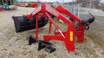

I think that if they are not covered, then they are going to get an upgrade with gussets. Even if they are covered, I might take the new ones off and do the same. My buddies 1726e which is considerably smaller has much more stout supports from the frame than these.

My buddies much smaller MF tractor uses round tube, which is much stronger looking that this square tubing that is mitered and welded. It’s definitely not a great design. Look up any MF 1835 with a loader and you can see them pretty clearly. The welds weren’t all the way through, as you can see in some of the separation.

Another point is that manufacturers got rid of the support bar that used to go to the front of tractor for some reason, costs most likely. This would spread the load through a lot more area instead of concentrating everything in the middle of the tractor. As people start putting hours in their tractors, I won't be surprised if we see more cases of cracking loader mount on any brand really.

From this photo, IMO, it appears the steel failed due to the missed weld or poorly penetrated weld on the topside of the photo, which may be towards the rear tire. As evidenced by the rust in the steel line AND the delaminated paint at that location, that steel has been cracked like that for some time.
I would take a closer look at the joint/weld seam towards the rear. If it is a poor weld the tubular mount was relying on three sides rather than the designed four sides.
Hopefully a failed/improper weld caused this on both sides, glad no one/property was hurt/damaged. At any rate, if you are in the US, this should probably be reported to www.recalls.gov if the weld is bad.

I never really looked at the modern loader frames. I didn't know they made some with no nose bar. The nose bar on my Farm Hand loader would stop that from ever happening. Mine looks like this one, just not as pretty.

I am assuming it is broke on one side not both? I cannot say for sure but this had to be bad from new small crack to start with and took a while to work its way down and finally failed? It is fixable with proper grinding and i would put in plates on both sides for more support and do the same to the other side. Going to take some welding and repositioning, If i was close i could
help you fix it ! Also to add go where you bought it and have it replaced at there cost If they give you any problem about this crack had been there when you bought it, Take it to someone in your area, they can look at it and tell by the break if it was a failure from the start !! And not to worry about some saying if you get it fixed to be cautious, Fixed and welded up with new plates on both sides of the loader arm will be stronger than new, I would check the other side also to see if there is and evidence of a crack in weld or any place else. These things can be over looked at the factory, and this was !!
