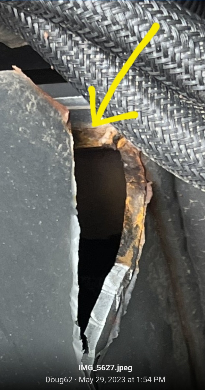

I had a similar failure on a trailer, looked like your pics. Welder laid ahigh bead on, not in, the joint. Then ground off the bead improve its appearance. Only left a paper thin weld, which cracked from flex and vibration.
Old saying: grinder and paint will make me the welder I ain't.
Bottom line, IMHO at least, poor worksmanship compounded by poor QC.

Looking at it, I'd say it was abused somehow and started to crack away but wasn't noticed prior to failure. Stuff like that don't just happen, it has to be brought on by some sort of abuse.
/ MF 1835M loader support collapsed on tractor #68
Massey doesn't make 'em like they used to (I mean back when they were still headquartered in England). Anyway, it's clear that the welds had inclusions that rusted after the paint failed at the top of the bracket, the region most exposed to sun, water and abrasion from falling dirt and rock. It's also likely the steel is poor quality. Good quality, high carbon steel doesn't rust fast or deep even when unpainted and exposed to weather. Nowadays most of the steel used in the manufacture of consumer level products is smelted from the recycled junk we ship to China. It's got rust baked-in at the foundry. Buy an orange one next time.

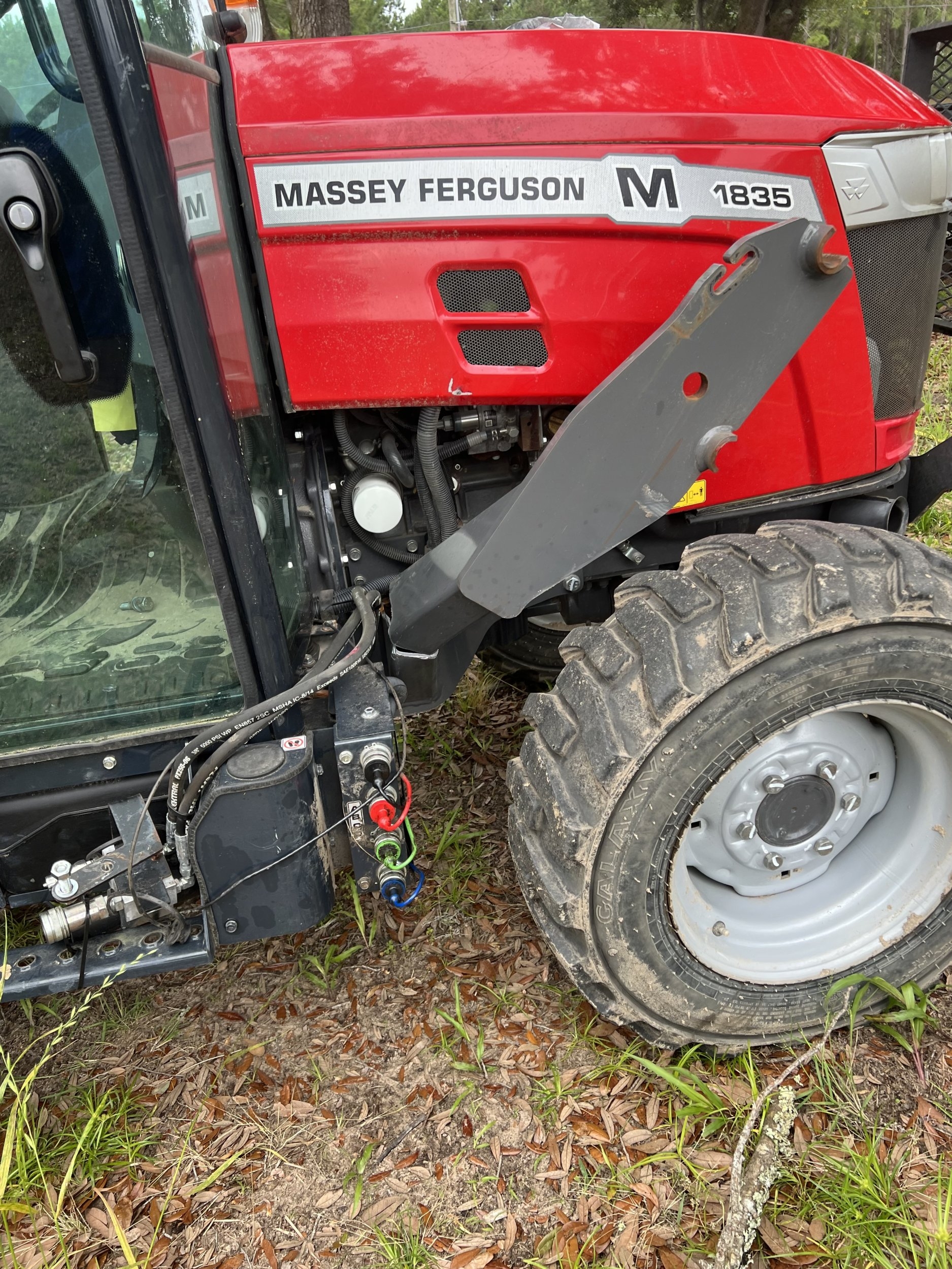

Was moving dirt today when all of the sudden my loader started going down all by itself. This was crazy looking. You can see in the photos that the loader sub frame gave way on both sides. It appears to be either bad welds or cheap metal. Either way, it’s nuts that it would do this with only 140 hours on it.

One thing that is immediately clear is that the loader was still being used heavily for a good while after the first cracks began, haha.
I'm not sure most of us would know to inspect for cracks in obscure areas of the loader subframe. But it sure would have been better to discover the cracks before the entire mount failed.

Was moving dirt today when all of the sudden my loader started going down all by itself. This was crazy looking. You can see in the photos that the loader sub frame View attachment 802798 gave way on both sides. It appears to be either bad welds or cheap metal. Either way, it’s nuts that it would do this with only 140 hours on it.
Am I missing something here. Aren't there suppose to be a brace on each side that goes for the loader mount to the front of the tractor frame for support? The brace behind the hydraulic piston on the photo I have attached

That sucks. The issue is not the steel or the design. It's the build.
The pictures aren't the clearest, but it looks like the top weld on both brackets was misplaced, with little-to-no penetration on the tractor side of the joint. Jig or programming problem if it was a robotic welder, which a lot of them are nowadays. Yours are likely not the first ones that AGCO has seen with the issue, and I suspect you won't have a problem getting free replacements that are welded correctly. I wouldn't bother fixing those ones. As has already been mentioned in this thread, the metal all around that failure is going to be severely compromised.
I recently had a bit of experience with this exact issue on the other end of my tractor... CB85 Backhoe boom arm split
I'm not sure who makes the backhoes, but poorly located welds on workpieces are really showing the weak point of robotic welding vs skilled tradesmen.
