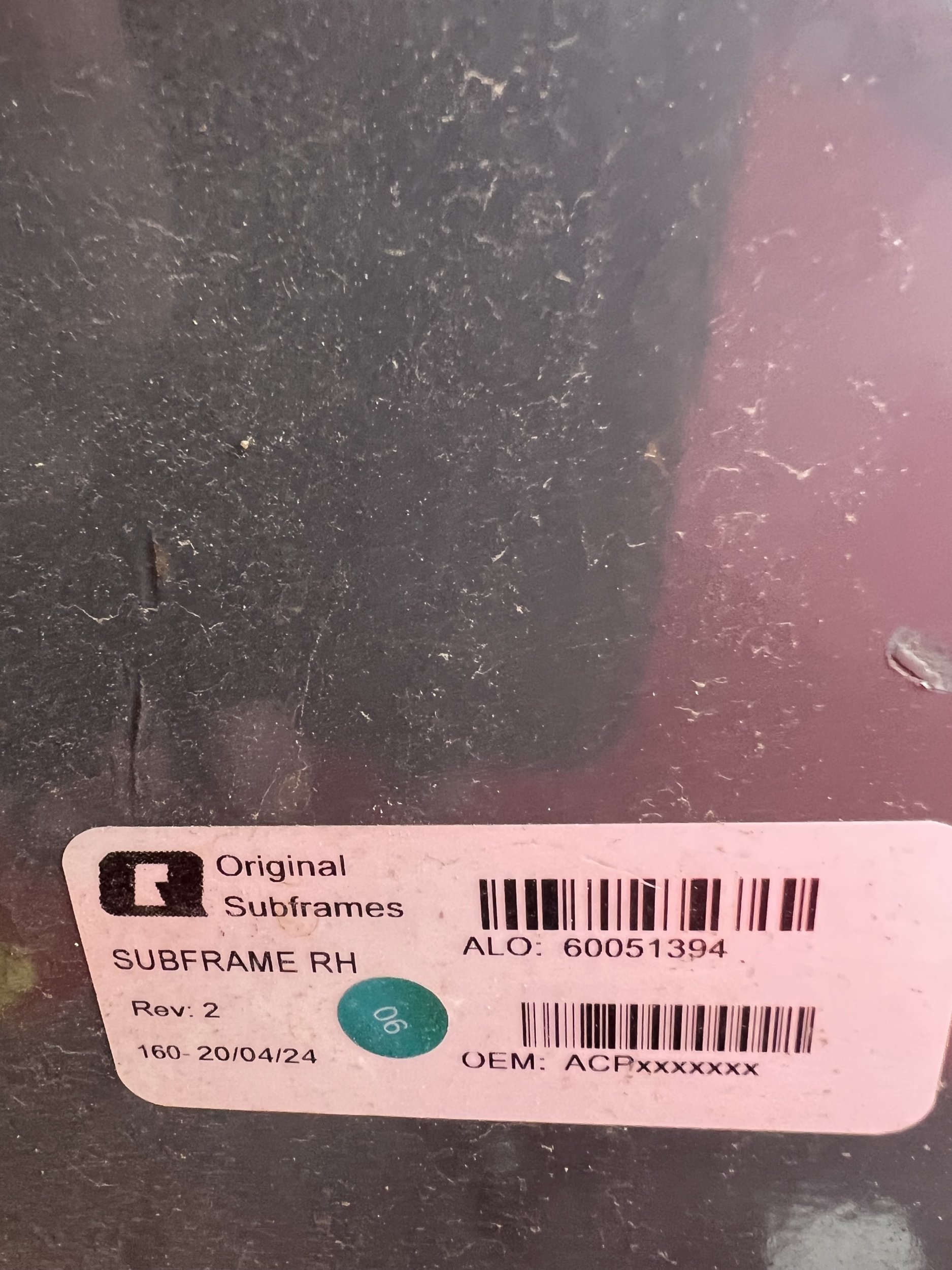

You'd need a lot of plate and gussets, a bend like that in a major element is going to be weak forever. Better to replace.
And reinforcing before installation. Seems like triangular plates on the top would be in order.
Depends on cost and availability.

If this were on a machine from the mid 80's where the parts were no longer available, then I would recommend repairing, or more accurately rebuilding it while also beefing up the design significantly. It would be quite a bit of work. Since its a relatively new machine AND replacement parts are most certainly available, I absolutely would NOT repair the existing hardware. Start off with new hardware and then decide where you want to go from there as far as making any modifications.

Most likely is originally cracked (rusted part) from driving into a pile, just picking up is unlikely to do that. Then it kept tearing until it gave way.
