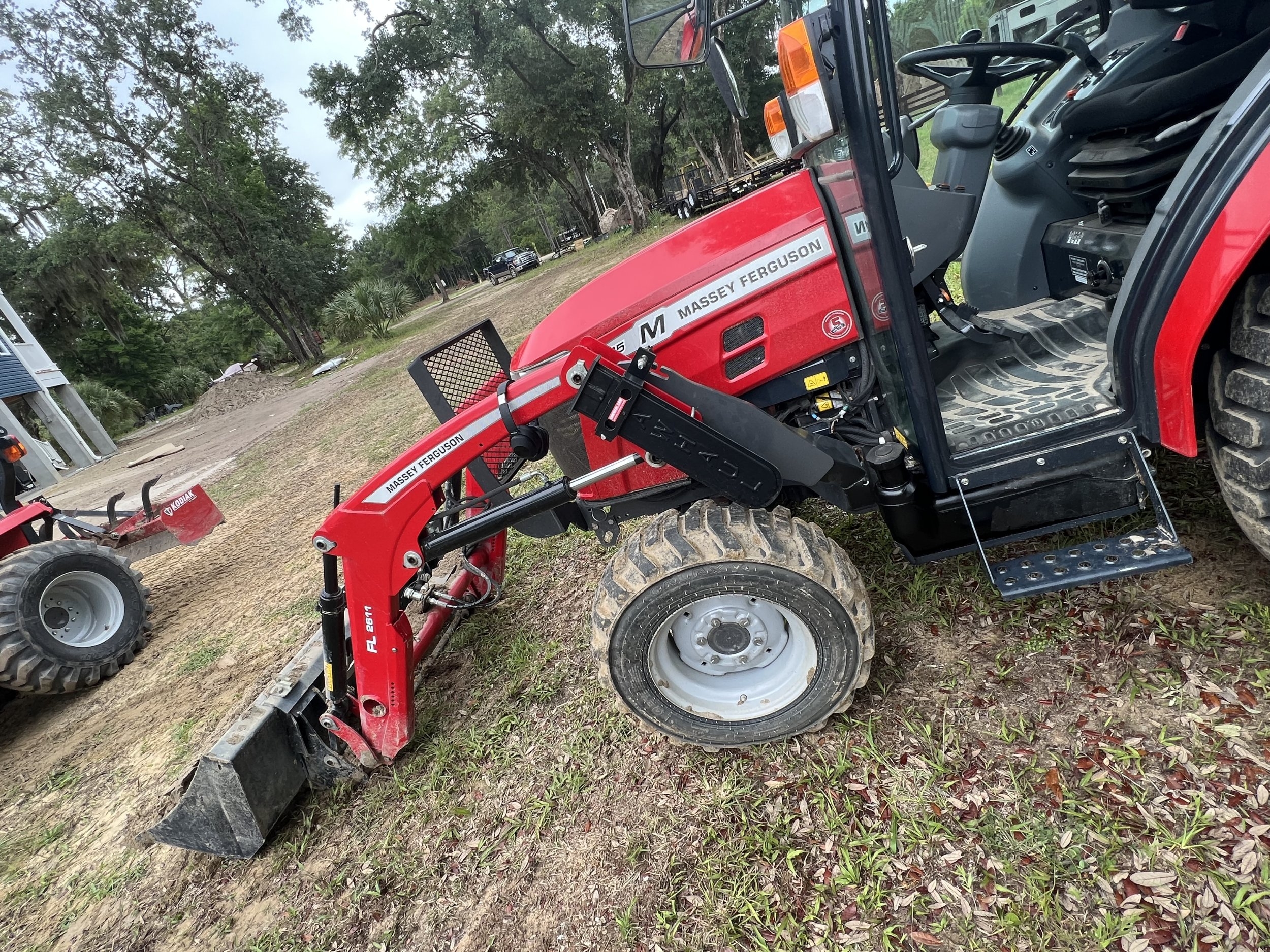

May be some design problems but, the steel was sub standard to rip apart like it did. Looks as though the welds were good, they never failed, One side has been breaking for a while you can see this by the rust in the old crack and the shine on the new rip apart. Maybe substandard steel in my metal working years we often seen in foreign made steel voids inside steel plates ( you could not see those until you cut into them ) what a pain to work with. Is that voids around the subframe sticker?
At any rate the design should be rated far above the lifting capacity of the Hydralics.

I would bet the was a weld failure on back side of tube (horizontal) where we can not see..... This allowed all the strain of FEL on back side of vertical tube.... Also bet it was a robot weld with poor preparation because it appears there was no penetration....

Was moving dirt today when all of the sudden my loader started going down all by itself. This was crazy looking. You can see in the photos that the loader sub frame View attachment 802798 gave way on both sides. It appears to be either bad welds or cheap metal. Either way, it’s nuts that it would do this with only 140 hours on it.
Have seen similar failure happen when transporting a bucket load at a fast speed over long distances, and bouncing along while stressing the steel frame as well as the weldments.
No clue if this may have taken place but seeing the construction area in the background may be an indication that this little tractor was not the right tool for a landscaping crew.
Not built to take the place of a skid steer. Good luck with some warranty fix.

I wouldn't trust those anymore even if welded, personally.. I would, however, be temped to reinforce any replacements.
I agree but from the limited pictures, I think it's a very poor design fault. The entire load appears to be transferred to that 4"x4" sq tube that's at a extreme mechanical disadvantage from what's essentially a difficult highly leveraged rotational load.
Clearly under sized for these loads to be transferred to such a small cross section.
