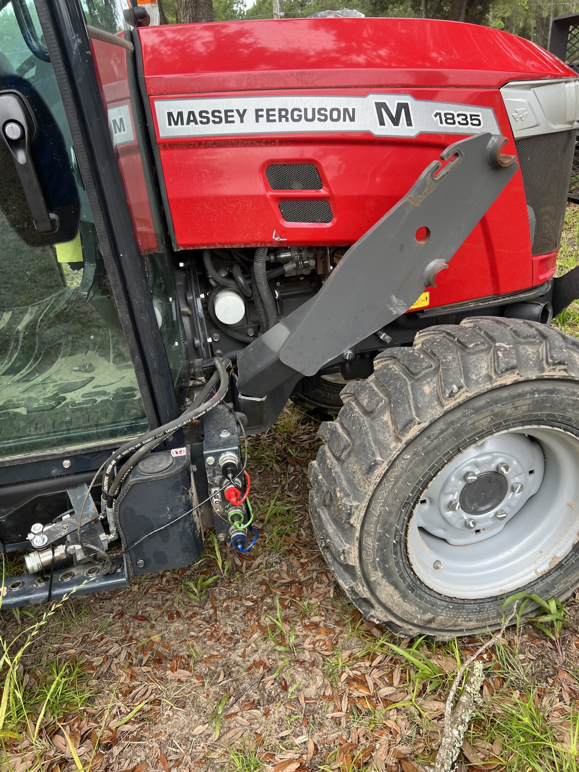

Massey doesn't make 'em like they used to (I mean back when they were still headquartered in England). Anyway, it's clear that the welds had inclusions that rusted after the paint failed at the top of the bracket, the region most exposed to sun, water and abrasion from falling dirt and rock. It's also likely the steel is poor quality. Good quality, high carbon steel doesn't rust fast or deep even when unpainted and exposed to weather. Nowadays most of the steel used in the manufacture of consumer level products is smelted from the recycled junk we ship to China. It's got rust baked-in at the foundry. Buy an orange one next time.

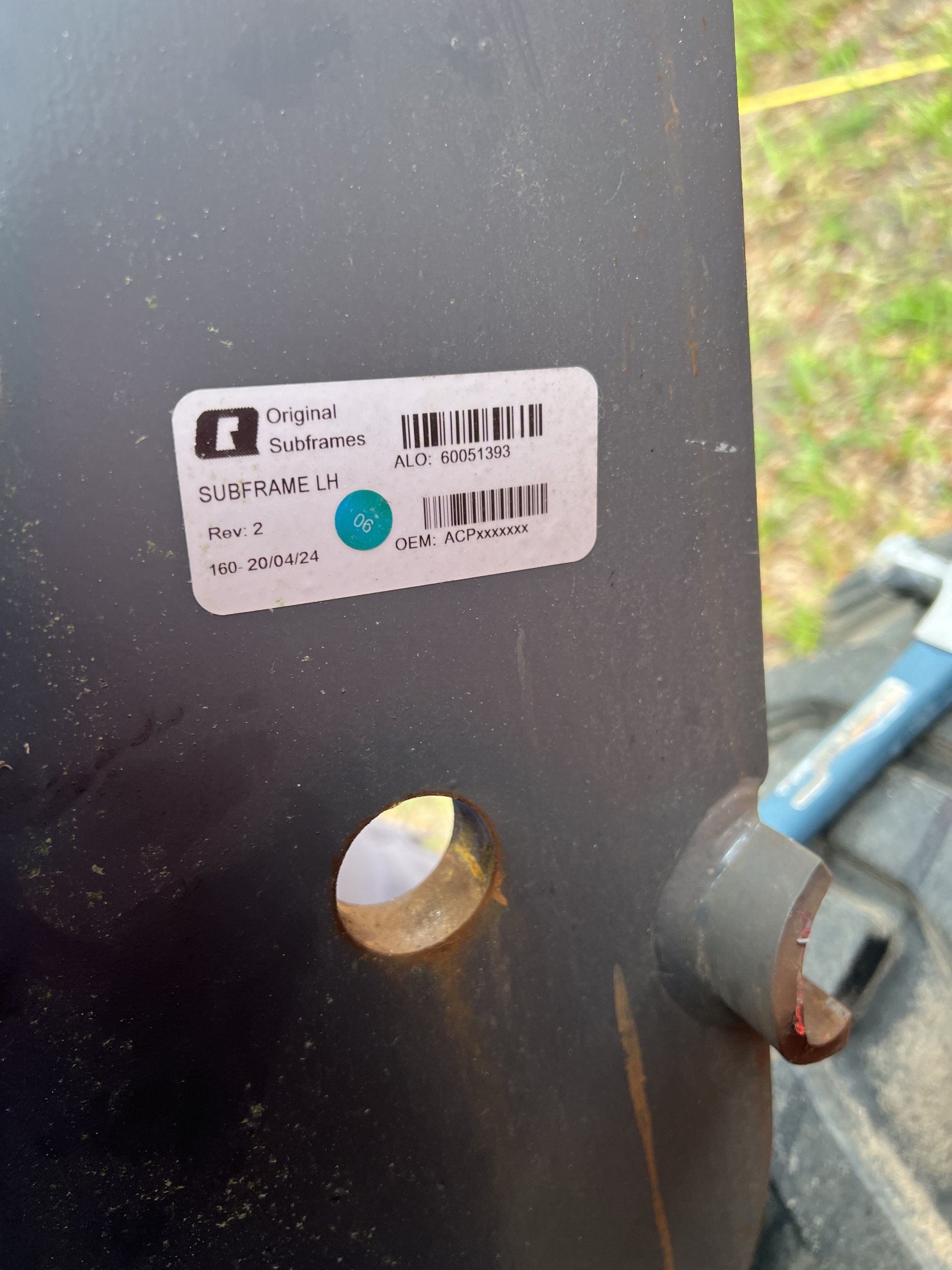

May be some design problems but, the steel was sub standard to rip apart like it did. Looks as though the welds were good, they never failed, One side has been breaking for a while you can see this by the rust in the old crack and the shine on the new rip apart. Maybe substandard steel in my metal working years we often seen in foreign made steel voids inside steel plates ( you could not see those until you cut into them ) what a pain to work with. Is that voids around the subframe sticker?
At any rate the design should be rated far above the lifting capacity of the Hydralics.
I agree but from the limited pictures, I think it's a very poor design fault. The entire load appears to be transferred to that 4"x4" sq tube that's at a extreme mechanical disadvantage from what's essentially a difficult highly leveraged rotational load.
Clearly under sized for these loads to be transferred to such a small cross section.

Like someone else said. To me it looks like there was a bad weld at the top where the rust started and it slowly got worse until it failed. Rust seems to progress in severity along the break. I don't see how anyone could put enough stress on an FEL in the direction needed to break the weld at the top of the support. In my opinion you'd really have to ram something hard enough to jar your teeth outa your head while the bucket was swinging into the direction of the side of original break.

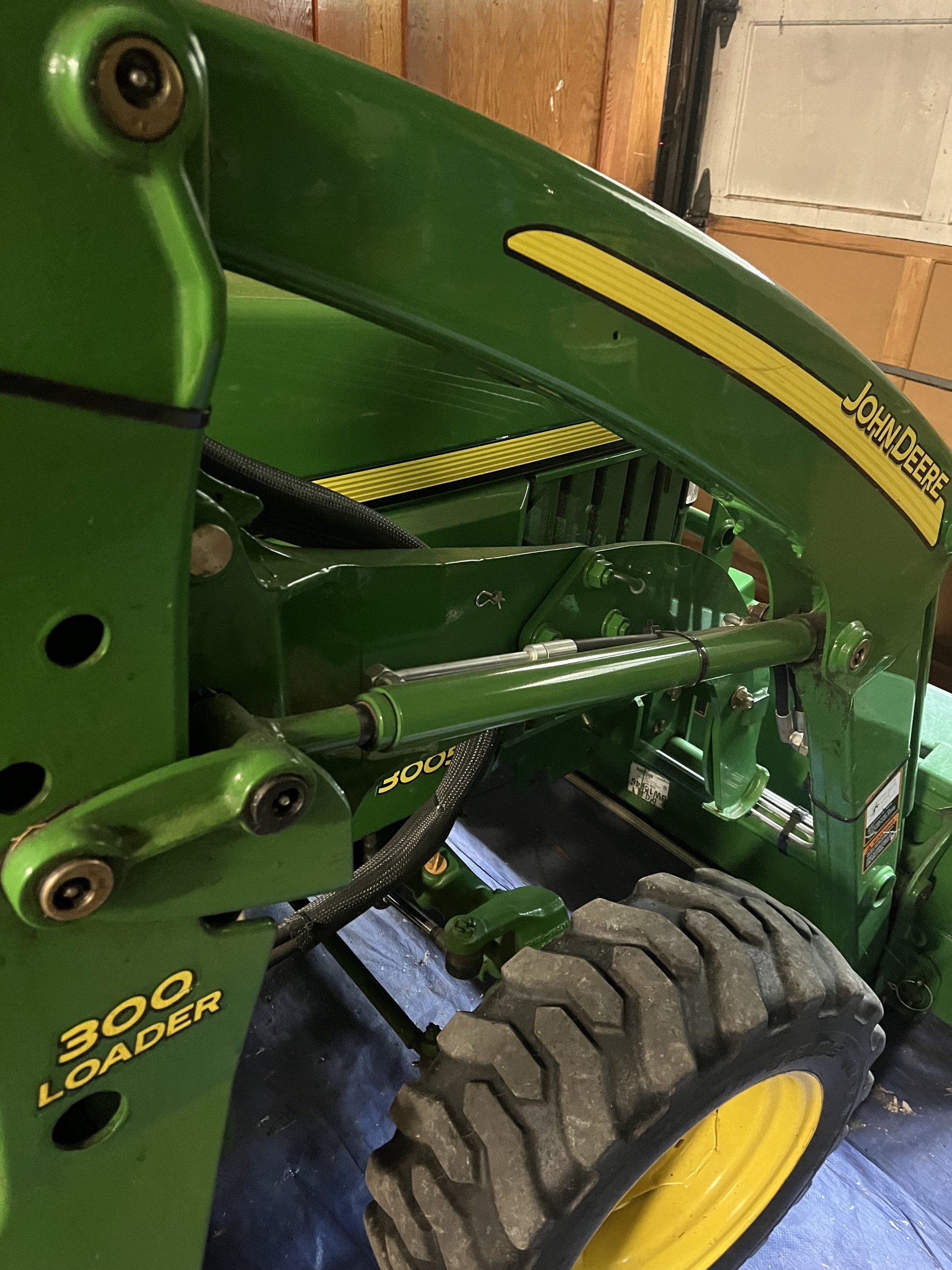

I don't know, maybe I'm wrong? But I just looked at the pics of the way the Massey loader stands are built and had to go compare to my way smaller B2620.
Look at the design. Not just a thinwall square tube. It is full of gussets and bracing. And the round tube is actually tied right back to the frame at the rear axle.
You would think the bigger tractor would have more beef to the loader stands than that.

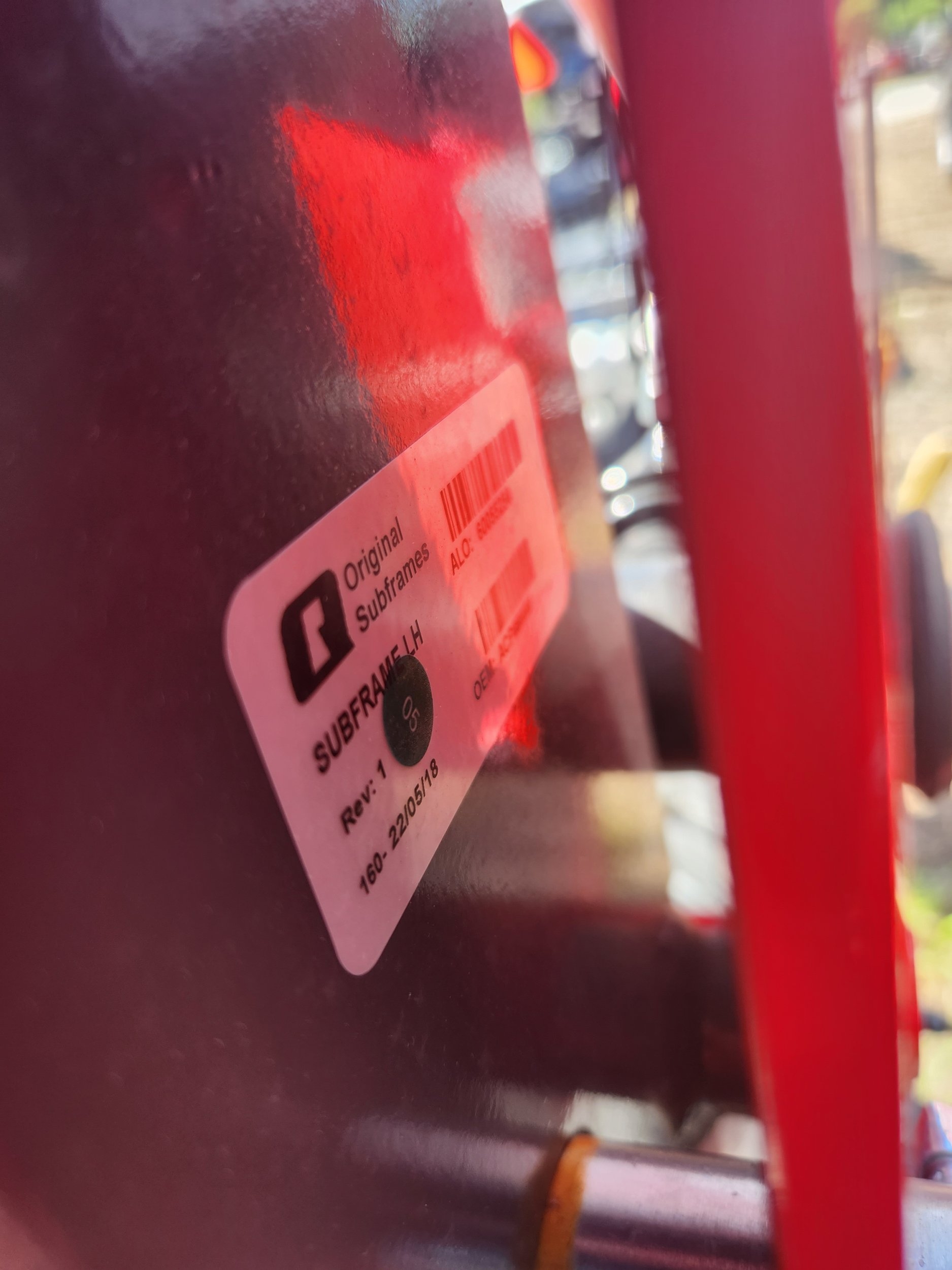

So I stopped by my Massey Dealer and all the 18M's had Rev 1 loaders on them, all 3 of them.
Also, not only do the 18E series use tube shaped loader mounts, but so do the 2800 series, so I don't know why it's changed up for the 18M.
The steel looks very rough. Poor quality? China?

Those frame assemblies are probably shipped in from China. That older/rusted area at the top is the area with the most load when carrying material with the bucket and hitting some bumps along a traveled area. Looks like it came that way and covered with black paint. Yellow is nice, cracks are easier to see.

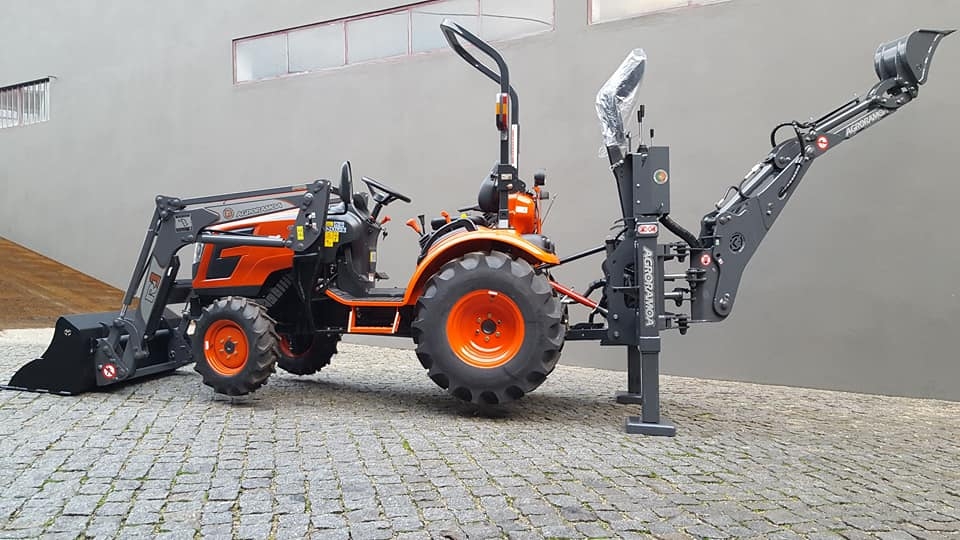

Having a backhoe digging an moving side to side with the bucket on the ground can't be good for the loader arms over time.
/ MF 1835M loader support collapsed on tractor #159
Kubota cautions against lofting the tractor with the BH outriggers and the bucket with the entire tractor off the ground as it puts undue strain on the tractor cases, especially if the BH is a 3 point mount with no subframe. More than one owner is incurred a very expensive repair bill from cracking the cases by doing just that as in the picture. I happen to know someone that did just that to the tune of 10 grand.
Kubota suggests keeping the wheels on the ground at all times and never moving the tractor around with the BH bucket.
/ MF 1835M loader support collapsed on tractor #160
That's funny. My Kubota backhoe owners manual says to lift tractor off ground and put loader bucket down with pressure.
And that's the way I have done it my whole life with full size backhoes.
