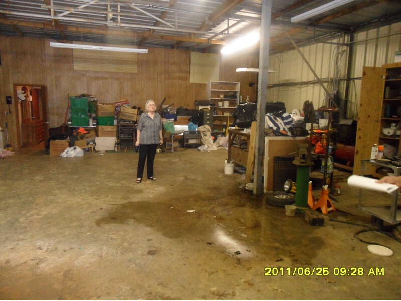

I have an open carport with corrogated thick metal roofing. It is say 20x24 and open on 3 sides. Its attached to the house but to a florada style porch that is not heated or cooled and sometimes has at least one or two windows open on it so its not like its heated or anything.
Anyway my point it on rainy or damp cold mourings as it warms up or on a day after really cool ones and the concrete pad is holding the cold it will have a soaking wet floor, also as it warms up it condenses on the roof to the point that it "rains" under the carport.
I've a similar situation in a shed I recently bought in NE Mississippi.
Building about 40x60, all metal, unheated (no need in Ms.) rains for a while on mornings when it was below freezing and whatever moisture which condensed on the roof comes down, as the sun warms the roof.
I've had recommendations of insulating the roof (coffee cup analogy).
My question is - what would be the best way? DIY kits run around $1/sq ft for an inch thick. Should I just cut up styrofoam cups from along the interstate and glue them to the ceiling? If professional install is $1/sq ft where should I go for bids?
Picture is prior to purchase, and yes the roof leaks slightly and I'm getting it fixed.
