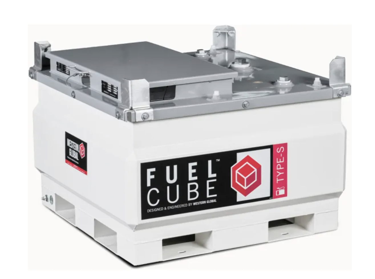

/ Fuel storage building #23
@ultrarunner any idea on the pricing?
Also, the FuelCube type-S, which is DoT approved for transport;
All the best, Peter
