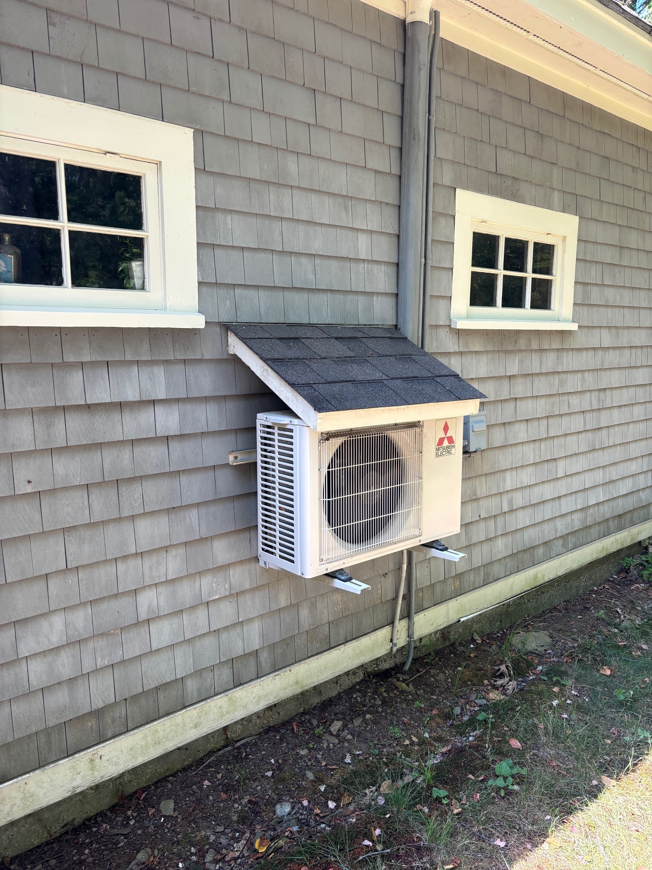

As advised above, and Cover Tech has what you need COVER-TECH | Heat Pump Covers | Mini Split Covers for $370 each.
I built my own and you can too for under $100 and some time. For your conditions you would want to go wider and have sides so air can get in/around the unit.

2 feet from the house is a lot. I'm on my second home with heat pumps, and both, as well as every other one I've seen is less than a foot from house. First home, I built a roof like shown above. It worked well. Given there isn't much you can do about the distance away from house, I'd leave maybe a foot clearance on the sides of the unit(s) and then put a wall to the house attached to the roof you are building. That will keep the majority of snow from blowing behind the unit, and still allow more than enough airflow.
