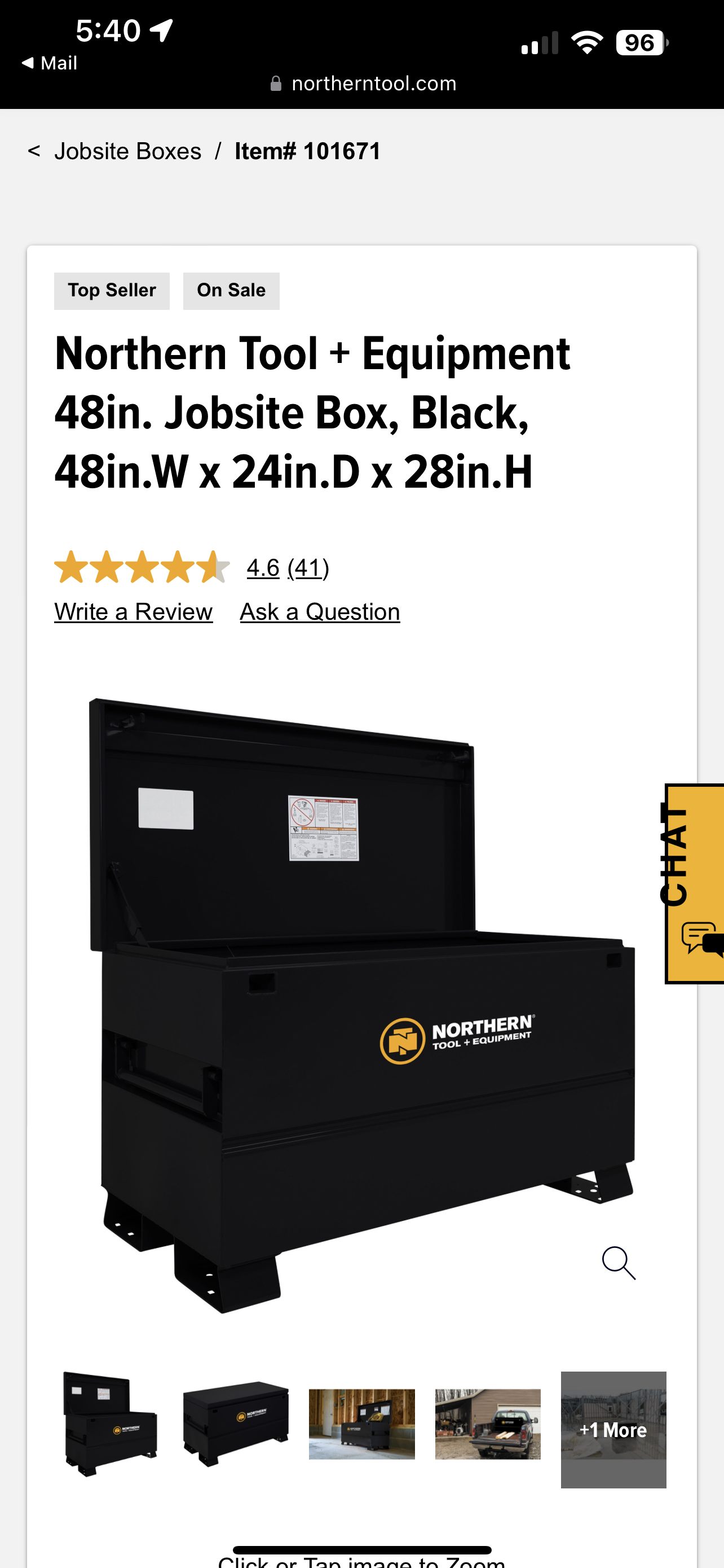

What does everybody use to store their fuel, not the container itself but a location.
I usually store between five and 30 gallons of gasoline and 5 gallons of fuel oil for the tractor.
I have always stored mine in my barn and I’ve gotten to the point where I’m uncomfortable doing that.
It not only takes a valuable floor space, but I’m concerned with the fire load it could add to the building contents if the building did somehow catch fire, along with the fact that I do welding, cutting grinding, and so on in that building.
I was looking at Northern Tools job boxes the other day, but I was concerned with the fact that it may contain more atmospheric humidity with the sun beating down on it throughout the day, and getting rained on, and cause water to condensate inside my jugs.
Do you think that would be a problem?
Do any of you have any better ideas than using a job box?
I have considered building a small shed or buying one of the yard sheds that you can buy on skids also but its not, my preferred choice.
Below is a photo of what I was thinking about.

My biggest concern is moisture.
My garage and barn is both concrete floor but I don’t want to store them in inside my residence or my barn.
I also want to protect them from whatever moisture could be introduced by condensation.
I would think by storing them in a job box, condensation would be minimal, but I’m not sure, and I don’t want to take a chance.
Ultrarunners idea of a concrete bunker seems like it would better insulate against temperature swings, and a job box but I’m not sure. also, it seems like it would dramatically be more expensive.

This likely will vary depending on one's climate. I feel that fuel should be stored in the most temperature stable place you can put it.
I think this is a good point. I store my jugs atop a 2x wood riser on concrete and never have a moisture problem.
