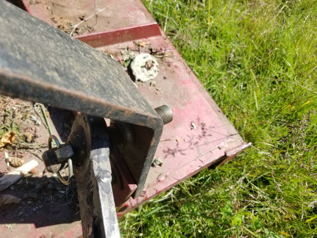

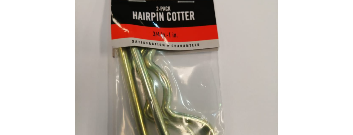

A couple of things to try: Cut a piece of metal pipe to make a bushing to reduce the slack/play between the equipment frame and the lift arm. If you reduce this space so that the linch pin fits snugly beteeen the lift arm and the hole in your draw pin, that may fix the issue. The attached implement can move around enough to shear or dislodge your linch pin. A weak spring action in the pin could also cause it to come off.
See photo below for a hairpin cotter. Get the largest one that will fit in the drawpin hole and use those.
Both options are low cost and can keep the equipment secure. This could also prevent ruining a rear tire or breaking a top link (have had this to happen) if the equipment pitches off too far to one side.

That picture of the pin in Post 47 shows the problem! Way too much gap. I use the black "heavy duty" ones from TSC. One side is flat, they are a little longer than the standard one and the spring of the ring is tight. I ave not had one come off. Have bent several using the Intimidator Tree puller but usually straighten them back and keep using until I feel like they are bending too easily. Never lost one on the shredder but they do only close to the flat side.
