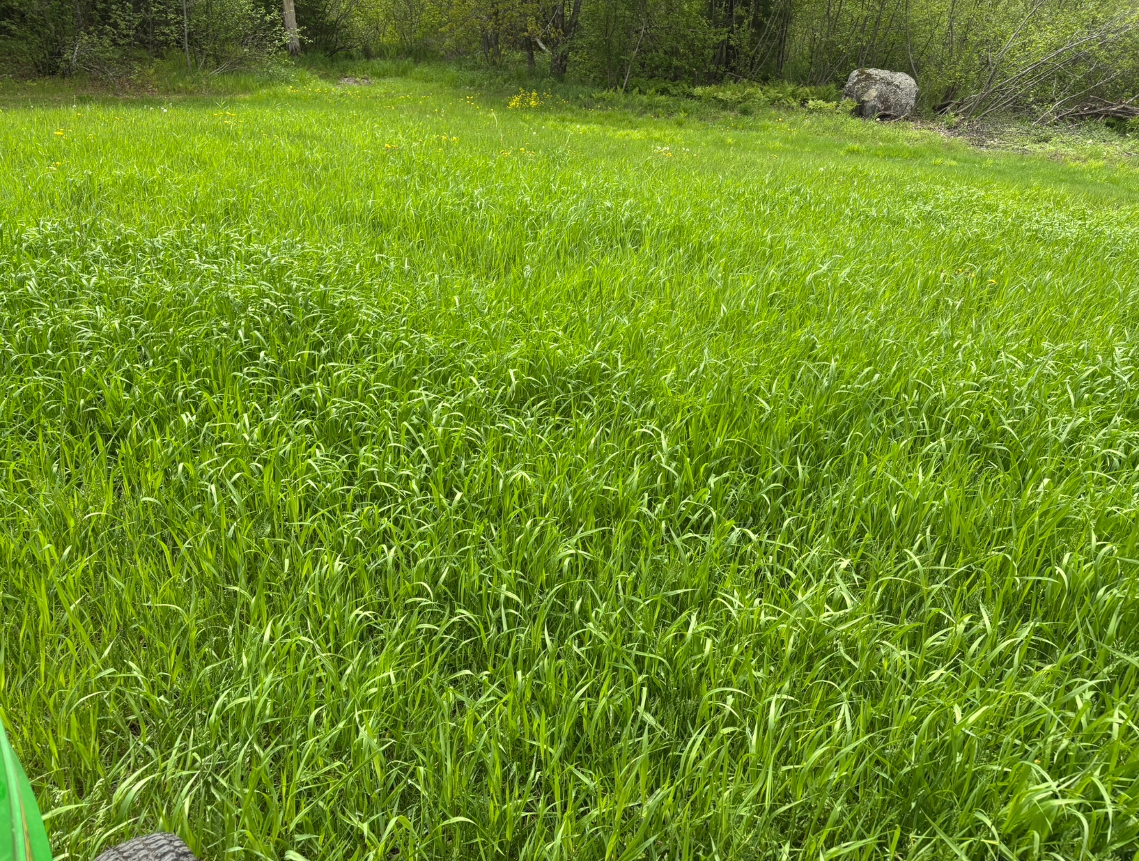

I had to mow up north. It was tall and wet, no choice. It’s been raining so much there this year, I had to cut on a day that there was a break in rain. Looks like my next trip will be cleaning the crap stuck under the deck. I probably should have used the finish mower behind the T25 instead of the JD. It was slow going.
