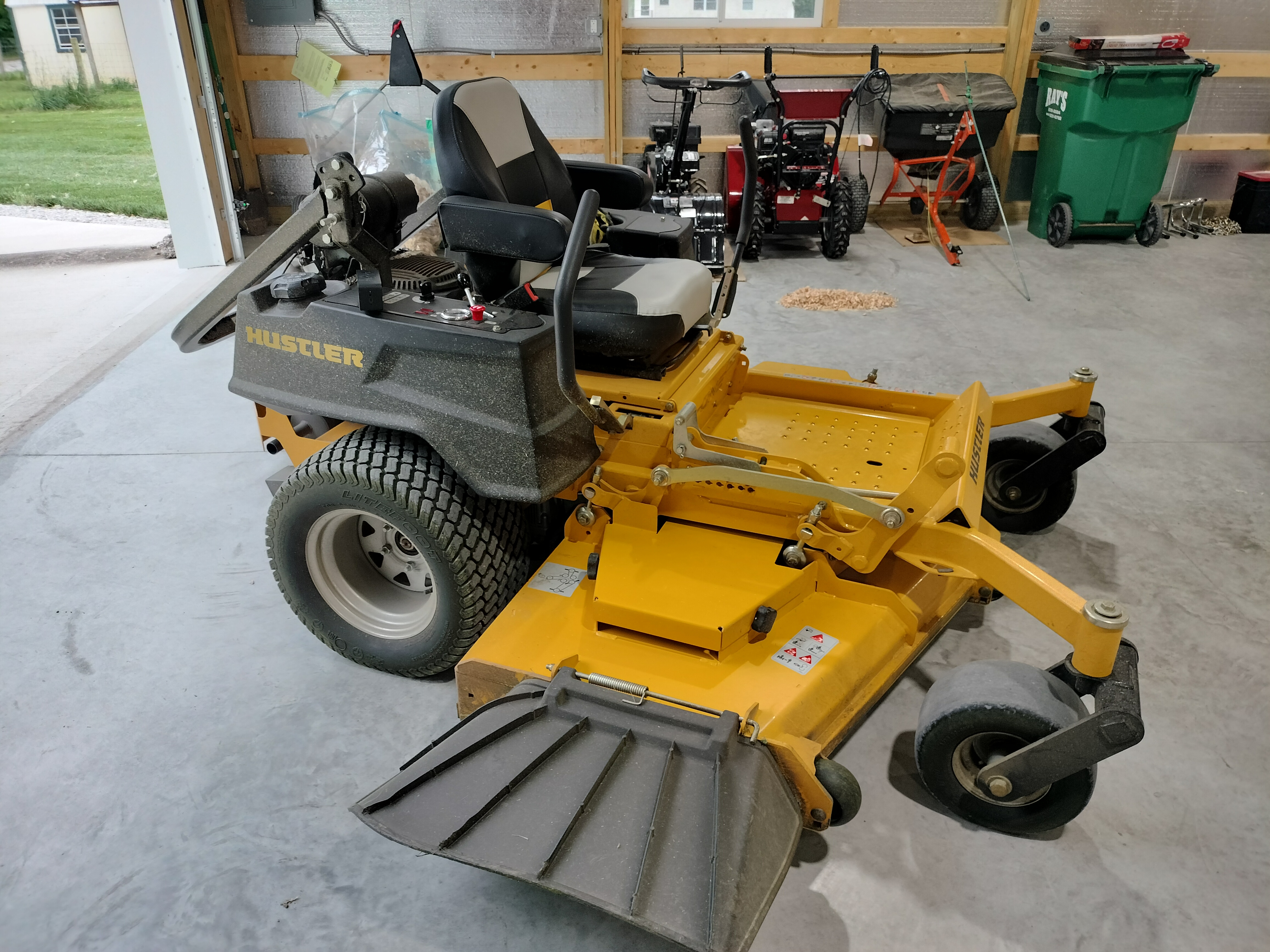

My wife's ZTR has the washout things I've never used. My diesel Kubota's is really thick and heavy, but I still clean it. The guy down the road has a Hustler and never cleaned the deck and it rusted out and he had to buy a new deck.

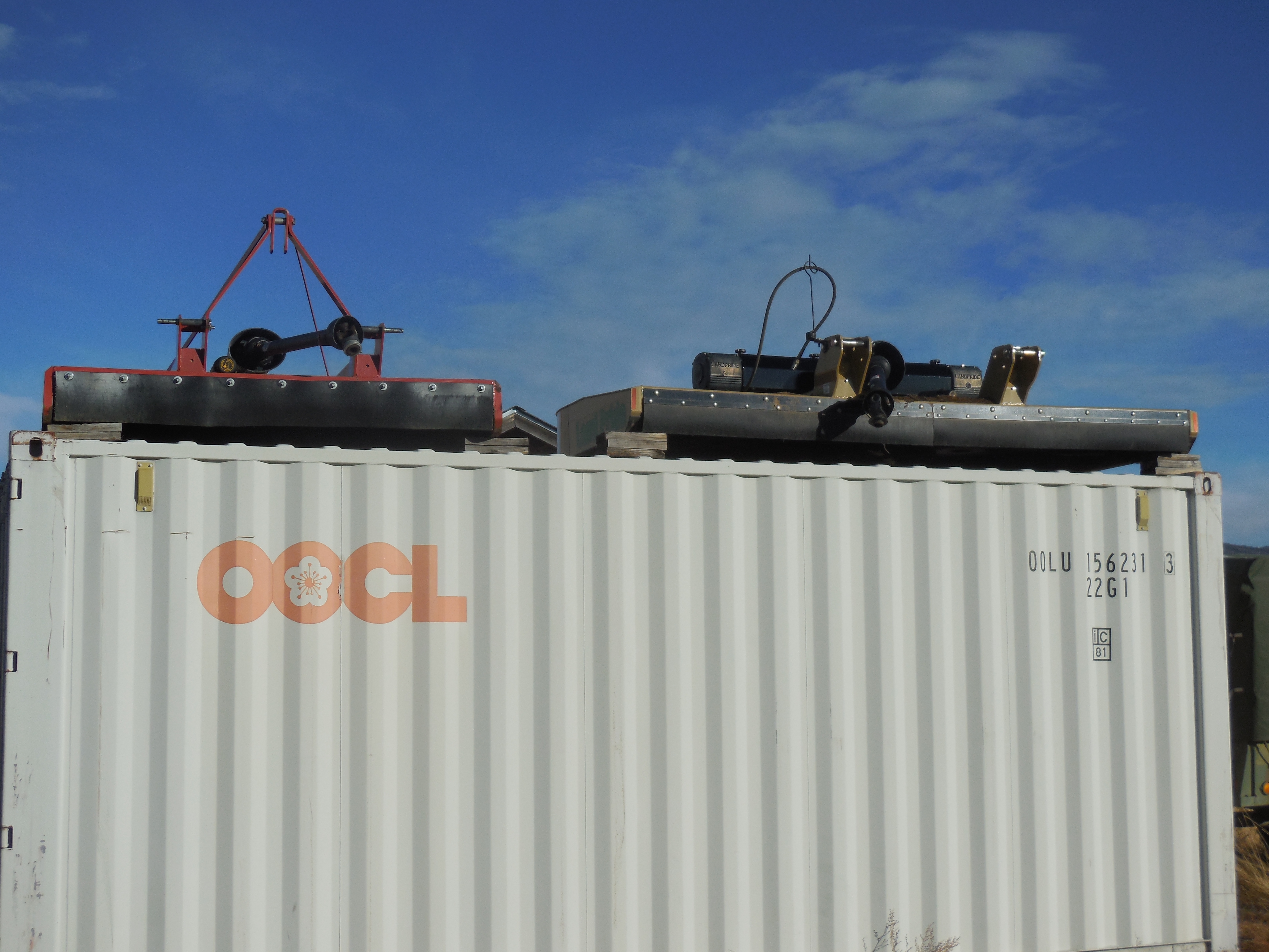

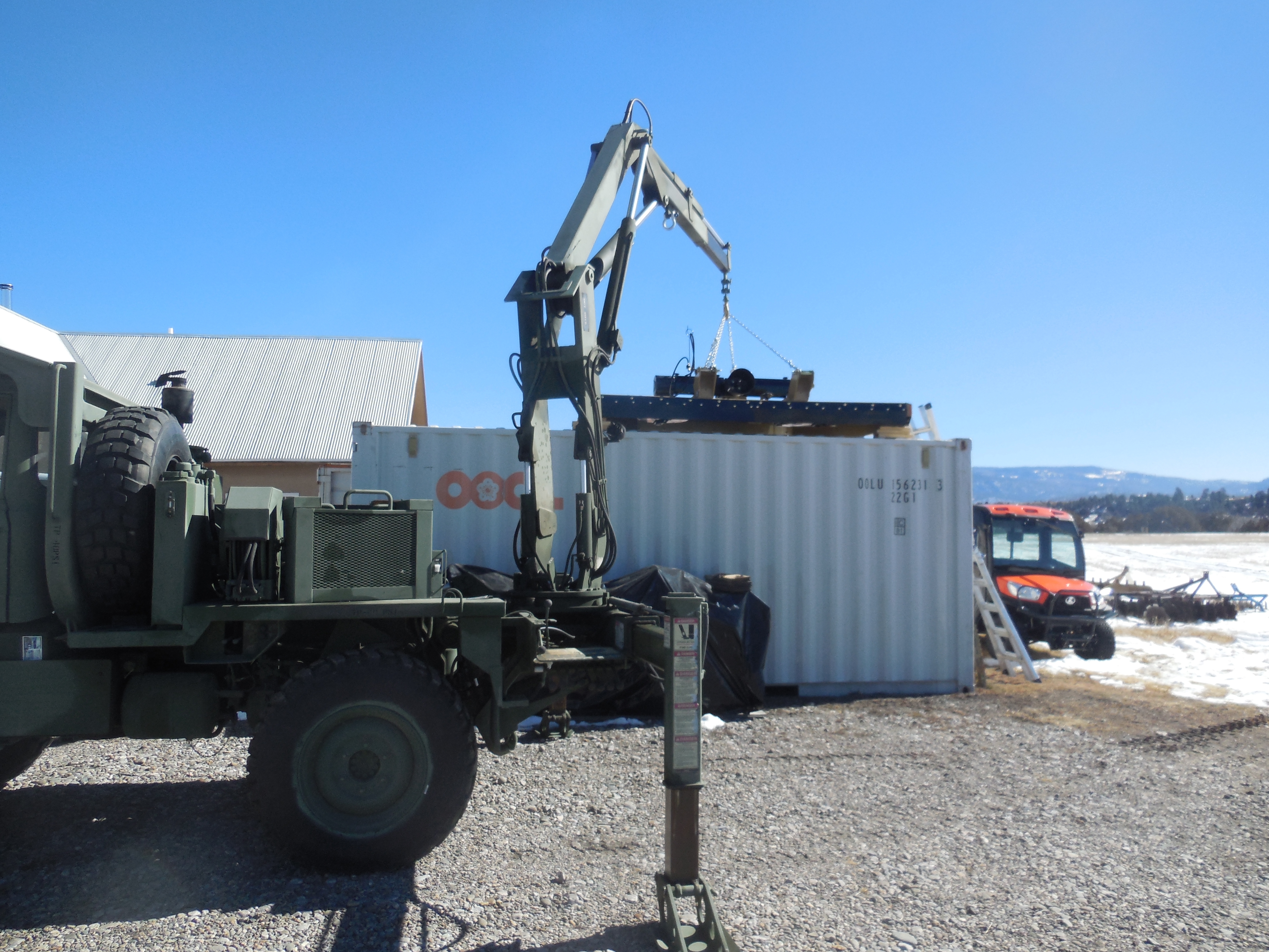

I used to store the mowers on containers over the winter, but these days they are parked on the grass year around.
