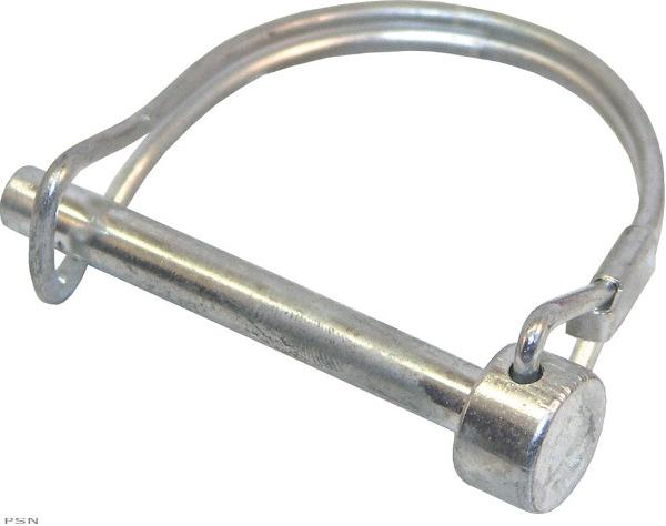

The pins for the three point lift arms ball ends really need to offer a flat face to the thrust loads.
Pins configured as in the attached image are not designed for maximum benefit. They do offer Length, which can be useful.
I've lost a few too many pins off the lift arms myself. A fella can sure tear up a bunch of steel if the loss isn't noticed right away.
It can tear up things quickly. Unfortunately, I know this to be a fact.

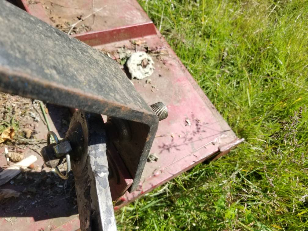

Not sure if the other image loaded; anyway I was thinking about it: I am fairly sure I never have lynch pin problems on my brush mower because my mounting bolts are reversed to usual.
The mounting bolts are inside to protect the ends of my arms and the spread is fixed rigid against the frame. It does not ride against the pin. It has never happend yet, but if I were to lose a pin it wouldn't matter because the arm cannot come off the mount.
   / Lynch Pins Coming Off
#37
The mounting bolts are inside to protect the ends of my arms and the spread is fixed rigid against the frame. It does not ride against the pin. It has never happend yet, but if I were to lose a pin it wouldn't matter because the arm cannot come off the mount. View attachment 703239
I’ve never seen that before, thanks for sharing. Makes sense, I’m going to look at my brush mower to see if there’s room.
