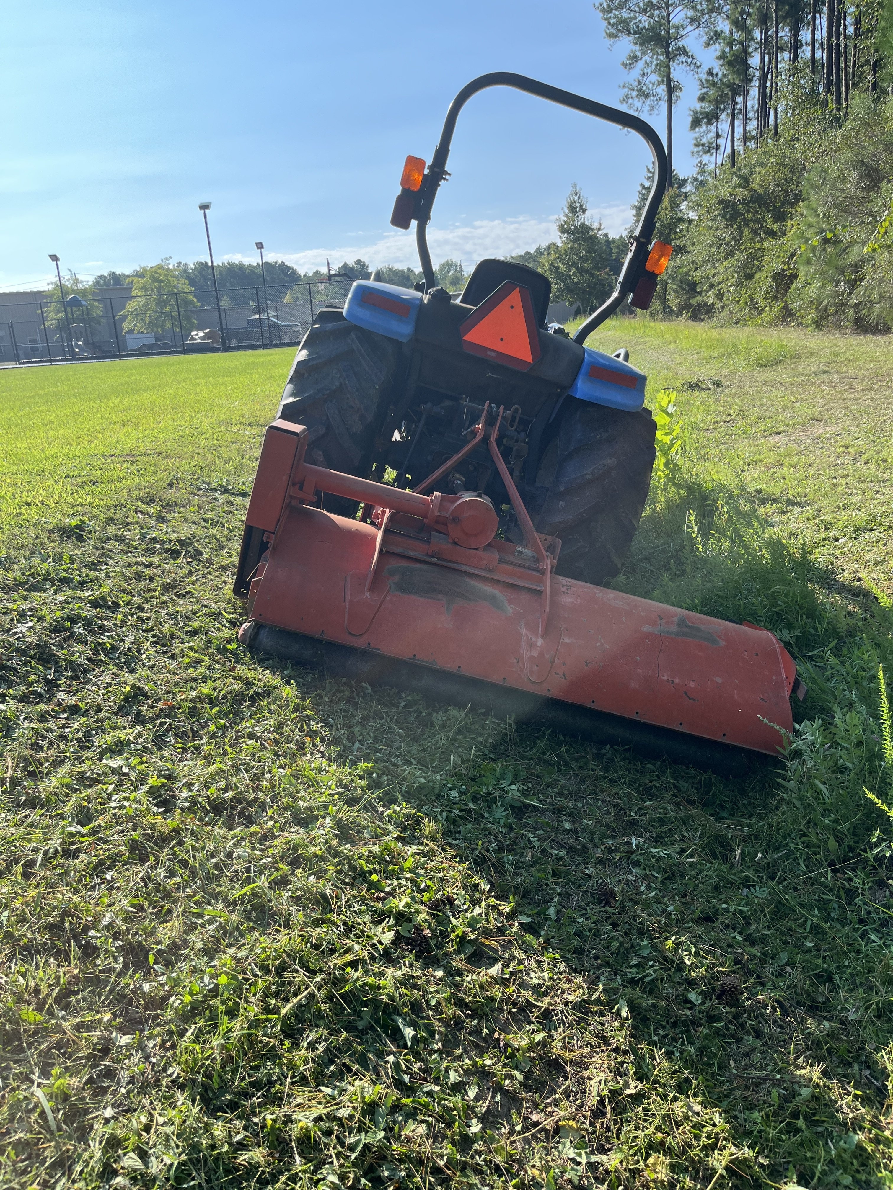

I mow the top by the fence, following it, then just back down the few places between the trees ... Then nose up to the fence, and back over a mower width on the way back down, and pull back up to the fence, no turning around.
This is the same place as that first picture, the little tree to the left of the tractor is the same one that is just barely in front of it in the other picture ...
Like I said earlier ... My tractor tires are directional, and I can't drive completely through that area, as it's too sharp of a transition at the bottom that goes back up the other side, so at least I know I can drive back up.

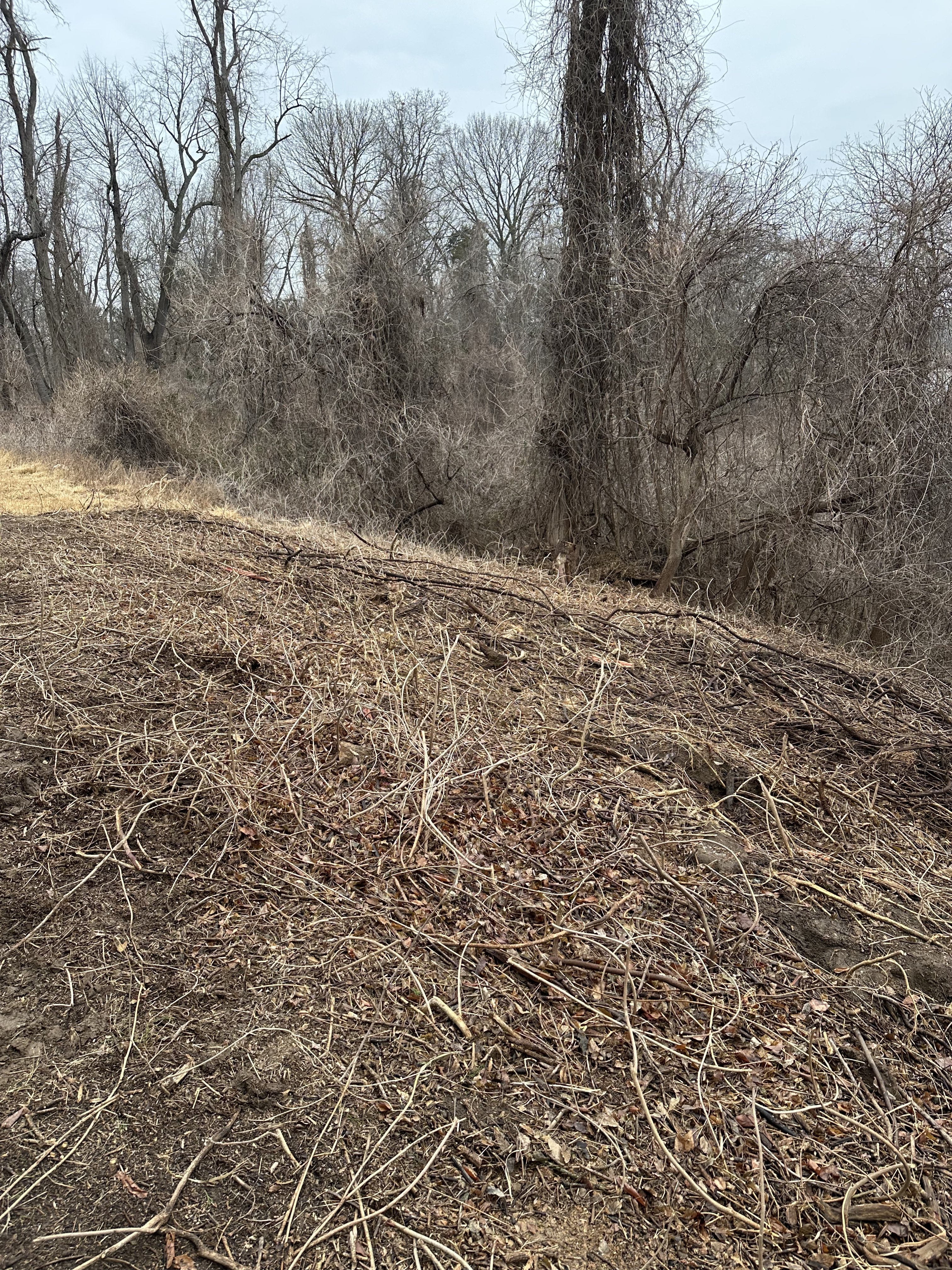

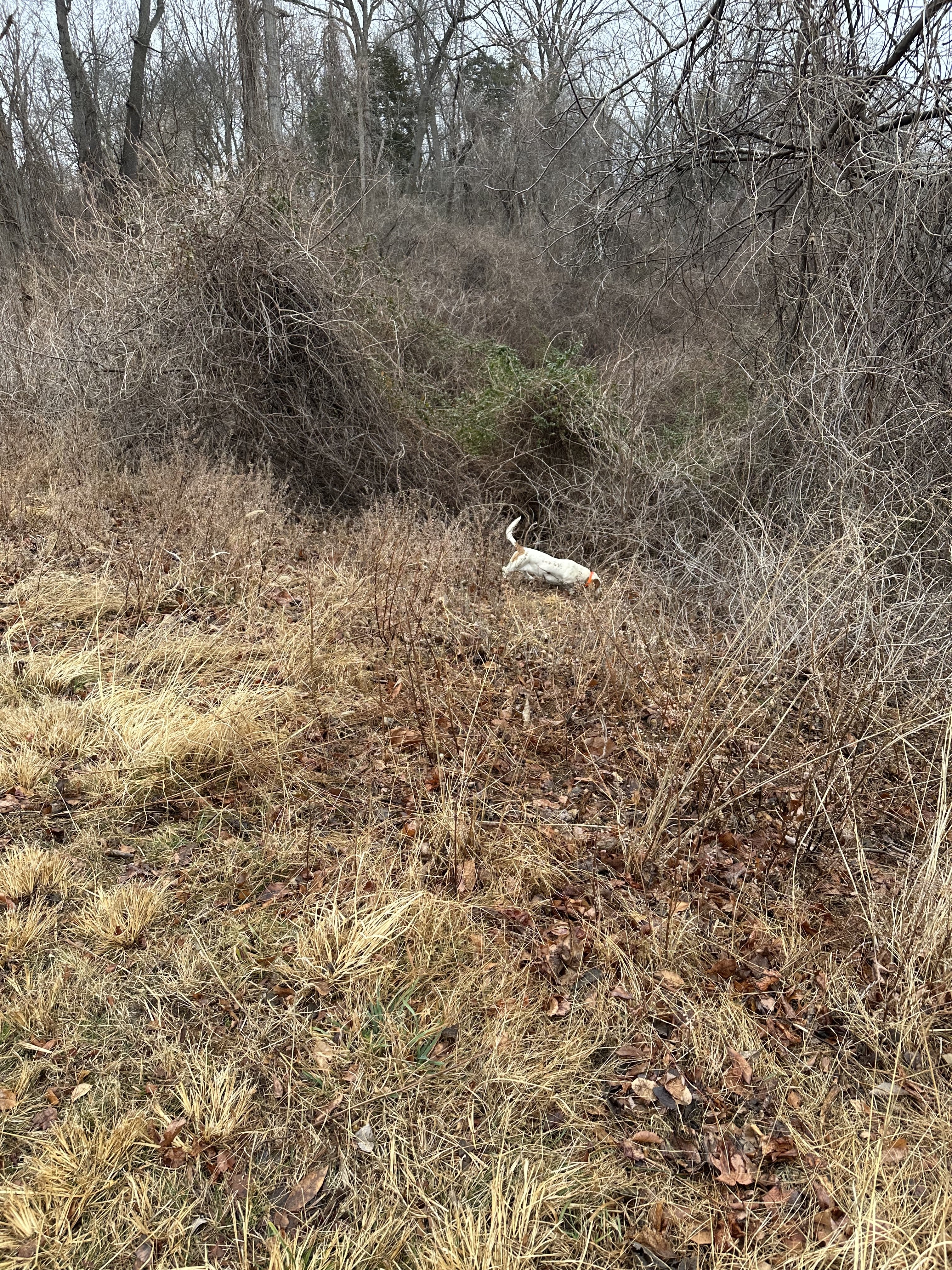

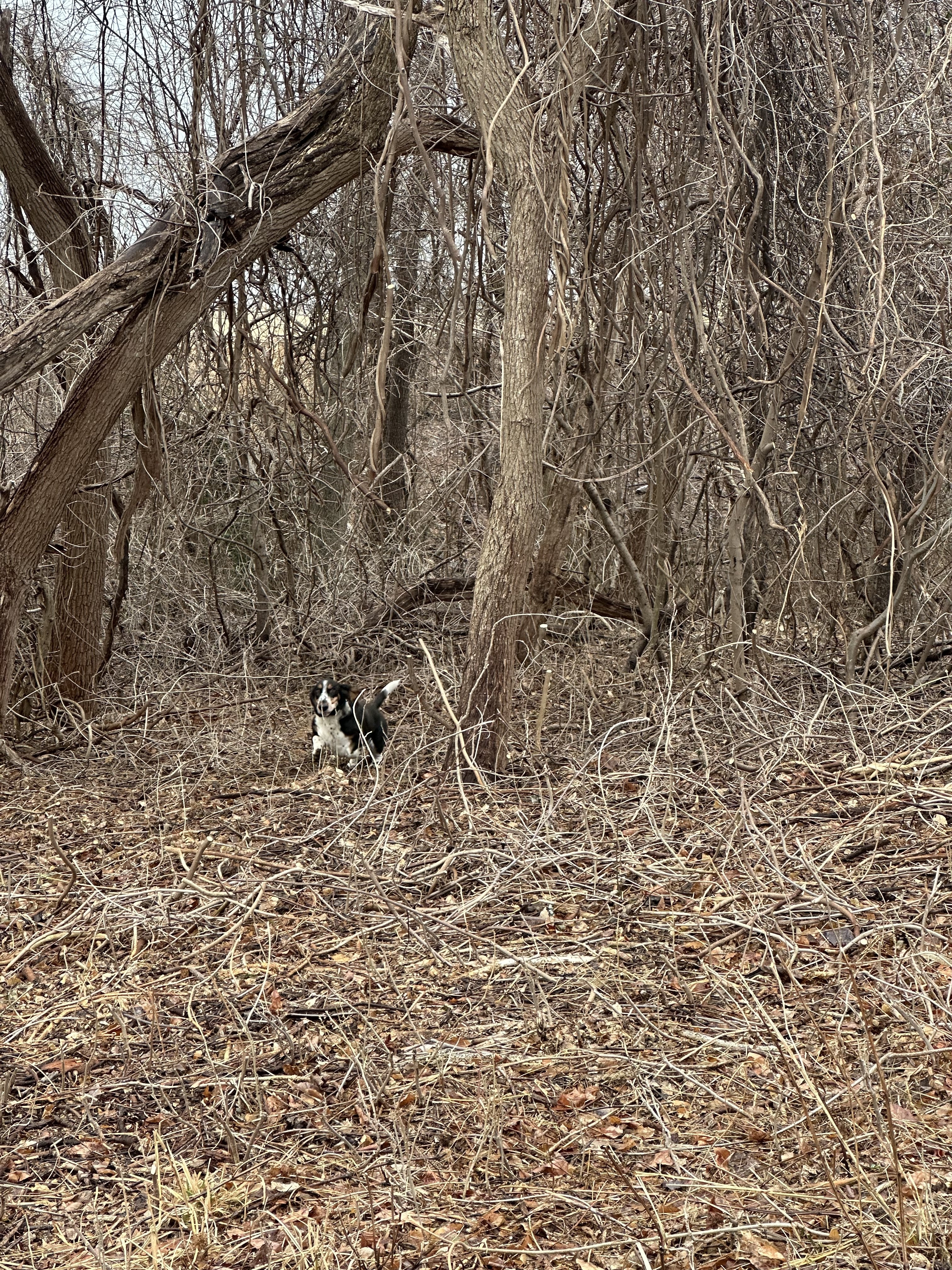

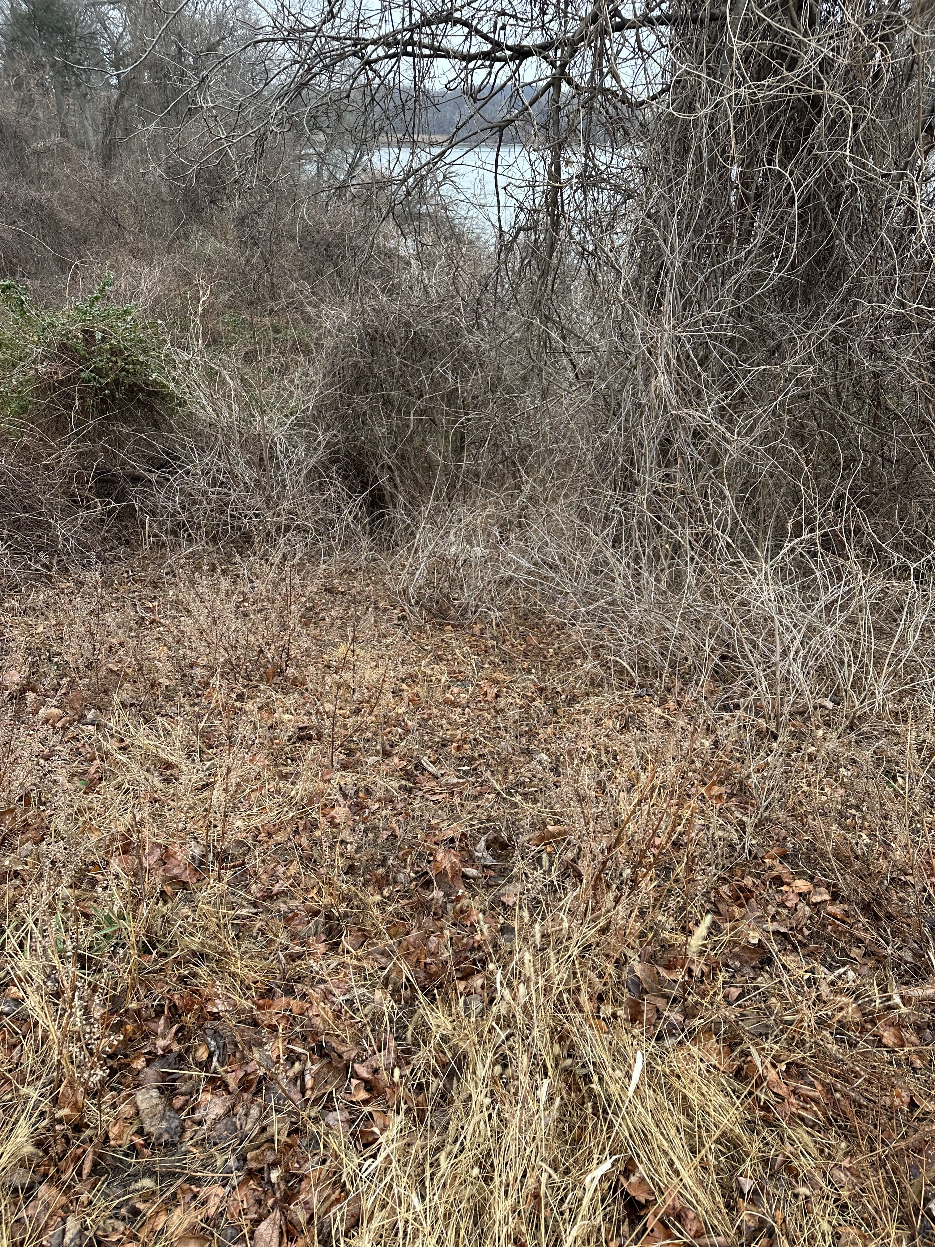

That's good to hear that backing down is the preferred approach. About 20 more feet I can mow.
Here are some photos of the slope. And Boyd and Opal.

The cut areas look like a piece of cake 🎂
Hard telling the lay of the land in the high uncut stuff, sure your pups know though! 😂

what is your intent of this area once mowed, ascetics, pasture? what will you sow?

I would be considering a good brush killer for what you cannot safely mow.

The main problem is the wisteria. The ground is covered in vines running along the surface and just below. It looks like cables everywhere. The thickest climbing parts are as big as my thigh.
My plan is Garlon 4 on the parts of the vines I can see along the ground. Then keep the area mowed so that the remaining vines are depleted of energy over the next few years with no leaves. The weeds that grow will look like grass when mowed. But will be far from it...There will be a deer fence running about 60 feet down the slope, and I will worry less about what happens between it and the water simply because control of so much area seems impossible. My goal is to maintain a view from the top of the hill, and to keep the fence clear of vines.
I've done this on flat parts of the property and have succeeded in converting wisteria infested areas into field mowed "grass." In areas where the vines are finally eradicated I let the natives (mostly Eupatorium) fill in (September is gorgeous when they are all in bloom).

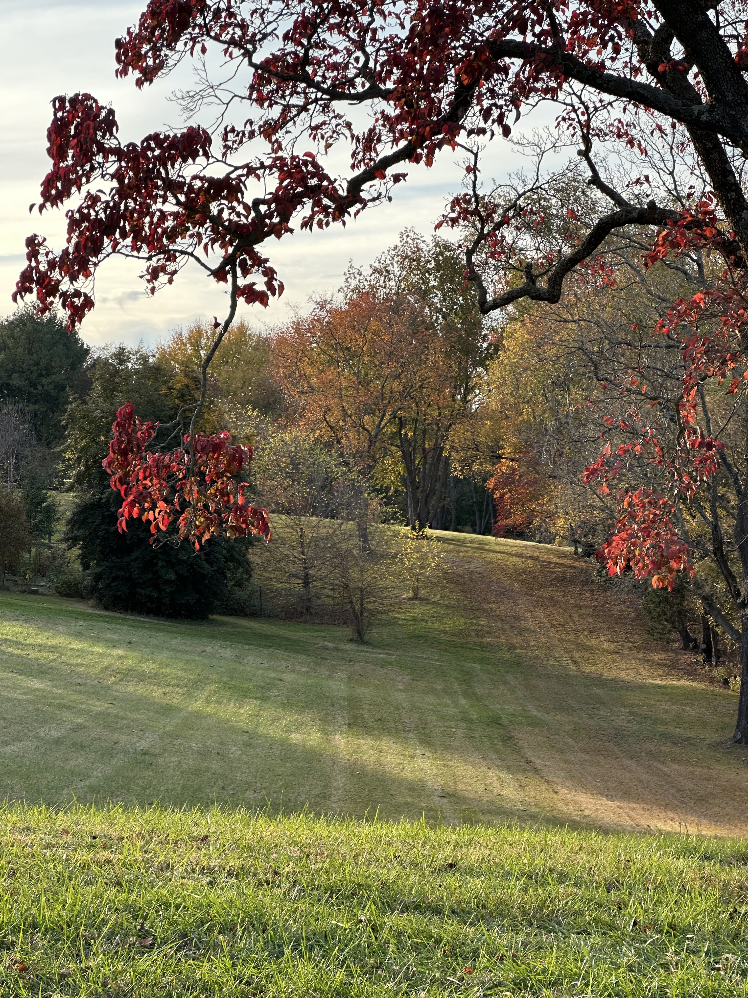

Here's the view in the opposite direction from the top of the same hill in early November. About 30 feet to the left of the tree line was all fallen trees and vines that I cleared over a few winters about 7 years ago.

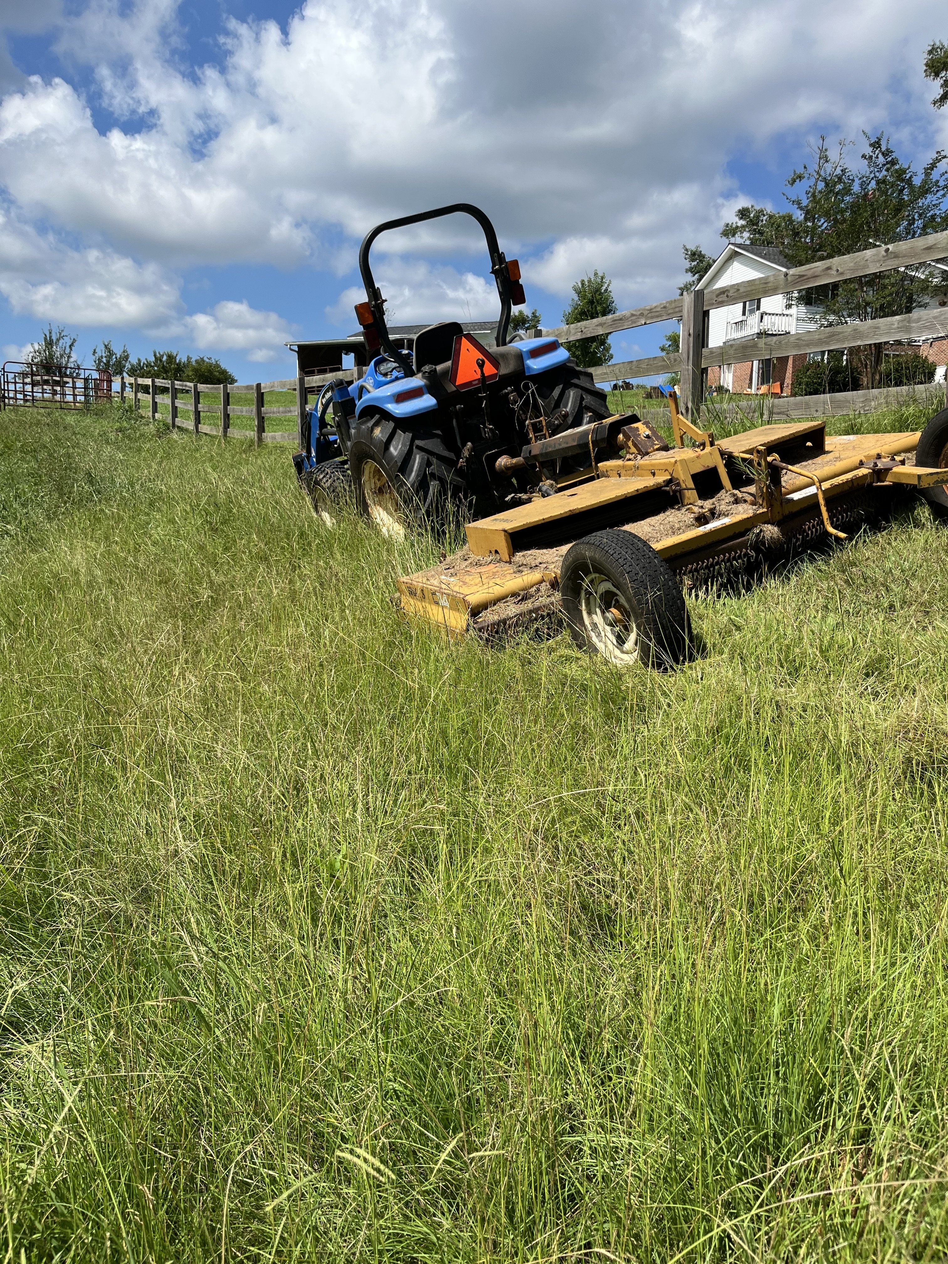

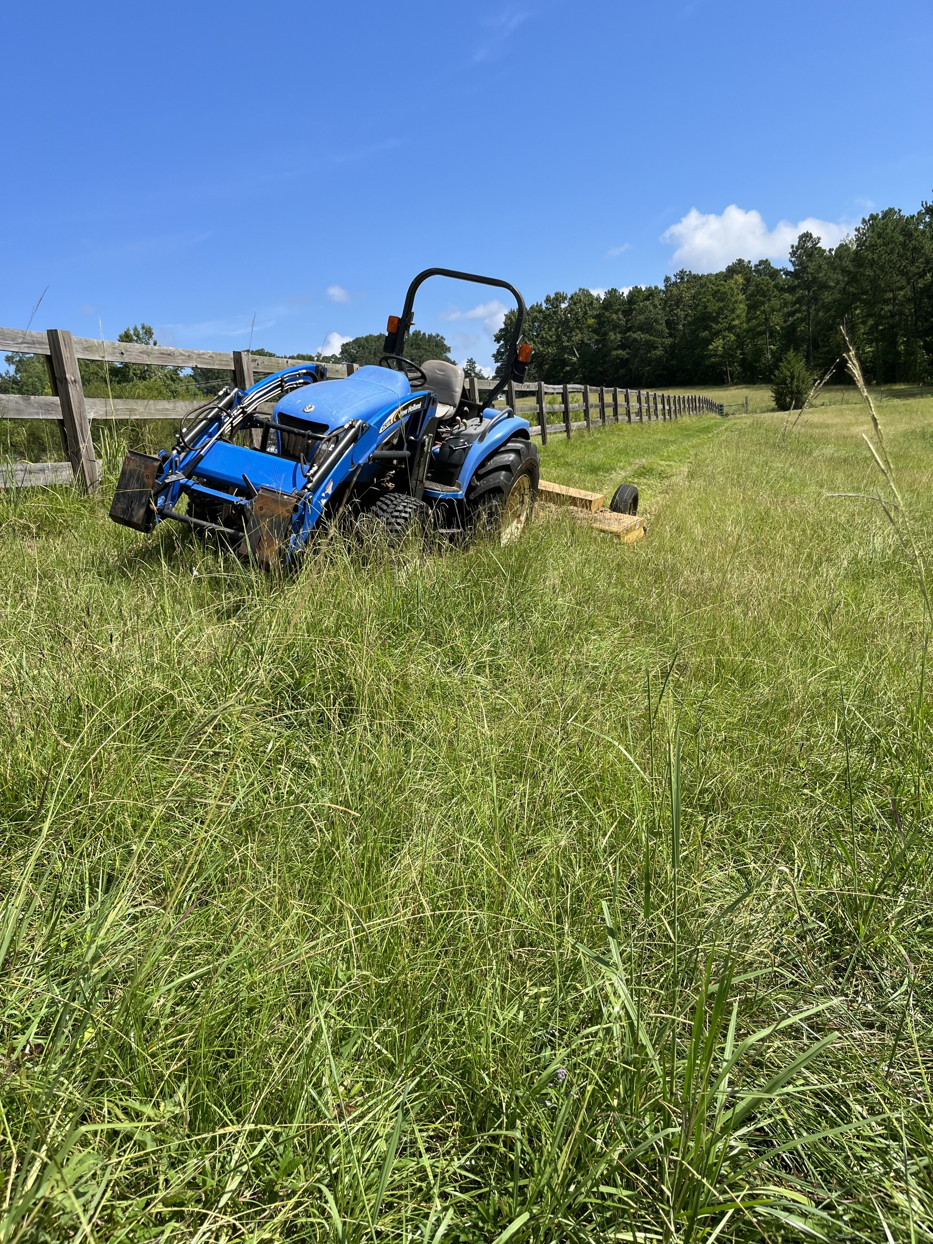

Side hilling on 25 degree slope for me is no problem even though I don’t like doing it by my pond even though I have to.
I wouldn’t do it if it is wet because of the potential for sliding sideways it the water.

Any moisture can cause tires to loose traction on a hillside. I tend to do our hillside mowing in the fall when it is the driest. The spring is a no-go for me because I've found that the moisture in the ground after the winter means that the turf can shear away from under the tires.
