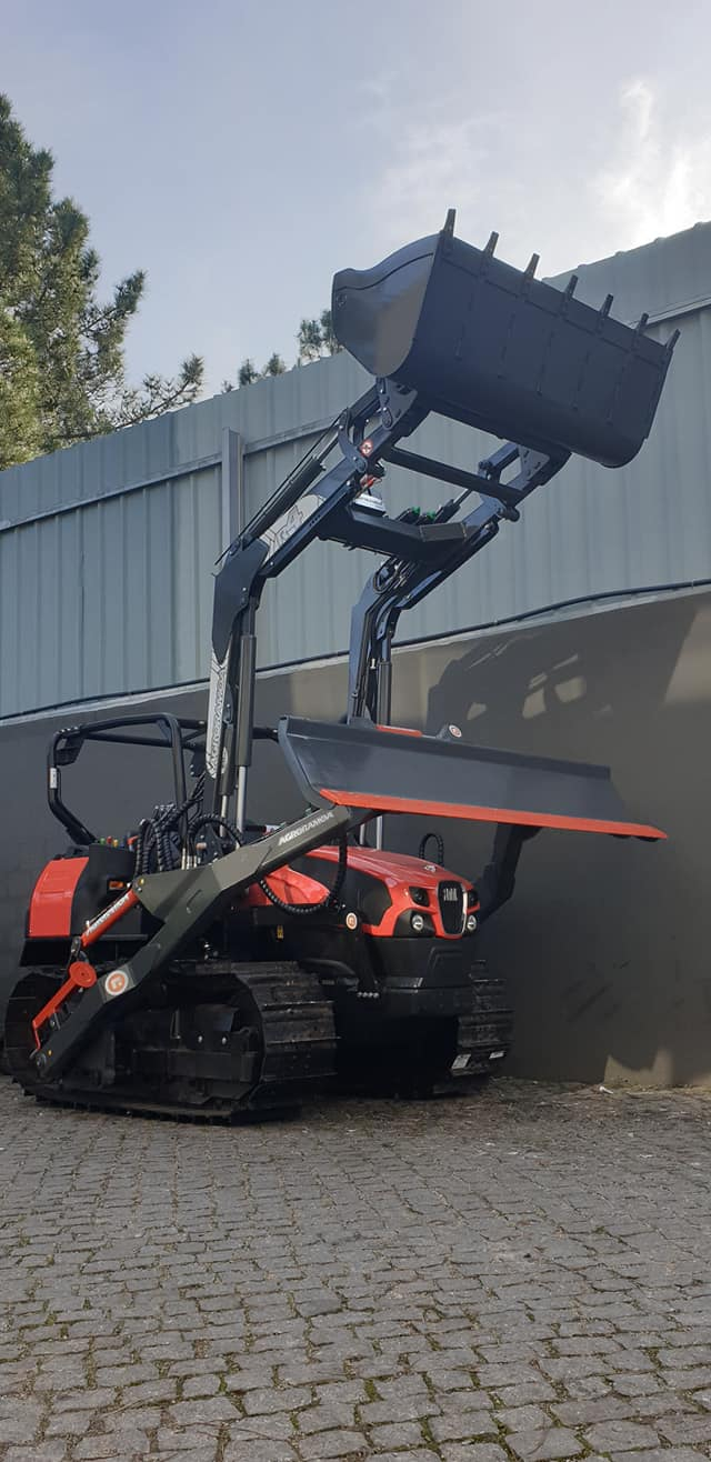

Just get a crawler tractor. That will put an end to the 2wd vs 4wd debate. šŸ™ƒ
