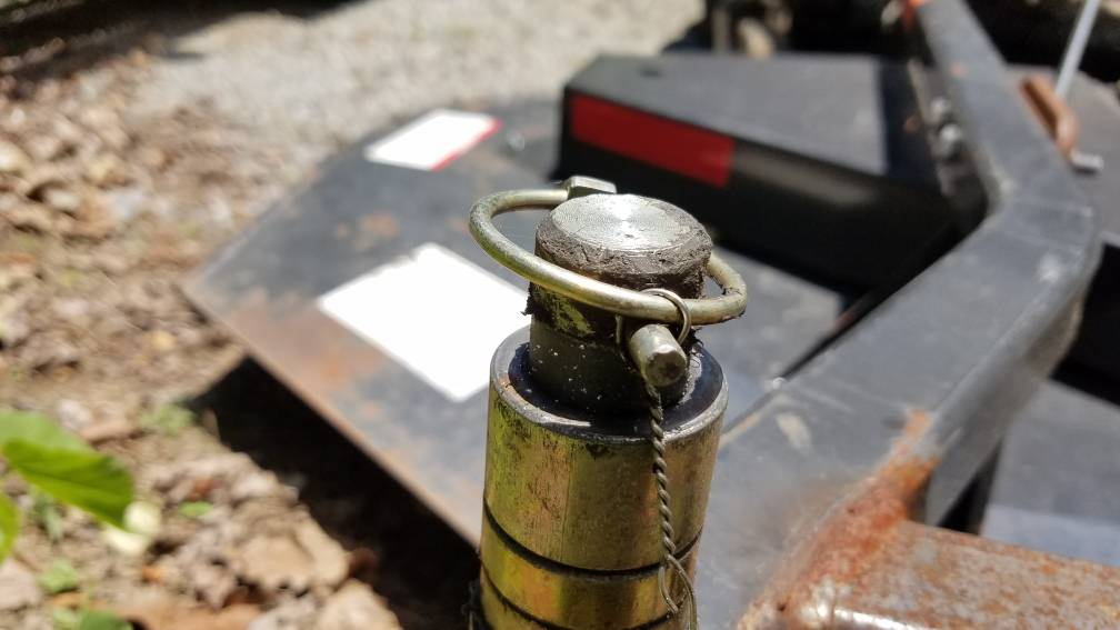

I kept losing them on my 3 point mower wheels and trying to find the spacers got old quick. A careful loop and twist of safety wire fixed my issue so they can't open. For something that you constantly remove, probably not the best idea though.
I have some baling wire, I'll try that too!

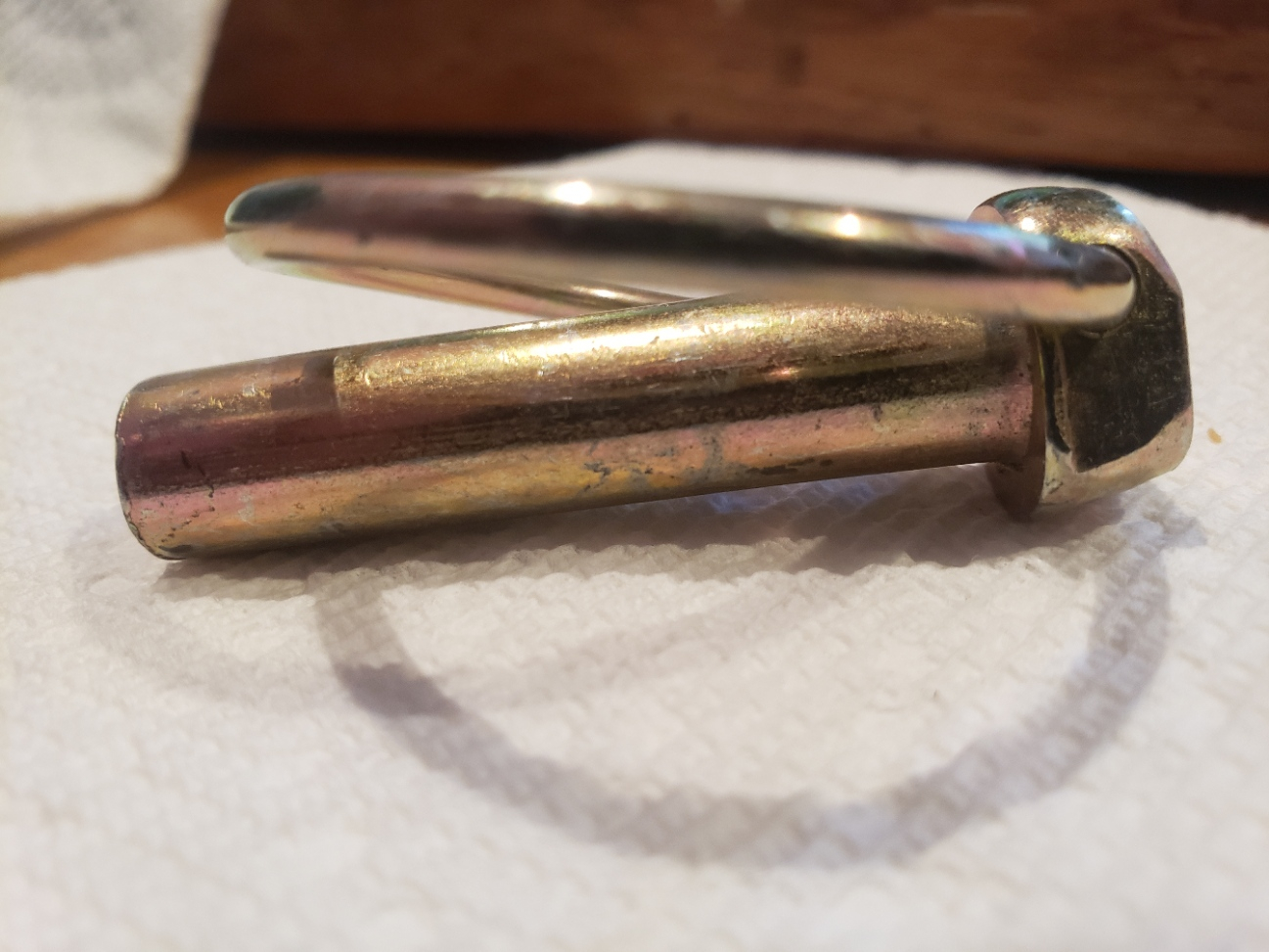

This is one of the failed pins. Pretty obvious what the issue is :-(
   / Lynch Pins Coming Off #48
Some types of these pins are not symmetrical. They close with more force and more completely in one direction. In the other direction they don't have as much force and don't close all the way.
   / Lynch Pins Coming Off #49
That was the only direction it would even come close to closing. I got the new ones and they close with some force like they should.

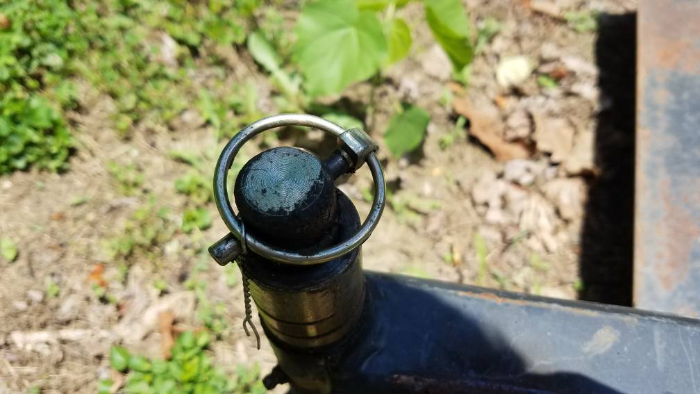

   / Lynch Pins Coming Off #54
I finally got the bail to move over. Don't trust it as it had something stuck in there :-0
