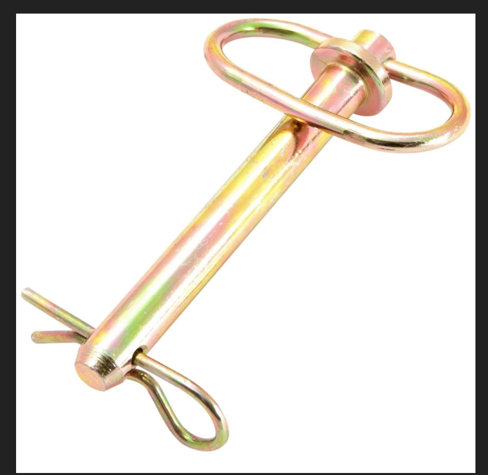

Is there anything more secure than this style of Lynch pin to the lower lift arms?
I keep losing them while brush hogging. I'm thinking about using a bolt and nyloc nut, but that would be a pain.
I buy the black lynch pins. They have a lot stronger lock ring. A little more expensive but well worth it. I get them at tractor supply.

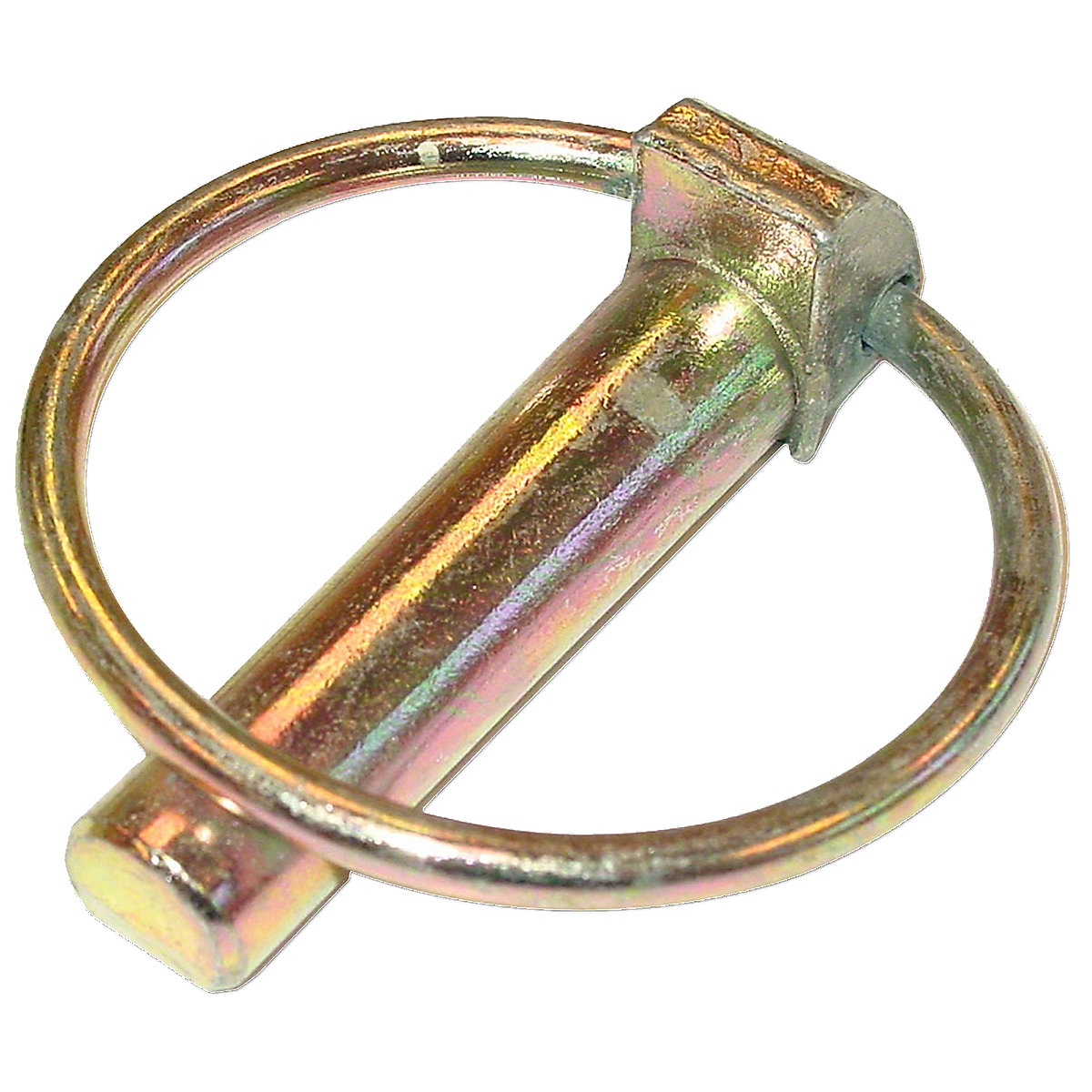

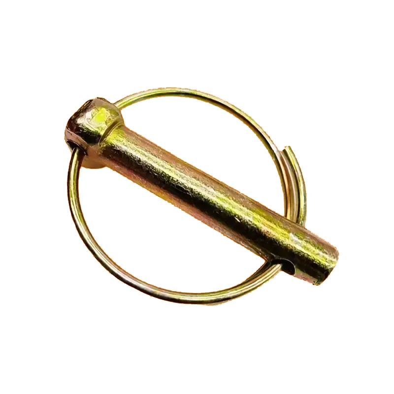

There IS...it's a locking type of Lynch pin. Sorry I don't have a photo. If you use "regular" Lynch pins, orient the pin so that the weeds/grass can't easily grab onto the loop when traveling forward. On that locking style, the loop part has to be squeezed before it can be rotated/released.

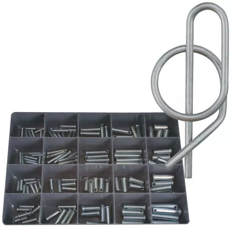

Perhaps in this specific situation, a pivot pin would be less likely to fall out? They come in all shapes and sizes.
There's also these crazy doo-dads, but I've not a clue what to call them:
That squigly one is called a "Rue pin" or a "ring cotter pin"
I bought some about a decade ago. They work really well if you can remember how to use them.

This is one style of a guard to help keep the pin protected.
Another style (pinis inserted the wrong way in this picture )
