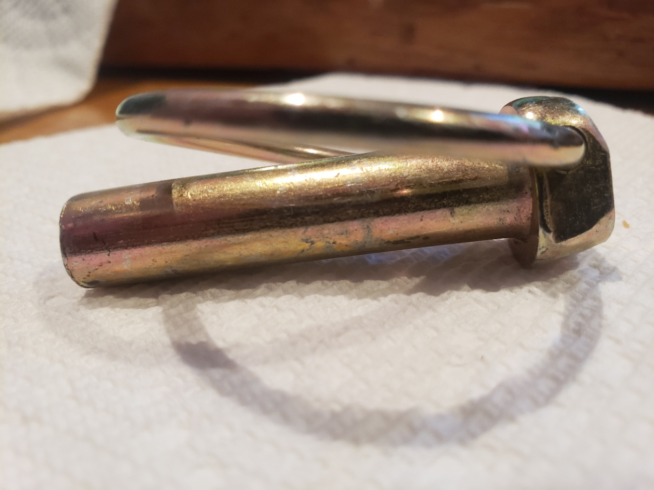

There are several posts about this but not many recently so a new day means new ideas. When I brush hog a different lynch pin falls off nearly every time. I've brush hogged five times in the last two months and have lost four lynch pins.
Facts: I do have a lot of overgrown weeds and saplings and I do use the HD black lynch pins.
My question is how do I keep them from coming off? I don't care about losing them so much as I do about tearing up my equipment. Chaining them to somewhere on the tractor just keeps me from losing the pin but it doesn't stop the inevitable damage from the pin coming out. Is there a better more secure pin out there other than a bolt and nut? Duct tape? Key rings? Thanks in advance for any and all suggestions.
Drill a hole through the pin and put in a cotter pin. Or take some binding wire and wire the ring down.

I do the same deal (search through the bins at the tractor store or TSC for ones with more spring closing pressure) but there is a drawback to them and that is, the ones with more spring pressure are also finger smashers if you happen to have a digit in the wrong place at the wrong time. Been there, did that and it hurts, they seem to like to smash down on the end of your finger.....lol
I've only lost a couple over the years but I keep extras in each tool box on the tractors and implements.
A lot of good ideas;. You said you use the HD pins. A good friend of mine had the same problem and the HD pins do not work. He place a a Yale padlock with a long hook instead of a pin. While it looks strange, A locked padlock is not coming off without a key.

I am amazed that some have never had a click pin fall out. I run into some heavy brush, including stick and saplings, and even zip ties over the click pons are not foolproof. I use double butted bolts instead of pins for my main lift arms on the bush hog now (8', dual spindle) and that works. I use bolts and nylon locknuts on the tail wheels. I still have to use zip ties on click pins for some equipment.

New to tractoring but I see this as a real problem. Now I’m wondering if a grade 8 bolt and a nut/jam nut would solve the problem. I don’t see where this would take longer than tape, zip ties or wire.
In the great scheme of things, it doesn’t seem like it would take that much more time.

A couple of things to try: Cut a piece of metal pipe to make a bushing to reduce the slack/play between the equipment frame and the lift arm. If you reduce this space so that the linch pin fits snugly beteeen the lift arm and the hole in your draw pin, that may fix the issue. The attached implement can move around enough to shear or dislodge your linch pin. A weak spring action in the pin could also cause it to come off.
See photo below for a hairpin cotter. Get the largest one that will fit in the drawpin hole and use those.
Both options are low cost and can keep the equipment secure. This could also prevent ruining a rear tire or breaking a top link (have had this to happen) if the equipment pitches off too far to one side.
