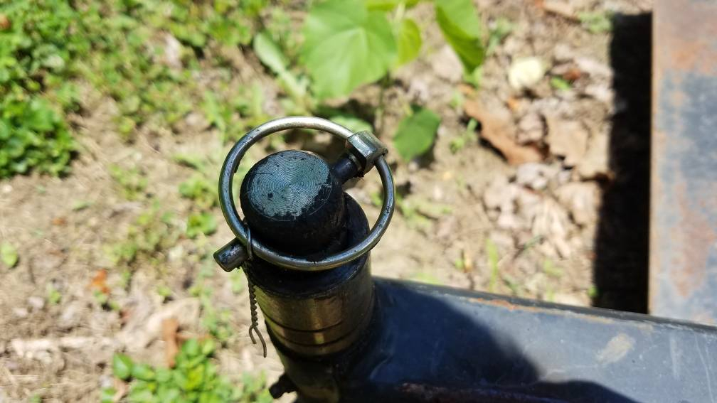

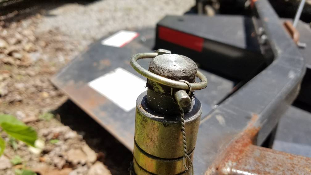

Mine were doing that on my rear finish mower, found out that they had too much slack on the shaft between the post and the pin, I installed a spring and a washer to keep the linchpins from rolling sideways which was a lot easier for them to come off and I haven’t haven’t had another problem Since doing that, been good for about 10 years now with no lost pins. I can take a picture later of what I’m talking about if you would like.
Yes, a picture would be great. Thank you!

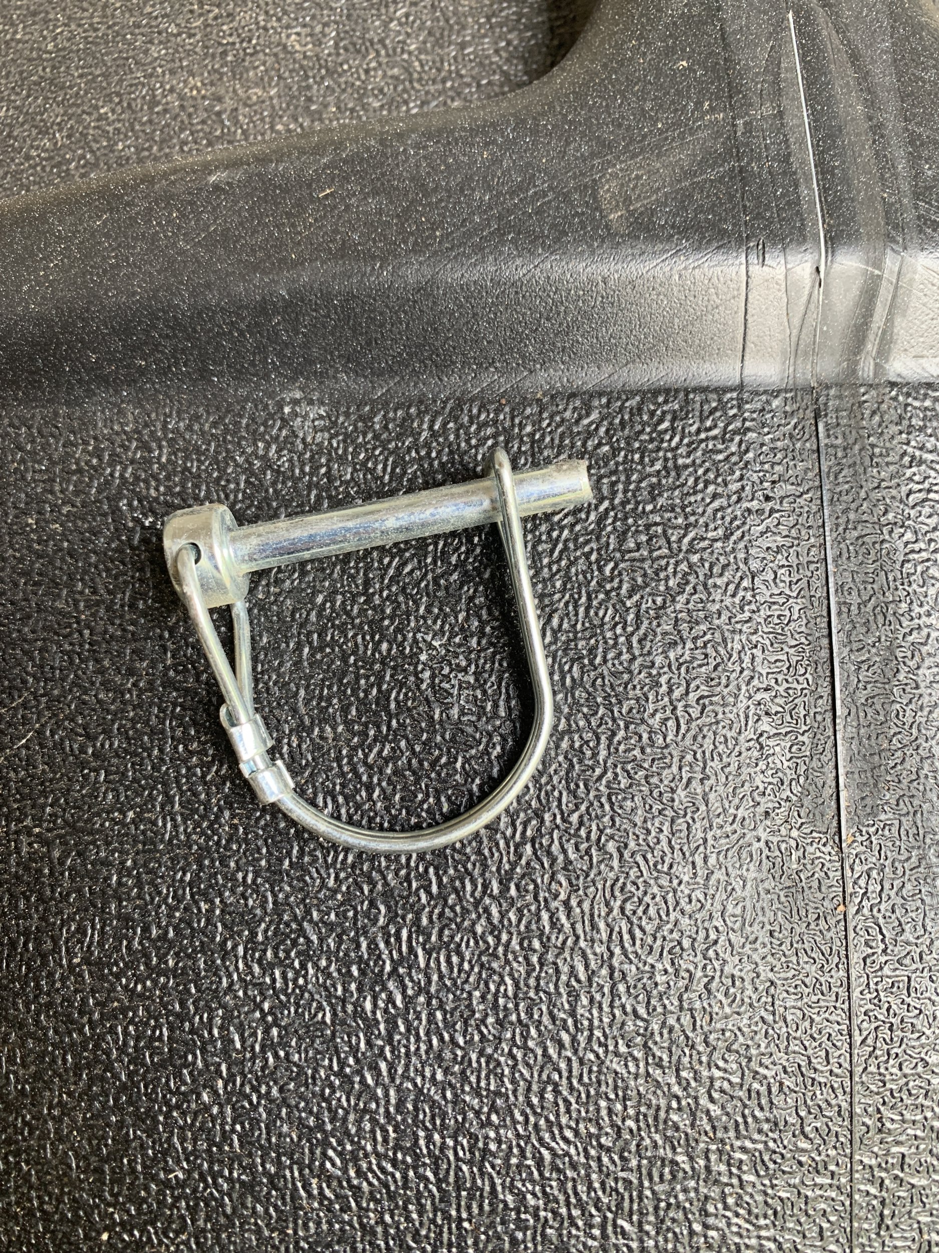

I went to a different type of pin. See pics. Available in a lot of sizes

Before applying the springs the pins would rotate on their axis which made it very easy for them to come off now they have tension and stay flat or horizontal and have never lost another pin sence, hope this makes sense.
