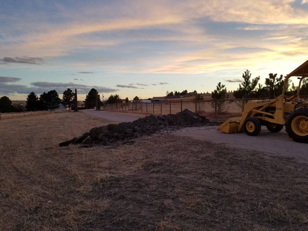

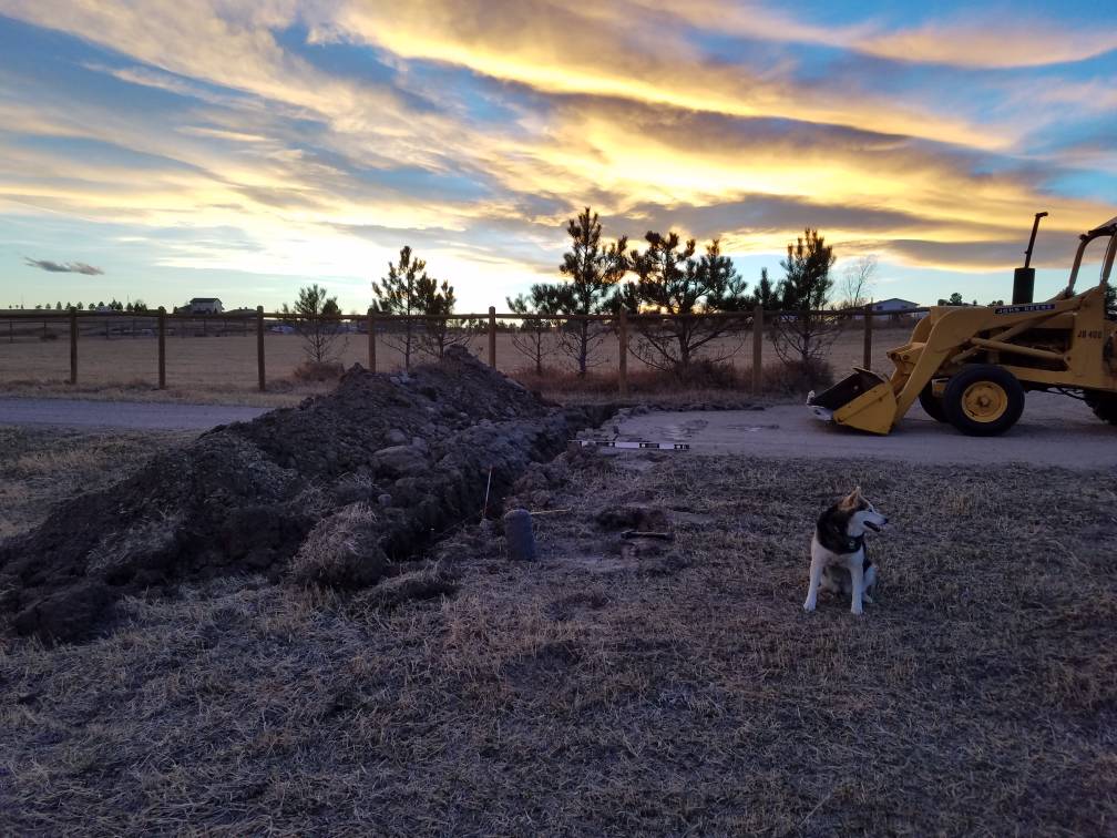

Borrowed a friend's backhoe for a couple projects 2 weeks ago & dug a trench across the driveway just before it had to go home. Trench us to deep (kind of by design). I finally picked up the required 25' of culvert yesterday. 12" double wall corrugated outside smooth inside stuff.
How well do I have to worry about tamping under & around the culvert? It's going to be snowy & muddy for the next week or 2, so good tamping really won't be possible. And the trench is slowly starting to cave in, especially with the moisture. 3' trench, 1' of culvert & generally you need 1' over the culvert, so I need to backfill a foot or so.
Not to worried about settling causing a dip as I have a box blade & maintain the driveway regularly. Not to mention needing to dump more gravel on it this summer or fall.
I'm mostly worried about the culvert crushing before stuff settles or it getting really out of kilter.
Can I skimp on tamping because of the mud? Should I wait for it to dry out a bit in a few weeks & manually re-excivate the trench as needed & tamp by hand? We can drive around for now, but it's tearing up the grass a bit.
I do need to re-grade the exit side of the trench smoother & a bit deeper a but should be able to do that with the box blade after the culver is in & leveled just past plumb so water will flow.

It being a gravel drive will be much more forgiving than if the surface was paved. Cheat the compaction if you'd like and just recognize that you'll have to fill in with some gravel a few years down the road.
Looks like your culvert is set a bit deep, unless you have plans to do a lot of digging at either end.

Thanks. Ya, the trench is to deep, need to back fill a bit & clear out & taper the inlet & outlet a bit. Need to re-grade the driveway up the shop (hidden behind the hoe) too. It currently tilts away from the culvert a bit.

I'll see if it's decent enough to work on after work. Back fill the little bit I need & tamp that a bit. Thinking I'll use some of the pile of pea gravel I have left to bed it in a little bit. That will pack in without being tamped. Either dump some dirty sand on that to lock it in or just use the pile of dirt & drive over with the tractor to tamp the top.
It's not going to get a lot of flow, especially until I re-grade my other section of driveway (it will just continue eroding the wrong side of that driveway branch & dumping sediment in my main driveway about where the other end of the backhoe you couldn't see in the photos was parked.
