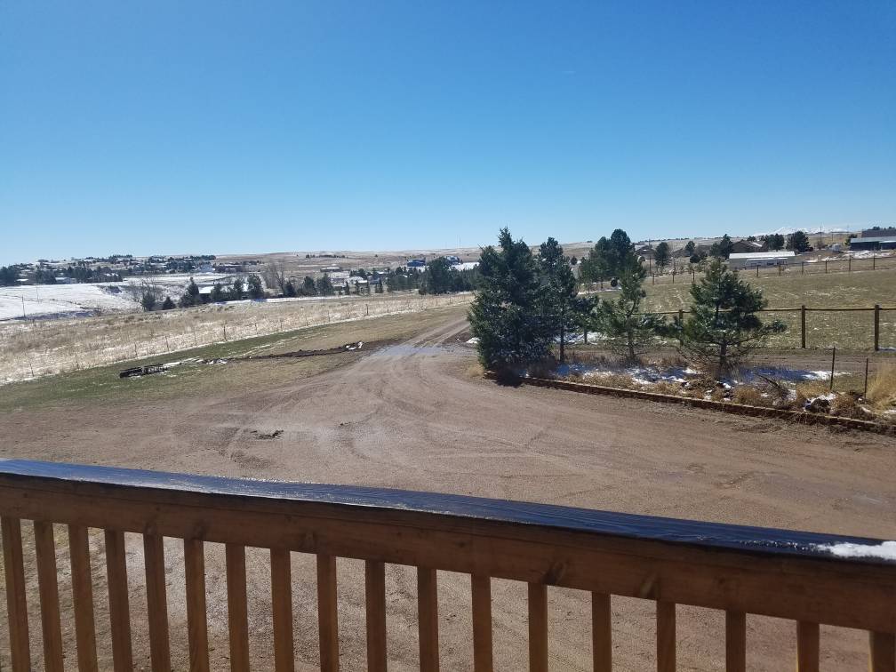

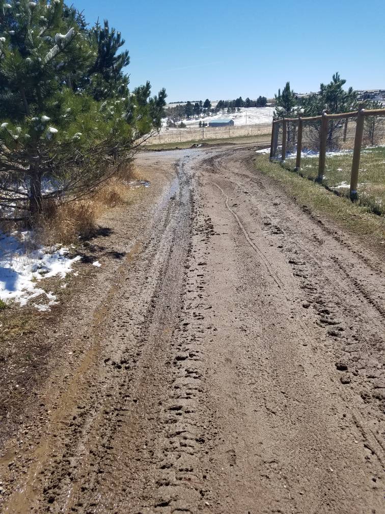

Well it's in, burried & driveable. The 2 buckets of pea gravel made for easy packing around the pipe & not really any tamping. I tamped by for & tire in 6" lifts or so over the top. I failed to crush the pipe driving over it with only 6" of cover.
I'm sure it will be settling for a few years, but I grade the driveway a couple times a year anyway. Need to get a couple truck loads of gravel on it anyway. Also need to sculpt the inlet & outlet a bit. Also re-grade my shop driveway & get water running down the other side & towards the new culvert.
Will try & get photos in the morning if it's not snowing.

Excellent. Yes, the use of pea gravel will minimize need for packing and will give a uniform amount of pressure on the culvert. I've buried many with less than 12" of cover and with any consideration they holdup to immediate traffic with no failures. Congrats on a successful install. :)

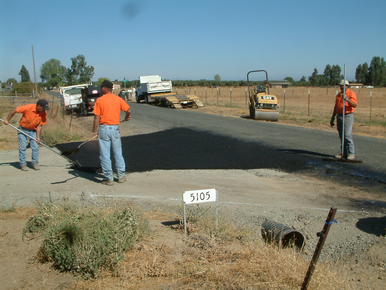

Here's how mine was installed in April 2005. Professional job. No problems.
   / How much tamping required for a culvert? #28
/QUOTE]
Excellent!!! I want to pave my driveway so bad...... :)
