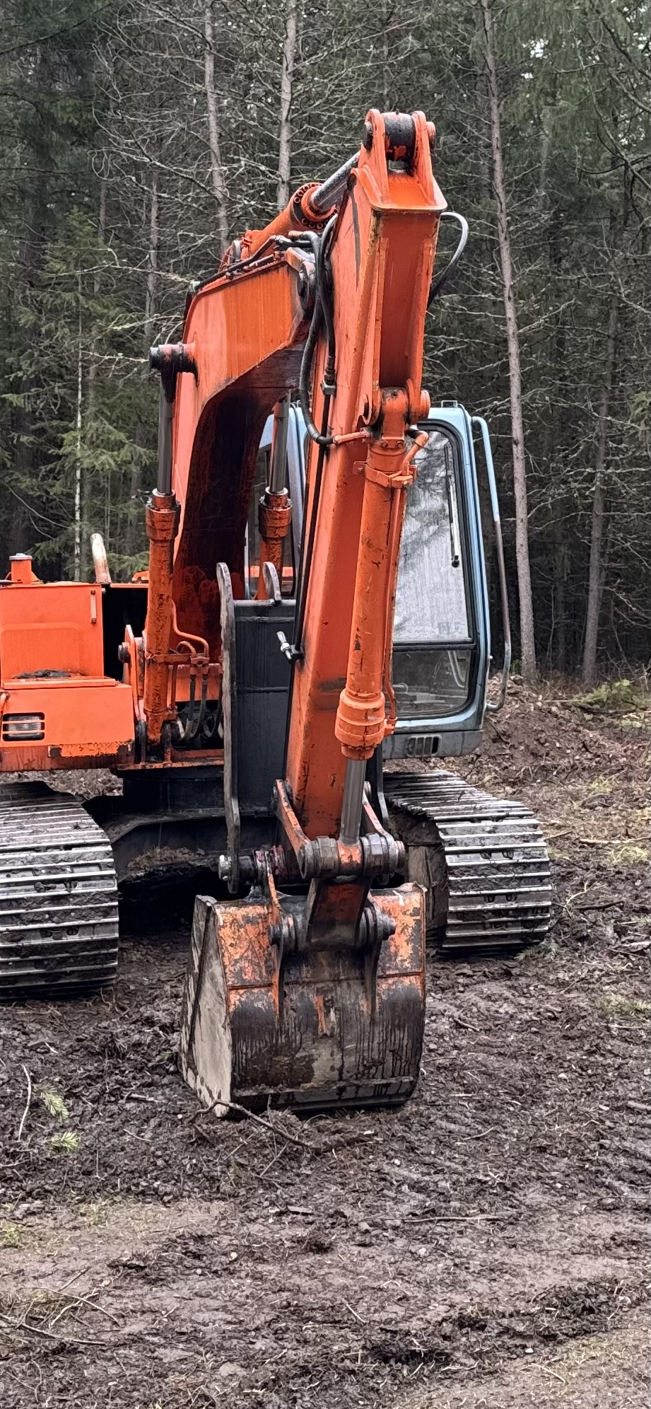

I’m very happy with my grey market hitachi ex100. 3500 hours. Bought for 26.5 K. Had worn bucket pin/bushings that I repaired for under 1K.
Owner was known by a friend and an experienced mechanic had recently gone through the machine.
Using it on 20 acres for land prep to build, removes 30” trunk trees easily. Will lift around 7K pounds. It’s my mistress now, not selling.
