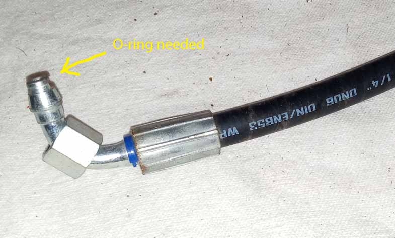

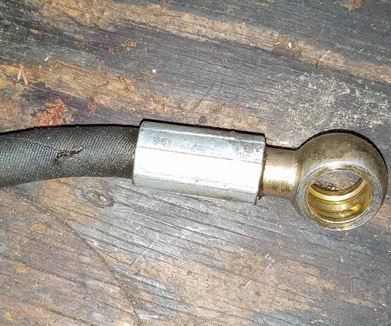

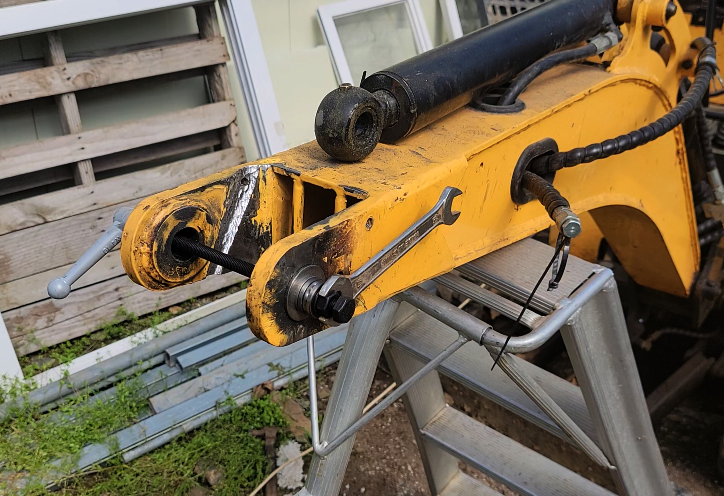

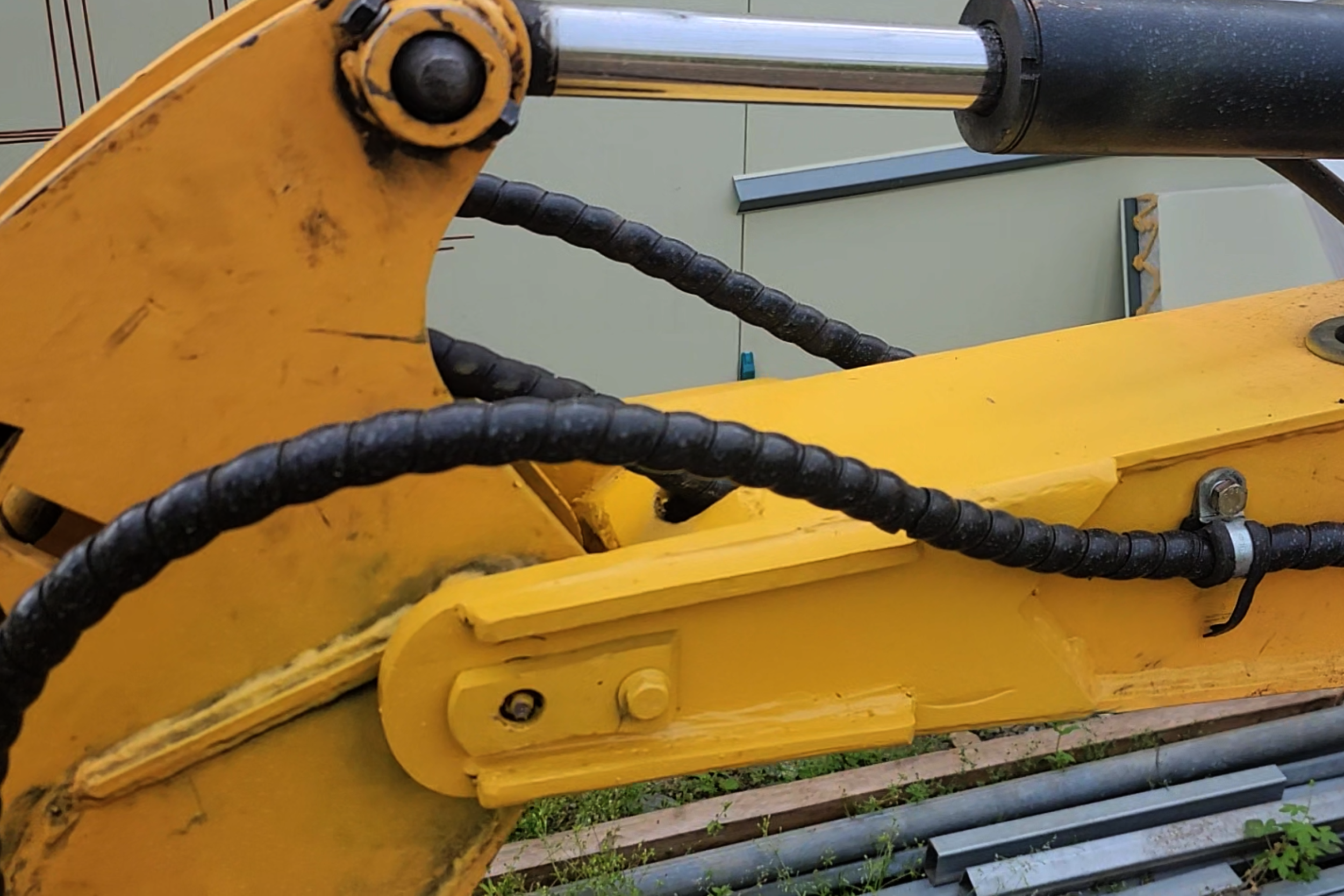

Here I had to replace one of the blade cylinder hoses. Fortunately, I had a spare, but it was longer; a bit too long. The original hose gets pulled pretty tightly when the blade is fully down, and that pinched a small rock under the hose. Now, the new hose sticks out further to the side, which is also not ideal. Hose length is important! Now I have a protection plate.

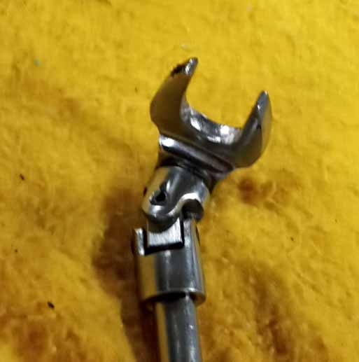

If the tracks are on, the connection for this hose is very hard to access. I used this 17mm crows foot wrench that I ground down to fit. If your tracks are off, it would be good to check this hose for tightness.
If you buy hoses with metric (DIN light) crimps, make sure your O-rings are there and in good shape, I had to get new O-rings for mine.

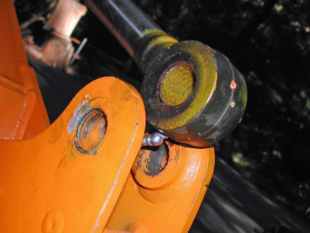

Here is another repair I did years ago. When my mini was new, I found one of the grease zerks did not take grease. I checked the zerk, which was fine, but the plain bearing insert grease hole did not align. So I removed the zerk, drilled thru the bearing insert, and reinstalled the zerk.. In this photo, I show how I changed from needle greaser fittings to zerks, plus I rotated the rod cross-tube so the zerk was underneath, and protected.
BTW, these yellow replaceable bearing inserts look just like the ones on my JD 4300 tractor. Nice.

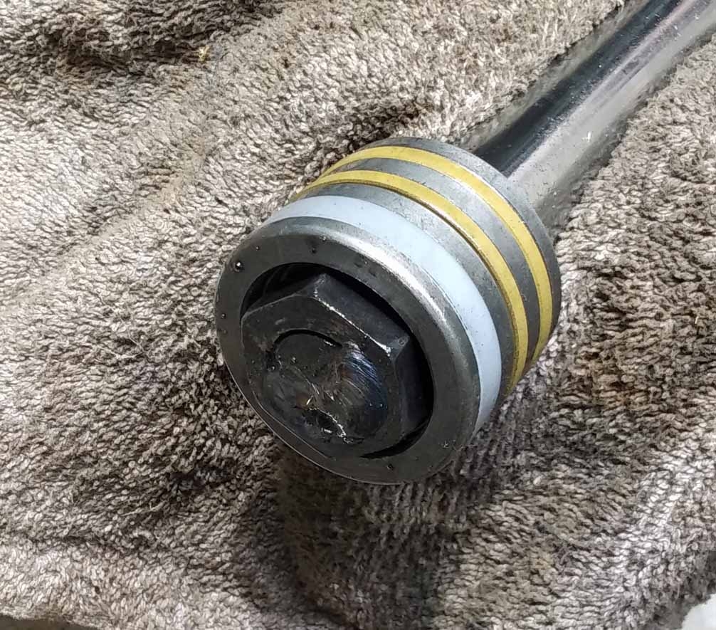

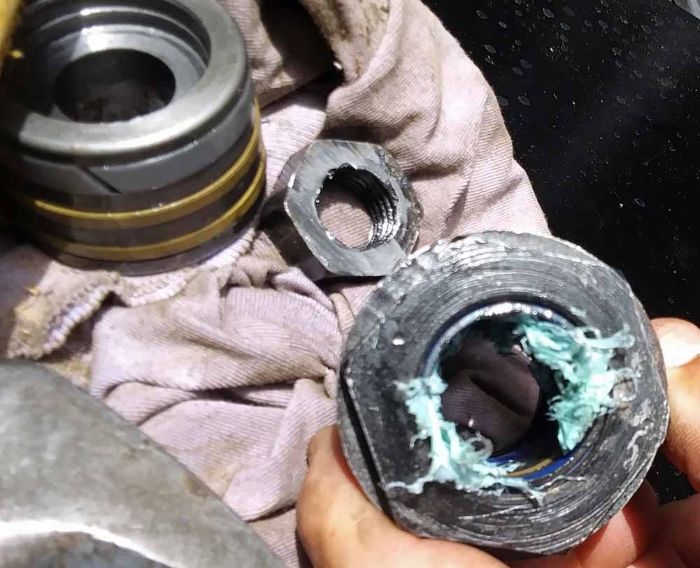

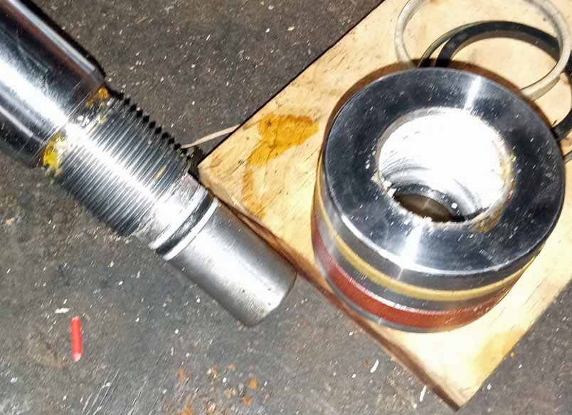

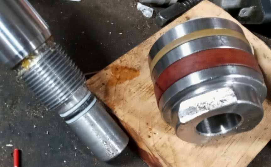

These next 2 repairs involve hydraulic cylinders. Overall, I am impressed with the quality of materials used, and both repairs were not due to poor assembly, construction, or materials. The rod finish does not rust readily, as often occurs with lesser units.
When the container of 6 black 1T minis came from Ouke via Alibaba in 2017, the shipper wrapped them with a bunch of that clear plastic film that is often used with palletized goods in warehouses. I don't have Before pix, but one of the units had some film tightly wrapped around one of the cylinder rods. Then the cylinder was operated and the film got pulled into the gland.
To fix it, I had to disassemble the cylinder.
I have done many different kinds of cylinders. This one uses a retaining ring, like a lot of JD loaders. It came apart easily, but the piston nut was welded on!. I have never seen that before.
The piston uses dual cup seals and a rub-ring, which were in perfect shape.

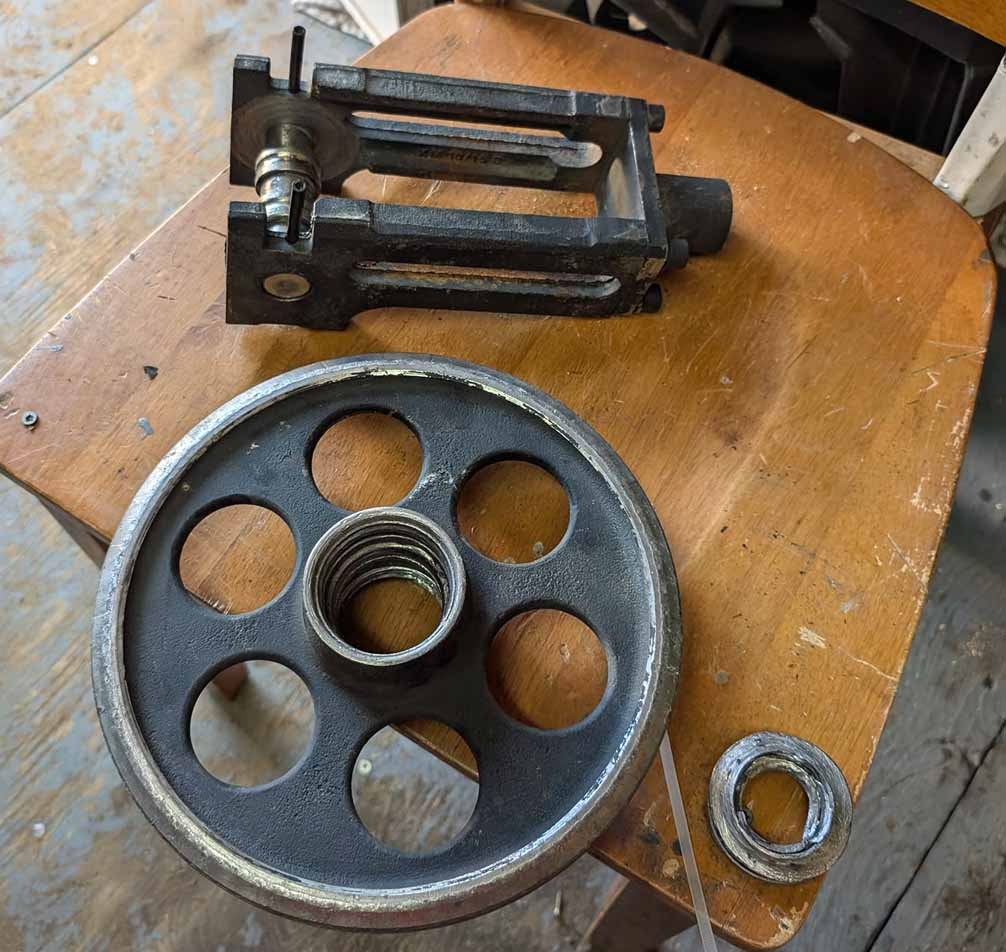

Other than the warranty repairs I did in the first year of ownership of my XN08, this is the first repair I did:
My bucket cylinder rod had a small ding in it, probably from shipping or handling. After 20h of use or so, the drip was more than I could live with. So I swapped out the cylinder in the field with one of my spares, and put the leaky one on the shelf for later.
A few years later, I took it apart and fixed it with a new gland-to-rod seal I bought on eBay, shipped from China. Less than $10 total, BTW.
Some surprising things about this cylinder: The gland unscrewed like most cylinders, but the piston was internally threaded instead of having a nut.
The piston had dual flat spots for gripping. I used a 24" adjustable wrench with a 3-foot cheater pipe, and it eventually surrendered. I had to put a bar through the cross-tube and drive the tractor on top of it. The maker had used thread-locker.
The maker also used a piston-to-rod seal, Glad I did not resort to heat to get that piston off.
Everything looks well-made with rub rings inside gland and on the piston.
I love the Chinese seals that have the metric sizes printed right on them. Easiest seal purchase I have ever had.
BTW, the maker of my mini quoted me $50 total for a full set of seals for all 4 cylinders, shipped via air. I forgot to buy those spares in advance with the XN08, and had no easy way to pay them, so I did not buy.

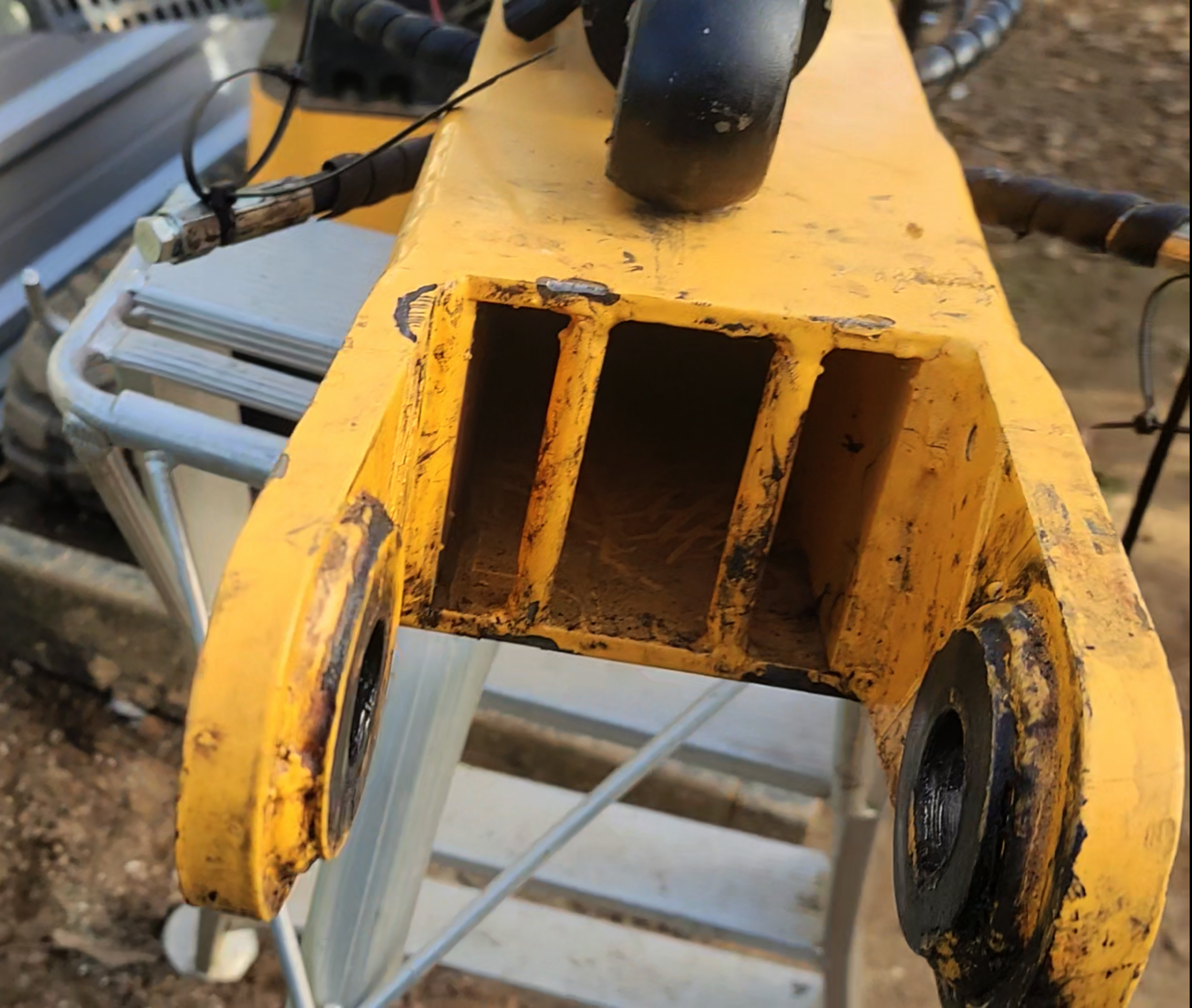

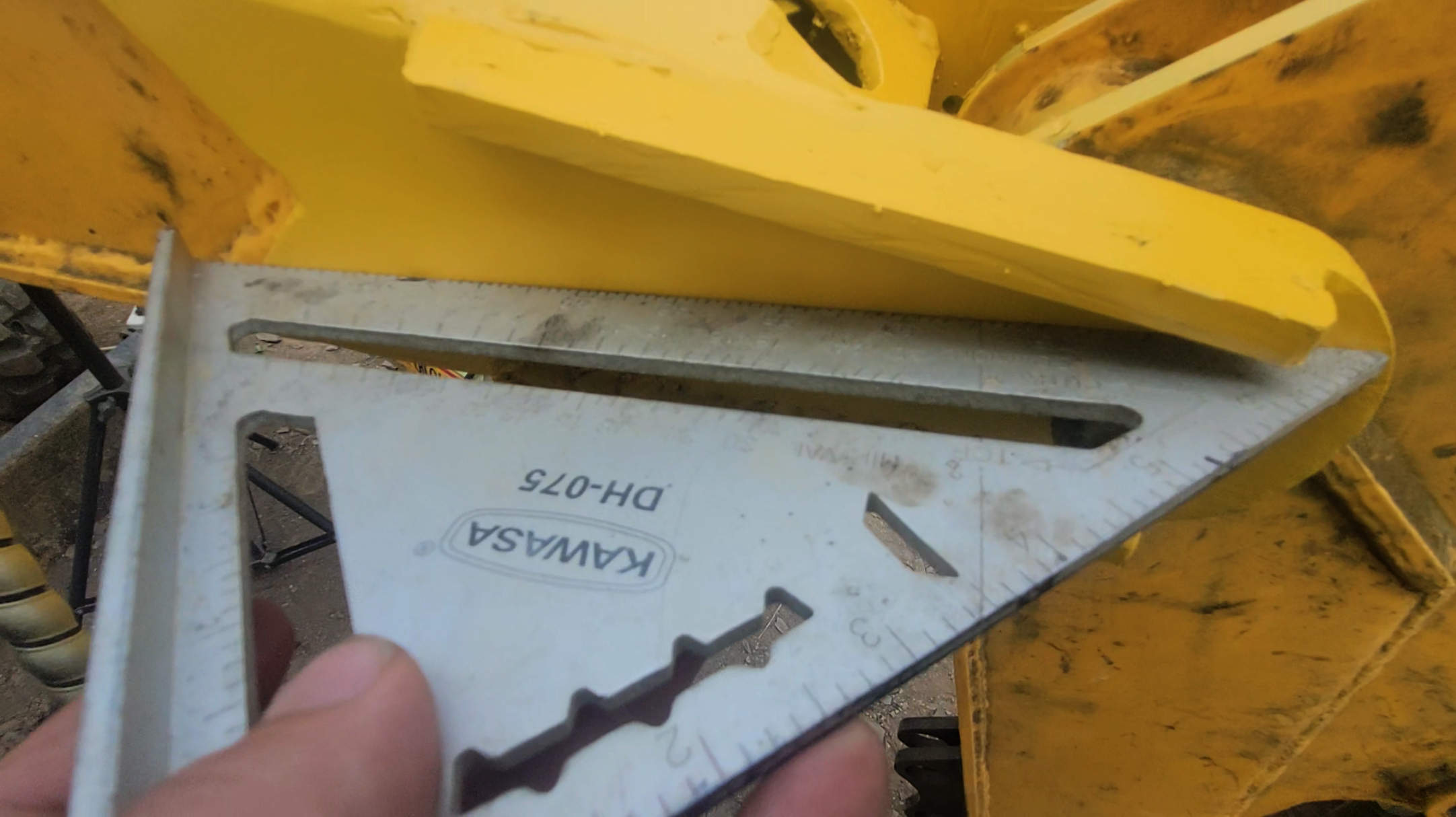

One of the brackets connecting the boom and arm has bent. The pin shaft broke and flew off somewhere.
If you compare it with major mini excavators, you can see the difference. They have wedge-shaped reinforcement structures welded between the brackets.

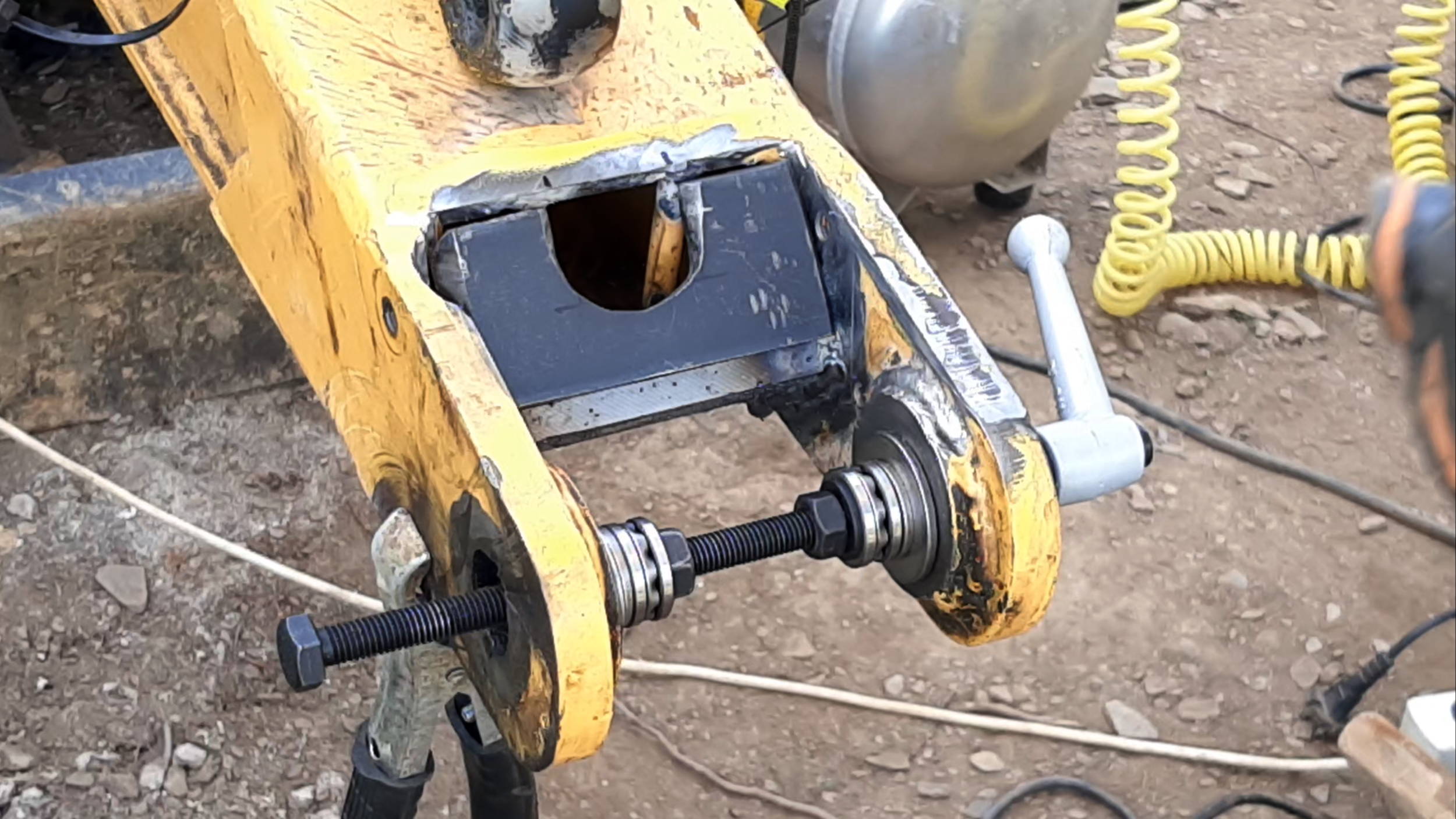

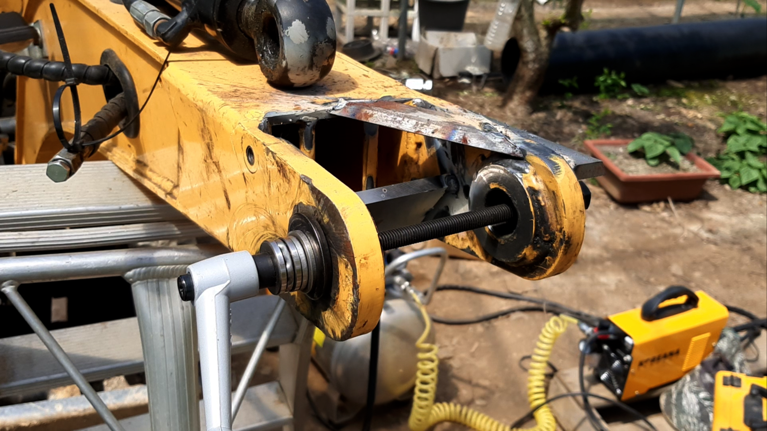

I decided to grind down the elongated part and align the gap between the two brackets.
First, I welded a reinforcement structure to the bracket that had no deformation and then used a bearing puller to straighten the bent bracket.
After aligning, I reversed the bearing puller to prevent excessive shrinkage during welding.
After welding the wedge-shaped reinforcement structure, I also reinforced the outside of the bracket.
Honestly, I didn't expect this part to fail, but fortunately, the bent part straightened out well, and the repair was completed successfully.
I plan to reinforce the kingpost as well, as it is very poorly made and might break soon.

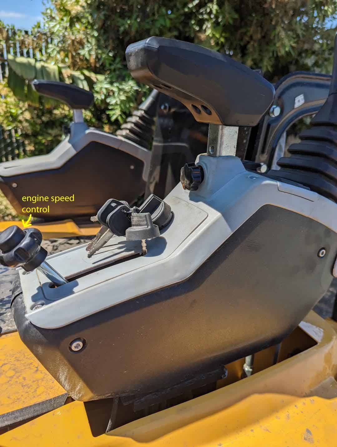

I was doing the spring upgrade to a Diggit EM15 the other day, and I noticed this problem with the engine speed control lever.
This is the same unit seen on virtually all of the 1-ton-ish Chinese minis, with the push button in the middle.
I see that water easily gets in, and pools inside, rusting the spring. Both the button and outer handle thread on separately. What's the repair? Take it apart, grease the threaded parts, and put a big dollop of grease in the recess where the spring goes. One could even drill a hole in the outer part of the handle so water drains out.
Then, keep your machine out of the rain, and protect the throttle control if washing it.
So far, my 7yo XN08 has had fewer repairs than modifications.

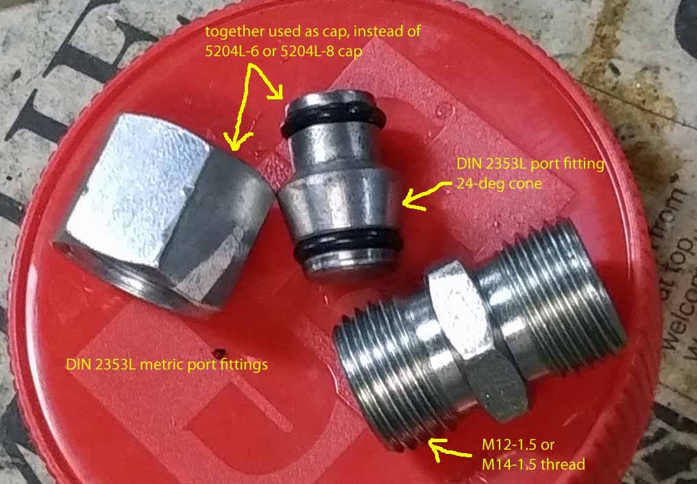

I recently picked up a hydraulic test kit thinking of checking and adjusting my TT-17's relief valve. The kit comes with metric adapters but they are not DIN style that the excavator hoses are. What adapter is it and does anyone have a source for a 14M test female(or 3/8 or other combination) by 14M Din male? I see several videos where people hook up their gauges to boom hoses but none of them tell where they get the fittings to do so. Test fittings are flat faced with a O-ring above the threaded portion whereas DIN are a insert seal.
I searched repeatedly online and never seemed to find such a fitting. Thanks if anyone has a answer.
/ small Chinese Excavator repairs
#20
I suppose I am guilty. Here is why:
When I got my first machine and posted that video back in 2018 or -19, I just welded up a NPT-to-DIN 2353L port to connect my gauge to the hose connector on the dipper.
Since then, I encountered different size hoses for the AUX, either M12 or M14 (-6 or -8).
DHH does not have an adapter for NPT to DIN 2353L port. Most gauges are 1/8 or 1/4 NPT. In your kit, maybe not.
So, I suggest you go with a DHH 9624 JICF to DIN 2353 and adapt the JIC to your gauge:
These adapters are very expensive, so welding one up for occasional use should be considered.
Attached pix show what I got for the AUX connection on the dipper on my minis.
