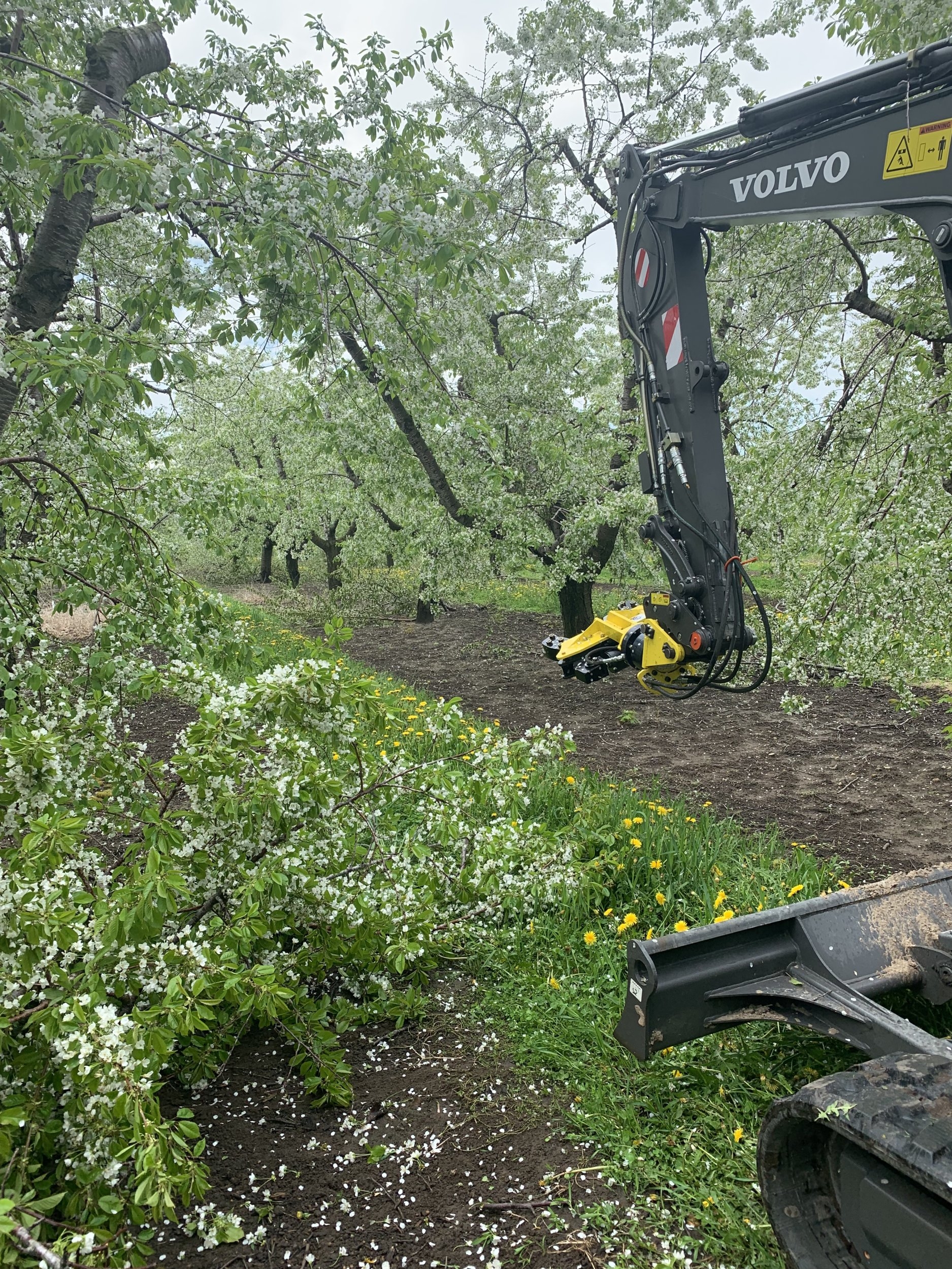

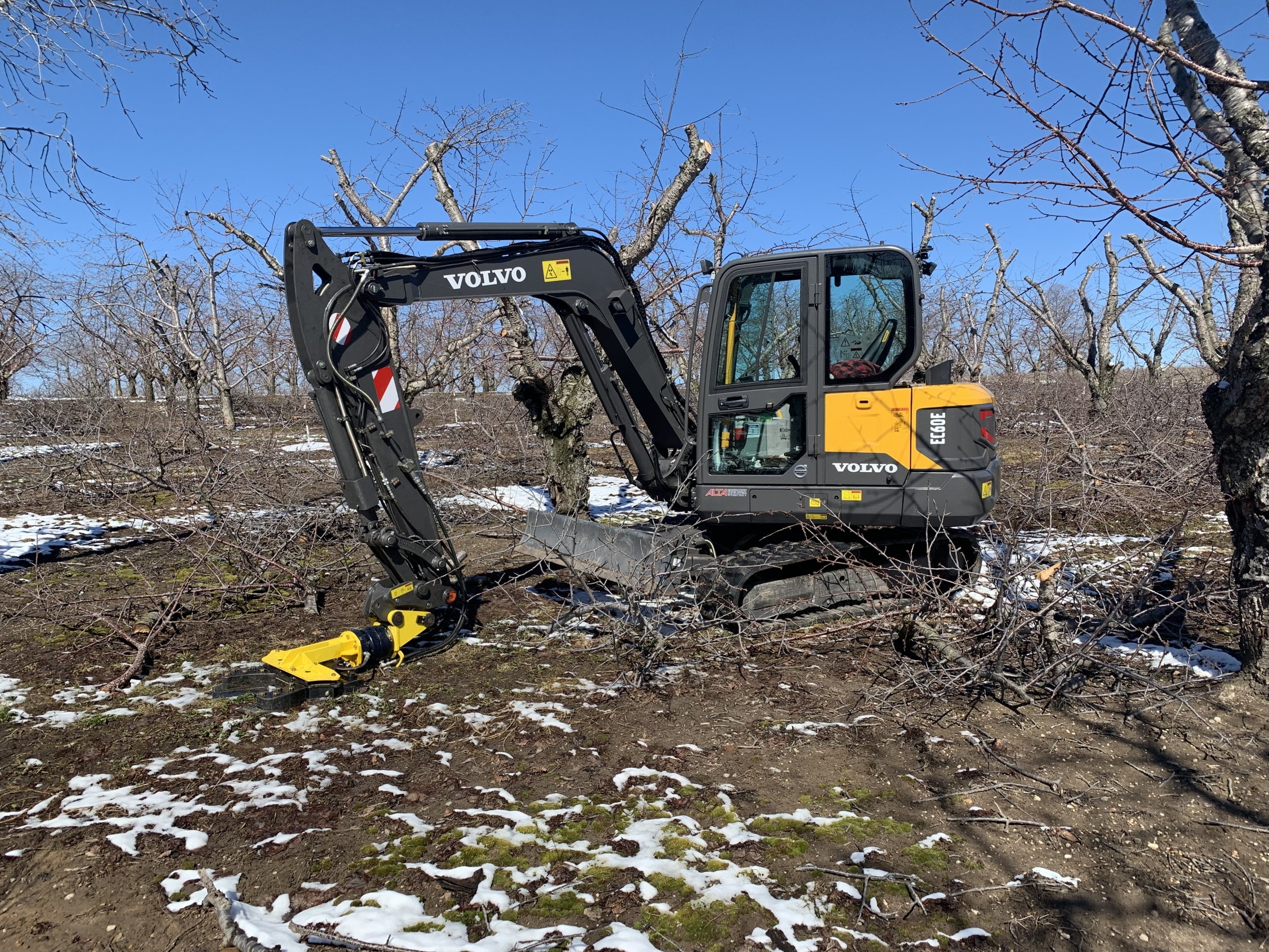

I’ve got quite a few hours operating a mini ex shear mostly in my orchard. My need was to reduce the size of some older overgrown sweet cherry trees that had reached 25-30ft down to a max height of about 20’. With limb diameter generally in the 3-6” range a pole saw wasn’t going to work and at 20’ out of reach of my Stihl power pruner.
The shear needed to be compact , maneuverable and able to make flush thinning cuts inside the tree canopy as well as the height limiting heading cuts. A shear with a grab as most have would be too bulky and cause collateral damage inside the canopy. Nothing was available to fit my needs so I designed and built my own.
I bought a M&M hydronip 8” capacity shear head only and a AVS rotator capabile of radial loads. Designed and built the framework to combine the two along with the pin mount. Worked excellent for my needs.
I think for what you’re wanting to do a shear with the grab would work. 360 rotation is a big plus but adds quite a increase in price and you need dual auxiliary hydraulic circuits.
JB equipment a UK company makes quite a nice selection of shears. I’ve never seen one up close but they appear to be quality and even with the rotator added very competitive on price.
Here’s a couple pics of my home built unit in some sweet cherry 🍒 trees.

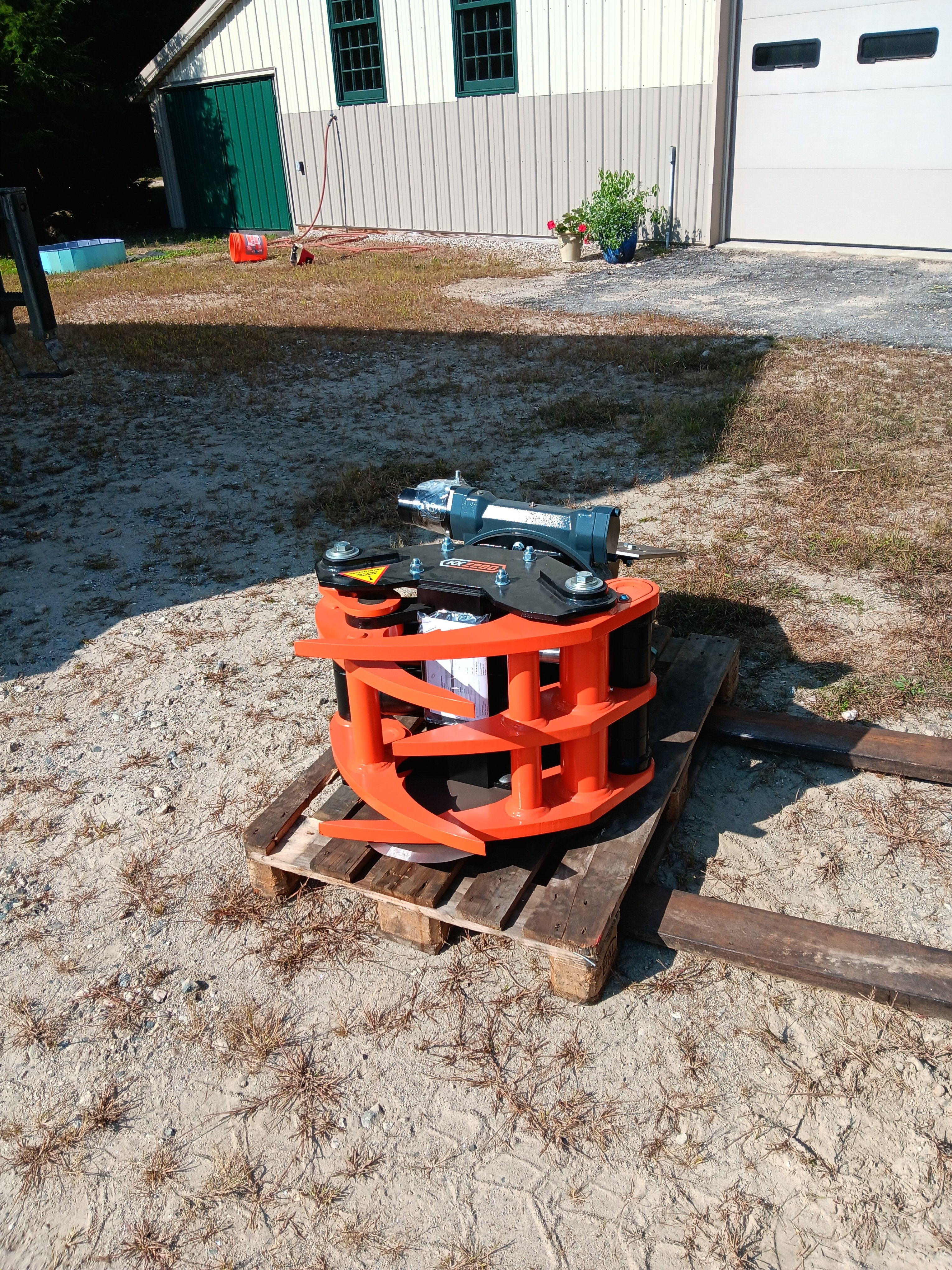

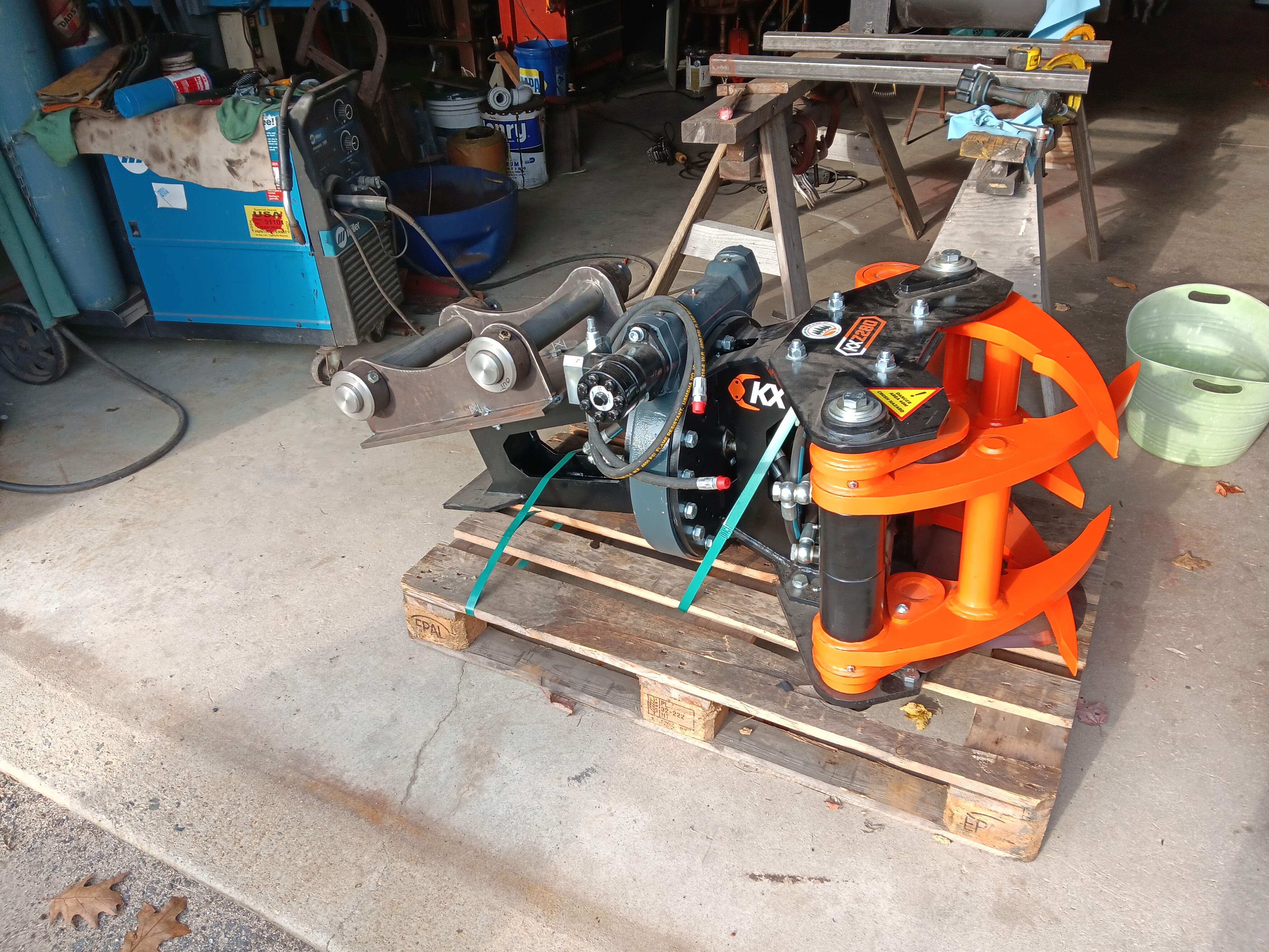

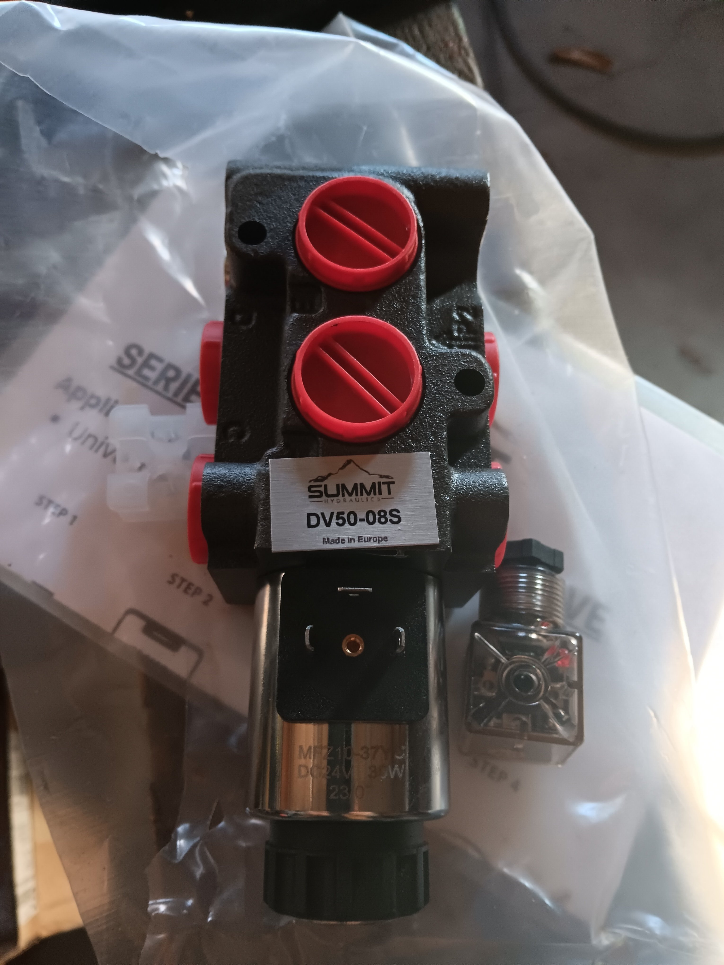

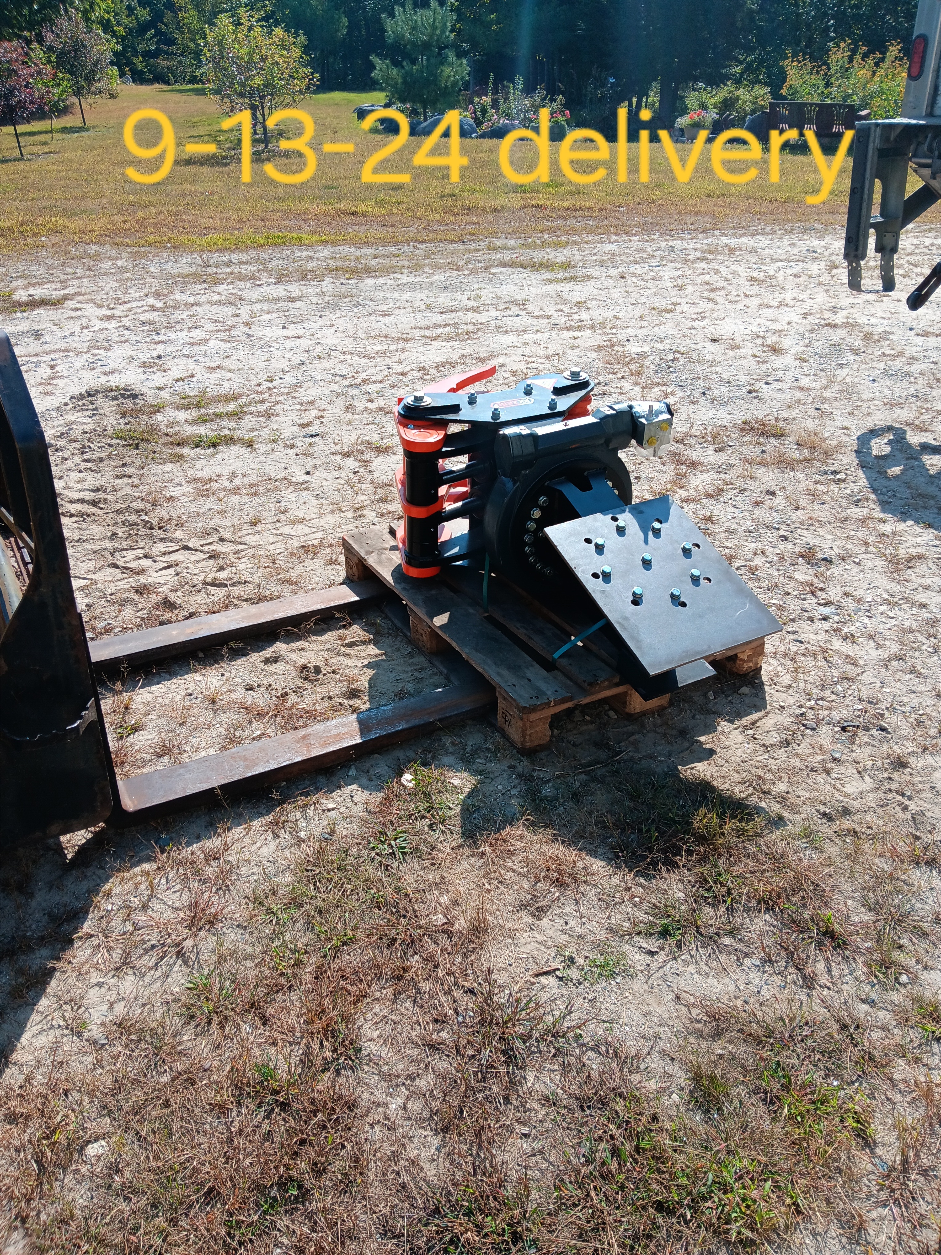

I'm in the process of mounting this shear and rotator.
I'm mounting a solenoid valve in a little, well protected area under the coupler pins.
My hold up is the wiring. I have an unused toggle (momentary) on the left joystick that I want to operate the valve to divert the flow from shear action to rotate. This rotator will greatly increase my ability/choice to pile the stems not to mention limbing abilities.
I'm envisioning quite a bit of disassembly and wire "chasing" for a clean installation. Not my strong point and my reason for procrastinating 🙃.
They've got a pretty good YouTube channel.
This is the outfit I bought it from. KXZ 280 Rotating Tree Shear
The build quality down to the paint is impressive. My use is for thinning and some of this will be firewood..... when I get it operational. 😆

I'm in the process of mounting this shear and rotator. View attachment 2073846View attachment 2073847View attachment 2073848
Impressive attachment!
Precision Manufacturing has wire and wireless options to control functions. Wireless helps if using between several machines.
Having the articulation to flush cut encroaching trees at ground level to maintain with rough cut mowers along fences and boarders one goal. Safety trimming overhanging limbs another.
