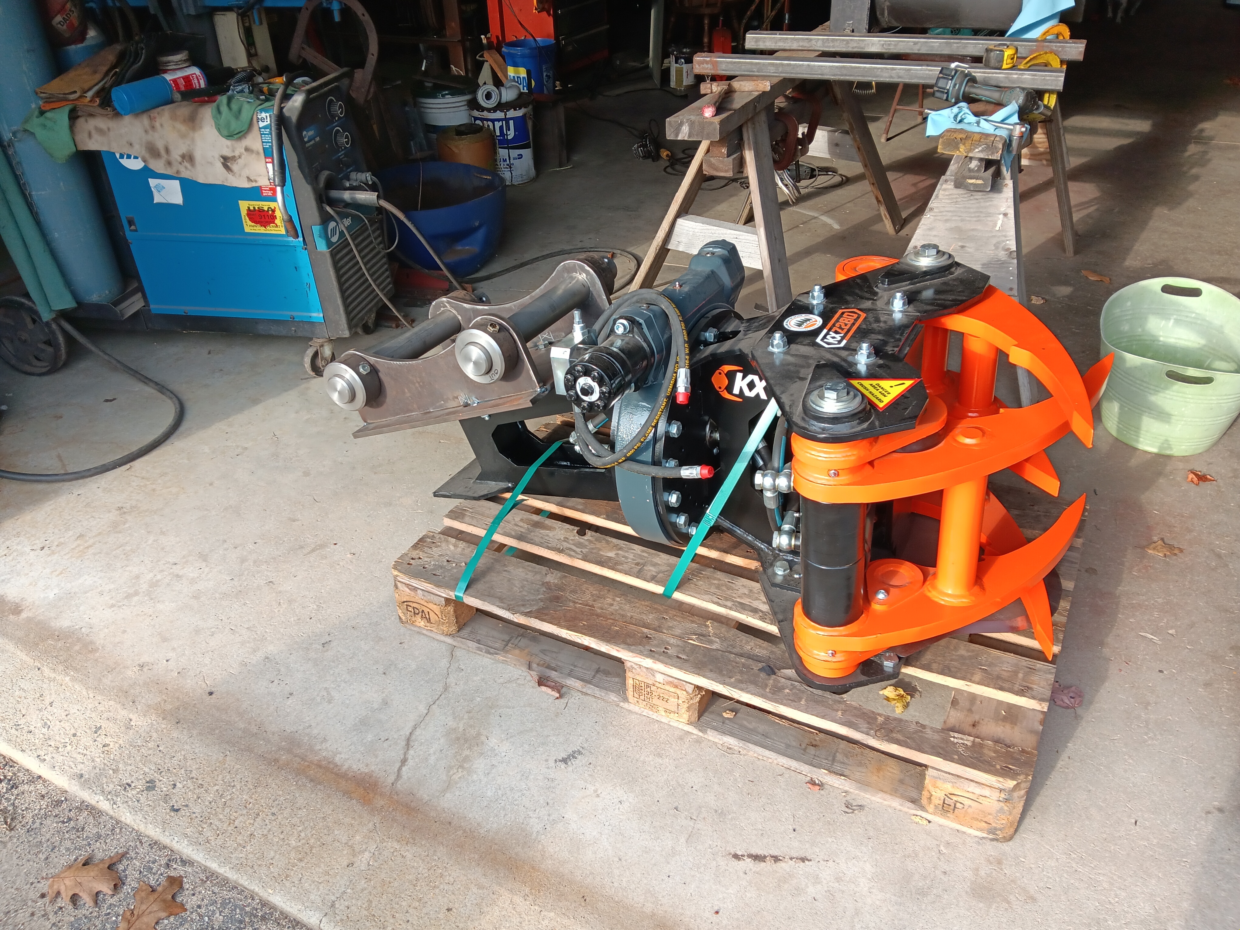

I'm in the process of mounting this shear and rotator.

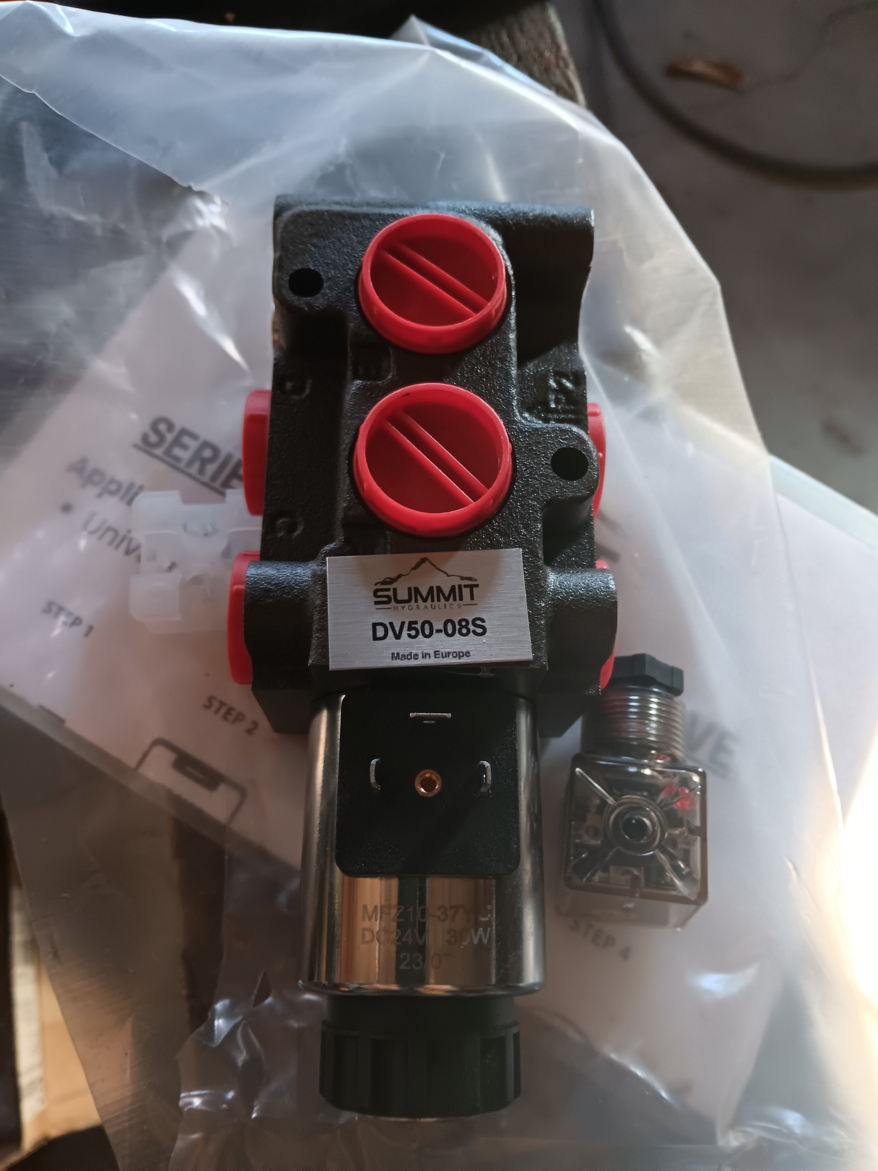

I'm mounting a solenoid valve in a little, well protected area under the coupler pins.
My hold up is the wiring. I have an unused toggle (momentary) on the left joystick that I want to operate the valve to divert the flow from shear action to rotate. This rotator will greatly increase my ability/choice to pile the stems not to mention limbing abilities.
I'm envisioning quite a bit of disassembly and wire "chasing" for a clean installation. Not my strong point and my reason for procrastinating 🙃.
They've got a pretty good YouTube channel.
This is the outfit I bought it from. KXZ 280 Rotating Tree Shear
The build quality down to the paint is impressive. My use is for thinning and some of this will be firewood..... when I get it operational. 😆

I'm in the process of mounting this shear and rotator. View attachment 2073846View attachment 2073847View attachment 2073848
Impressive attachment!
Precision Manufacturing has wire and wireless options to control functions. Wireless helps if using between several machines.
Having the articulation to flush cut encroaching trees at ground level to maintain with rough cut mowers along fences and boarders one goal. Safety trimming overhanging limbs another.
