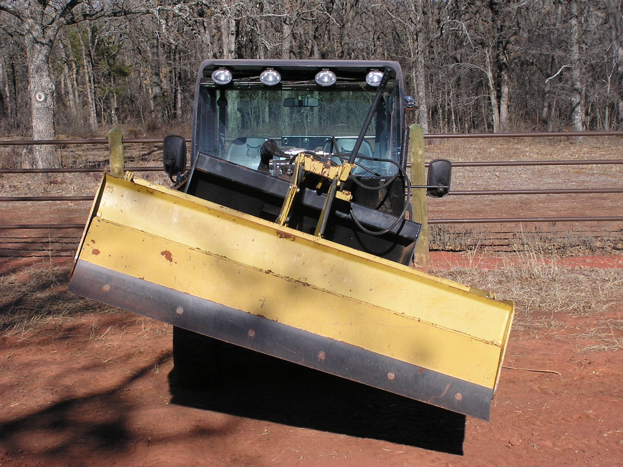

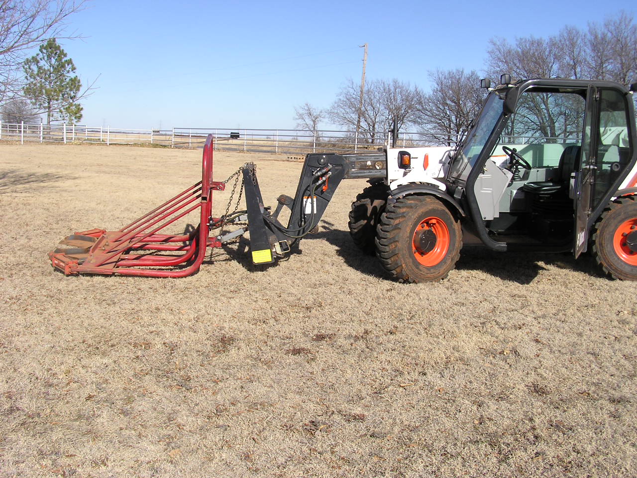

Not a flail mower, it is a 6' box blade that was pictured in post #18 of this thread, Piston was asking how the Versahandler would do for grading trails into a hillside, so I showed the Tilt-Tach tilted.
Here it is not tilted:
And on the V417:
I had an Oliver HG-68 with a front loader on it, neat little crawler, but not geared low enough for dirt work. It is possible to add a Ford Model A 3 speed transmission ahead of the transaxle, put both in reverse and you have a crawler gear for the crawler! :D

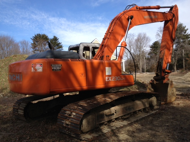

...........it's a Hitachi 230 LC5 which I guess is around 50k lbs............I can't help but think I could buy this machine, clear the land, then sell it and replace it with a small mini ex, or just sell it altogether and use the money towards my next tractor.
Hitachi's are sound machines & a c.20T will clear & dig ponds/dams fine - grapples or thumbs make stacking pile burns & rock landscaping easy - if you're heading down this path invest in machine oil sample analysis (engine/hyd/drive motors )/undercarriage inspection prior to parting with any $'s - Yep if I had 5acres+ of heavy land clearing & some pond work this what I'd be doing - With patience I'd expect you should get something sound for under c.$20K (avoid an "ex" that's had a hammer fitted or been used in demolition)..the resell for close to what you paid

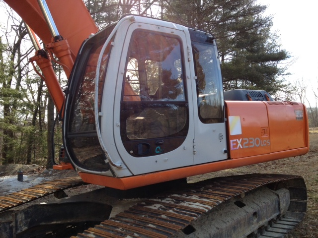

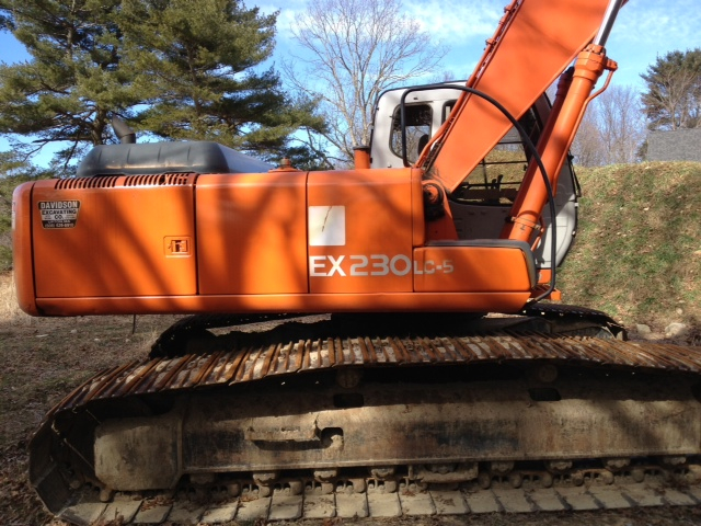

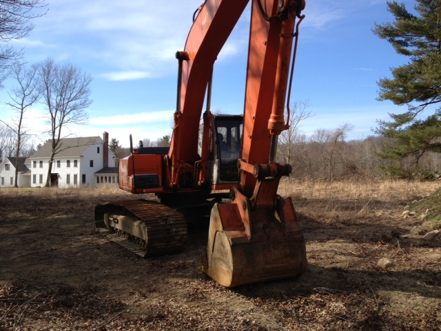

Piston, you'll love the ex. Is that the one your looking at in your photos? You might want to consider that your needs will change from your clearing & construction stage (excavator & SS wins big) to later on during your living there "landowner" stage. Where I'd say that your tractor will suit you better than a SS. I have all 3 and up until lately only had my SS & ex. here, finally after 3 yrs. (another story) I have my tractor here as well. The excavator is really a fantastic tool that I doubt you'd ever want to get rid of. I use mine for so many things that you just can't do with either a trac. or SS, all the way to the wood pile, (an ex. with a thumb makes the best "sawbuck" for bucking up firewood, ever). As for clearing your prop., forget the tree shear & take the tree with the stump with the ex. I have the biggest SS made, @ 5 ton and 115hp with OTT's (over the tire tracks) it is just about unstopable, that is until you meet a stump or rock (poor ground clearance) but it'll run circles around a tractor doing dirtwork & other loader chores, and really compliments an excavator's ability. With the 2 you could dig your own foundation, septic, well & utility lines, driveway & clearing. Lot's of choices & decisions not to mention budget considerations. Now that I have my tractor here (my bldgs are built and now am more in the "landowner" phase) I had forgotten how sweet a tractor is to hop on and off and it's MUCH inproved mobility in the snowy woods, but still for loader work, the unbeatable visibility of a SS, and it's boom & bucket that was designed for abuse vs. a tractor loader & bucket, that (IMHO) is designed for chores & loading loose materials only. Now the telehandler aproach is a good idea, but again similar to a tractor when it comes to manuvering although better with the different steering modes.

Piston, you'll love the ex. Is that the one your looking at in your photos? ....
Yes that is the one I'm thinking of buying. My father's lifetime friend is in the excavating business, has been since his father started the company when my dad was a kid. The good part about this is that I trust the guy selling it, he's been using it for jobs for a while now, and I know I wouldn't be getting screwed on the price for it.
I don't know the year yet, but I found out that they started building them in '97, so it's somewhere between then and now :laughing: I also don't know the hours, or undercarriage condition, or really anything about it. I won't be home for a couple weeks but I'm going to look at it when I get home and ask him questions and try it out.
It's a Hitachi 230 LC5 and from what I found online is a 50k lb machine. It seems like a decent mid sized excavator. My father told me that the owner has been using it for a while and it is currently on a job doing a septic system or something like that, only a couple miles from my house. The guy is getting closer to retiring and is starting to sell his equipment and downsize. He isn't advertising it and he's not in a hurry to sell. When the guy asked my dad how I was doing (I used to go on fishing trips with them as a little boy) he told the guy about my plans for building on my NH land. That's when the guy mentioned that he had this excavator that I could buy, clear my land with and dig a foundation/driveway, and probably sell it for what I buy it for. And that is where this crazy idea started :D
It does not have a thumb, but you can see it has mounting for a mechanical thumb. I recently built a thumb for my 410 backhoe and I overbuilt the heck out of it, so I think it's actually a bit too big for the backhoe, but maybe slightly too small for the ex. I could probably mount it and just "go easy" on it and it should be fine. I'd also look into adding the hydraulics to make it a hyd thumb, but I have a feeling this could get expensive. I'd be okay with mechanical I suppose.
.. The excavator is really a fantastic tool that I doubt you'd ever want to get rid of.
That's what I'd be afraid of, I wouldn't want to sell it! However, I could see myself selling it and buying a mini ex just to have around, but as mentioned, they seem to be some pretty expensive pieces of equipment "just to have around"

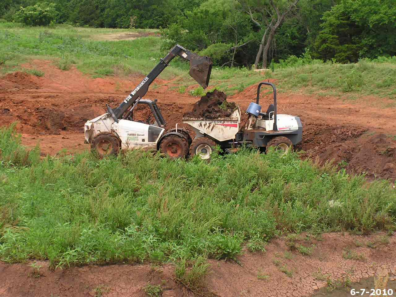

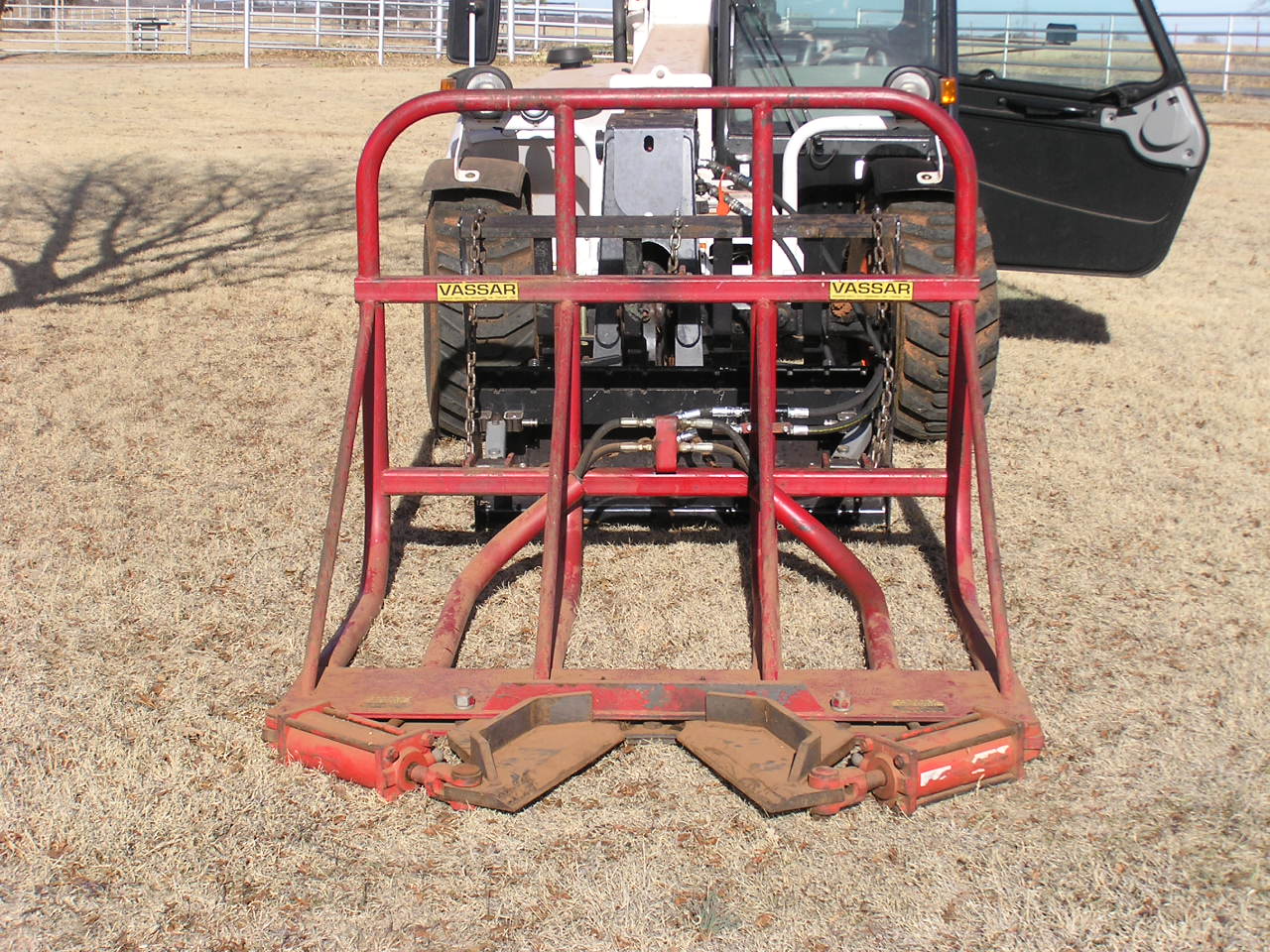

I looked up the prices on used Versahandlers. It looks like those are around $70k even for a used one :eek:
Must be for the full size series, not a compact V518 or V417.
Here is a copy of the quote from my dealer on a new V417 in 2010:
Product Quotation
Quotation Number: 4486E05124v1
Date: 2010-07-01 11:22:15
Description Part No Qty Price Ea. Total
V417-Cab Versa-Handler 7138801 1 $63,139.00 $63,139.00
Warranty: 12 Months, Unlimited Hours
I bought a 2009 demo with 44 hours for $52K, and it does everything that I need.
Keep in mind as you are trying to decide a decision, there are backhoe attachments that will work on the Versahandler, and can be removed in less than a minute. Turn the pressure release lever, pull up two levers, disconnect the hoses, drive away.
