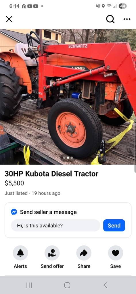

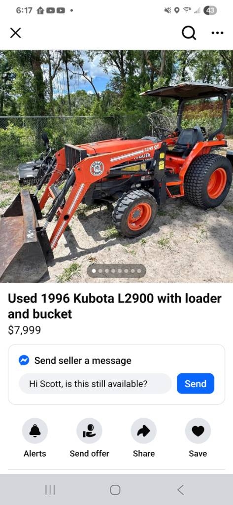

Over time I'm running into more and more situations I'd like to have a tractor. Since I am currently buying a new home with 4 acres and want to maintain and grow a small homestead, it's time.
I first fell in love with the older sub compact b6 7 8000 tractors with a fel. As i do more research and hear more things, people say do not under buy and go a size up from what you want.
I'd like a good all around compact tractor. Id like to do things like pull cars and trailers around, some grading and leveling, move brush, pulling engines, use some other implements.
I believe a sub compact could do most of these things but if I'm gonna buy one and keep it for a long time... might as well make sure it's up to the task.
I like older tractors, cheaper, I see plenty, and I don't mind a repair here and there. I'd like something that can work in tighter spaces, a big plus of the b series to me.
I've been watching marketplace and Craigslist for some time. New, and old, it seems hard to judge the sizes between the many models. Not to mention hp, fel and rear loader capacities, 2wd vs 4wd, power steering? Tractor data is a useful resource, and I'd like to go look at some but don't wanna be a tire kicker.
I see L175, 185, 245 are common and there are so many models in general. I'd like a 4wd model with a fel and ofcouse rear 3pt and pto. Budget 10k max. Wanna be educated and decisive. I like imports, leaning orange.
Can someone just drop some knowledge on me? Do smaller L series numbers inherently mean smaller? How do some of these newer and older series compare? Are there any resources that could shared with me? Located in NC.
Go look at the RK25 from Rural King and then use that as a benchmark to compare against. You can't get it for $10K, but then you can't get a nice 30 HP Kubota with loader for that amount either.
Sounds like you're able to turn a wrench. That RK25 is bigger than the largest Kubota B tractor. Just need to add the 3rd function option.
Just thought you might want to check it out and you need something to measure against related to size, weight, tires, features, capacity, HP, etc. Good luck.
