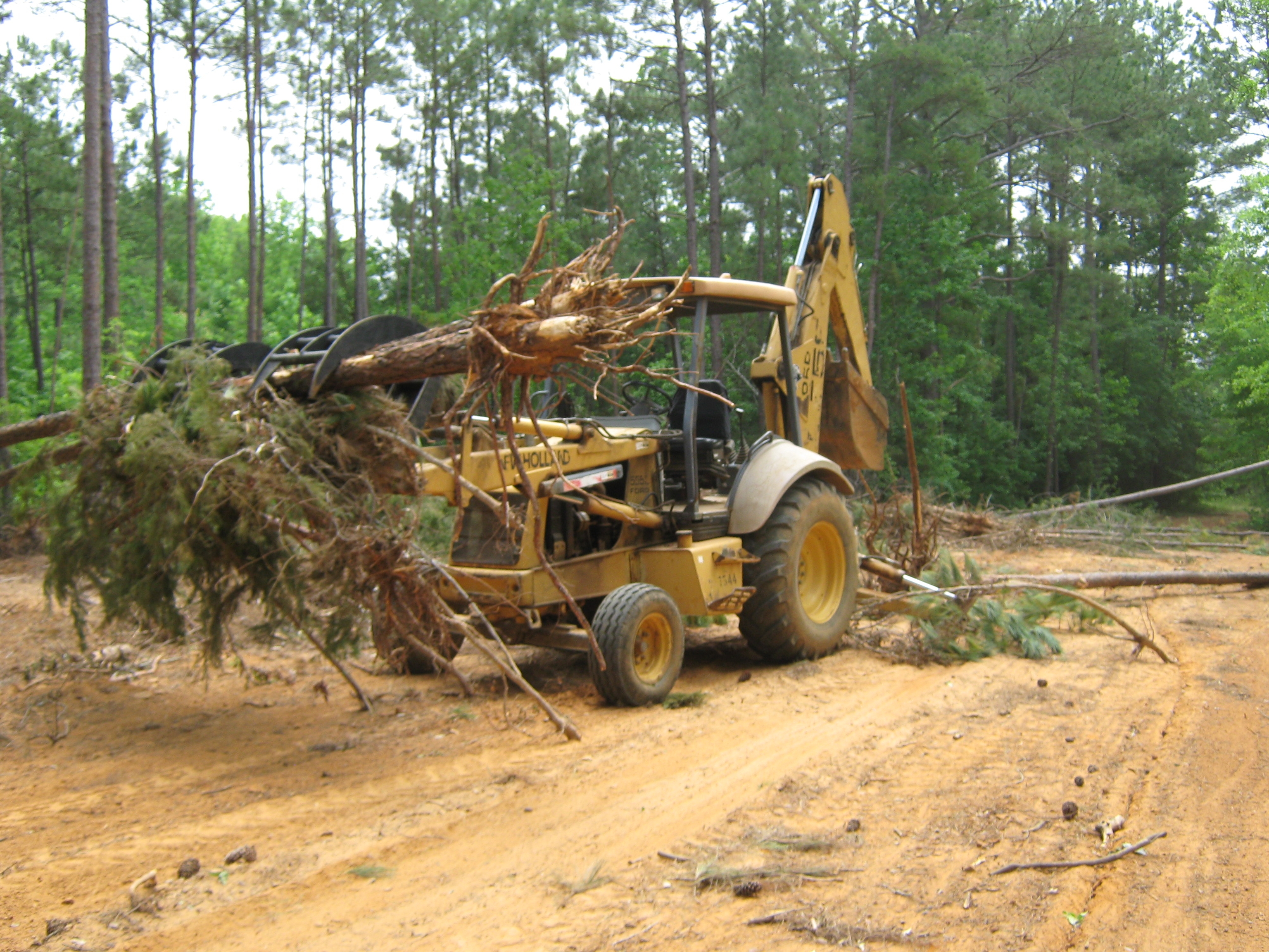

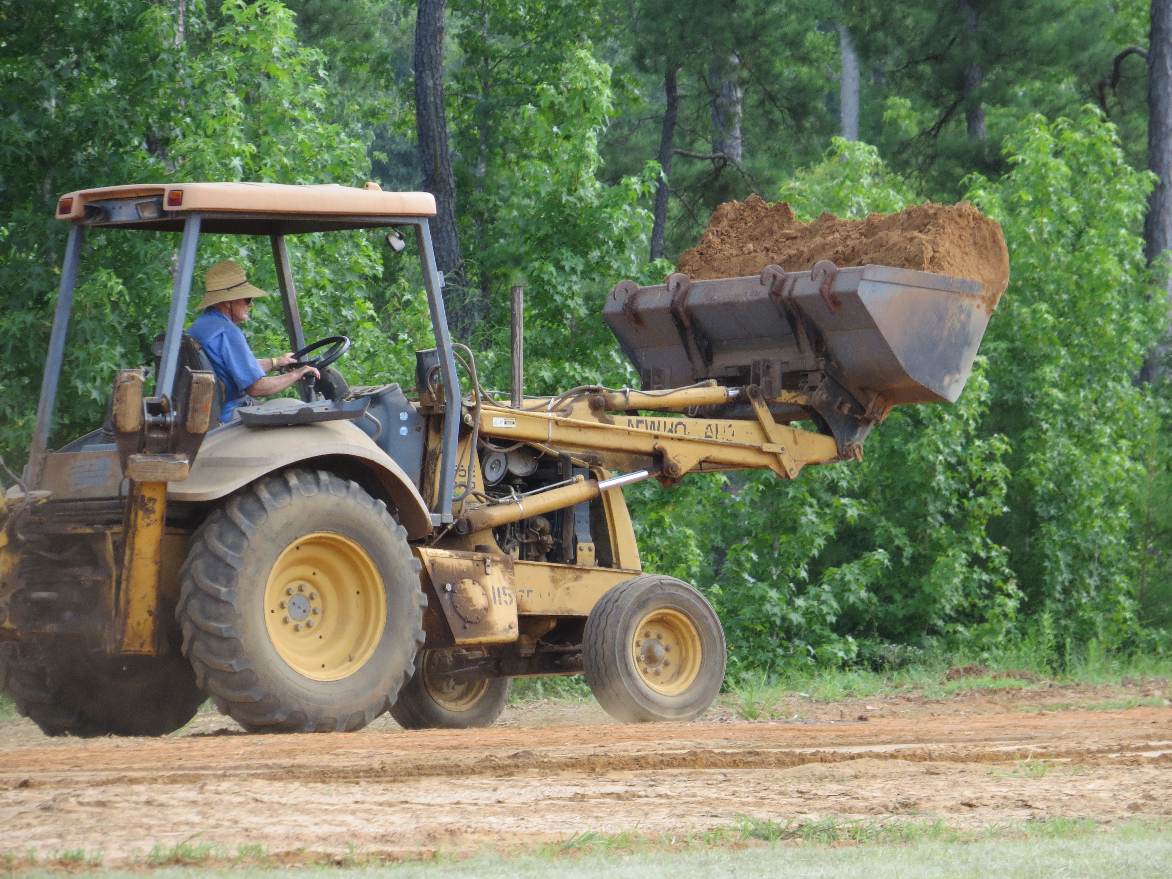

I bought my cabbed 4707 brand new in 2022. I got lucky. That was the first year that they had the new AC System. I own 68 acres that was thick woods when I bought it 20 years ago. I mostly use the Massey for mowing with my 12 foot batwing. It's awesome in the heat of summer to be able to relax while being productive!!! Yesterday the temps droped ten degrees in half a hour, so I quit working on my fence and got in the Massey to finish up my mowing for the year. The heater works almost too good!!!
For maintain your land, light loader work like moving round bales, small amounts of dirt and carrying things like firewood rounds, the Massey is a great tractor.
For clearing land, it's not a good choice. While I don't know what other brands are like, I'm pretty sure they are all poor choices for clearing land because they are not designed for it.
If you had unlimited cash, an excavator is the best thing for clearing and cleaning up land. But it's very limited in moving materials.

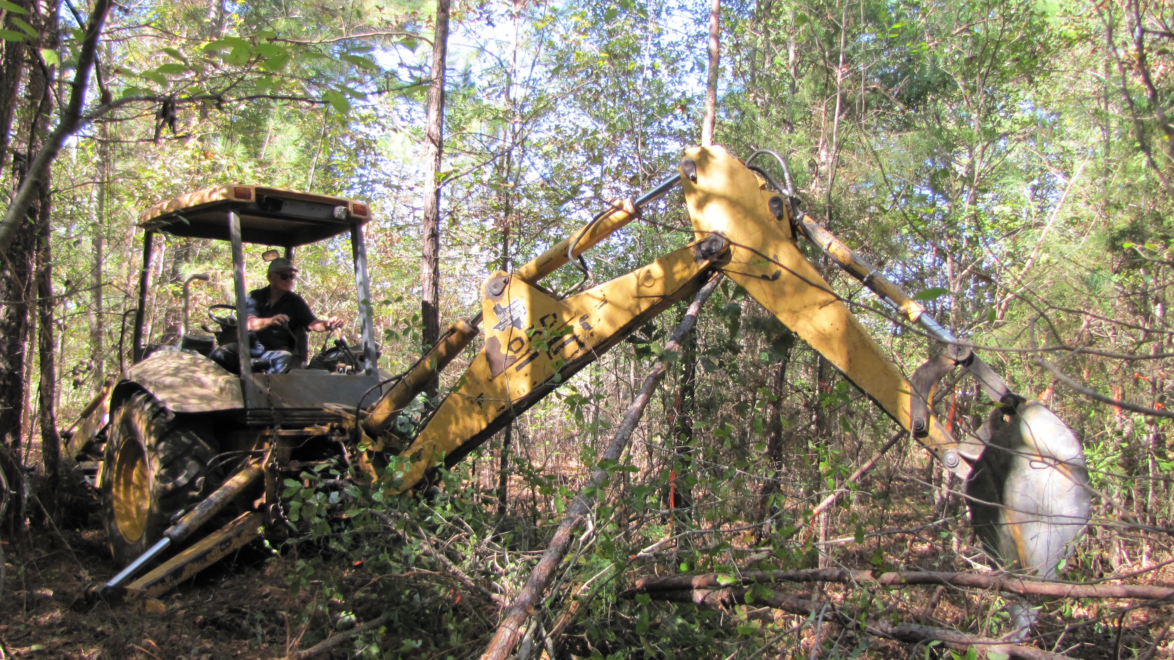

I bought a used 1998 2wd open station full sized New Holland 555E for clearing my land. The loader is night and day better than the Massey or my 5065E Deere. The bucket holds a Yard of dirt, and it's rated to lift 6,000 pounds. Being able to dig up stumps, take out entire trees or just pull apart a pile of logs is easy with the hoe. Digging anything is easy with the hoe.
I modified my front bucket so it's now a Quick Attach. I have pallet forks for it and a grapple. The grapple was the big game changer. I can dig out a tree, then pick it up with the grapple and carry it to the burn pile without getting off the seat. A 4 in 1 bucket would be even better because I could haul a bucket of dirt back to the hole from the tree and fill it up. Now I use the Massey for hauling dirt to the hole so I can leave the grapple on the Backhoe.
Another plus to having the backhoe is it's great at pulling my lawn mower out of the mud!!!!!
