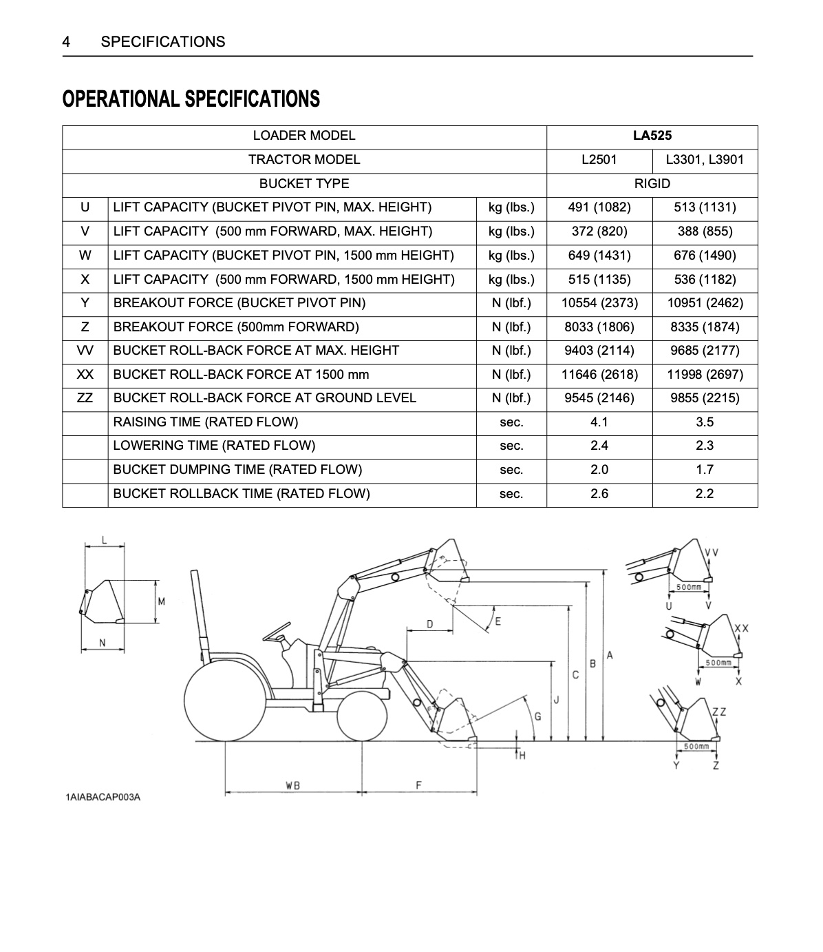

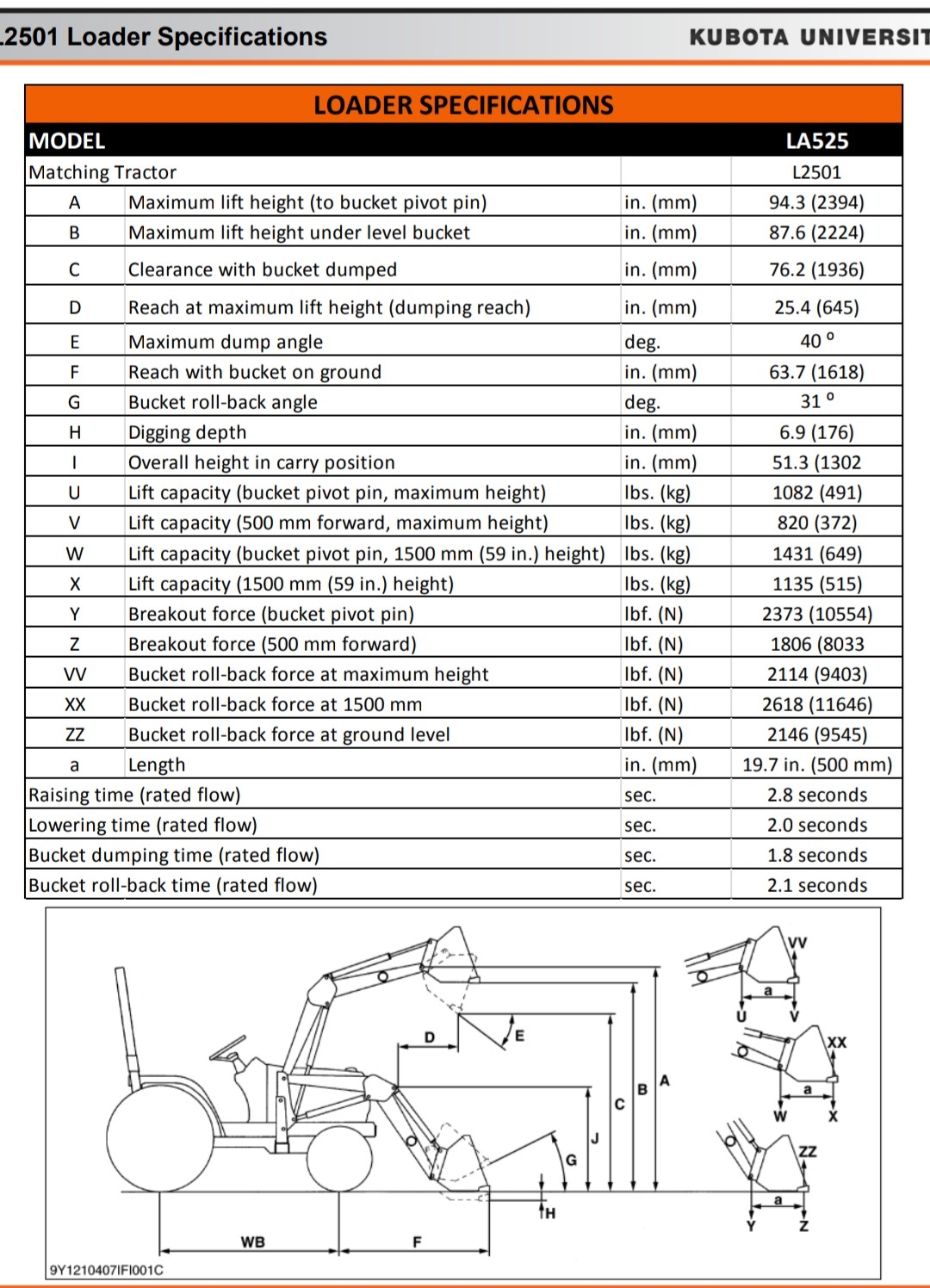

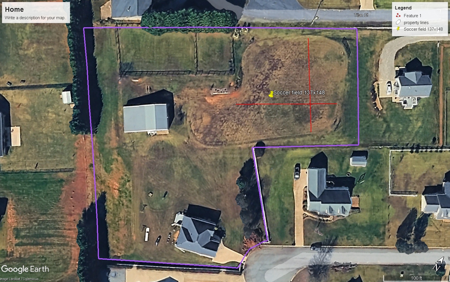

Hi,
We just purchased our first home that isn't in a regular neighborhood on tiny lots.
We are in Greer, SC on 3 acres. see below image for reference. I am looking to buy a tractor for my own personal use. I have never owned a tractor. I've owned a couple forklifts for warehouse use but that's it. the seller is conveying a nice Ferris IS2100Z 61" riding mower with the sale so I plan to use that to cut the grass.
I have no idea where to start so I'm hoping for some advice. I don't want something to small nor WAY to overkill. I want diesel, but no DEF.
The way I see it my needs will be:
1) I plan to turn the old horse arena into a bermuda soccer field (bear i mind I have no idea how to go about doing this yet).
2) add about 175' of fencing
3) convert the majority of the grass around the house to bermuda
4) move palletized items around the property safely. max weight 1000lbs
5) plant trees
6) move some excess dirt from one part of the property to the other
7) lay irrigation lines as there currently are none
8) build a small bmx pump track
9) clear an area around my barn for more concreate to expand the barn
10) we want to add a garden approx 40x60
Again I'm sorry for not knowing squat about tractors. I'm very grateful for any advice.
Thank you
Nick
