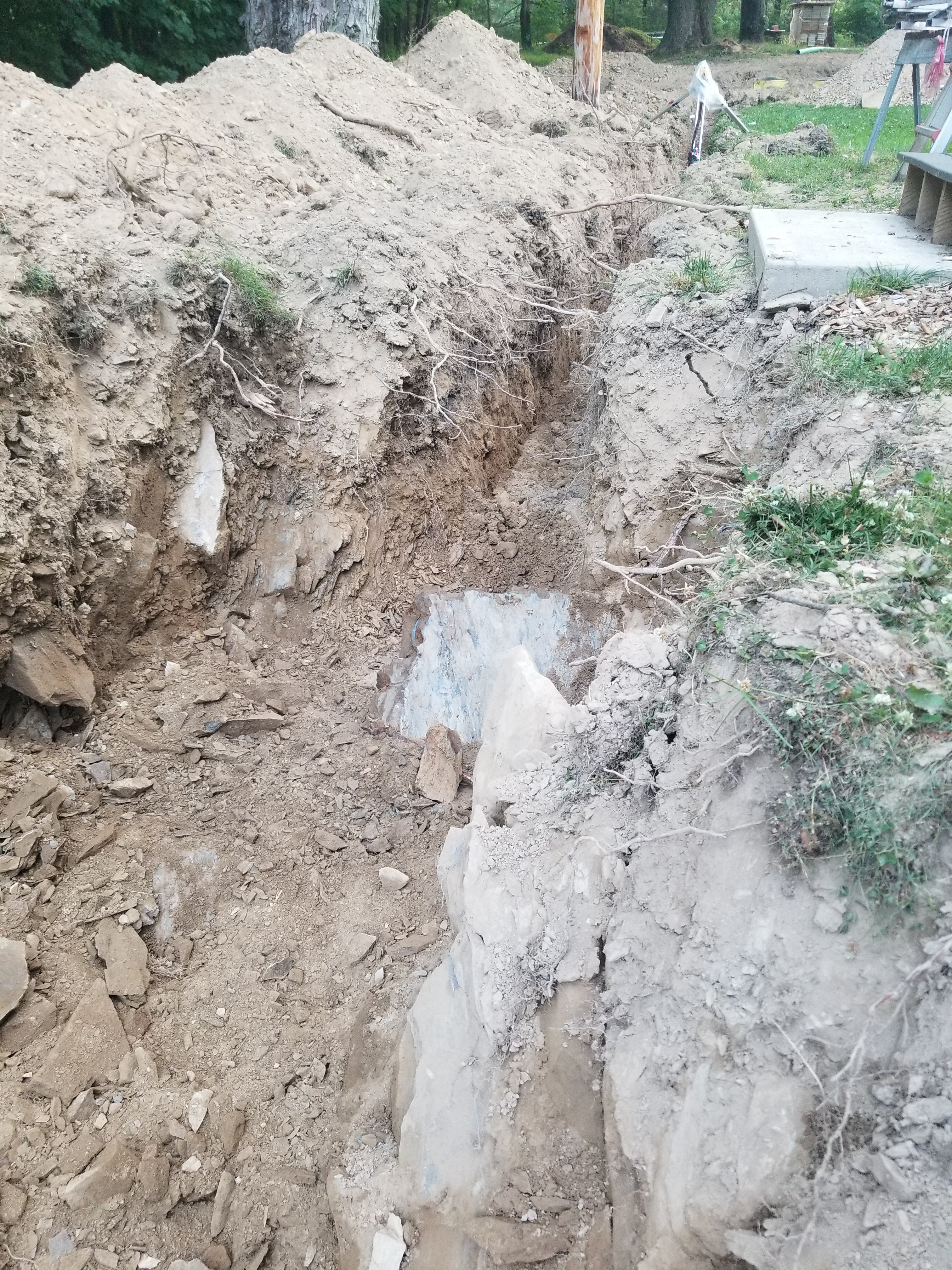

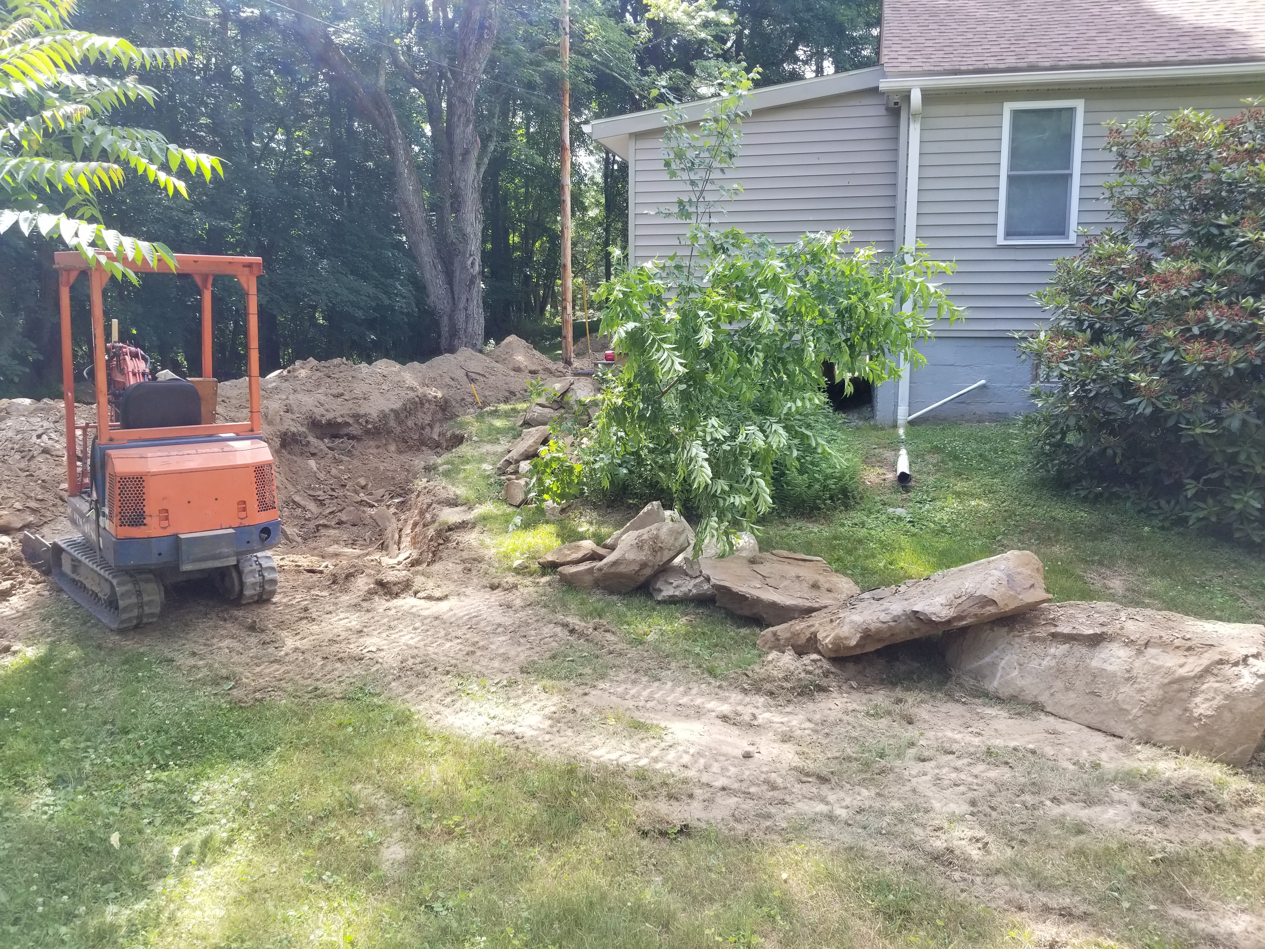

3,500lb machine. This is my septic in the northeast. Notice the large rocks on the right. 2hrs to dig 80' of drain line 2days to dig the last 20' of the 100' run. You can bent 4in pvc if you really need to. I had to dig that trench wide enough to get the machine down there and build a ramp to pull out that large rock.
I also put a 1,000gal tank in, I just did a light step dig. They also sell low and wide tanks, this wasn't one. I have a 12" bucket and used 2'wide leach chambers. Yes a 2' wide bucket would have been quicker but not a deal killer.
The trick with a small machine is to think and plan your dig.

Rocks, yeah I grow those things here too. Was your machine able to move those larger rocks, or did you have to use something else? Been tossing the idea of a mini for here and no idea where to start size wise. Thanks
