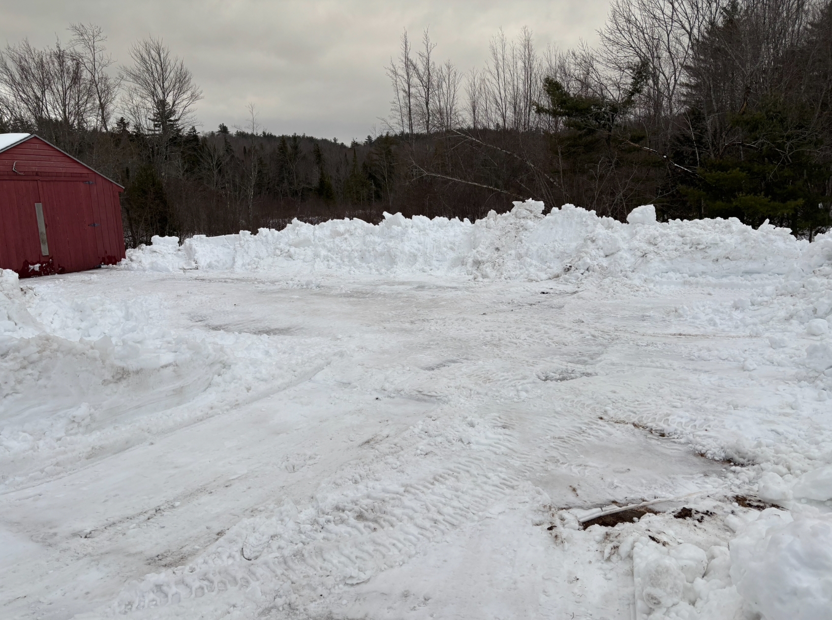

Fisher plows are made in Maine and are popular here. I've used the old straight permanently mounted blade, a Minute Mount straight blade, an Extreme V, and an XLS - my favorite. The XLS is a straight 8' blade with two hydraulically driven 1' extensions, so an 8' becomes a 10'. What's more, the ends can fold forward creating sort of a scoop for clearing larger areas like small parking lots without losing much of the captured snow on the way to the bank. V plows are great for breaking through deeper snow or banks left by town/state plows, but I've found they leave a windrow where the two moldboards hinge from. The XLS is a heavier plow and cleans right down to the pavement.
Adding angled wings was a huge improvement to my ancient Meyer straight blade.
Caught by the neighbors security camera:
Before widening to 8'6", the wings and the 42" tires:

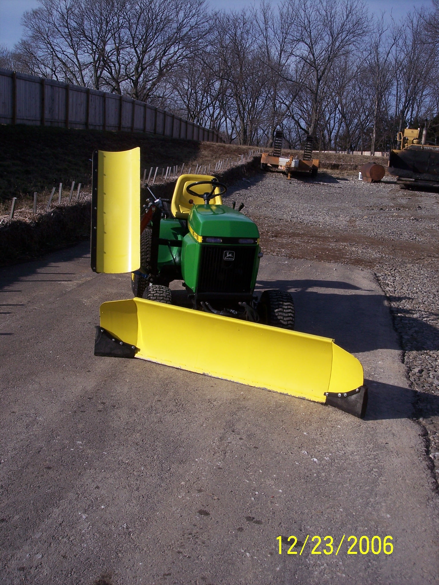

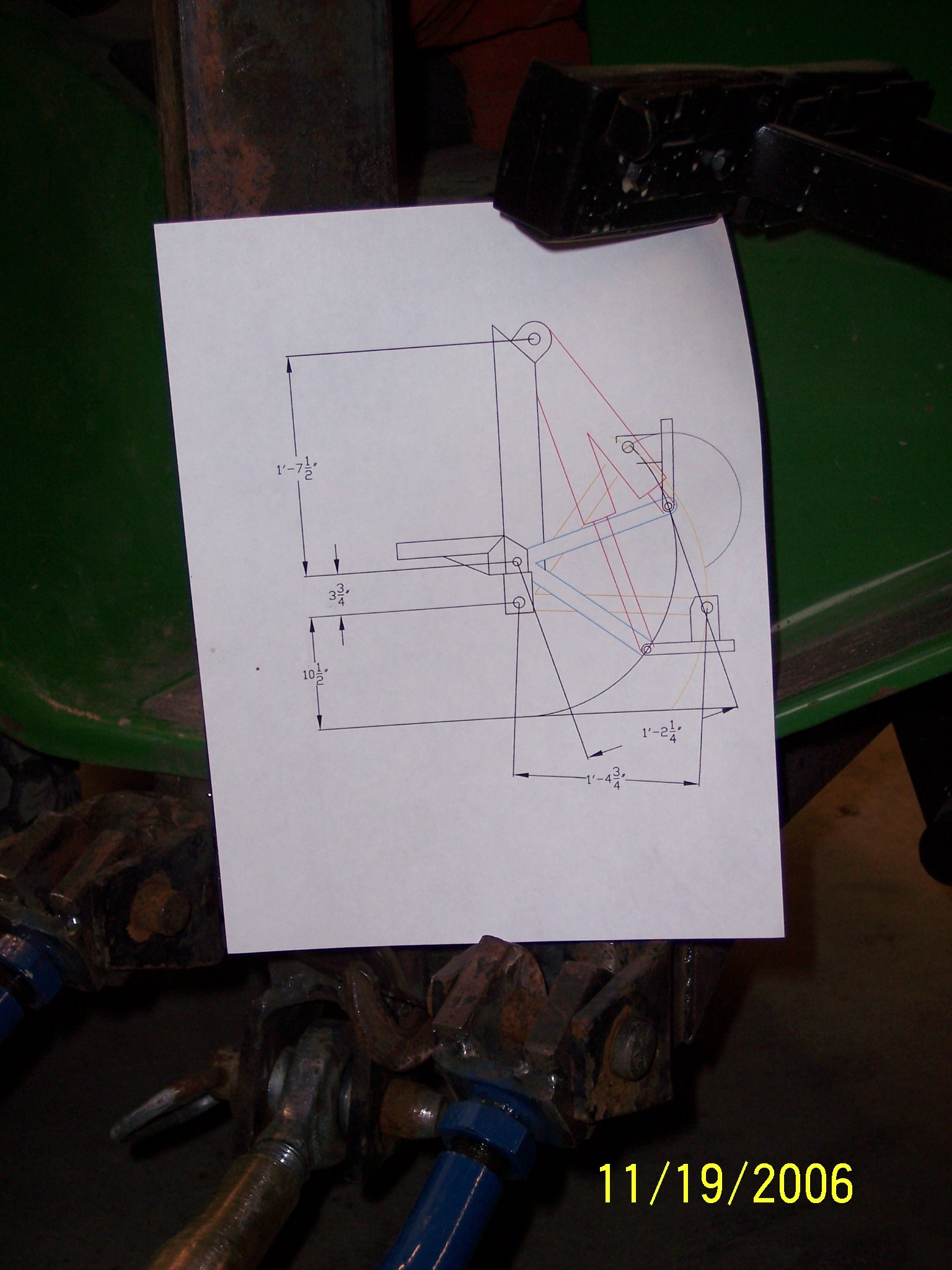

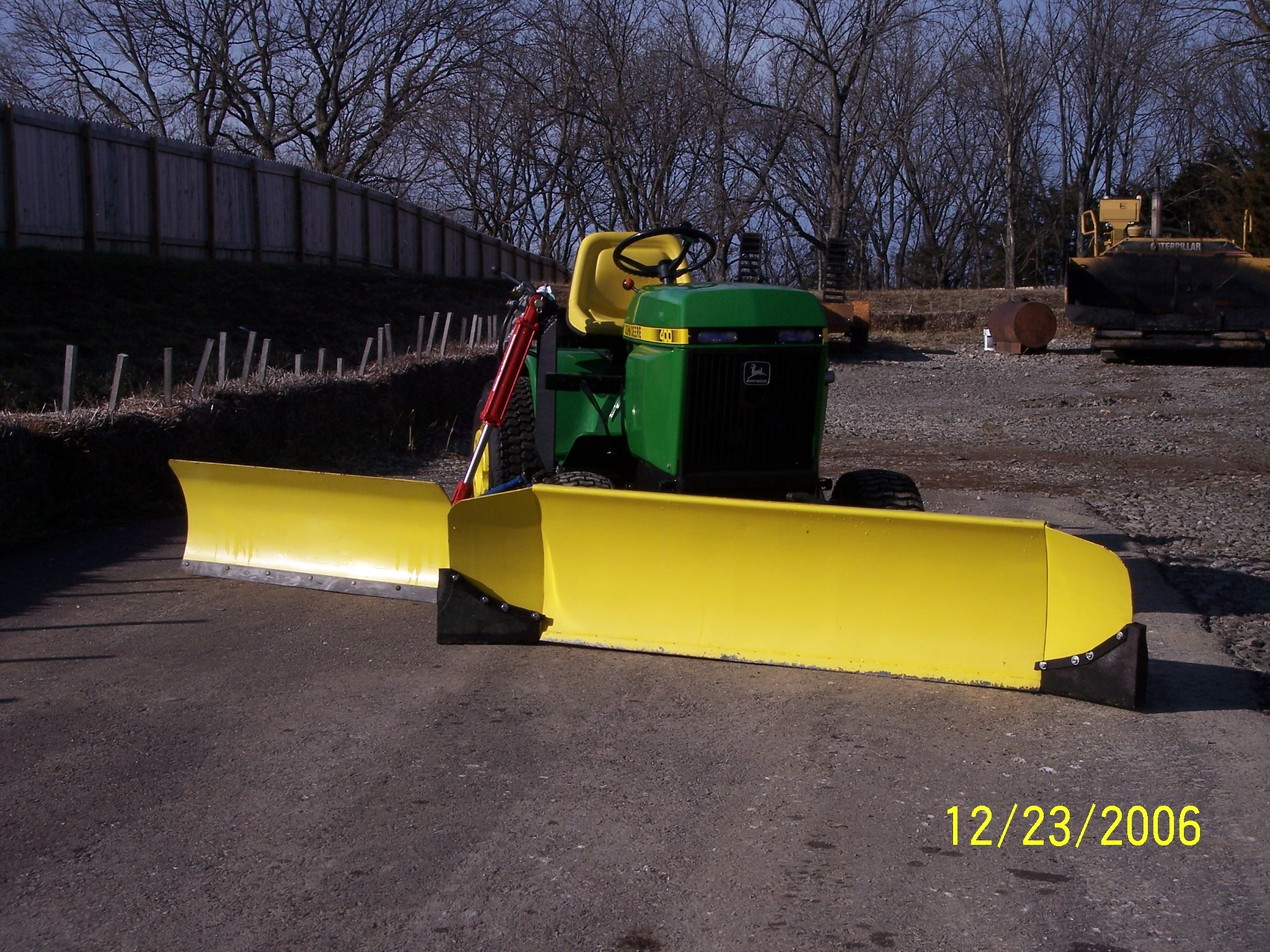

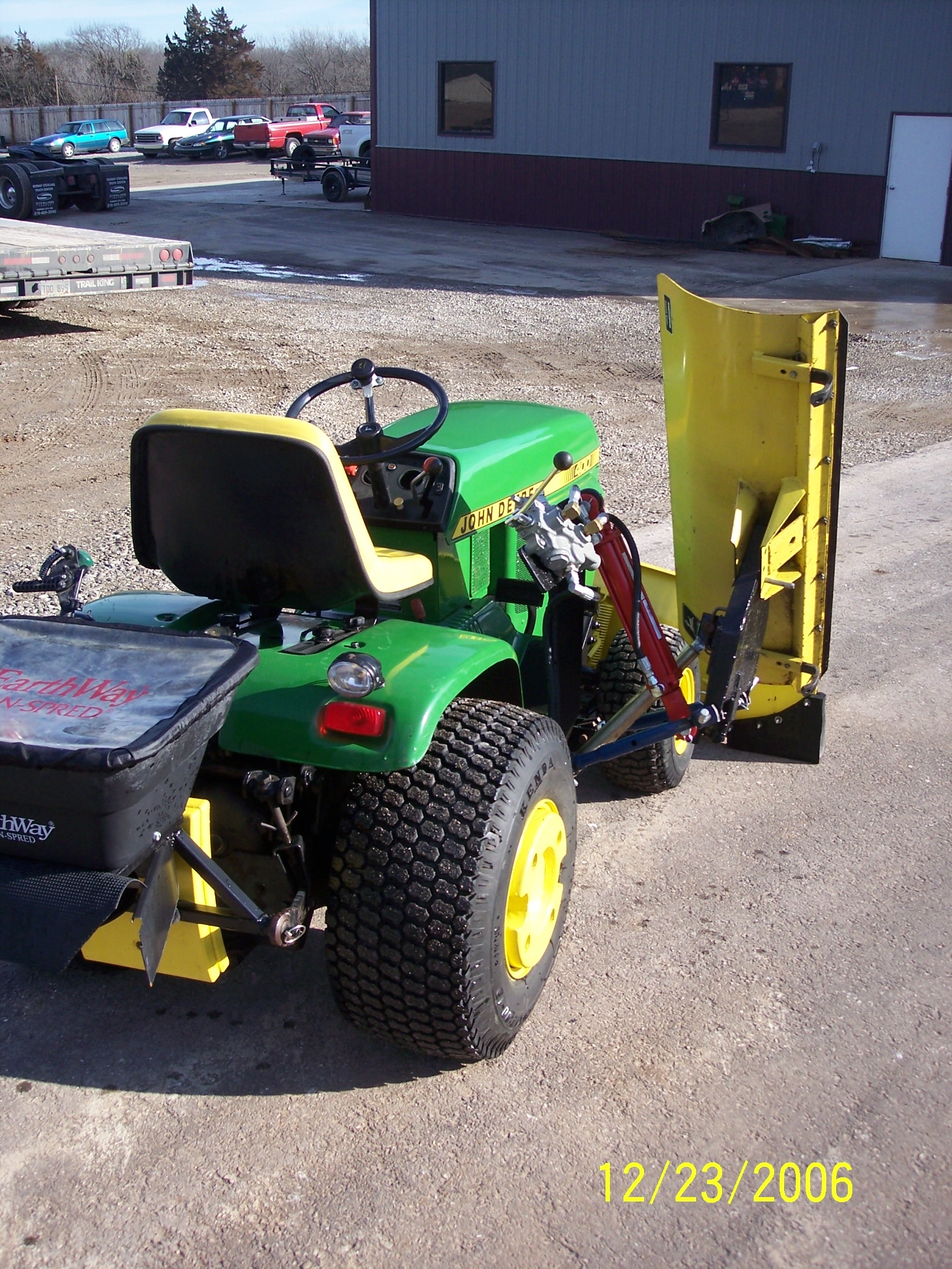

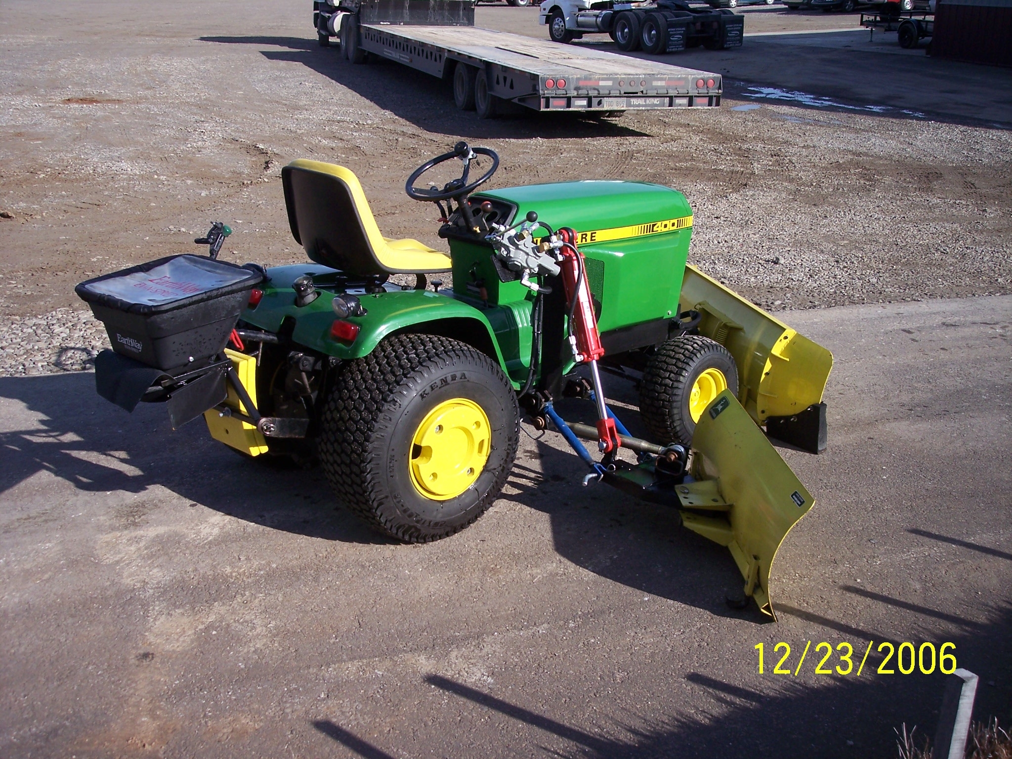

airbiscuit asked me to post some pictures of my wing that I made years ago. A constriction that I had at the time, was that it needed to fit on a trailer. I had a niche plowing sidewalks for retail stores all over. So that is why when the wing is picked up all the way, it folds up vertically. The drawing is how I figured out the geometry.​

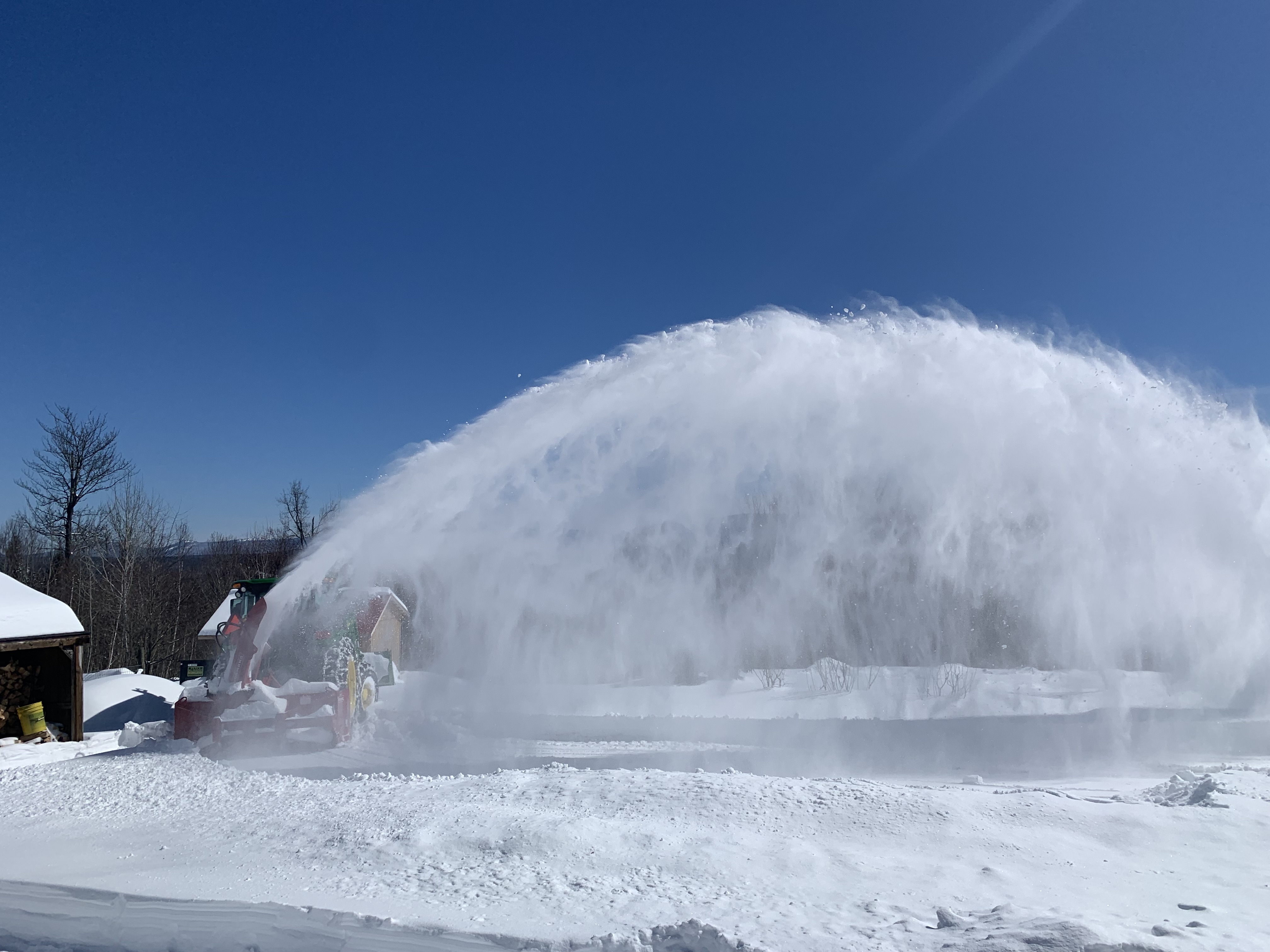

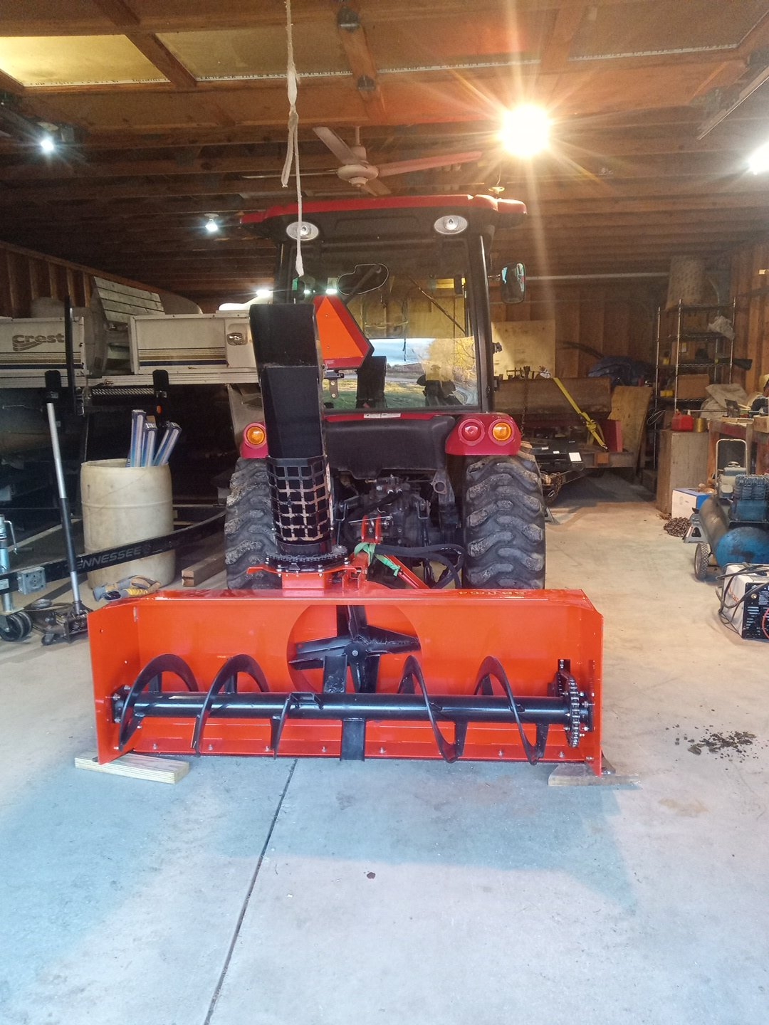

3rd tractor [Mahindra 2645], 2nd blower [LandPride 60some" wth hydraulic chute rotation. All I need yet to do is put on the rear chains. Just east of the last big lake, we typically get 120" over the winter [sometimes from both Erie and Ontario at the same time!] You oughta hear the neighbors cheer when I bring this puppy out to play in the neighborhood.
