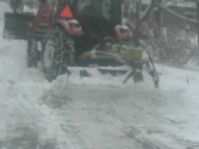

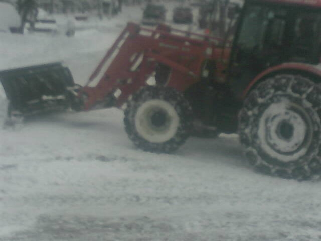

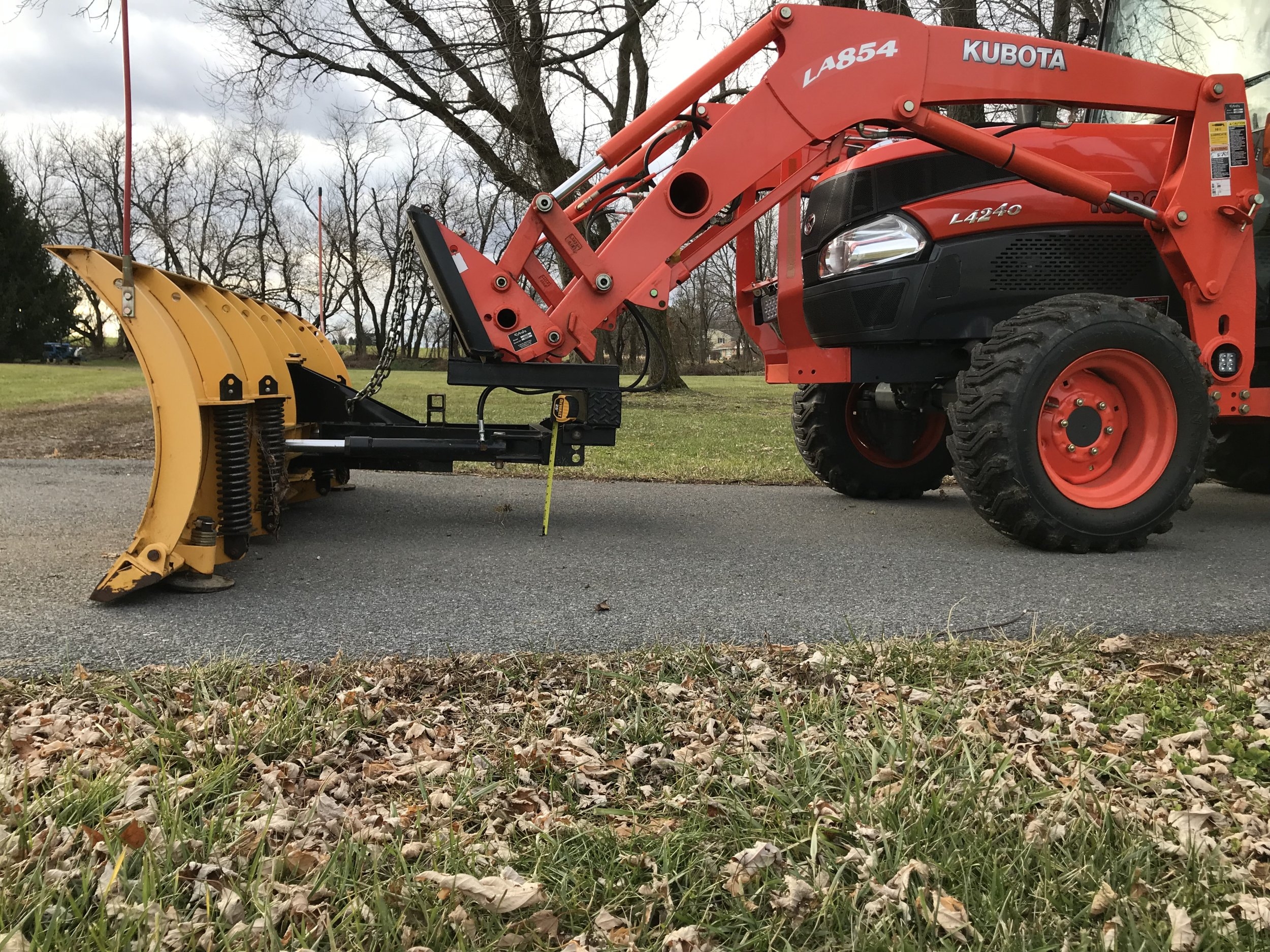

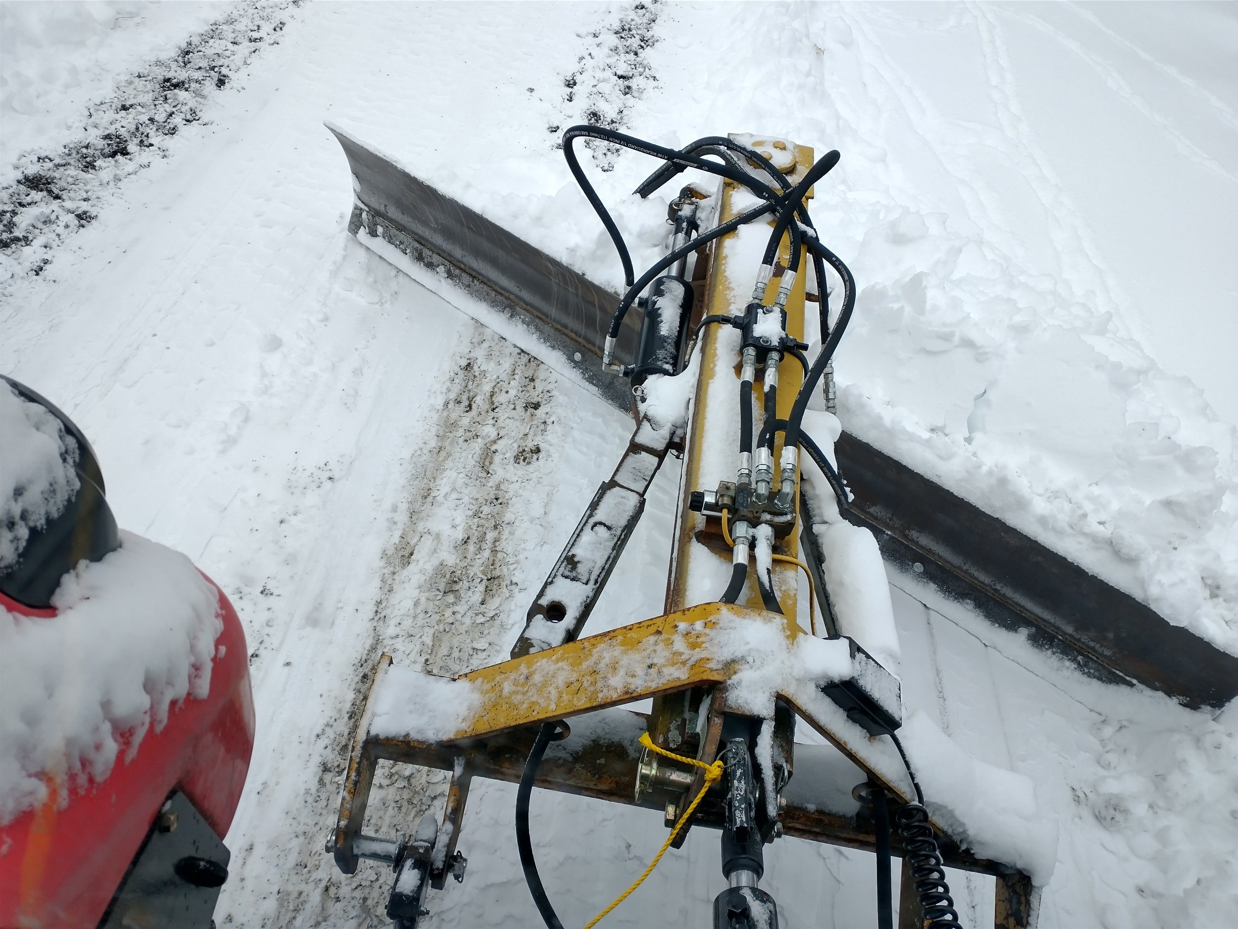

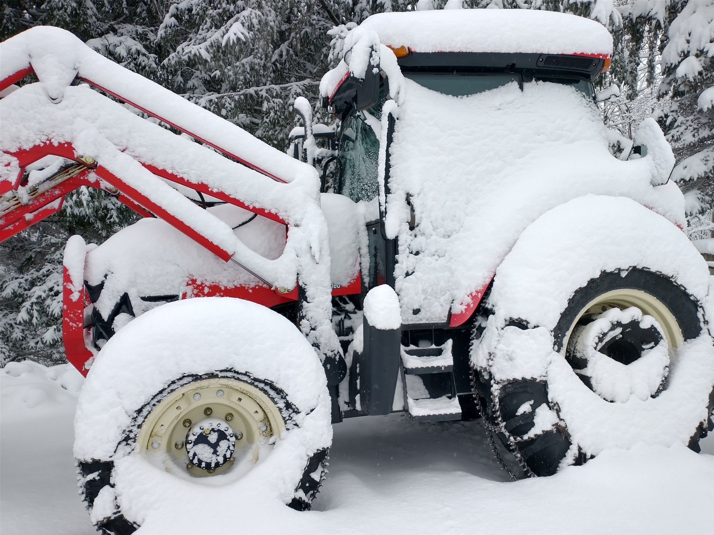

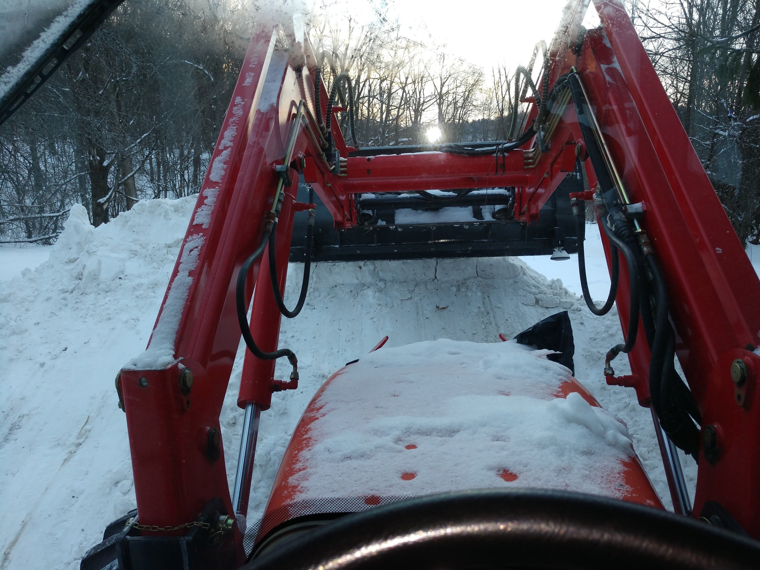

My situation is similar I have a mile of road (Dirt) to get to the state highway. We get quite a bit of snow December thru January and I have done most of the plowing since 2010. Since you only have occasional snow you can get by with a back blade once you get the blade set you shouldn't have to look back constantly, good mirrors are a neck saver. I started with an old 9n ford but the lack of 4 wheel drive made it tough on the hills I could often only plow down hill and getting back up was a krap shoot. I traded up to a Ford 1700 with 4 wheel drive which was much better. The problems with the back blade as have been mentioned are that you driving ahead of the blade and you have to drive through what ever you are plowing packing down the snow. In heavy wet snow the tractor will try to slide down the blade pushing you into the borrow ditch. You can turn the blade around which works well but your neck and back will suffer. When I upgraded to a Kioti CK3510 with a cab it came with a skid steer style quick coupler on the FEL and I purposely ordered it with a front remote. I bought a used snow plow blade with hydraulic tilt which made my life much simpler. The plow is much faster and easier but it does have a bit of a learning curve. On the early and late season storms when the ground is not frozen it can tend to dig in a bit but so will the rear blade. You just have to go slower and pay attention. Chains will pay for themselves quickly if you have deep snow or ice. I got by with the snow plow on the front and the blade in the back until last season when we had a super wet winter and I just couldn't push the snow berms any higher. I ended up buying a snow blower so I could get the snow completely out of the road. So my new winter configuration is plow on the front blower on the back and chains all around. A cab is nice especially with the blower.

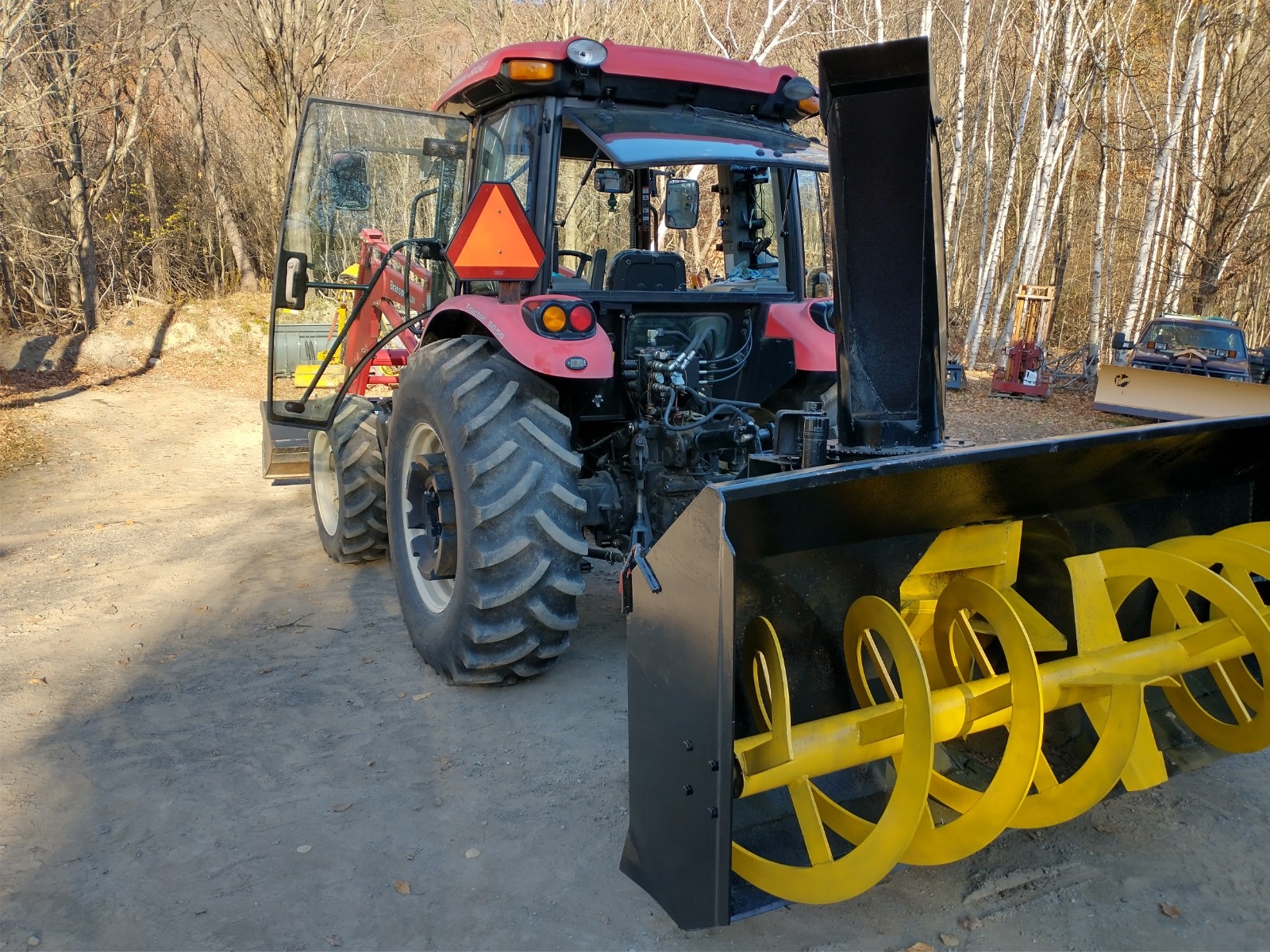

I use my 6 foot bucket on the front and 6 foot snow blower on the back of my LS 5030c (58hp front wheel assist) tractor that works quite well in our Manitoba Canada winters

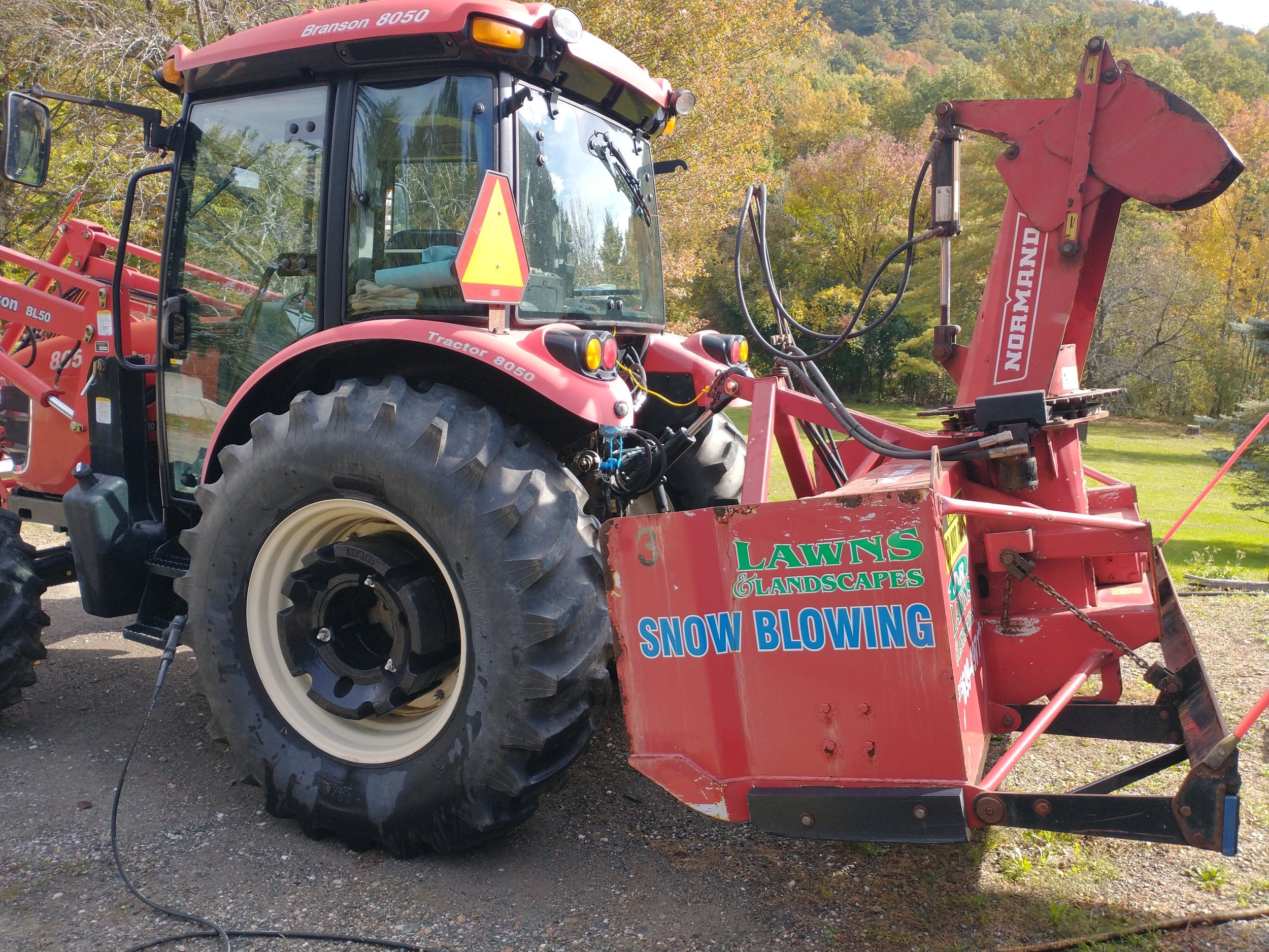

I’m waiting on one my new inverted pull-type, and I can’t wait for the neck relief. So no experience yet, but sick and tired of looking back to blow snow….and my lane is only 300’.
I was wondering when someone would comment on these. I have a FEL snowplow blade, rear blade, and a pull type 8' snowblower. And I'm in Kentucky... But, 10-12" snows can drift very high on old carriage roads in high winds and the county can take a while to handle the issues.
I have the nice option of heavy tractors to mount these, admittedly. I don't have issues with pushing snow and sliding much (10-12K tractors). But, I can see a lighter rig having problems sometimes. So...maybe back up and try again?
No doubt the snow blower in a heated cab is great and throws snow (and gravel) a long, long, way. Not cheap, but nice. Rear facing snowblowers would not interest me for reasons others point out (heck, my own driveway is over 1/2 mile and I also take care of others on my county road).
