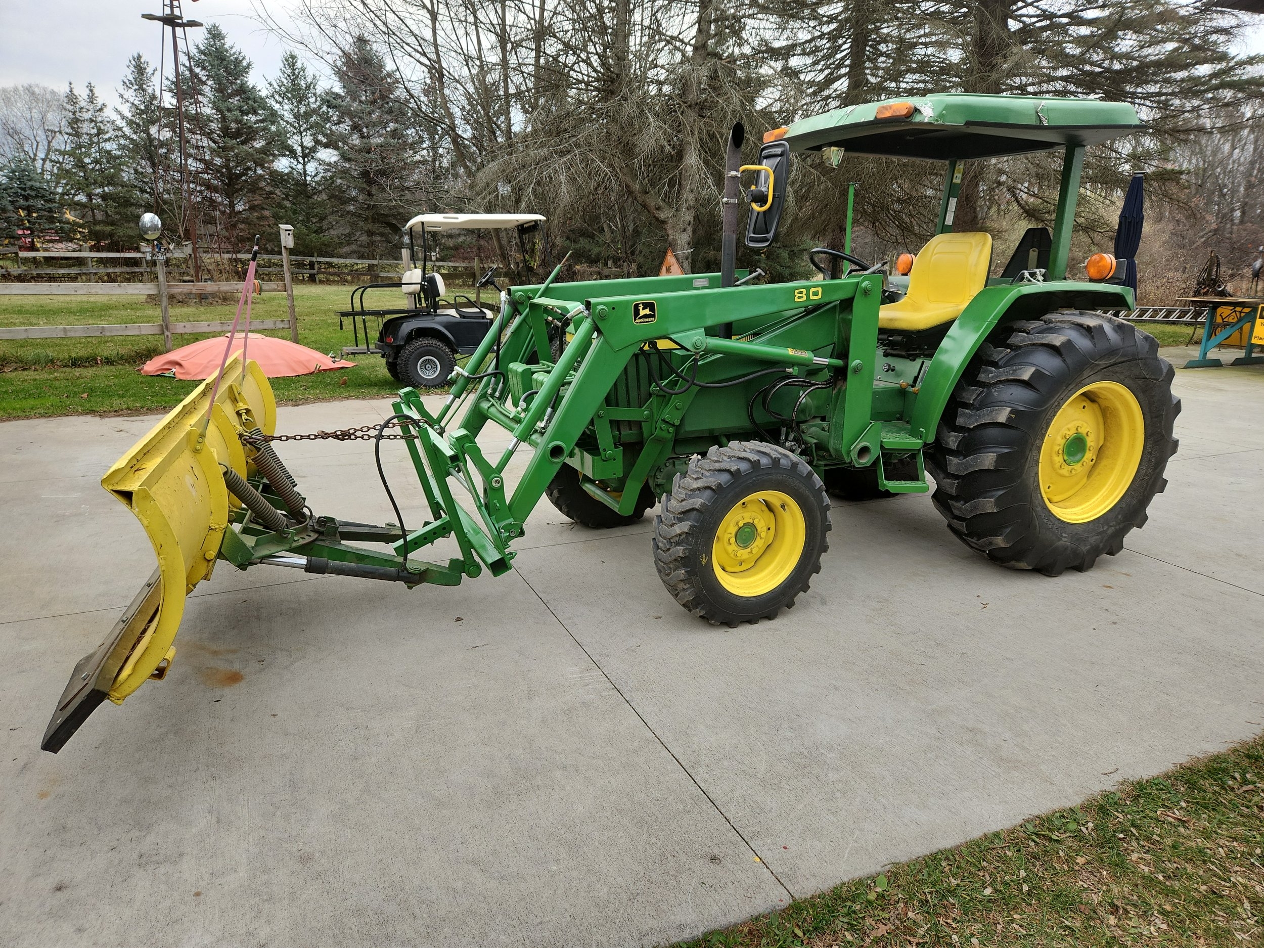

I sling a frame-mounted plow under the bucket with a chain up to the bucket for raising/lowering. The plow angle cylinders are driven from the quick-connect fittings for the bucket curl. Works great, has for years, and is a lot more efficient than a rear-mounted plow. By no means consider a plow attached to the bucket or to the loader arms - that is a recipe for ruin.

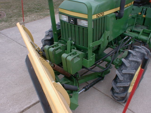

have plow on FEL...works great....but if have more than 4-5 inches of snow will use my rear mount blower....we get tons of snow and i dont want to bend my FEL by pushing too much weight
