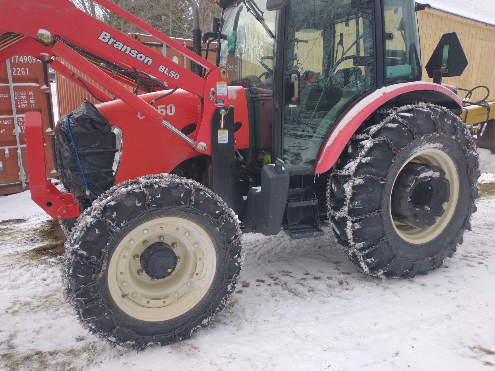

I envy you guys that can get such a tight fit with your chains. As tight as I can get them, I still have to use bungee cords to make sure there is no slack.
   / Snow chains for plowing with a rear blade #22
Mine are not real tight, the Euro patterned chains tend to stay on better with less walking off then 2 link or 4 link conventional chains. It is critical that both side chains are hooked in the same links so the chains fit square.
First question for you, is the inner chain as tight as it can be locked to the last useable link?
If not, you can release some air straighten the ladder chains and then reattach the locking link and tighten the outer locking
link to the same tension and then reinflate the tire and you should no longer need the bungee snakes.

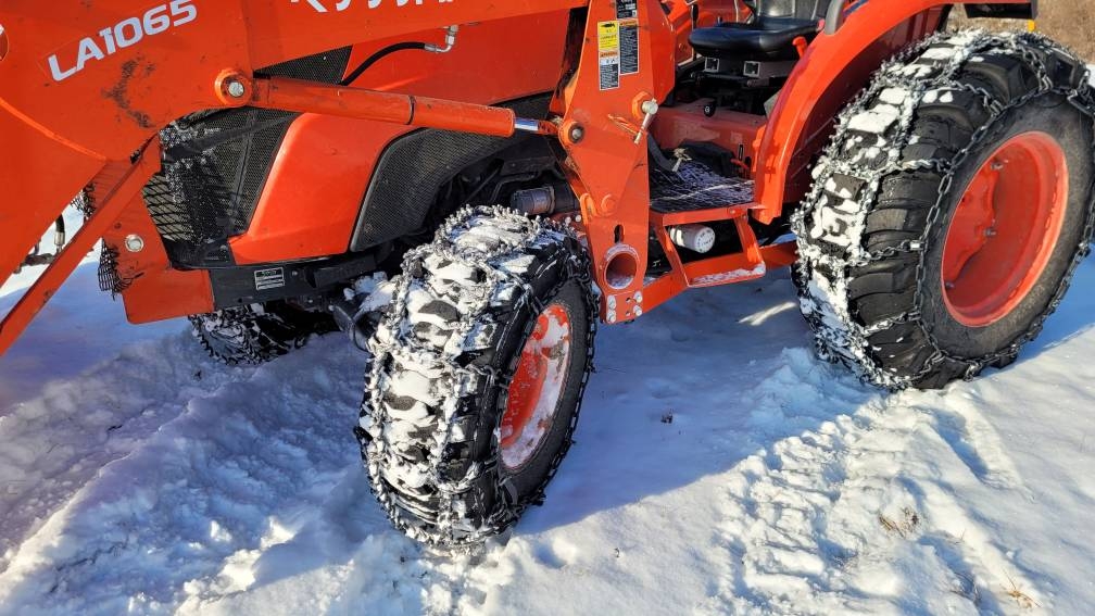

Those are excellent suggestions, thanks. Pretty much have them on the last links available outside (first pic) and inside (second pic). Have also tried increasing tire pressure after mounting and it does help somewhat.
Although these chains were recommended for my tire size, I had to adjust by removing one cross link and shortening the sides a little, but this was as small as I could go.
They aren't crazy loose without the bungees, but I am pretty paranoid about having them hit the three-point arms or fenders.

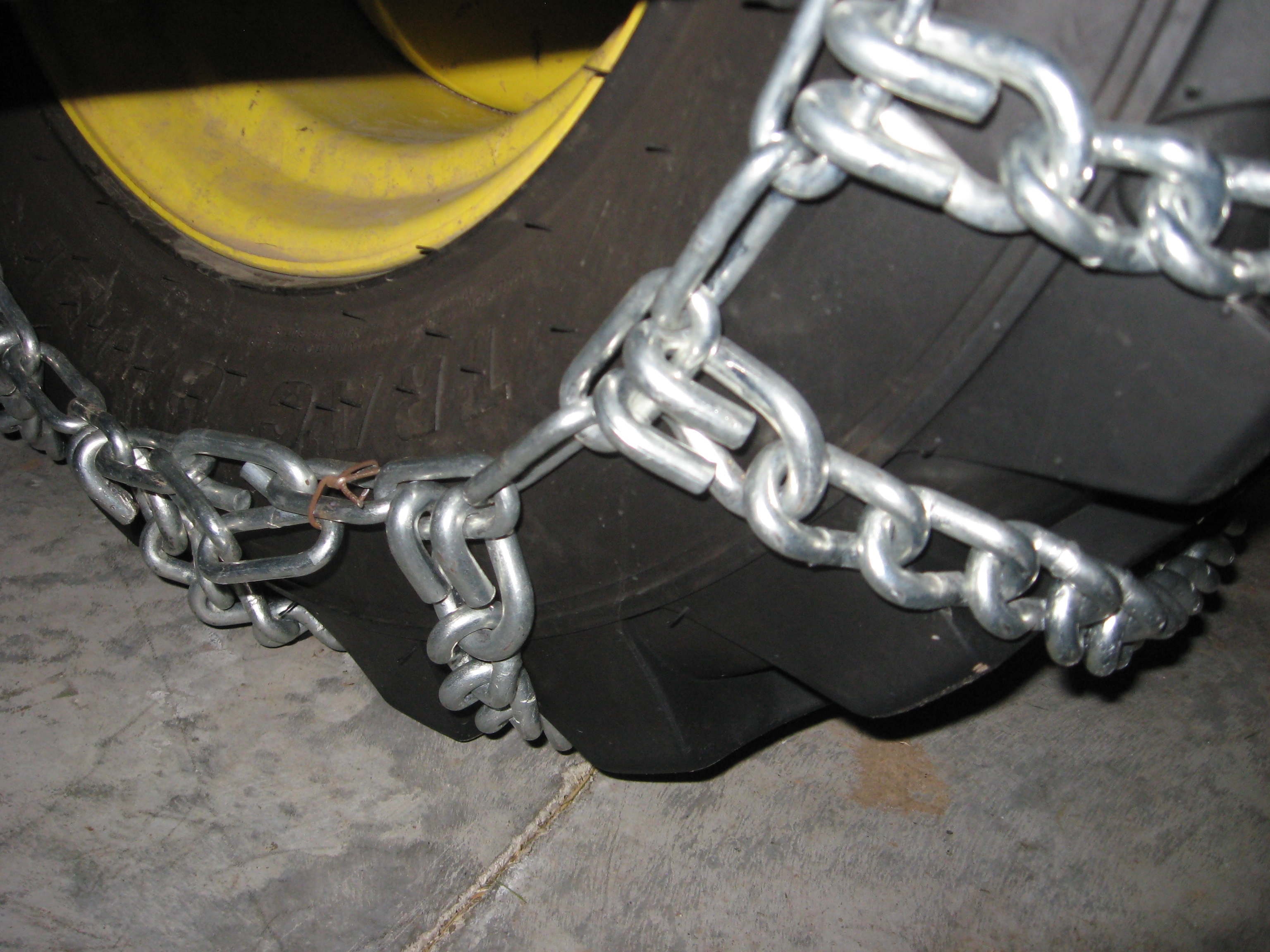

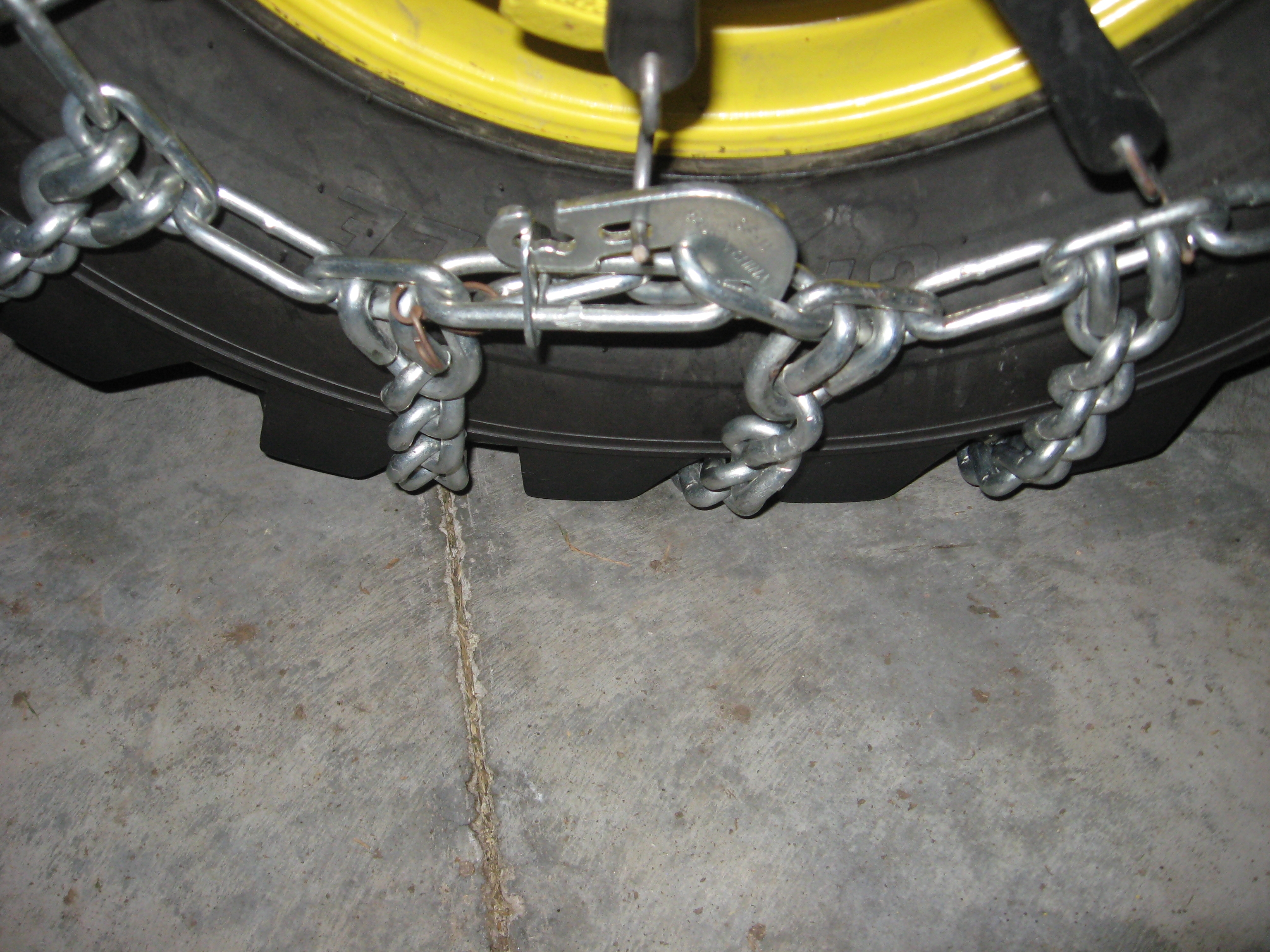

I ran my chains with rubber snubbers for several seasons and for the same reasons - I didn't want to take a chance on them hitting anything.
After my rubber snubbers started to age, I decided to try to make the chains reliable iby removing and added links so that just closing the over-center levers would make them fit snugly.
It took awhile, but I'm slow, patient, and enjoy working metal. I still safety wire the over-center lever. Goodby bugees. It is much easier to put the chains on now. As a side bonus, they fit good enough to use anywhere there is poor traction year round.
Looking at your photos, you could strart by removing one or more links from all the cross chains using a vise and leverage to open and close the cross-chain double hooks, and a grinder or hacksaw to remove cross chain links. Keep the cross chains flat. Twisted links like those make that easy. Make changes slowly....
There are places online that sell tire chain parts; wish I'd known that at the time.
Luck,
rScotty

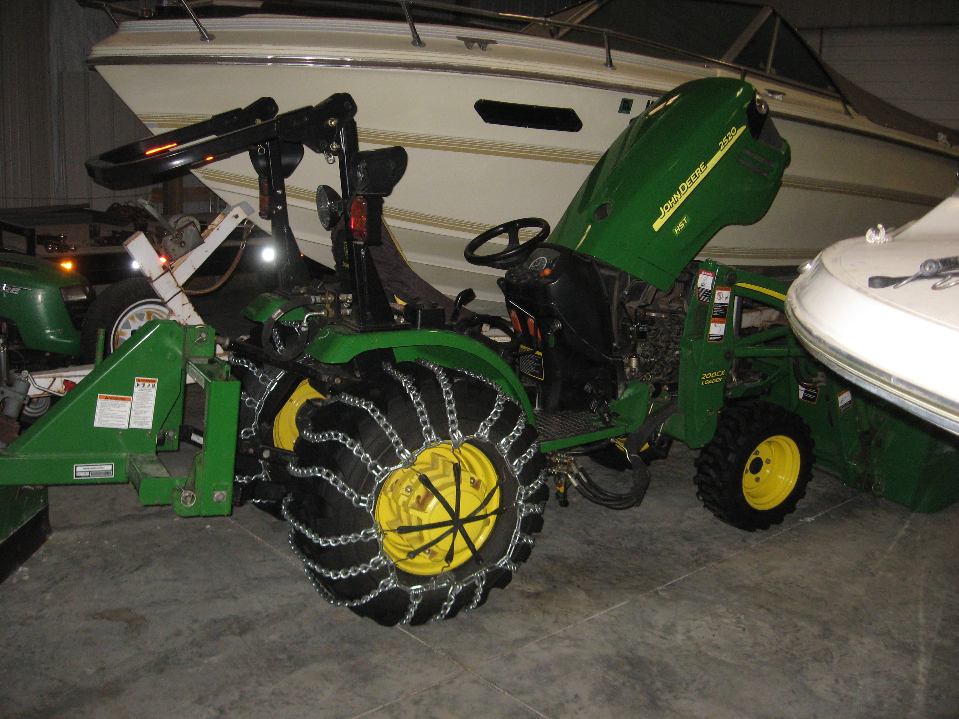

Here is how I install chains, works quick and easy for me. With tractor in garage and front wheels chocked:
1. Use floor jack under drawbar to jack up back of tractor.
2. Release parking brake.
3. Lay chains on floor next to tire with the outer side DOWN and very carefully work out all the kinks.
4. Slide chain under tire with BACK end of chain lined up with back of tire.
5. Lift BACK end of chain up and hook it on most convenient lugs of tire.
6. Hold end of chain against the tire and rotate wheel so BACK end of chain goes over center of top of wheel and lock parking brake (or just hold onto the wheel so it can't rotate backwards).
7. Slide under tractor and fasten chains
8. Apply safety wires and bungees as necessary/desired.
9. Repeat for other side.
