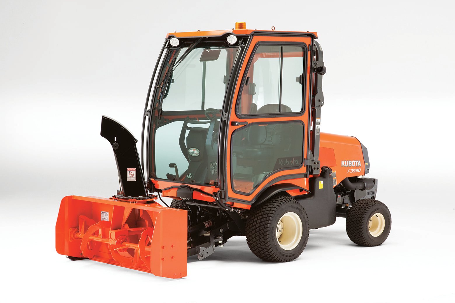

A friend has exactly the tractor U want. (not 4 sale)
It is a Kubota product that has rear steer and is essentially set up like a 0 turn landscape machine.
Looks like he is driving backwards!
The product is offered with sweeper, mower, blade and his has a heated cab with wipers front and back.
Oh, and diesel powered.
(He only has the blower attachment which is all hydraulically controlled).
It is a very agile machine with fantastic visibility plus is 4 x 4 and hydrostatic drive.
To see it in action is like watching a forklift maneuver in a crowded warehouse.
Wish I knew the model # but I'm sure any Kubota dealer can advise you.
The only downside was weight on the steering wheels but we added weights at that end.
If that machine had chains on the drive wheels I think it could even climb a cliff!

Sounds like a Kubota F series mower, which can mount a 50" blower or ? 60"blade, JD and NH have similar units;
It would take at least 3 maybe 4 passes for a narrow driveway.

Piloon, is your friend's machine a Kubota F3390? I had looked at the JD equivalent (1585) as an option to get rear steer. It seems a little low on horsepower, I'd be worried about fitting aggressive chains, and I'd like a back blade (and a loader for summer). I do worry about turning radius. The Kioti DK has a 74" blower and is 63" wide, which should lead to a ~100 ft turning radius. The Kubota L6060 also has a 74" blower but is 67" wide which should lead to a 170ft turning radius. I might be able to bolt some wings on the side of the blower to get another couple inches on each side, and the sharper turns would require some back-and-forth. It looks like the euros (ferrari, antonio carraro, etc) have tractors in the 50-ish HP range with reversible controls, but obviously little dealer support and also not great loader options (and also no back blade).
