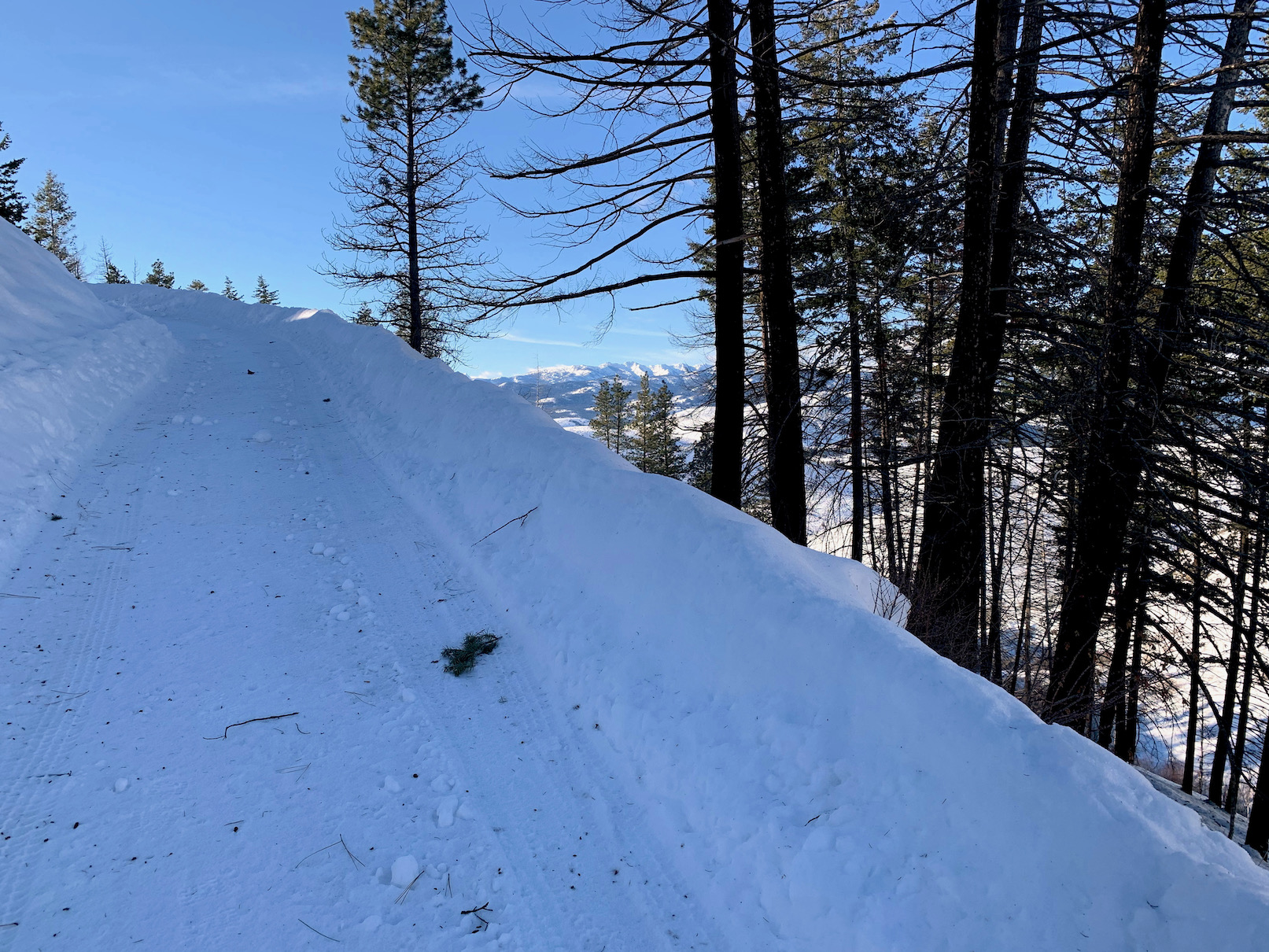

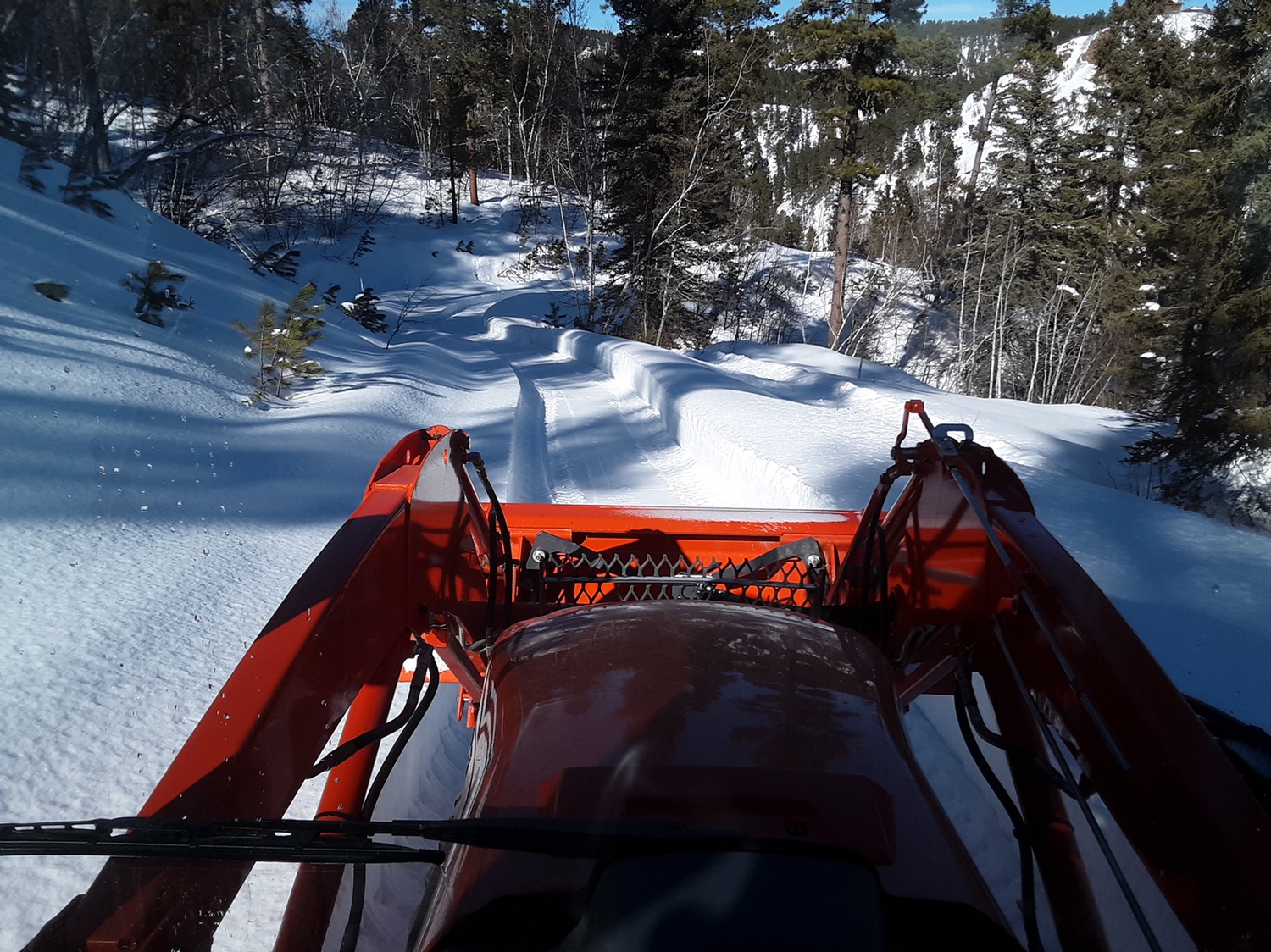

I'm in the mountains/foothills of WA with a 1-mile dirt/gravel driveway that is seriously steep (13% average, 21% maximum), plus another half mile that I share with neighbors. The driveway is narrow and curvy, and is cut across a steep hill so the edge drops off. We get about 100 of snow per year. Our plow guy has trouble with the volume some years (like this year), so I'm thinking about getting a tractor with a blower to take care of it myself. This would have the additional benefit of avoiding the plow piles that keep the driveway muddy in the spring after the rest of the snow has melted off. I don't want to be craning my neck for 2 miles every time it snows, so it's going to need to be a front blower. And, unless someone wants to talk me out of it, hydrostatic transmission and a cab. I have JD and Mahindra dealers an hour away, and Kubota, Kioti, New Holland, MF, and Bobcat dealers 2 hours away. At this point, I'm mostly looking at Kubota and Kioti.
My main question is around horsepower and ground speed. I don't want to spend more than an hour on a normal 6" snowfall, which means I normally need to be moving 2 mph at a minimum, hopefully at least 3 mph. Many people seem happy with the B2650, and people talk up the Kubota blowers a lot, but based on YouTube videos I've seen they are often moving fairly slow when blowing (perhaps close to 2 mph). If I buy a Kioti, I'm looking towards a 50+ hp DK. Will double the power that translate to being able to move twice as quickly when blowing? Kioti's literature on their DK-compatible blower recommends 25-40 PTO hp. Will it actually be able to effectively use all 40 hp, or does the snowblower design lead to declining ROI with each additional hp? What if I put it on a DK6010SE (which has 45 PTO hp)?
Reliability is a high priority--my driveway is trailer-unfriendly, and with the distance to the dealer it would become quite a headache. Being stranded in the winter would be especially unfortunate. Other than blowing speed and reliability, there are some additional priorities. In the winter, a heavier tractor would do better at breaking up driveway ice (I would have chains, of course), and would be more effective at pulling a stuck vehicle (which I hope won't happen, but good to be prepared). In the summer, my only regular use would be driveway maintenance, but there are lots of projects where I'd love to have a tractor with a FEL to move heavy things around (including when we build a new house to replace our cabin).
For winter maintenance of a steep, high-consequence driveway, what else should I be thinking about? From what I'm reading in threads, a rear blade to get more snow off the driveway (and reduce ice build-up) is a must. Is a salt/sand spreader effective, and if so, how much sand should I be spreading on a 1-mile driveway when I think things are going to get icy? Is there a better way to add traction to an icy surface (or avoid the ice altogether)?

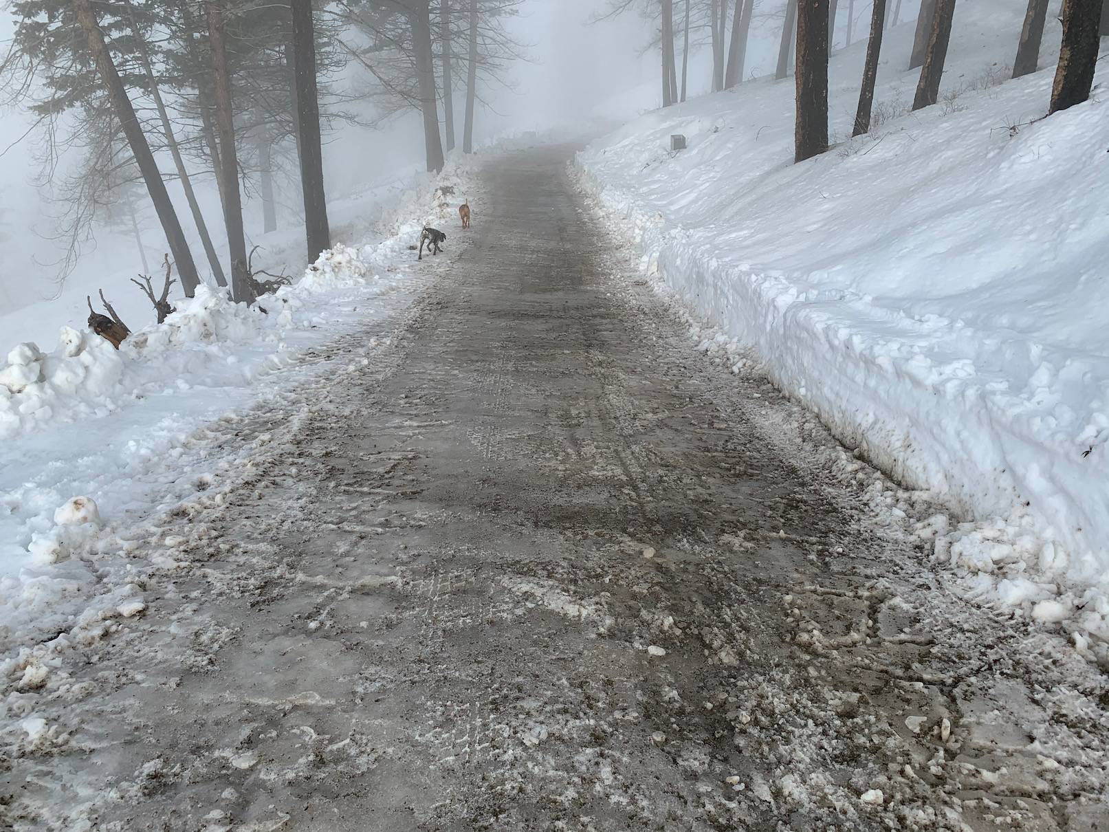

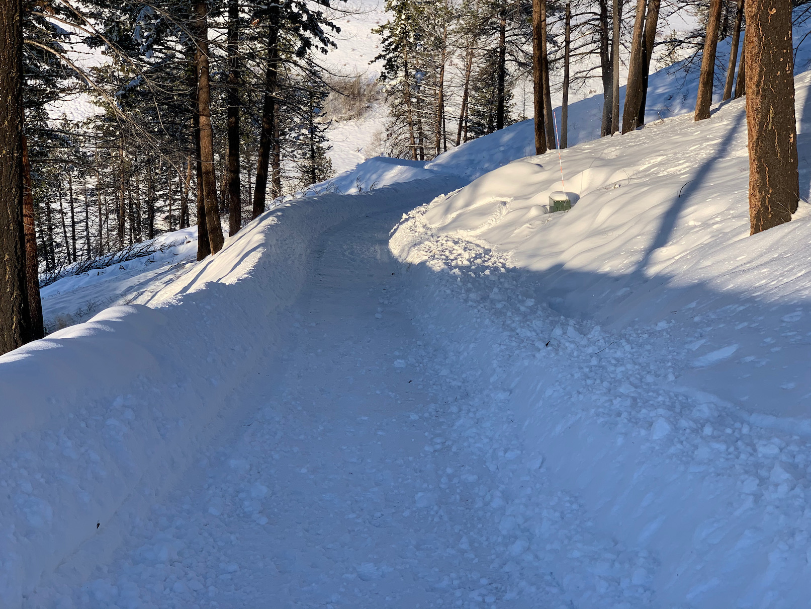

I really appreciate the insights and advice, folks. There are a lot of questions, so I'll try to cover them in groups instead of individually. I'm also attaching some photos of the driveway. We had a Cat 930K come yesterday to deal with our plow piles, and a sand truck came today. Two of the photos are before the Cat came, one photo is after the Cat but before the sand, and one is with the sand down.
I wouldn't necessarily call 6" a normal snowfall--sometimes it's sometimes 1" or 2", sometimes 8", sometimes in between. It's not often much more than 6", and it would be very rare (less than once per winter) to get more than 16" in a day. We're on the east side of the mountains, so the snow is usually dry. I used 6" as the guideline because it's usually less than that, and the handful of times per year it's more than 6" I'm not averse to spending extra time blowing at a slower speed (as opposed to spending a lot of money on a monster tractor that can blow any amount of snow at 3 mph). Snow drifts are uncommon. We've had the property three years--the past two winters have been mild, and this winter is closer to normal. This winter is the first time we've had a problem with ice buildup. In previous winters the driving surface was usually snow, but good snow tires were always sufficient (blizzaks on the car, hakkas on the truck). Sunny days and ground heat would reduce the mass, and cold clear nights would cause frost growth on the surface.
Our plow driver had a V-plow and got stuck with some frequency (taking an hour+ to get unstuck). His equipment (truck, tires, chains) weren't the best, but he was experienced. He quit on us this weekend after getting stuck badly and missing other clients (I don't blame him, an unfortunate situation); we'll see how the next plow driver does. No matter how good the plow driver is, on high-volume winters the piles will eventually require machinery. I don't want to go through the learning curve of plowing on a high-consequence driveway, I don't want to deal with plow piles during the winter, some places (especially around the house) don't have good places to put piles, I don't like the extra driveway mud from plow piles in the spring melt, and I want the flexibility to leave the big snowfalls to blow in one pass instead of waking up in the middle of the night to do an intermediate pass. For all those reasons, I want to blow instead of plow. And perhaps silly, but I prefer the aesthetics of a blown driveway compared to plow piles. Captain Dirty, your point about keeping a plow contractor while I learn the ropes is well-taken. The sand today was delivered today at a good price and without fuss, so maybe that's the last job I'd try to take on myself.
We have ~100 acres, but almost entirely steeply hilled. I have no desire to farm or otherwise touch most of it. Around the house we have a few acres to landscape/etc, but I can manage that mowing with my BCS. The tractor is primarily for winter snow removal, and the only summer activities are moving heavy things with the loader, and maintaining the driveway (box blade, land plane, or similar). I certainly have no high-horsepower requirements in the summer. If it weren't for the snow removal, I'd probably buy an old lower-hp open-station tractor with a decent loader for the summer tasks.
The advice here seems to be to definitely aim higher than the Kubota B/Kioti CK series. There are a few youtubers with extensive collections of front-blower videos. In particular, Mark Holbrook's channel has a lot of videos with a front blower on a Kubota L4760 in Idaho, which should be fairly similar to my climate (albeit with more drifts). He seems to move at a decent pace when blowing 6", and so I'm using that setup as a benchmark in my head. Based on that benchmark, is upgrading the hp to the L6060 going to come with a noticeable increase in blowing pace? (sounds like going with the high HP is a good idea) And is switching from Kubota L to Kioti DK without changing the HP or blower width going to have similar performance? (not sure)
Leonz, your recommendation to use a row crop tractor while rear facing is definitely interesting. I had seen that such tractors exist, but assumed they were so astronomically expensive that it wouldn't make sense given the lack of summer use. I would appreciate the rear steer so that the wheels more closely follow the path of the blower. In addition to the cost, I'd be worried about the ease of operation/maintenance of a used tractor engineered for large farms compared to a Kubota Grand L built with less experienced owners in mind.
fishhead, your story about sliding on a 20% slope with v-bar chains on all four tires certainly got my attention. Were those cross-link chains or a web/net-style like Aquiline Talon or Trygg SMT? How heavy was that tractor?

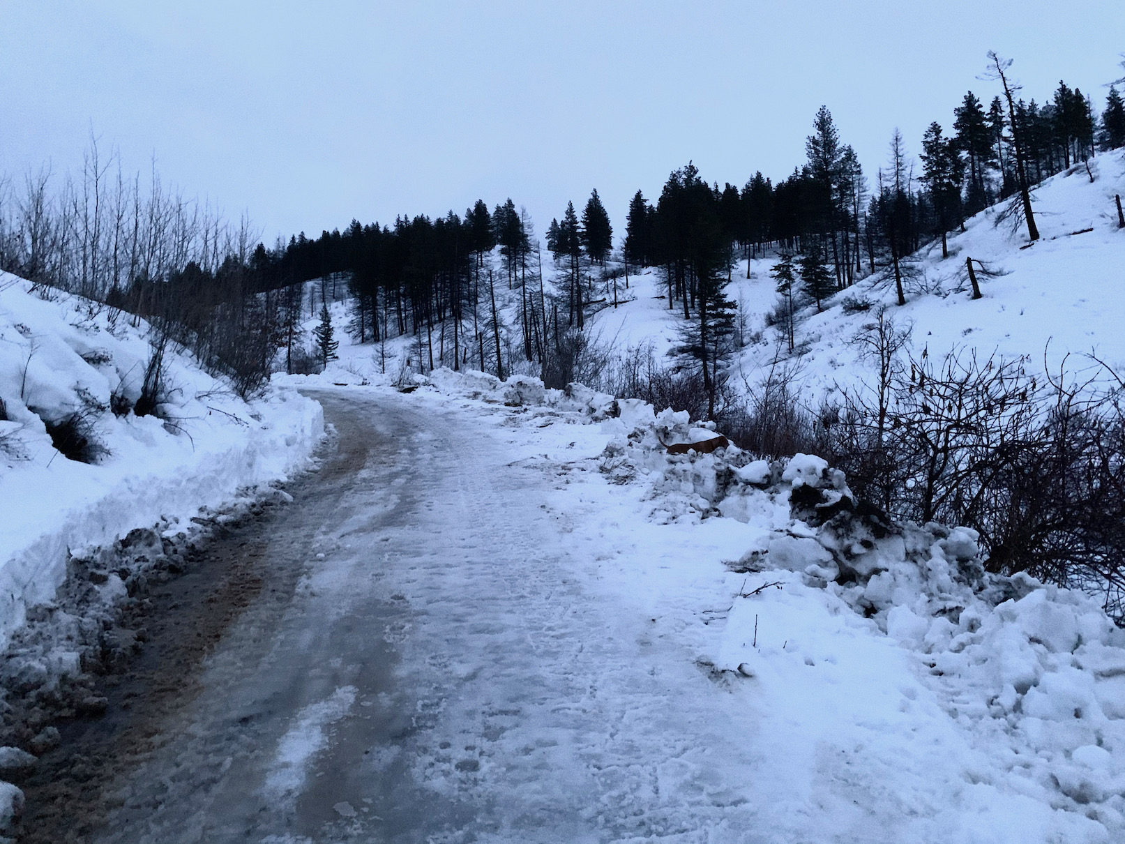

View attachment 685221View attachment 685222View attachment 685223View attachment 685224
So, the person that came and plowed used a 29,000 lb end loader that had chains? Looks like a good choice of tool for the job. What altitude is the property? With a diesel, lack of air really hurts you so you will want a turbo to make up for that. Also, I would be looking at equipment that is not just "front wheel assist". Get something that is made strong enough to last pulling with the front axle and has GREAT brakes.
