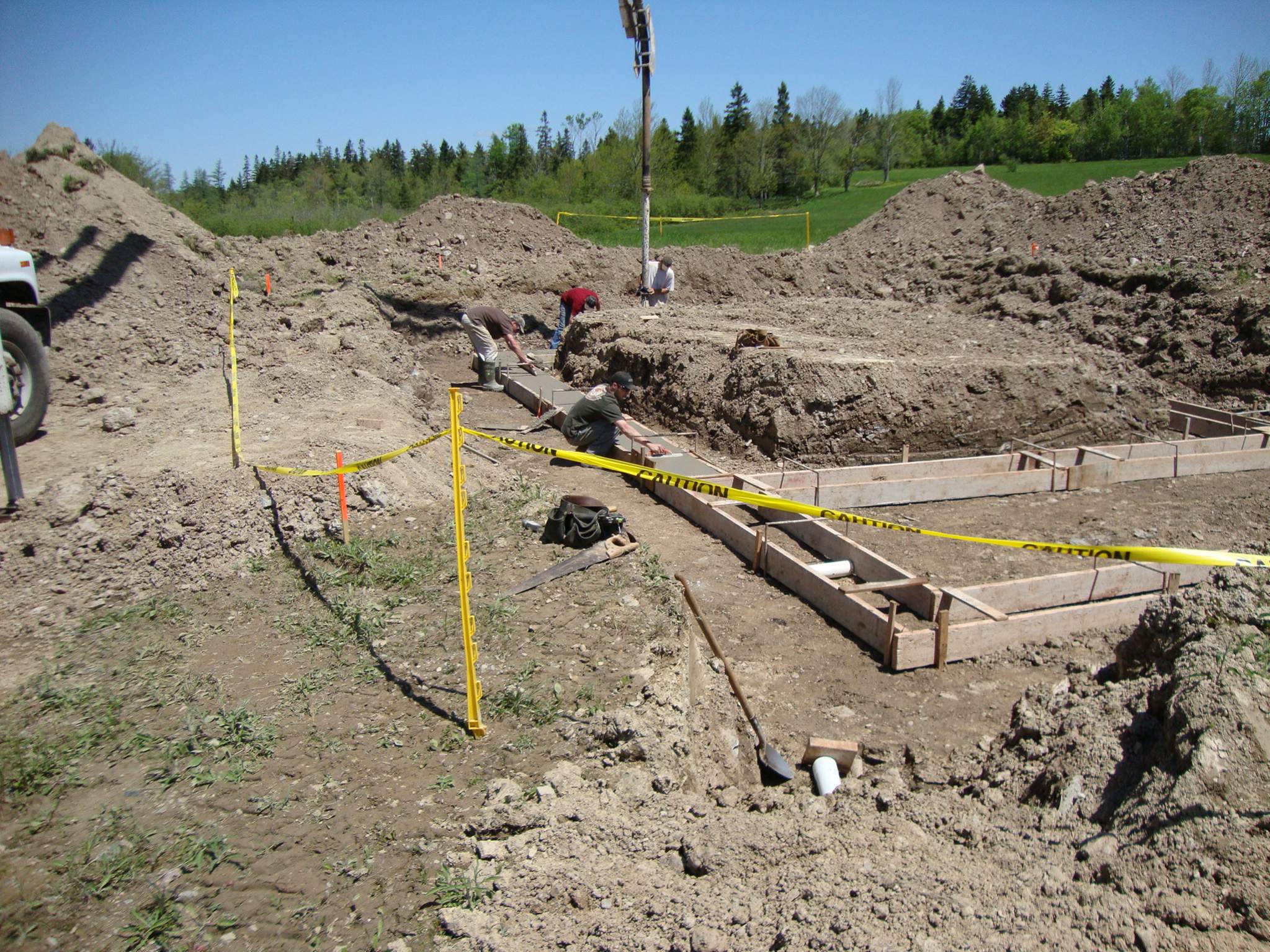

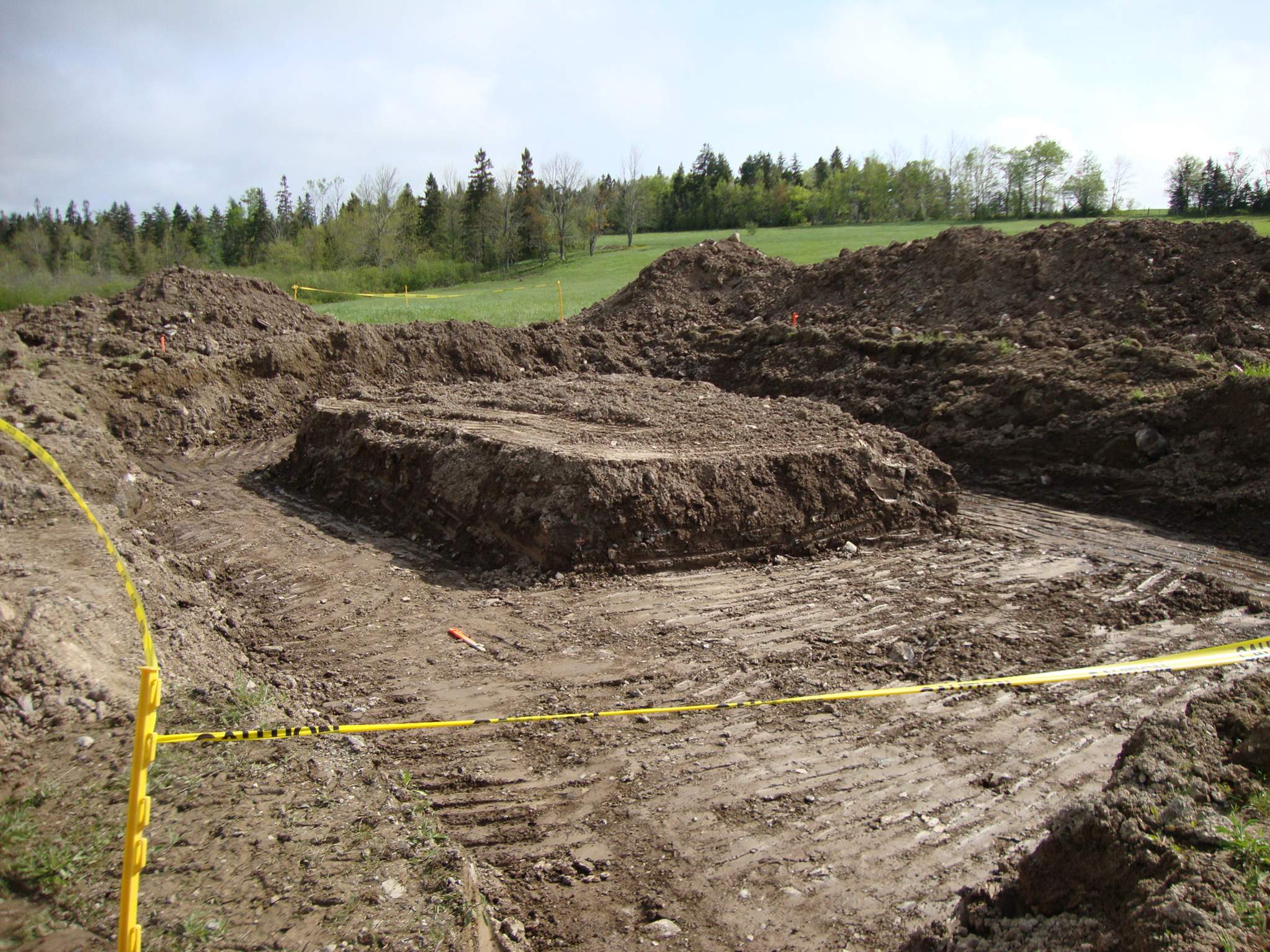

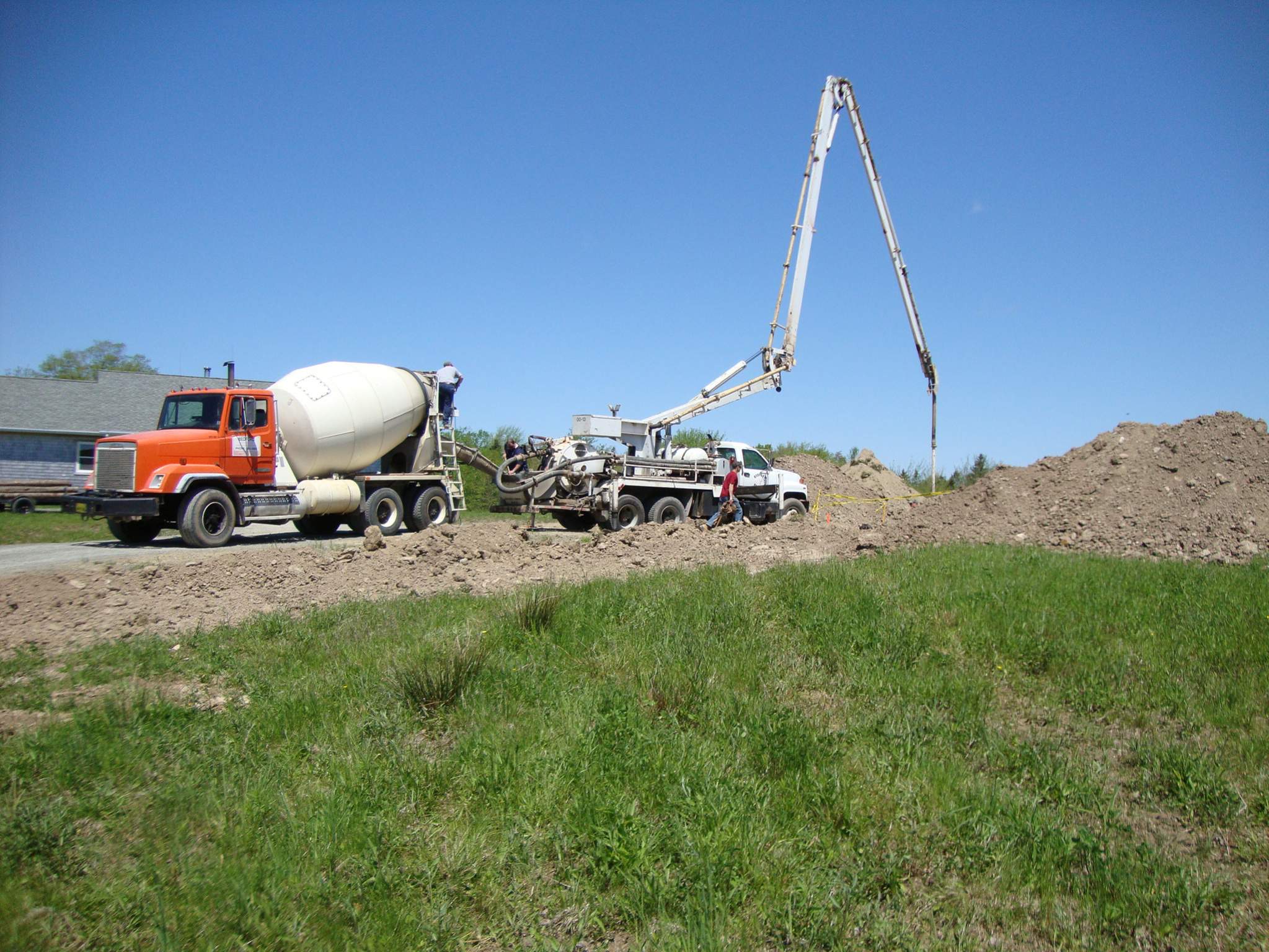

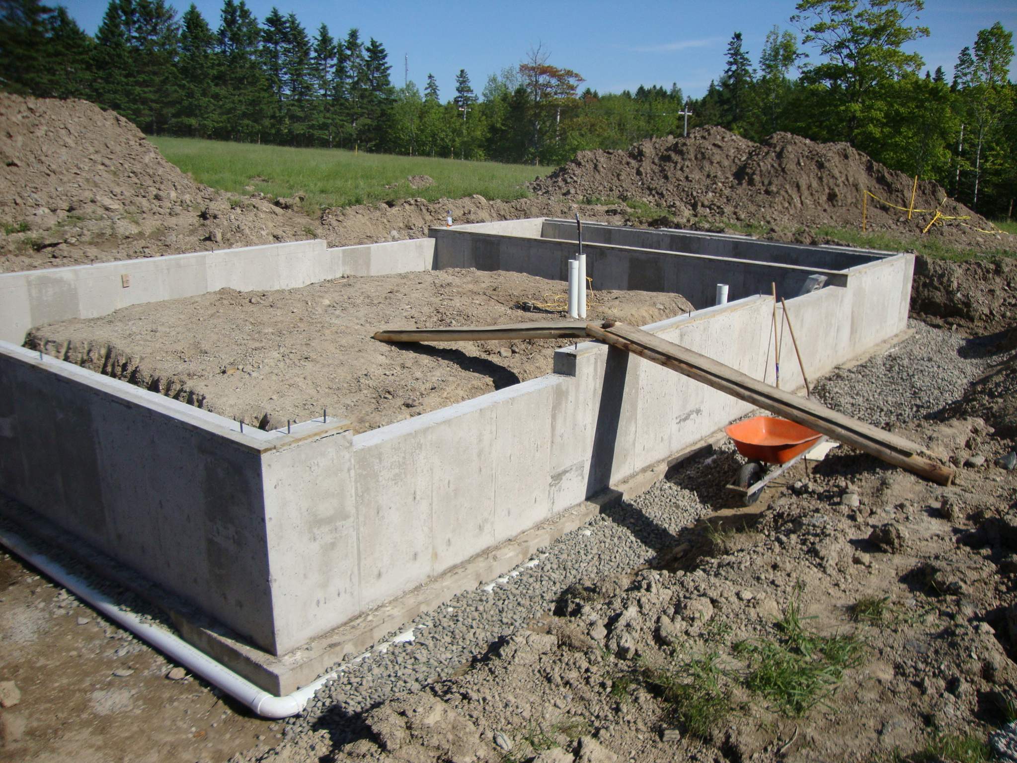

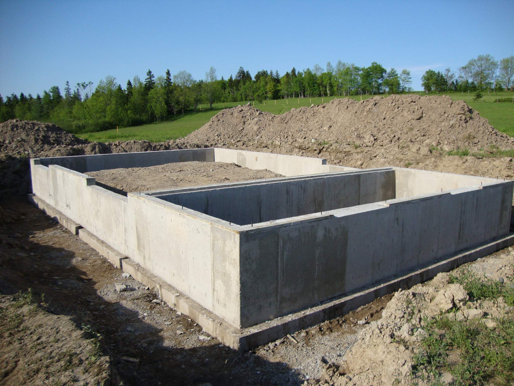

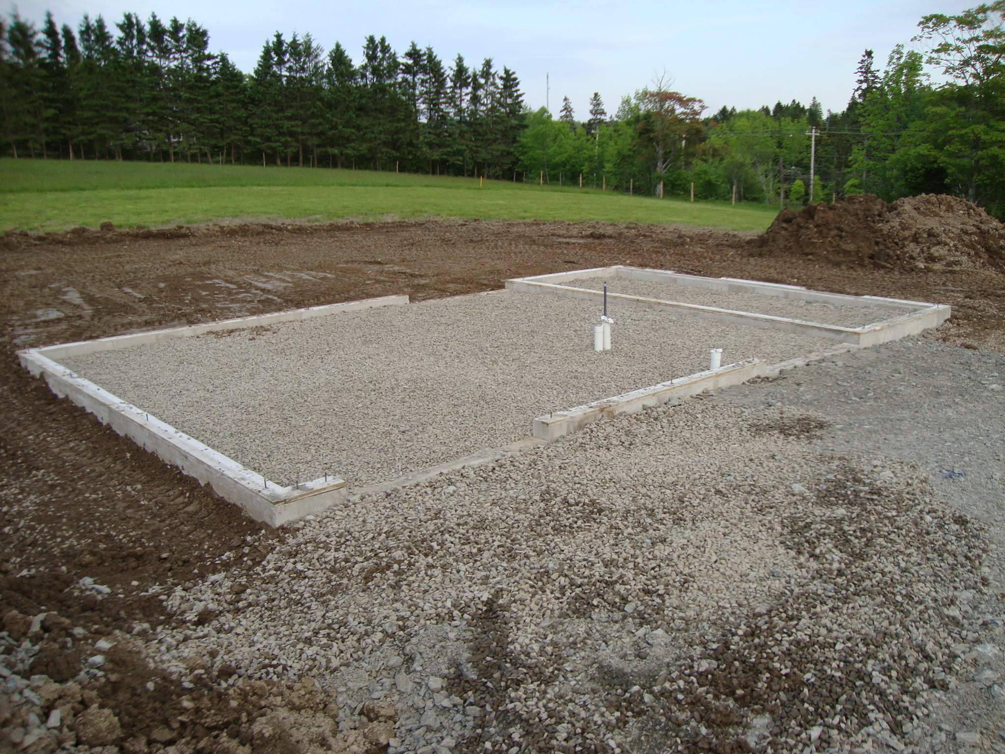

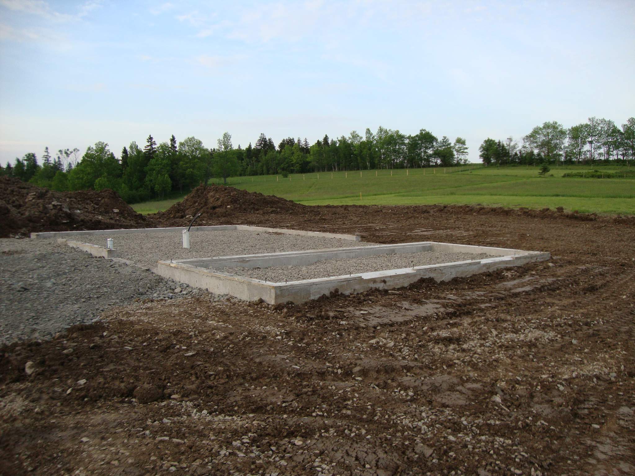

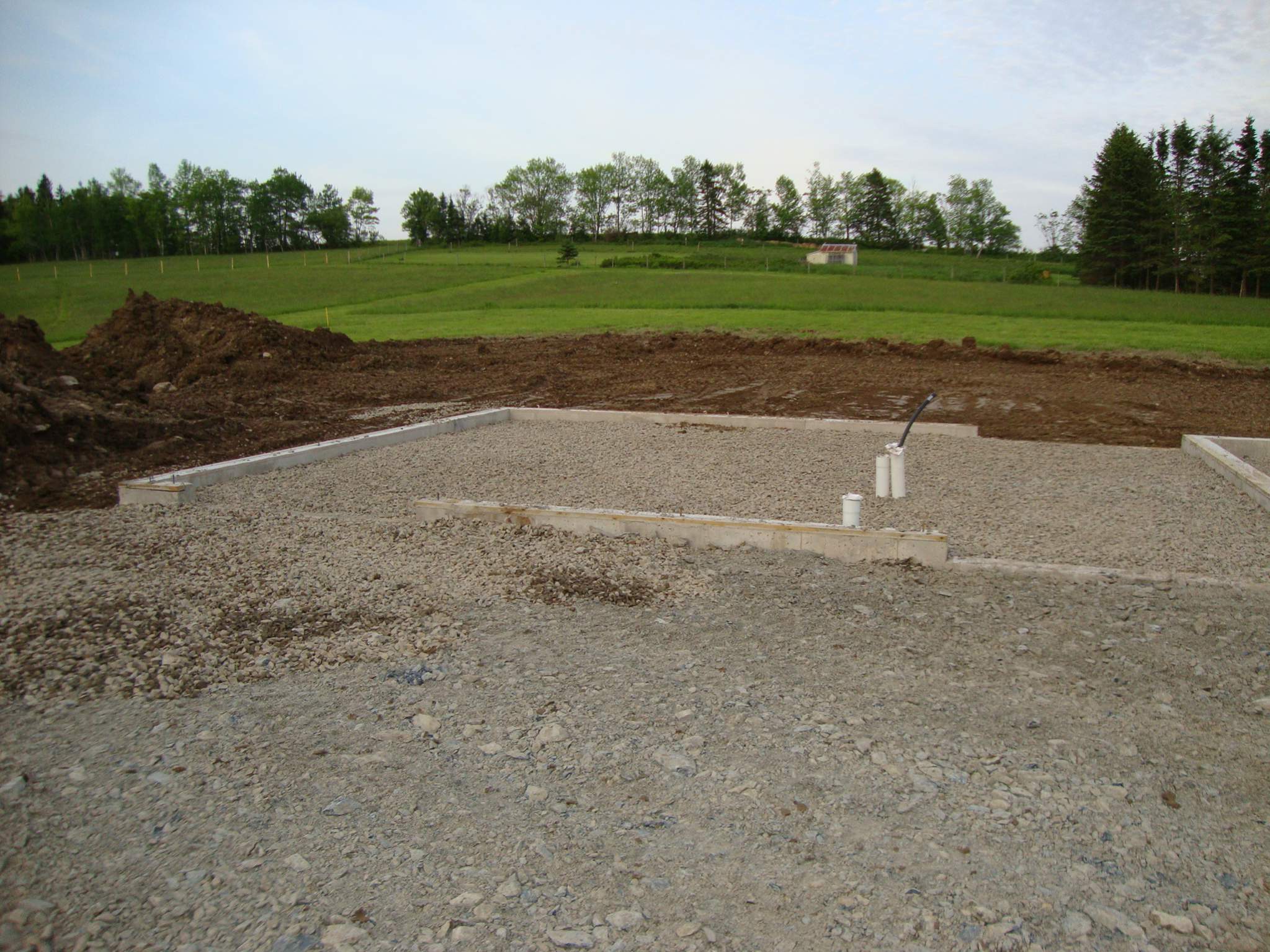

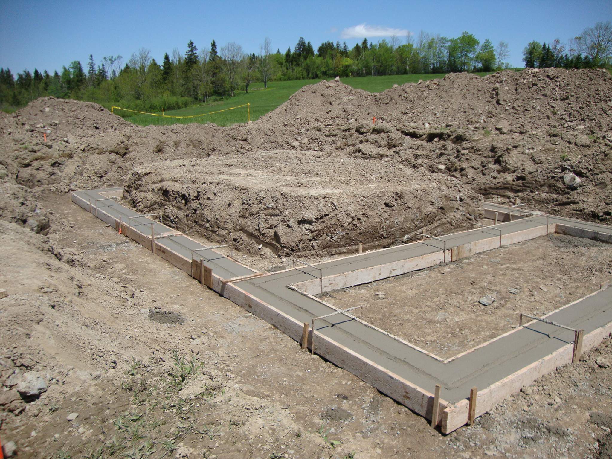

We've finally started the barn for our horses. We built the house 3 years ago, and have been putting off the barn as long as possible. Now it's time, as the missus reminds me.
We decided on a smaller size, 24 x 40 on one level, with two box stalls in one end and ground-level hay storage in the other. Concrete slab on 4 foot frost walls, with suspended plank floor in the stall area. She found some rubber stall mats to inset into the concrete in the alleyway for better footing and more cushion for the horses while they're in crossties and for farrier visits.
Initial stages are done, excavation, footings, frost walls and drain tile and underground pipe for water lines and some electrical.
I'll keep posting as the job progresses, we're expecting backfill to start on Friday, with framing due to start the following Monday.

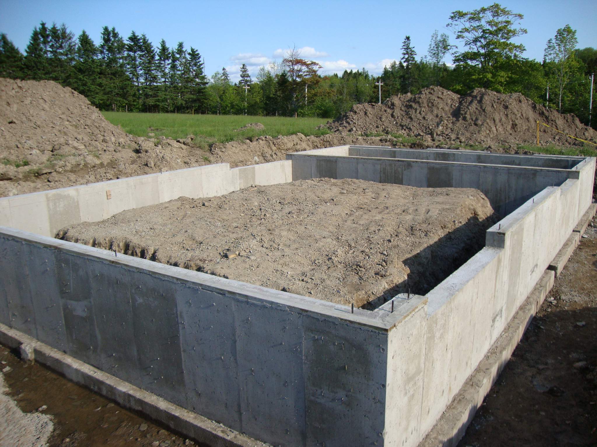

/ Horse barn project
#2
Here the footings are in, and the frost walls are up and forms stripped.

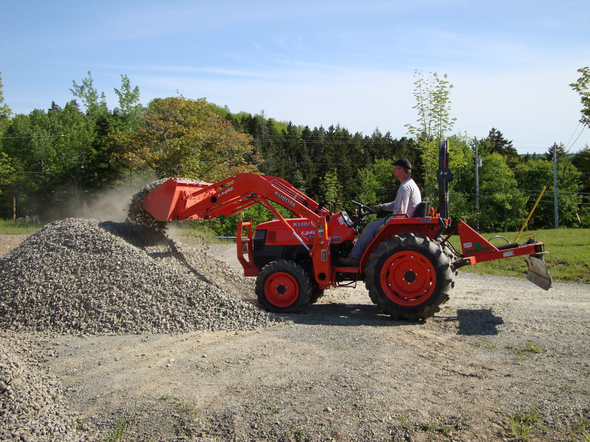

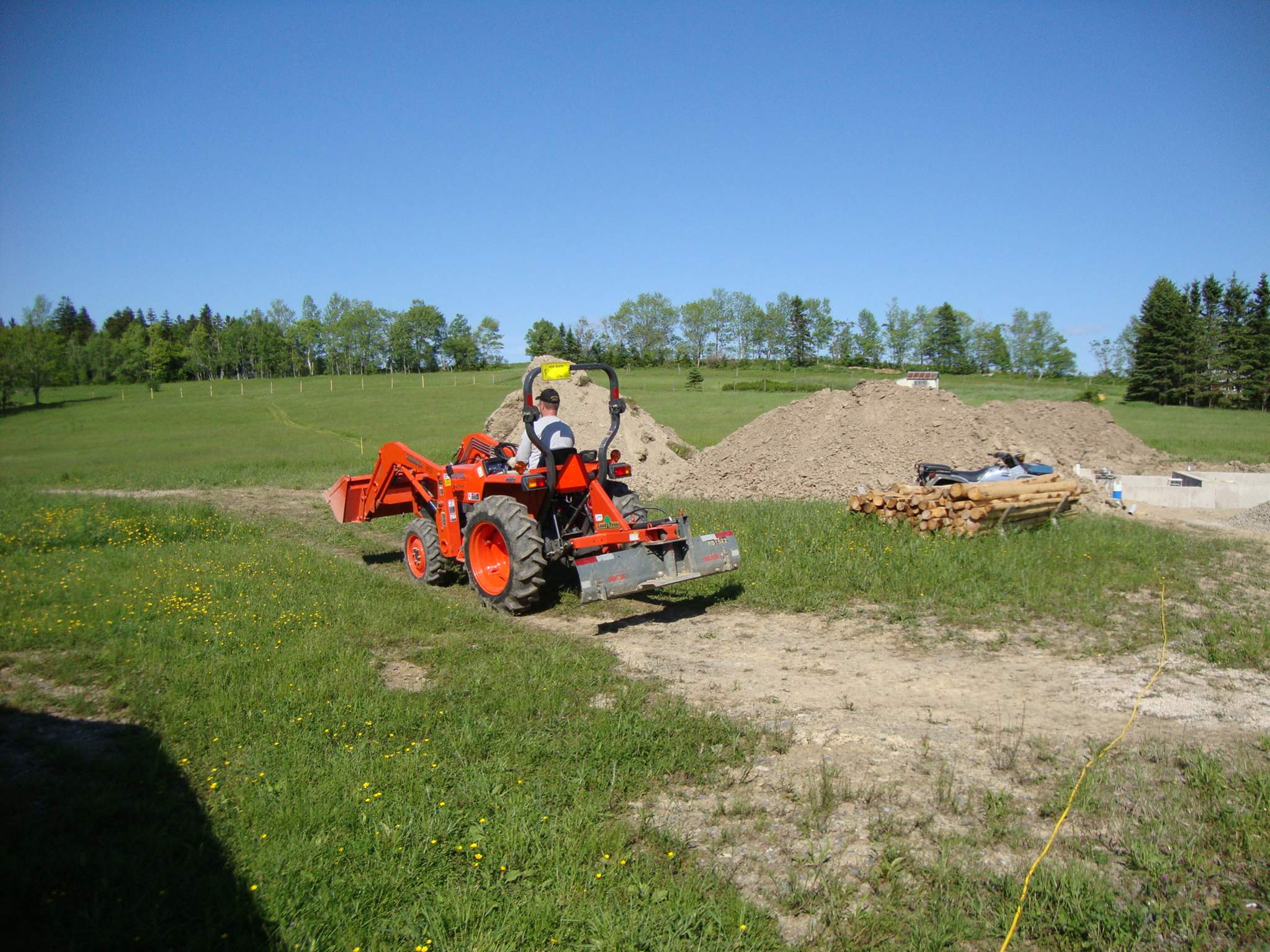

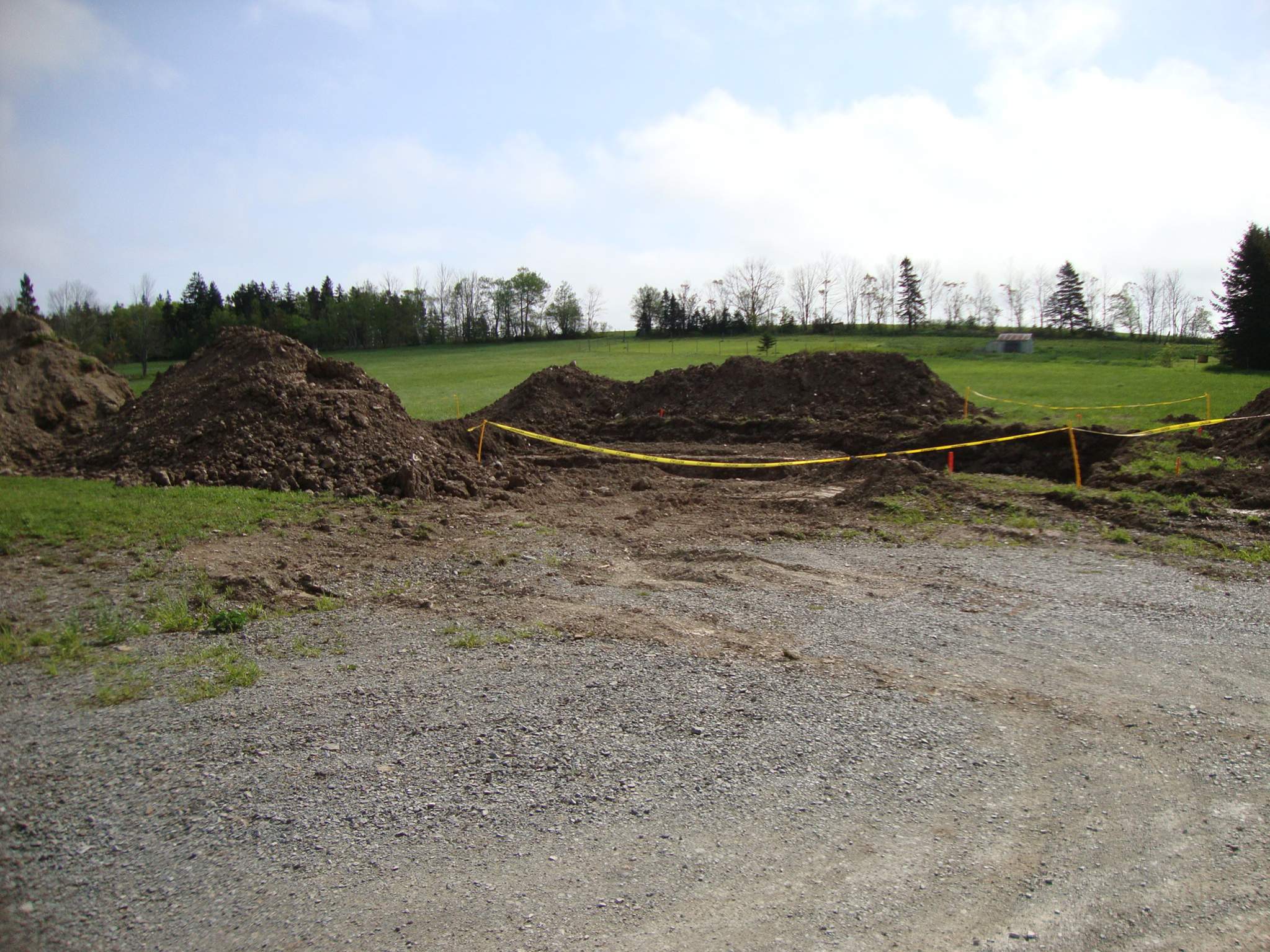

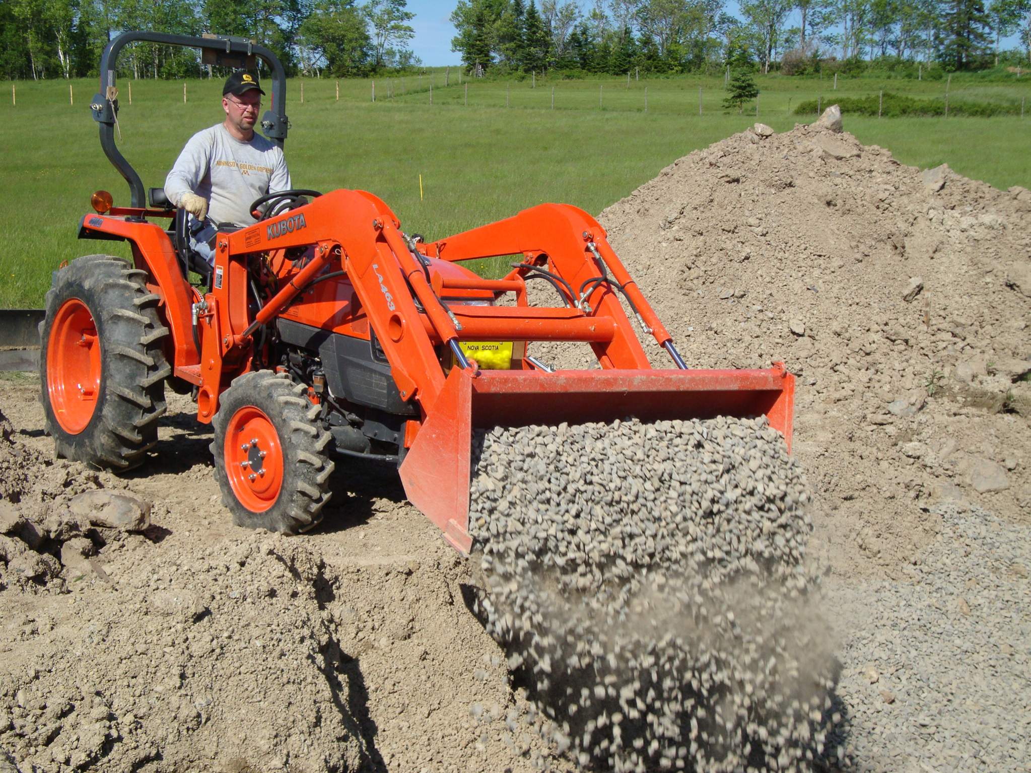

The Kubota is earning it's keep these days, what with spreading excess top-soil and fill, and moving stone to cover the drain tiles. Not much weight on the rear tires when scooping a bucketful of stone, even with loaded rears.
And yes, that IS a John Deere hat, it's what they get for not giving me a Kubota hat when I got the tractor..:laughing:

/ Horse barn project #4
Wow, that's built better than most houses around here. Why did you use footings instead of a floating slab? Why do you need a drain tile, is there going to be something below grade?
I'm interested in the stall mats you describe for the alley. Please post pictures when those go in.
We used the footings and a four foot frost wall because the two box stalls will have a suspended plank floor to be easier on the horses' legs. The open area of the foundation on the right side will be filled with rock up to about 6 inches below the top of the cement. There is a 2 inch "check" in the middle and end frost walls to lay the ends of rough-cut 2 inch planks in, which will span the 10 feet of the open area. A pressure treated 6x6 across the middle of the span will carry the horses weight.
The main part of the floor will be a concrete slab under the hay storage, tack room and storage areas. If it hadn't been for the stall areas, we could have gone with an engineered slab.
The drain tile will provide better drainage around the foundation. While not required by the building code here, it is recommended due to clay soil and a wet climate.
Sean
/ Horse barn project #6
If I die and come back as a horse I want to live in your barn. I didn't understand what a suspended plank floor was. Treated lumber is toxic for horses, how do you plan to keep the lumber on the floor from decaying? I guess just replace it when it rots.
Where does it drain to? Does it go out to daylight somewhere?

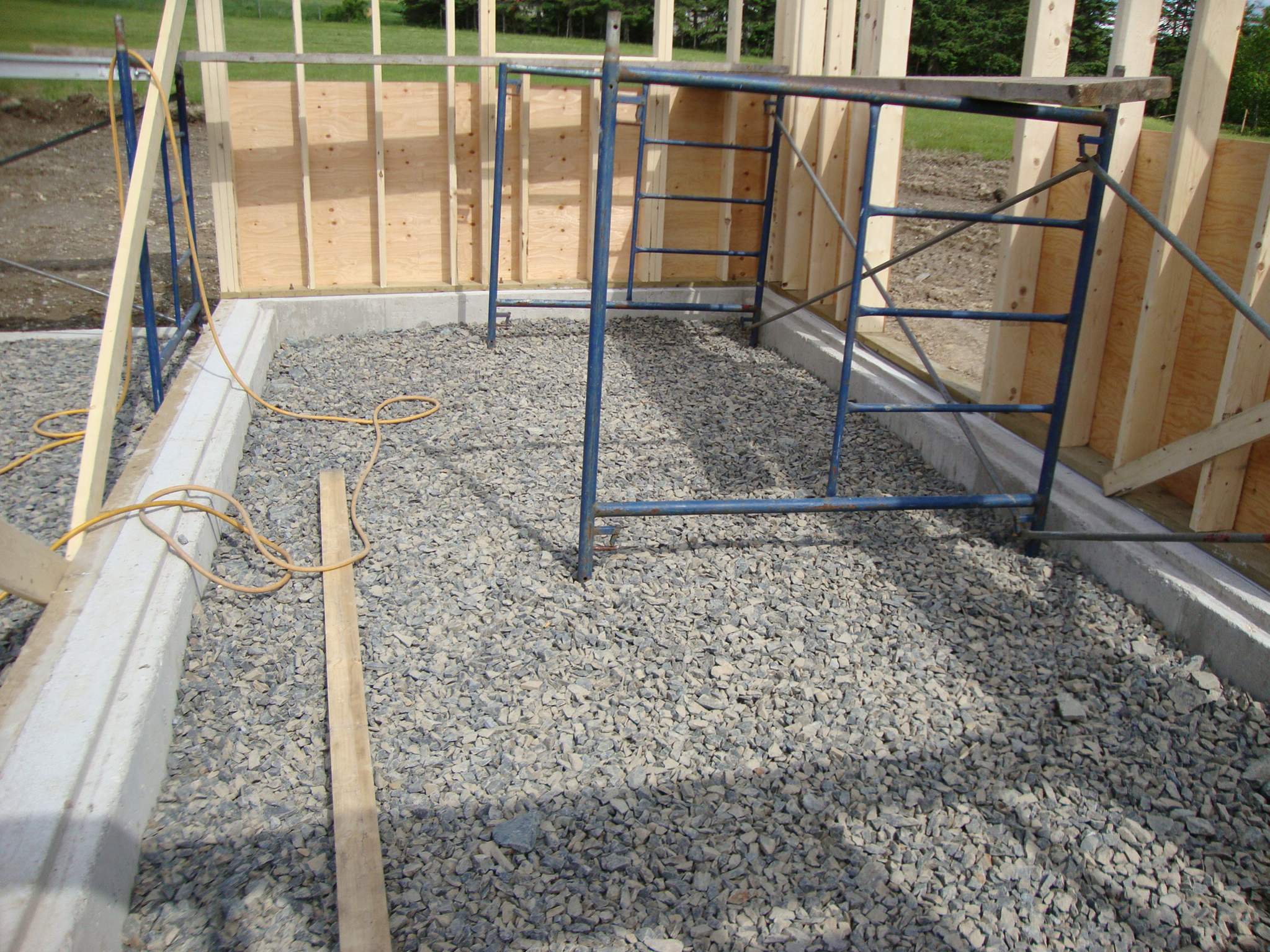

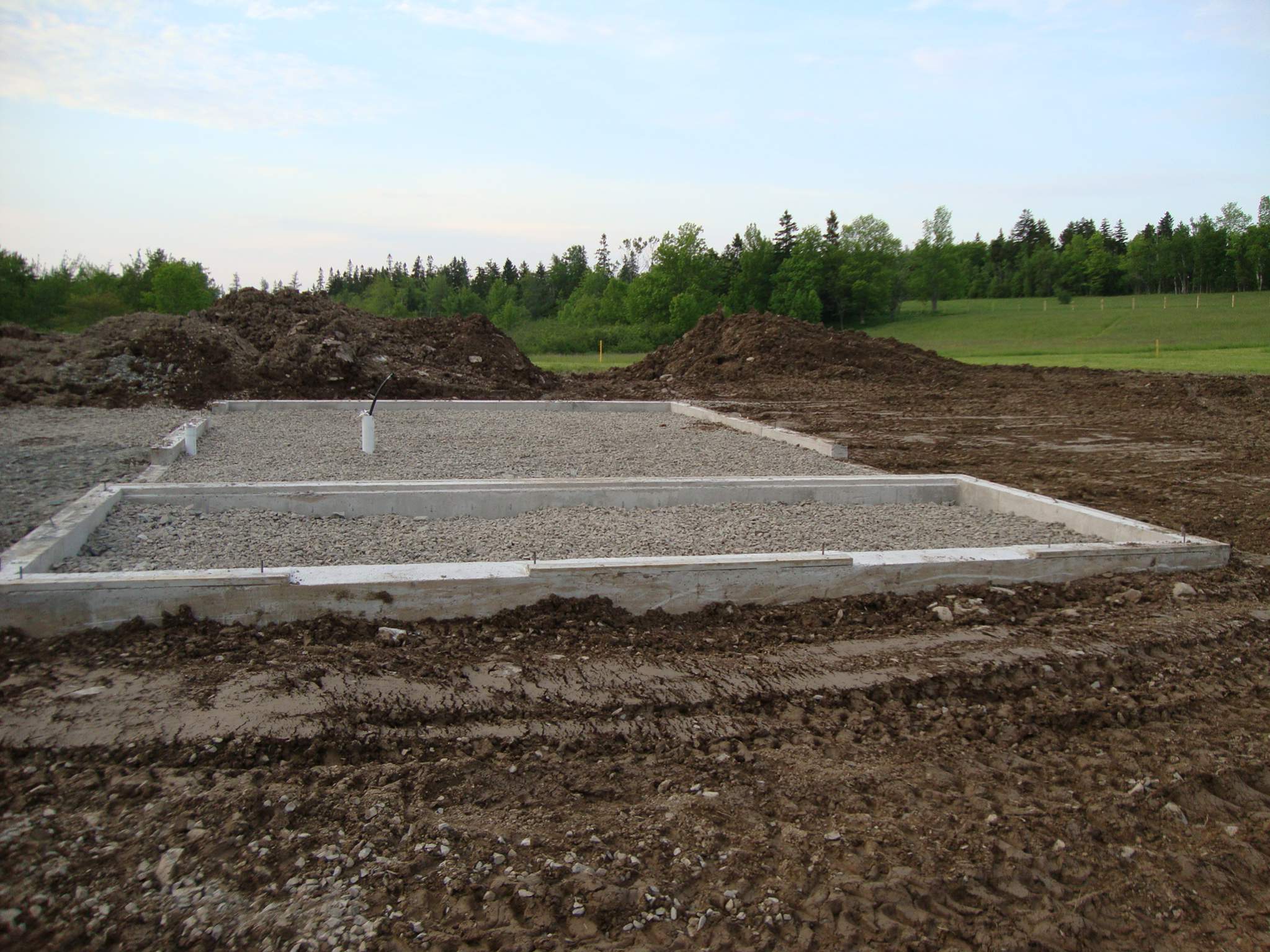

We backfilled the foundation on Friday, and built up the driveway area in front of the barn with pit-run and crusher-run rock. Started stripping top-soil from the riding ring area, but with the amount of rain we had last week it's a bit damp for that just now.
Unless it's raining tomorrow we should be able to start framing. It's me and two slightly older fellas, so I expect a pretty relaxed pace. Our target is to have the roof on and tight in two weeks, weather permitting.

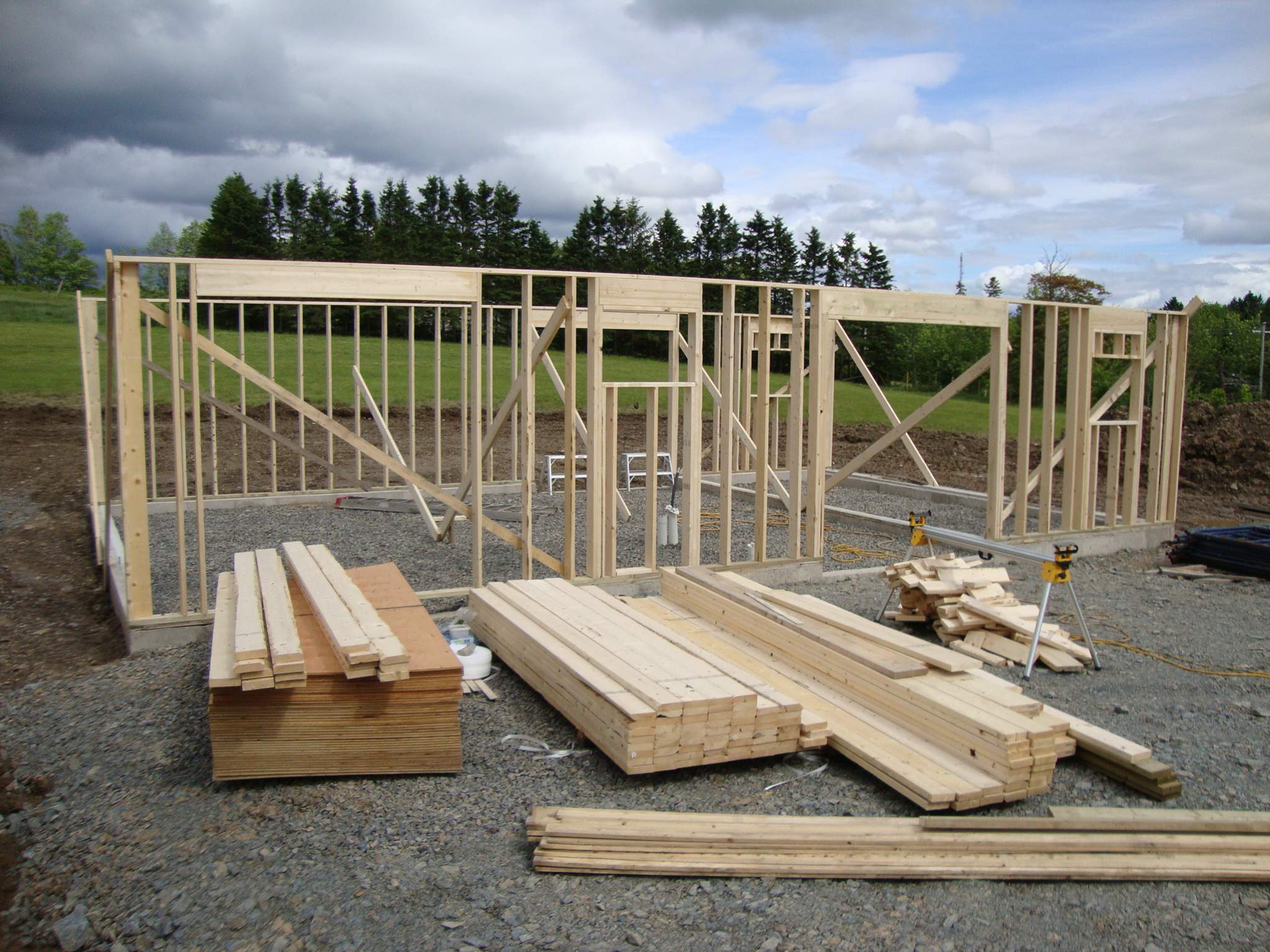

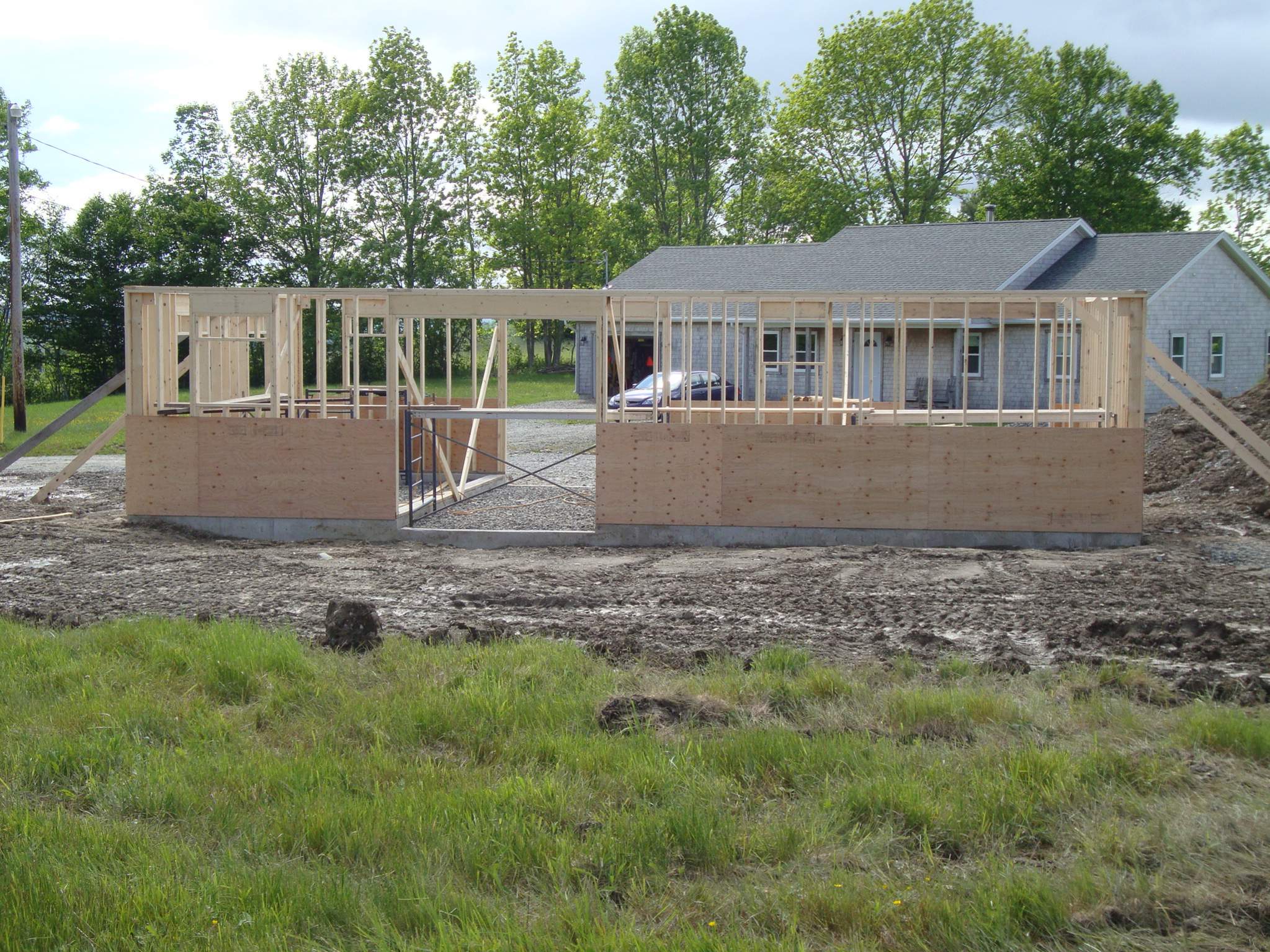

#19

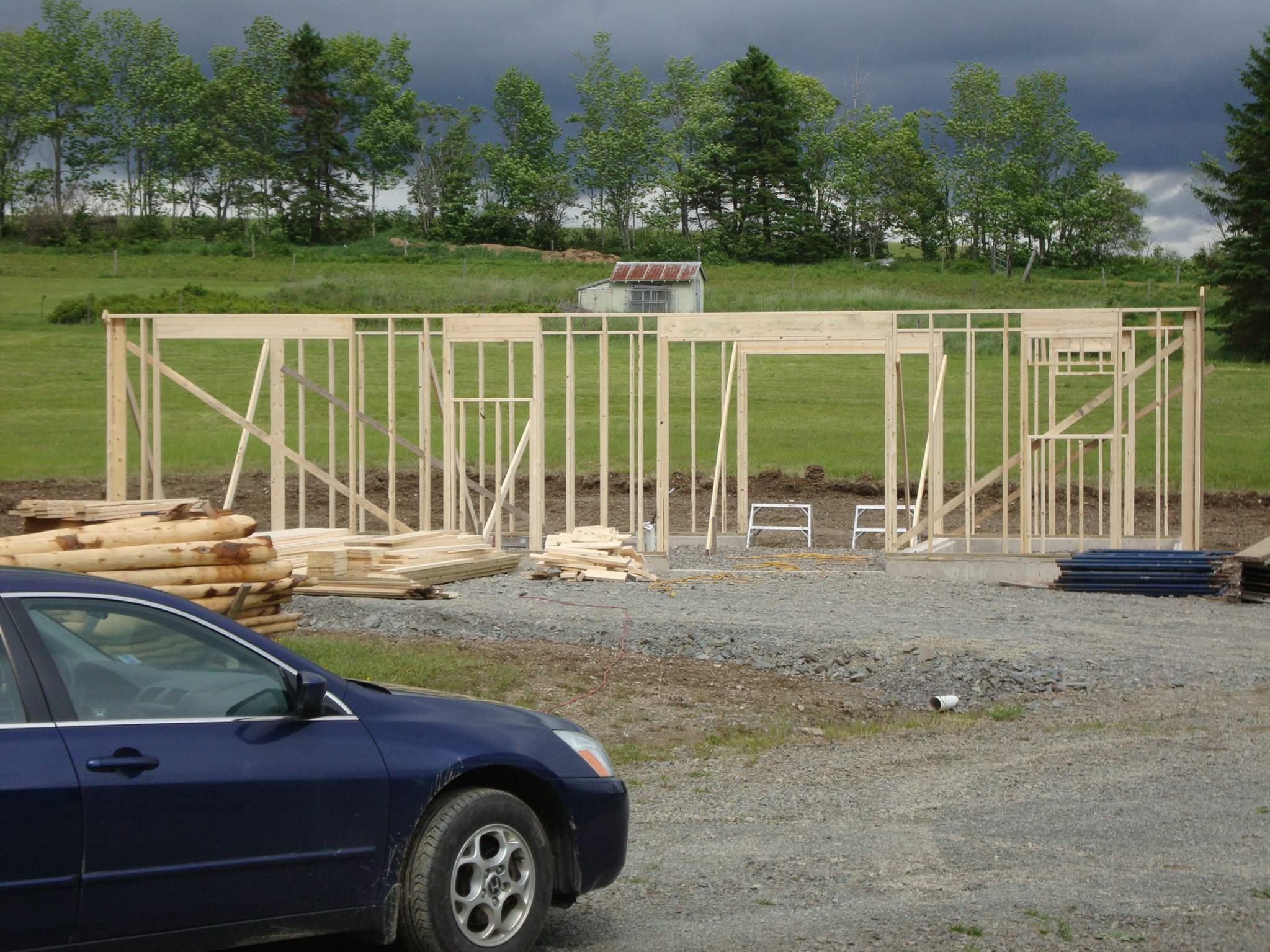

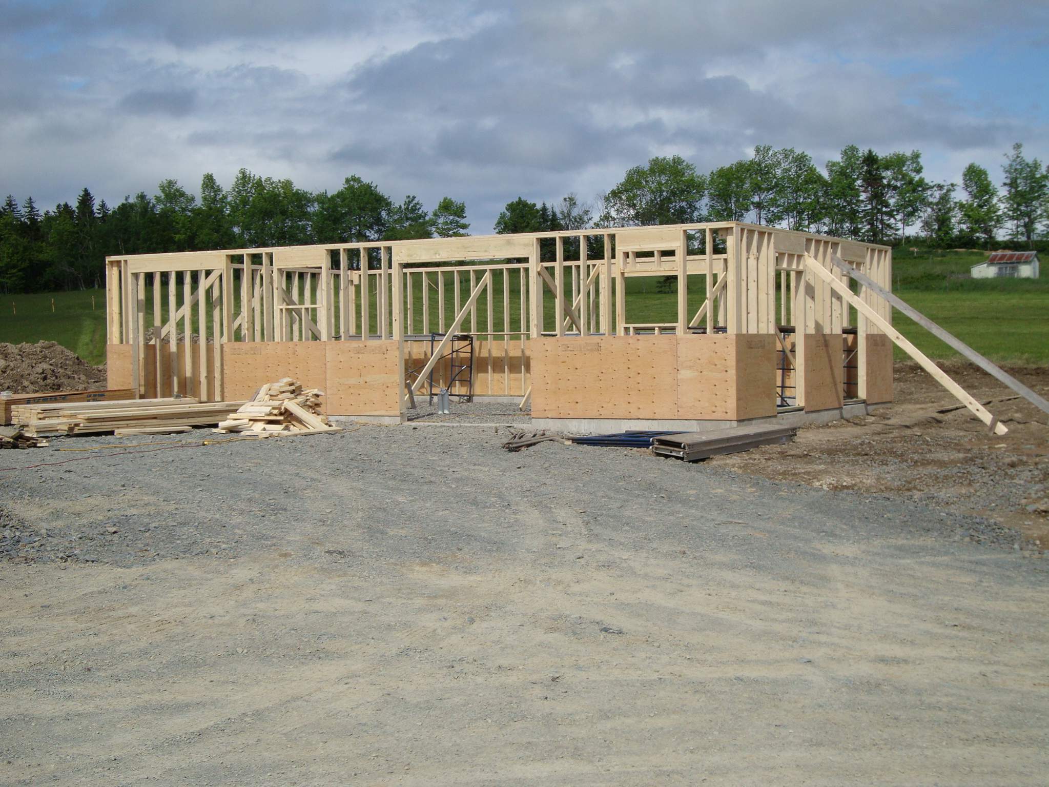

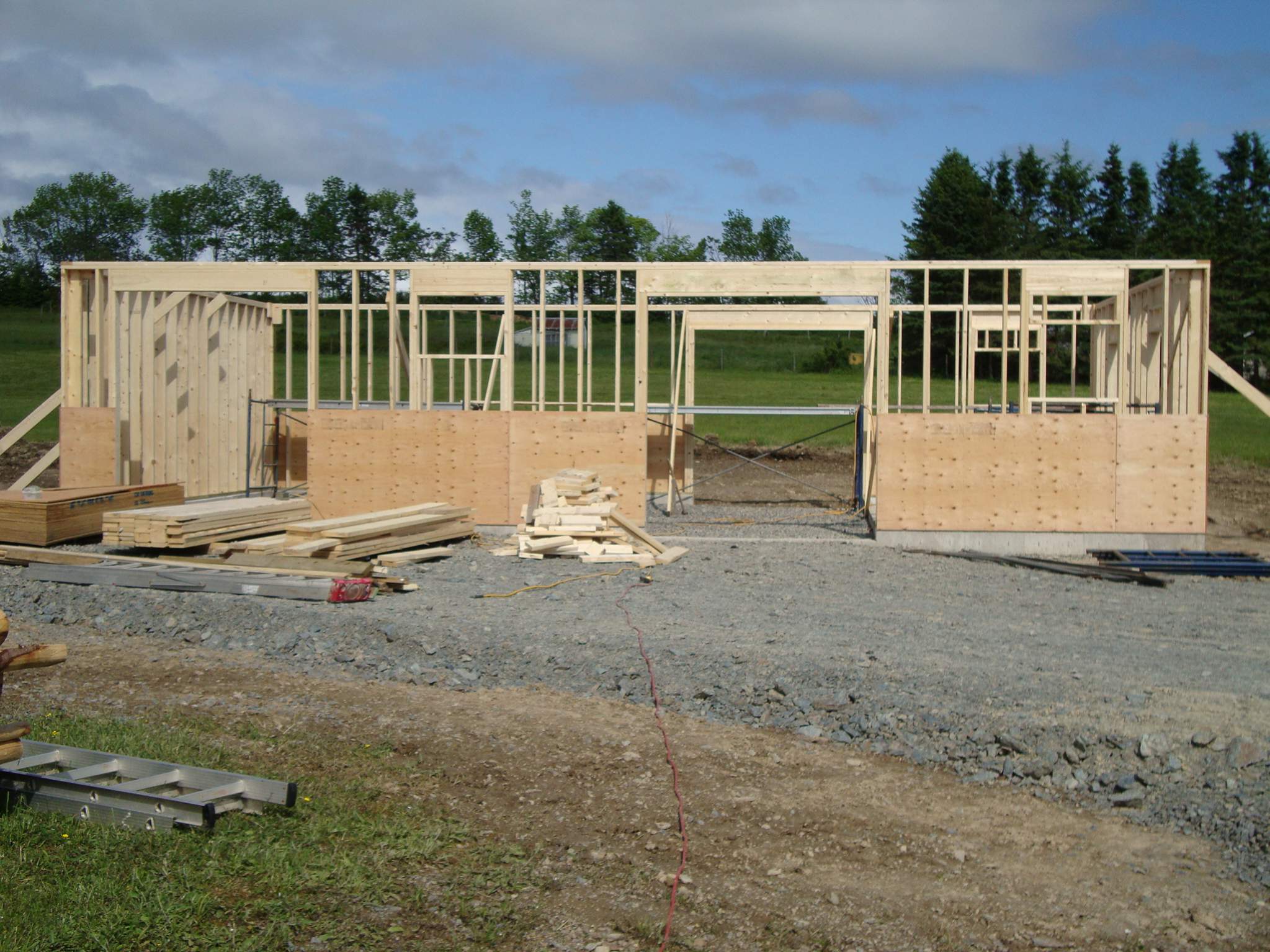

First day of framing on the barn project. We got off to a late start once materials arrived, but then things moved along pretty well. After a few days of working together it always gets smoother as you start to anticipate what your partners are going to want next.
We're using tripled 2 x 10 over each 8 foot doorway, and doubled over each window and smaller doors. 2 x 6 walls (exterior).
Sean

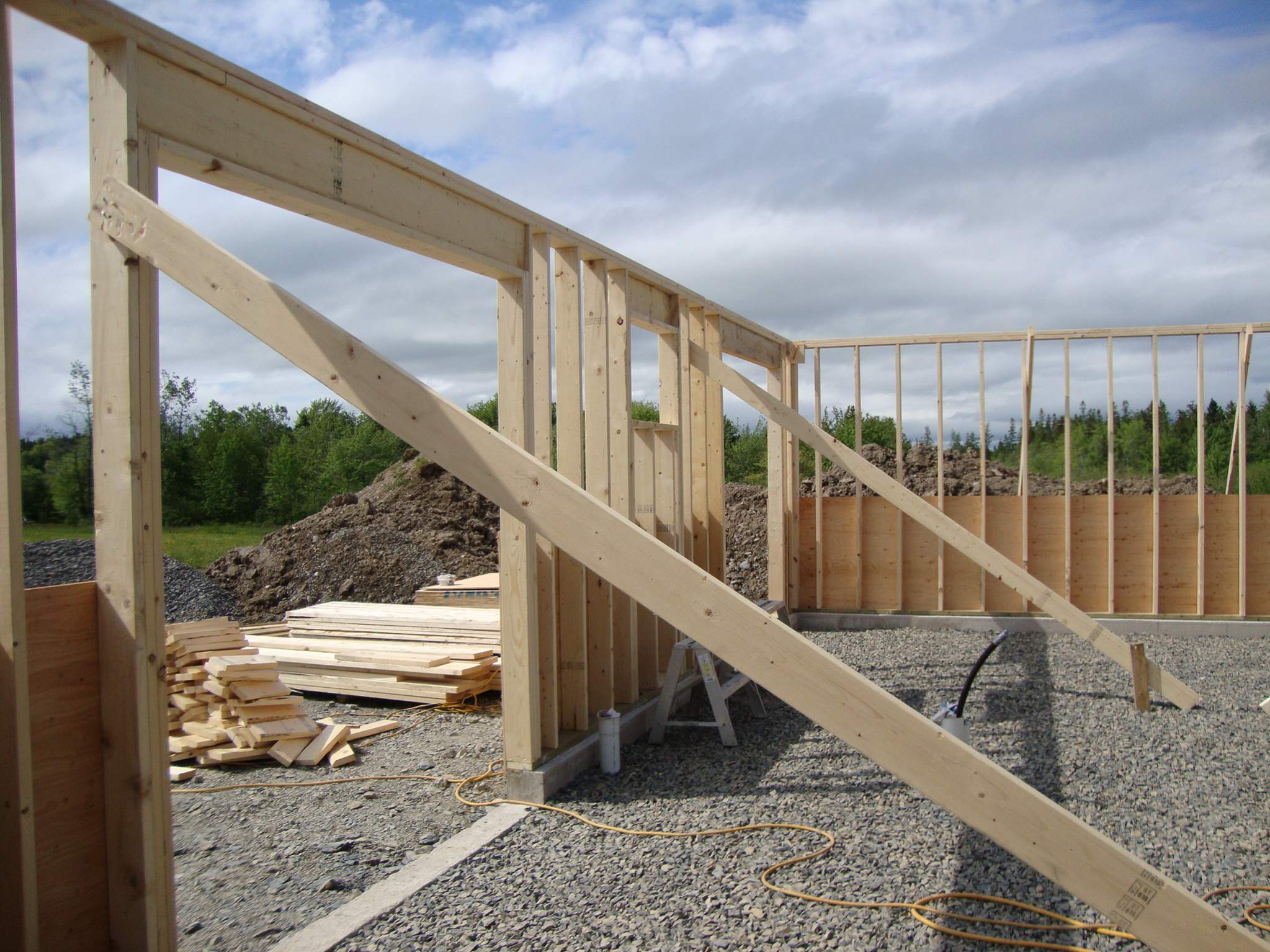

More framing today, we have trusses arriving tomorrow, and should have the roof on before the weekend if all goes well. I've attached a few pics showing the groove in the concrete where the suspended plank floor ends will sit.
