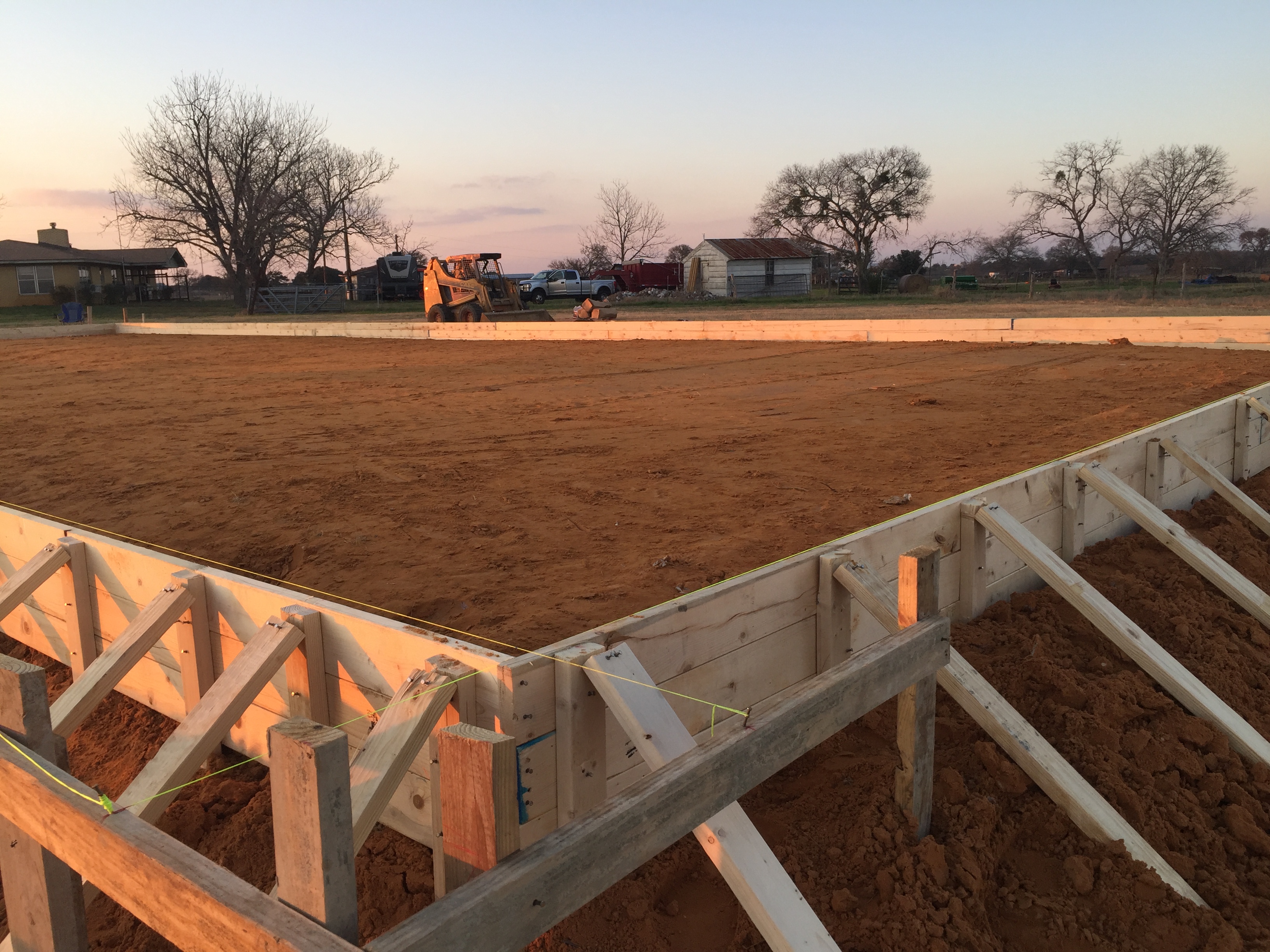

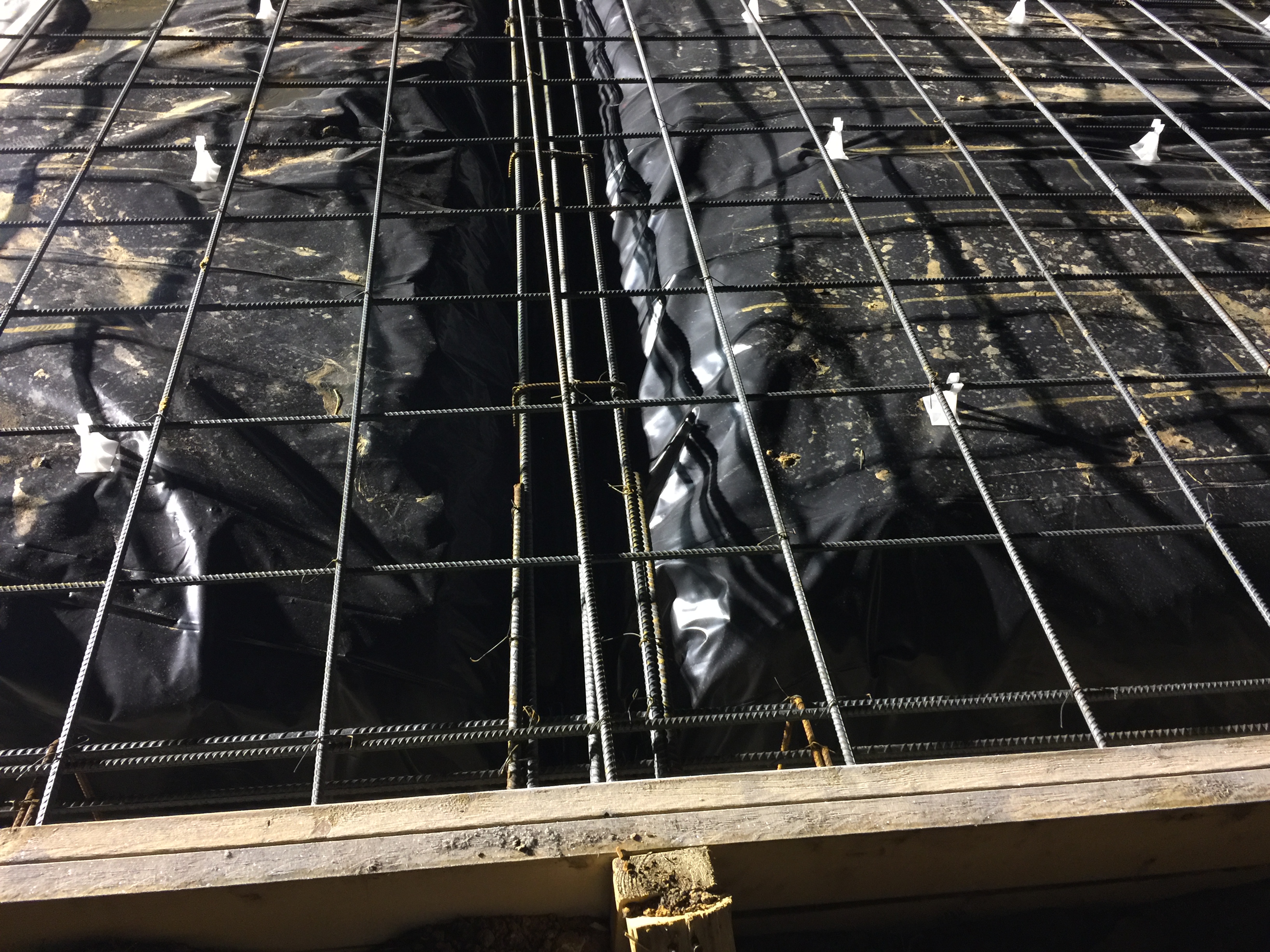

We started building a new barn/farm shop at our ranch to replace a couple of older buildings that are about done. The first phase is going to be a 40' x 100' central building (16' side walls with a 4/12 pitch roof) and then add 24' shed roofs coming off of each side for equipment storage. The location I chose was about a foot out of level from one end to the other, so not too bad, but we still had to have about 20 dump truck loads of sand mix to level it all out. We did get lucky with a bit of a drought so the ground under the slab was hard as a rock.
I hired some local concrete guys who do most of the work in the area and they set the forms, rebar, pretty much all of the labor involved. They brought out a bobcat and mini excavator and the dirt guy used a vibrating sheepsfoot roller to pack the fill.
Ended up going with a 6-7" thick slab with 1/2" rebar on 12" centers and 12" x 36" deep perimeter beams, center beam, and then cross beams every 20 feet with 5/8" rebar (12,000 pounds of steel). Used 6000psi concrete with fiber so I hope to keep any eventual cracks small and moisture away from the rebar. BTY, concrete guys like to start early - like 4:30. In the morning when it was 35 degrees.

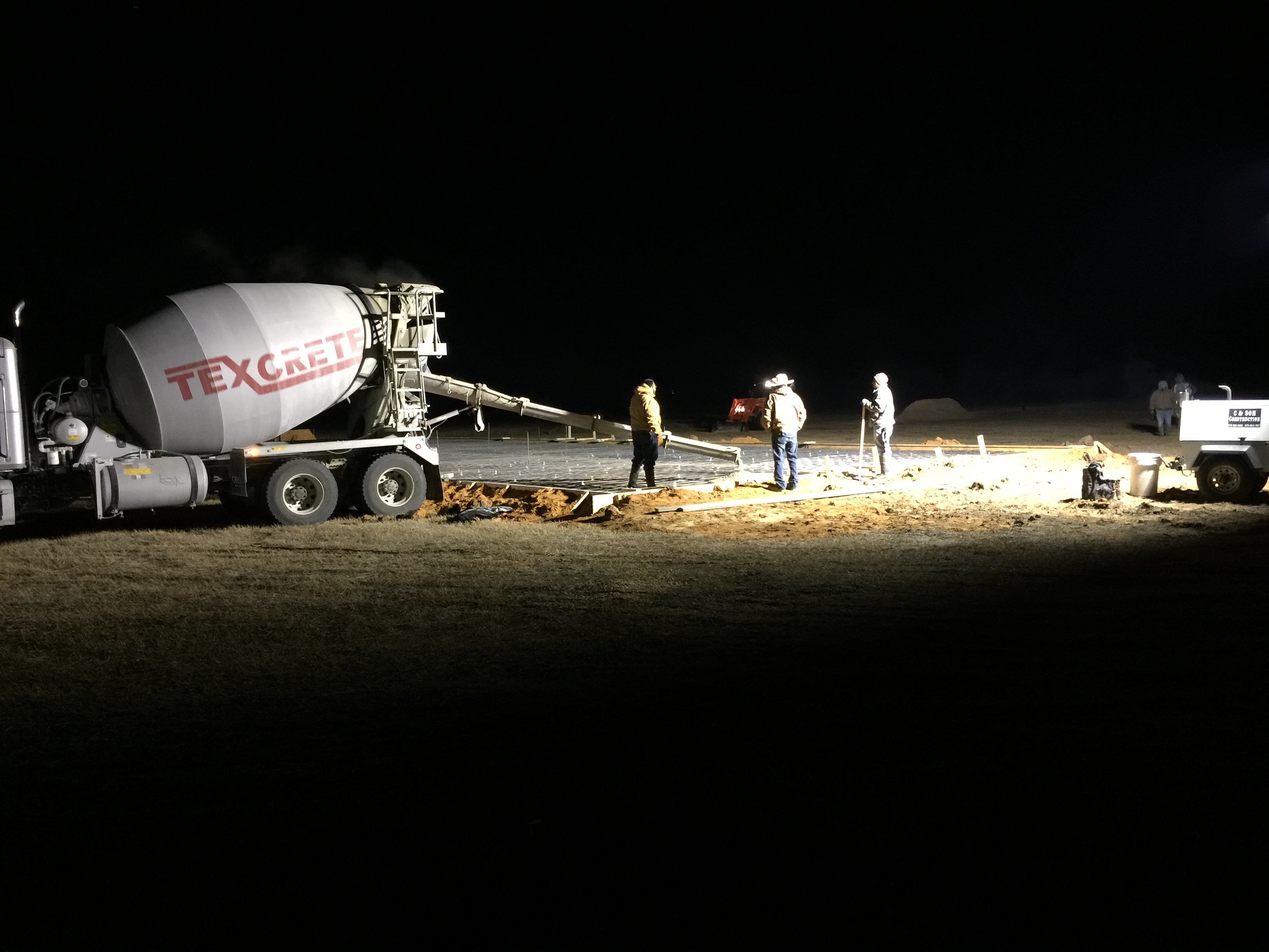

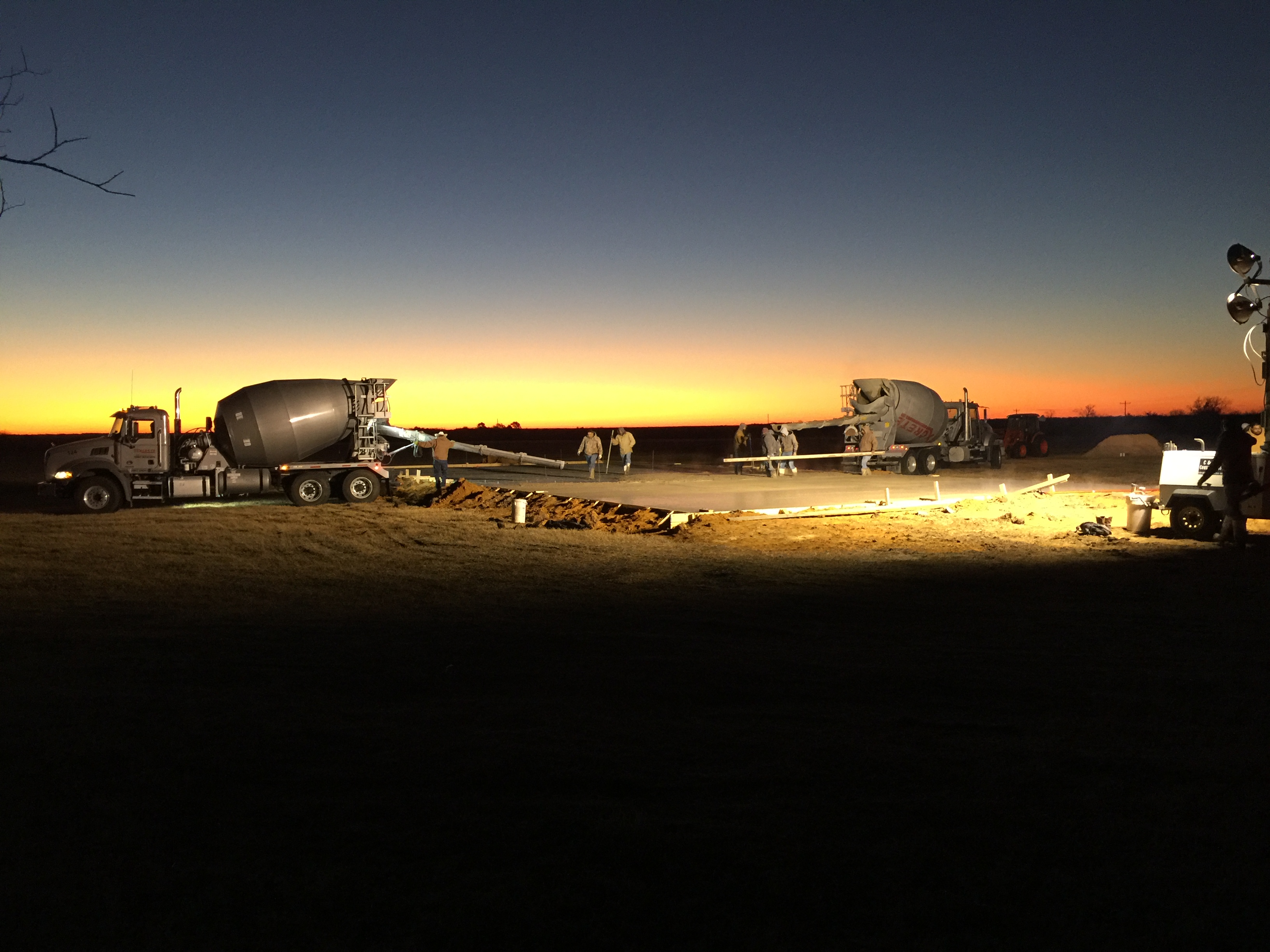

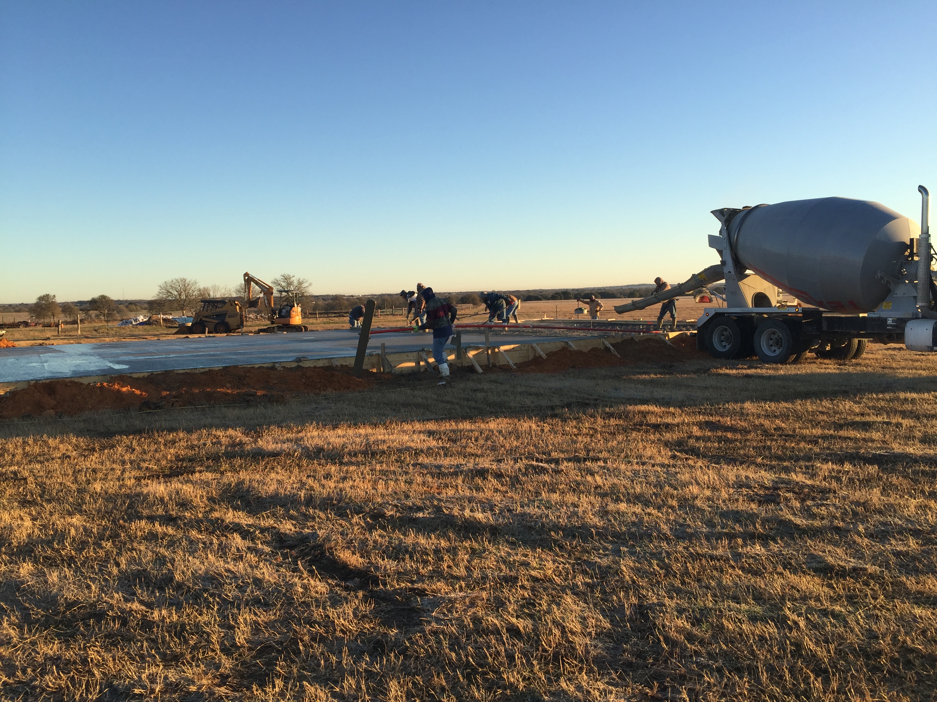

I forgot to mention that we poured on New Years Eve. We had about 16 concrete guys, 2 inspectors from the concrete company and a supervisor. Ended up using about 129 yards and got the last truck out at about 10:30 in the morning.
They used a gas powered vibrator to help get the air and voids out and seem to have done a good job.

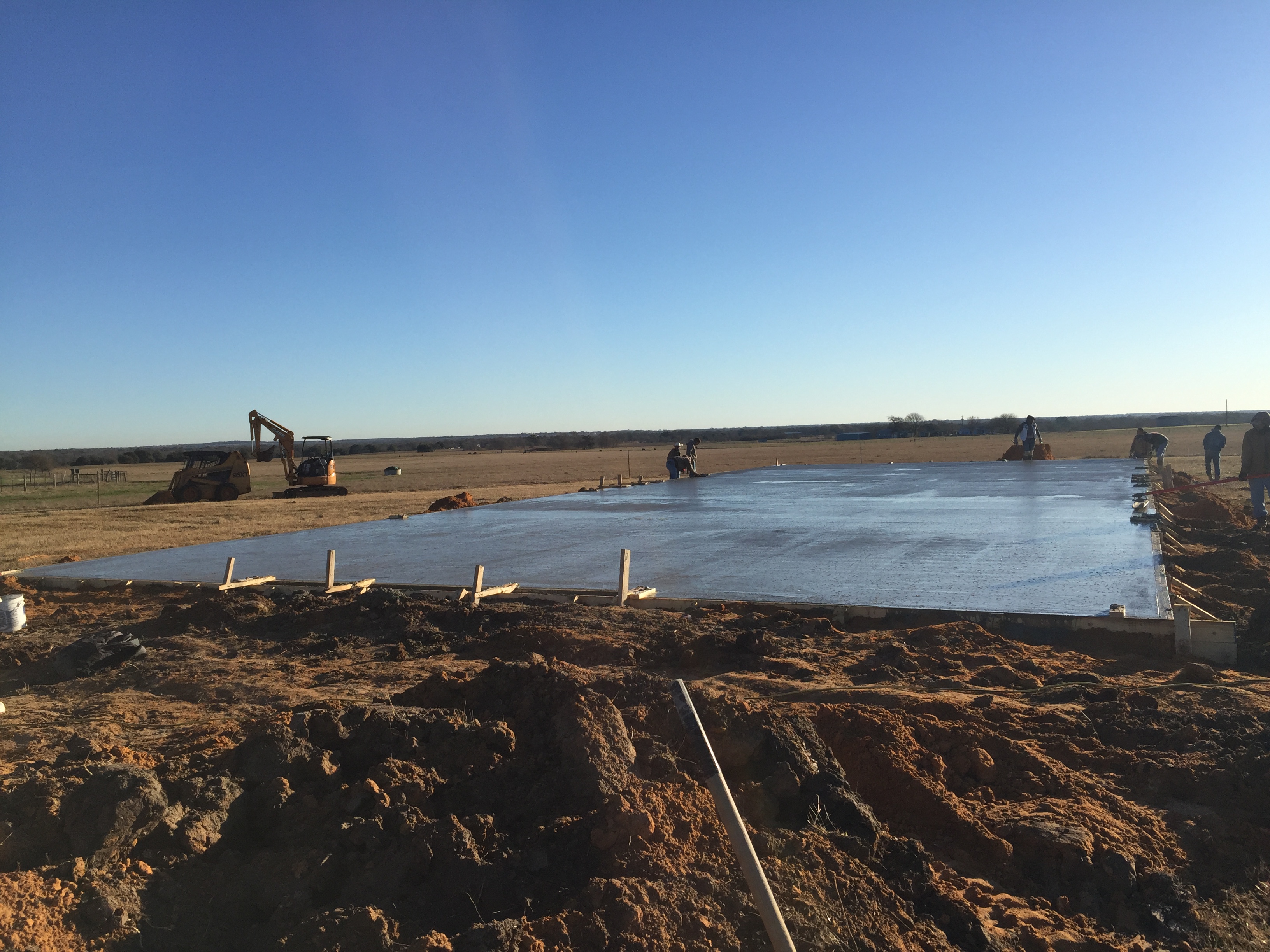

They used a couple of power trowels to get a very nice finish on it. Kept it wet for a week per the concrete company and pulled the forms off last Friday so I figure it has a pretty good chance. I will get more pics this weekend (spent last weekend planting 70 pecan trees and have 60 more to go this weekend). The building kit is supposed to show up in a week or tow and the the real fun begins.

Love seeing forms built when cost isn't a concern, and your rebar is just perfect!!!!
They did a nice job laying out the rebar and I got lucky on the form wood quality. Spent about a grand on it but we are going to reuse it on the next pours.

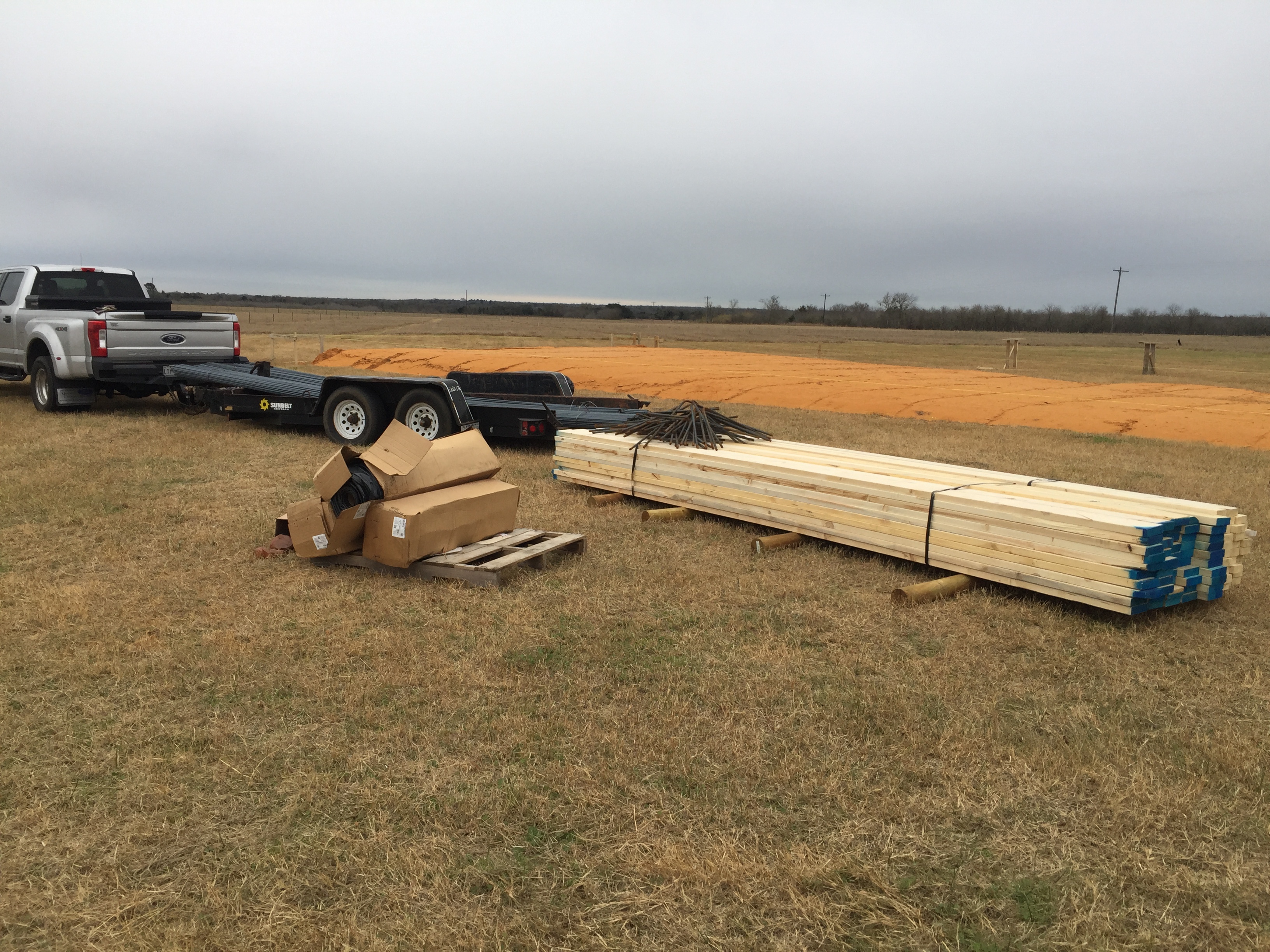

The barn kit showed up today - the driver thought it was sneaking up on 40,000 thousand pounds and it took over two and a half hours to unload. My initial reaction is I feel like the kid who just got a ten thousand piece model airplane kit. Spent most of the afternoon after that checking to see of everything is there and that the bolts sticking up out of the concrete match the holes in the steel and so far everything looks good. Used the 7320 to unload and it did fine despite the fact that it is almost impossible to see the end of the forks at most heights. Going to try and get a scissor lift next week and then start putting it all together.
