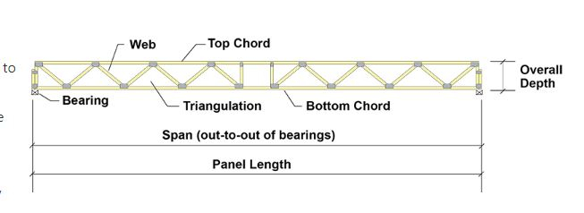

And basically what you're saying is that with a solid member (2x10 etc) joist or beam...as long as you leave that 1-1/2" of material at the top and bottom you can drill as many and as big of holes as you want...NOT...!
You mean similar to this?
That is an engineered floor truss...where the web members are structural and are charged with distributing the load...
They offer a more rugged floor but are heavy and expensive...
Again...it is the strength of plywood or OSB that makes I-joists a light, viable alternative...otherwise they could use something like luan...LoL
