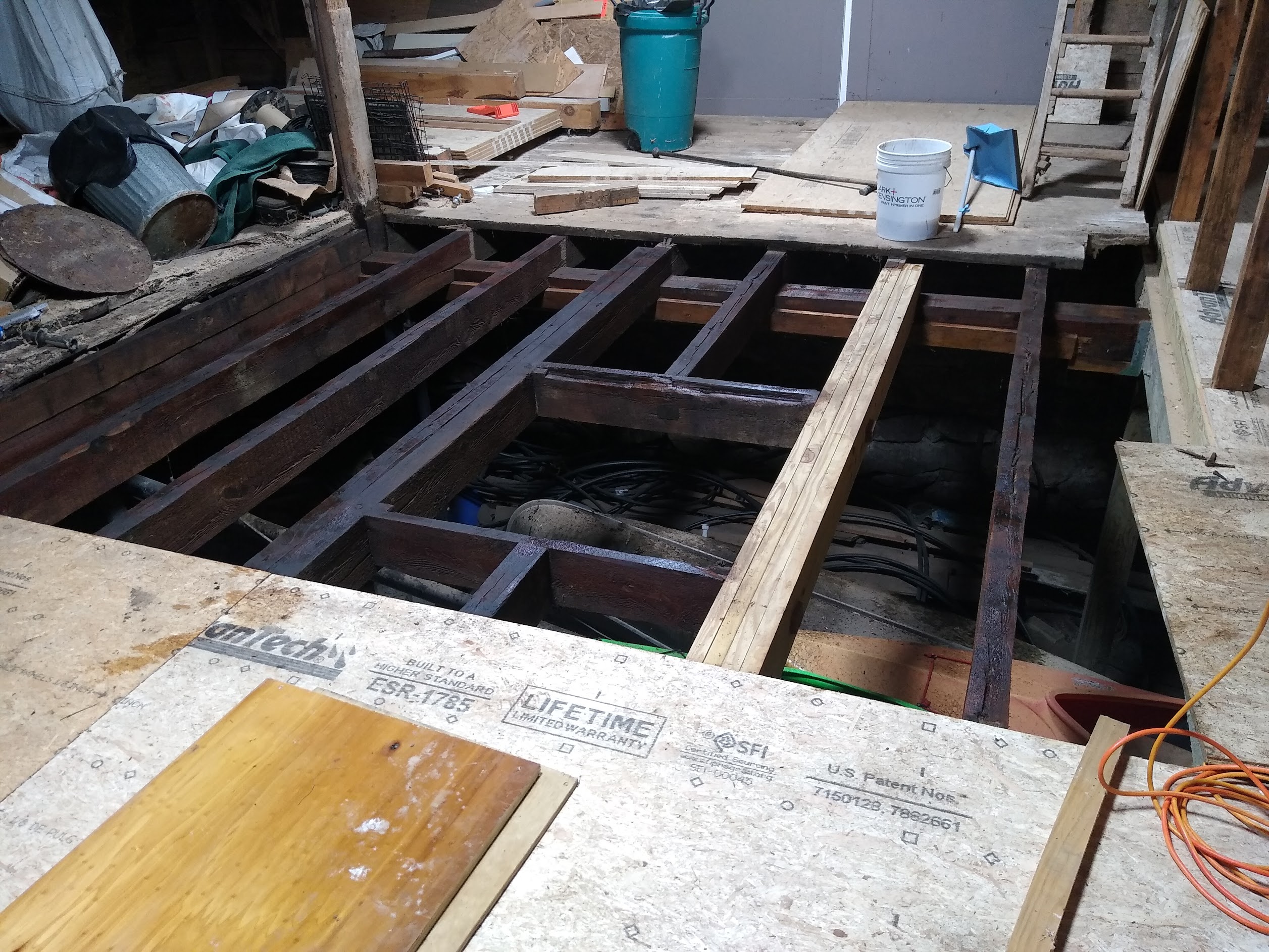

I need to do a bit of repair to the sill where the window leaked and it rotted. So with the siding out of the way I took off a piece of sheathing, it's true 4/4, sixteen inches wide.
The sill isn't structural. In this shot you can see the floor I put in last summer, and along the back of the sill you can see the new rim joist I put in at that time that is actually holding the floor up. You can see how the sill has sagged a bit and the stud stayed put so a gap opened up between the sill and the stud. That's how not-structural it is! Note the mortise and tenon at the bottom of the stud. Behind the stud is a piece that is going to sister that stud, it's just placed and not attached yet.
What I want to do is put something along the top of the sill to give the two studs on the sagging section a solid base. I haven't figure out quite what yet.
When I redid the floor last summer I tried jacking up that section of sill before installing the new rim joist, but I couldn't get it to budge.
