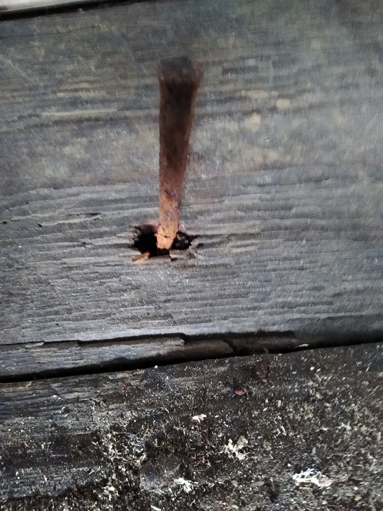

I don't know how old these shingles are, but they were put on with hand-cut nails, here's a close-up with a quarter for scale:

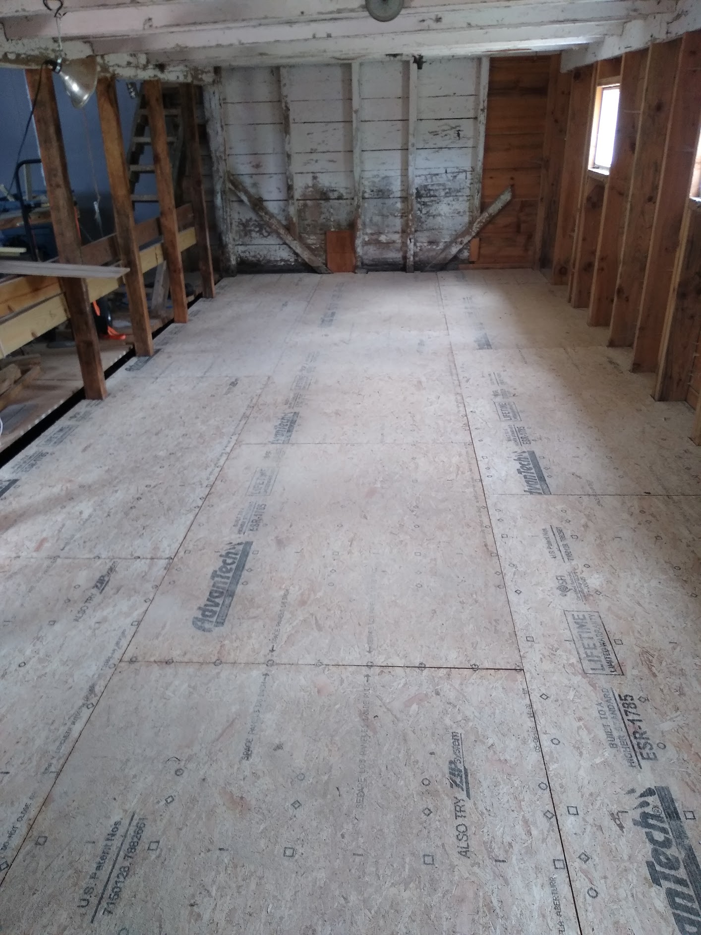

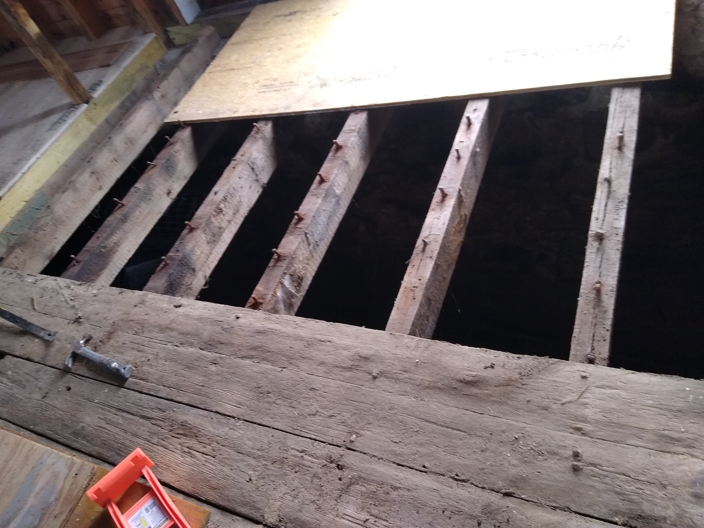

This is a picture of the wall I'm going to be working on. This is where the horses were kept, the studs were all chewed up by the horses. At some point 2" thick boards were nailed to the wall to protect it. I was worried that those boards are now contributing to holding up the wall, so I wanted to brace the wall before taking them away.
There is a hay loft above this section. There is a ledger board let into these studs, and that supports the loft. My first thought was to brace the joists of the hay loft. That would allow me to put the bracing far enough away from the wall that I could get in there to work. But it turned out the joists were just sitting on the ledger, so bracing them didn't brace the wall. So I had to brace the ledger, which meant working close to the wall.
First step was to bolt a 2x4 to the ledger, up against the joists. Then I screwed two other 2x4's to it, and put a 2x6 along the bottom:
Before putting up the 2x6, I laid out marks for studs on 16" centers. I put down a doubled 2x4 for a bottom plate, and measured the distance to the floor at each stud. My plan was to cut the studs the same distance longer than the measured distance, jack the top plate up and put the studs in. By measuring all the distances before doing any jacking I made sure the top plate would be lifted by the same amount across its length.
This is a shot of jacking up. Usually in an old building there's a fair amount of play, so I cut the first stud 1/4" longer than the measurement. I was quite surprised when I tightened the jack as much as I could and couldn't get it in. I cut it back to 1/8" over and that's what I did for all of them. That was encouraging to me, it meant the wall was stronger than it looks.
OK, the finished wall. I added a couple of diagonal braces. I wanted to use duplex nails for the diagonal braces to make it easier when I have to take it down, but I couldn't find them at the store. They did have #9 screws that were labeled "structural," so I used those instead. Perhaps that's why they don't sell duplex nails any more.
With the bracing in place I could take the boards off and get a look at the wall. I mostly used a sawzall to cut through the nails. It's not too bad. Every one of the studs looks like it will need to be sistered but otherwise the wall looks in OK shape.

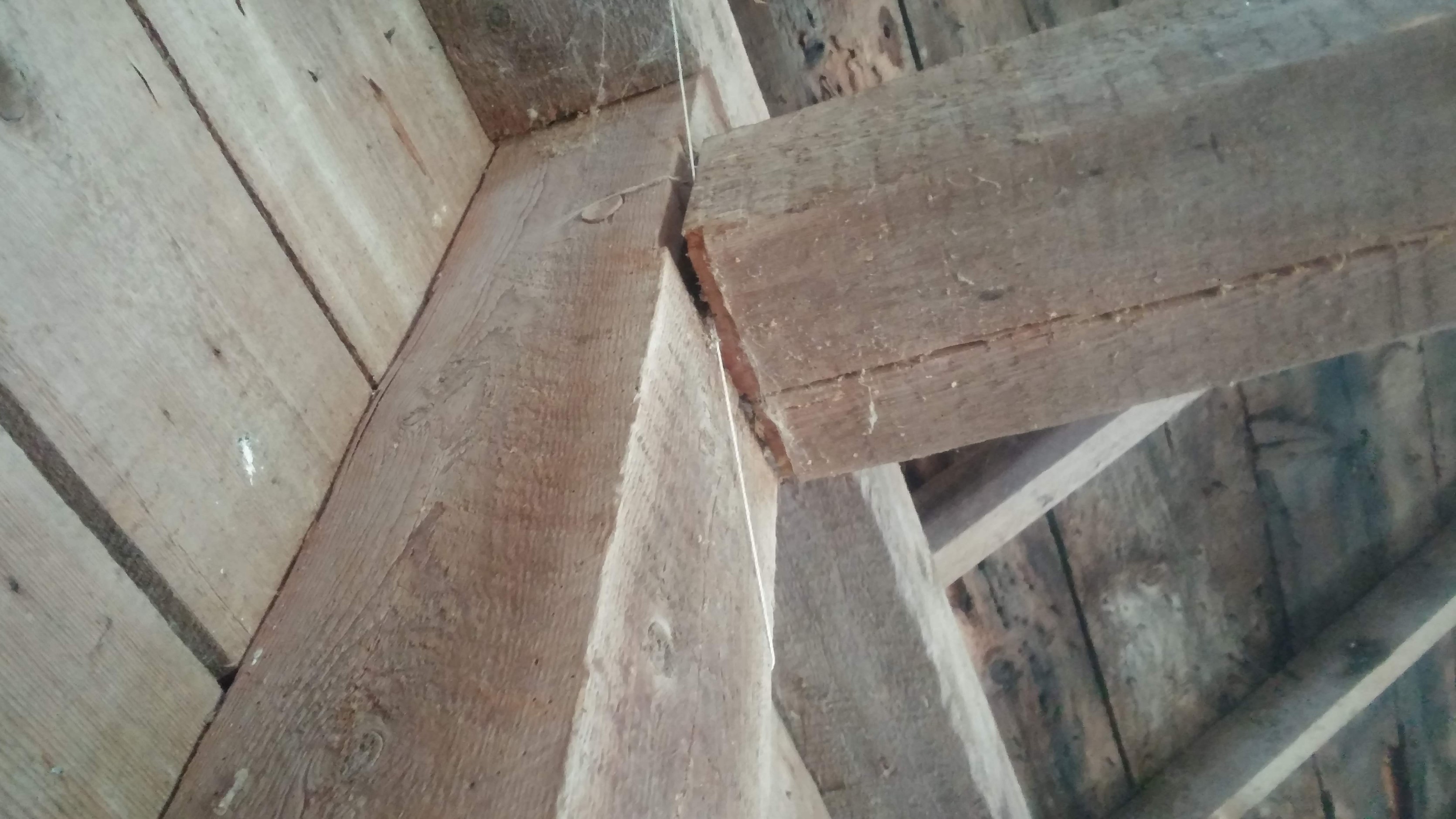

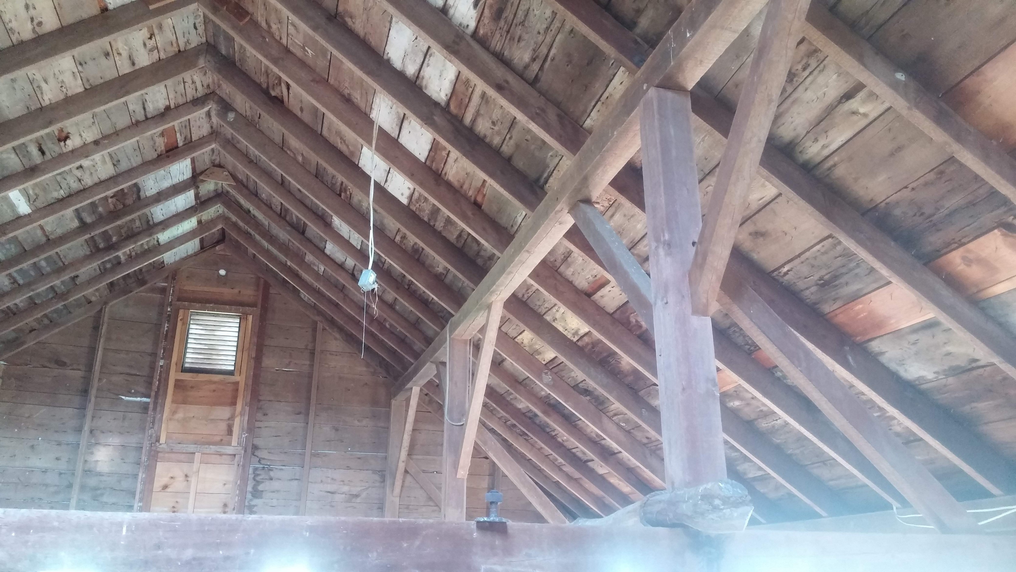

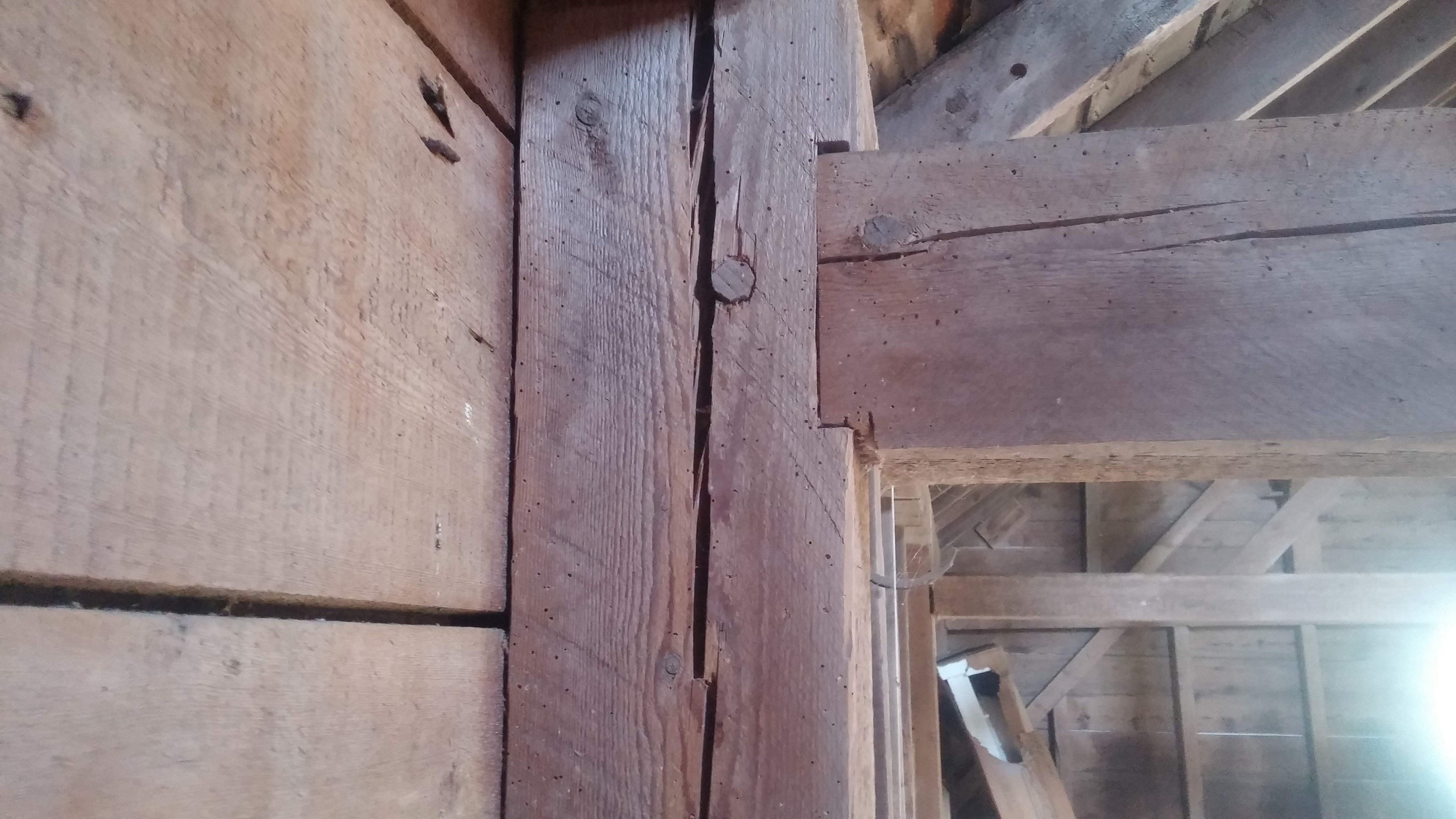

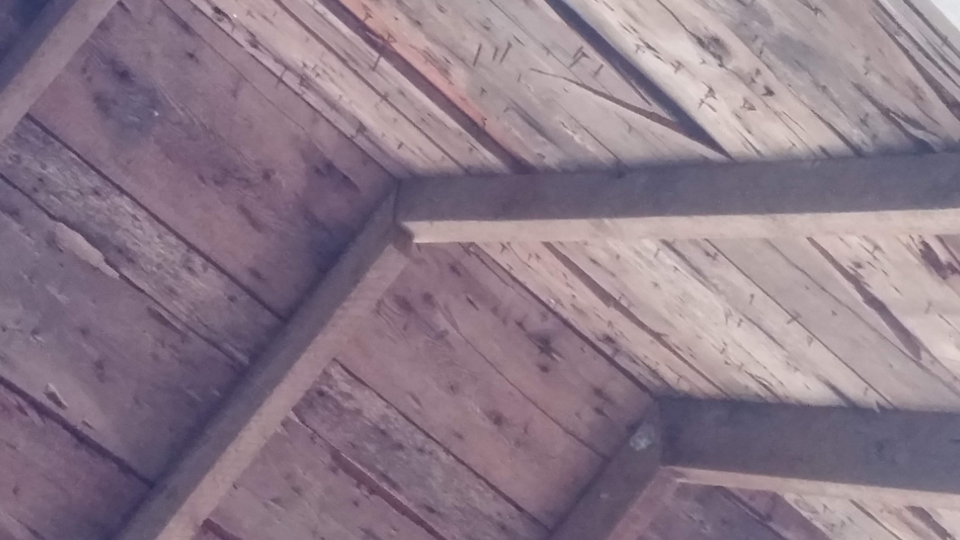

Fantastic documentation of rebuilding and reinforcing a great old barn. Thanks for your time invested in showing how well you have done the work. I was looking at your photos and noticed that the roof rafters were just butted up against each other and was wondering if two triangle pieces of 1/2 plywood on either side would aid in their structural stability during snow loading in the winter. I also noticed the absent of collar beams between the roof rafters. I'm sure Eddie Walker has some good input to this.

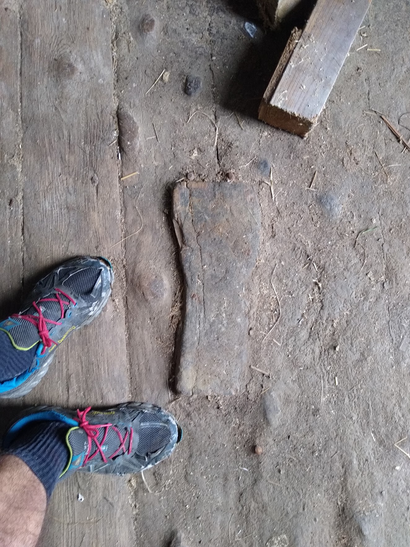

Agree the plank floors are not very level. It is double layers 2 by 12 oak floor planks. It has the trolley running under the roof ridge high up that was pulled by ropes for placing hay on the two lofts and there are several trap doors in the floor for dumping down hay to the lower floor. Two 16 ft by 16 ft doors are on the upstairs part for access for the hay wagons
