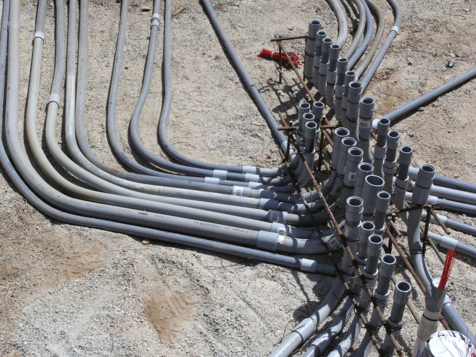

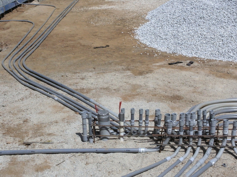

/ Foundation site prep #15
You definitely need to compact the subgrade. The you should use 3/4” drain rock 4-6” thick as a capillary break, then cover that with 10 mil plastic and finally 2-4” of sand. Bare minimum of 4” thick concrete with #3 bar on 16” centers. If you plan on a hoist or other heavy use the go up to 6” concrete. If you are planning any electrical or other conduits put them beneath the rock layer and fill with sand.
