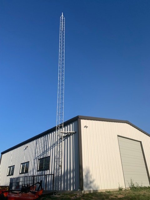

When I bought my retirement place, the original owner had Line-of-site internet, using a 60' antenna. I tried it briefly and it was horrible. We were able to swap to fiber and now I have an unused tower. My buddy wants the tower, so we're going to take it down ourselves. We're both comfortable working at heights and have the necessary tie-off equipment. We'll take our time, think each step through and make safety the number one priority.
I've been researching it and it looks like we need to build a gin-pole. I found this plan on-line and it looks simple enough, (Gin pole fab) I've also seen some plans using a length of uni-strut and some pipe clamps, which also seems feasible. It also looks like we need a modified scissor jack or similar jack, to help unseat the sections, if they're stubborn.
Anybody tackle this themselves? Any pointers or words of wisdom?

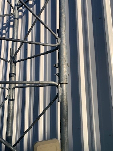

It looks like it consists of a top 5-6' section with an extendable stinger, then (4) 10' sections and another 5-6' at the bottom (likely another 4-5' buried in the concrete pier.) The next picture is the joints. Lastly the original vendor.

Many decades ago I worked erecting, painting, and removing home TV towers.
The gin-pole needs to have a 90° Ell on the top, otherwise it is like your link. That Ell places the pulley centered on the tower, which makes pulling sections apart much easier. We didn't use a jack, just a BFH to loosen the joints if required. you'd be surprised at how much those joints move with the wind.
First thing is to remove the top pipe so you can use the gin-pole. You need 3 men really, 1 ground man, 2 on the tower. but 2 can get it down. Just 1 tower man is gonna work his XXX off, he has to carry a battery impact gun and wrench for removing bolts, climb up/down each section while removing bolts, moving and attaching the gin-pole.
The ground man handles lowering each section and moving it out of the way.

I wold be tempted to hire a cherry picker and tie on at about 35 feet. Take out the bottom bolts and lay it on it's side to take it apart in 20 foot sections. If you have the new footing ready it would then be quite easy to erect it in similar fashion.

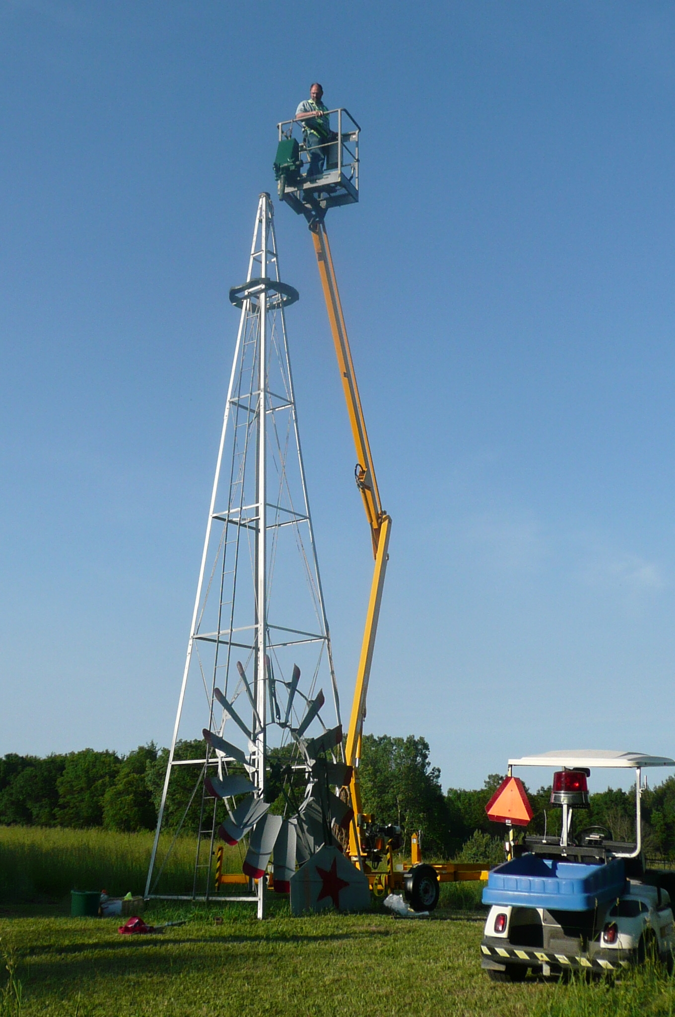

Rent a 35' or 50' trailer boom lift. You can run it from the ground. Strap a jib crane beam on the basket, insert it into the tower above 1/2 way up. unhitch the base. Then you can gently set it down. Put it back up the same way. I do it all the time with windmill towers using my JLG-T350 lift. Mine can pick up 500# if I'm running it from the ground. The outrigger sensors will prevent you from tipping over.
