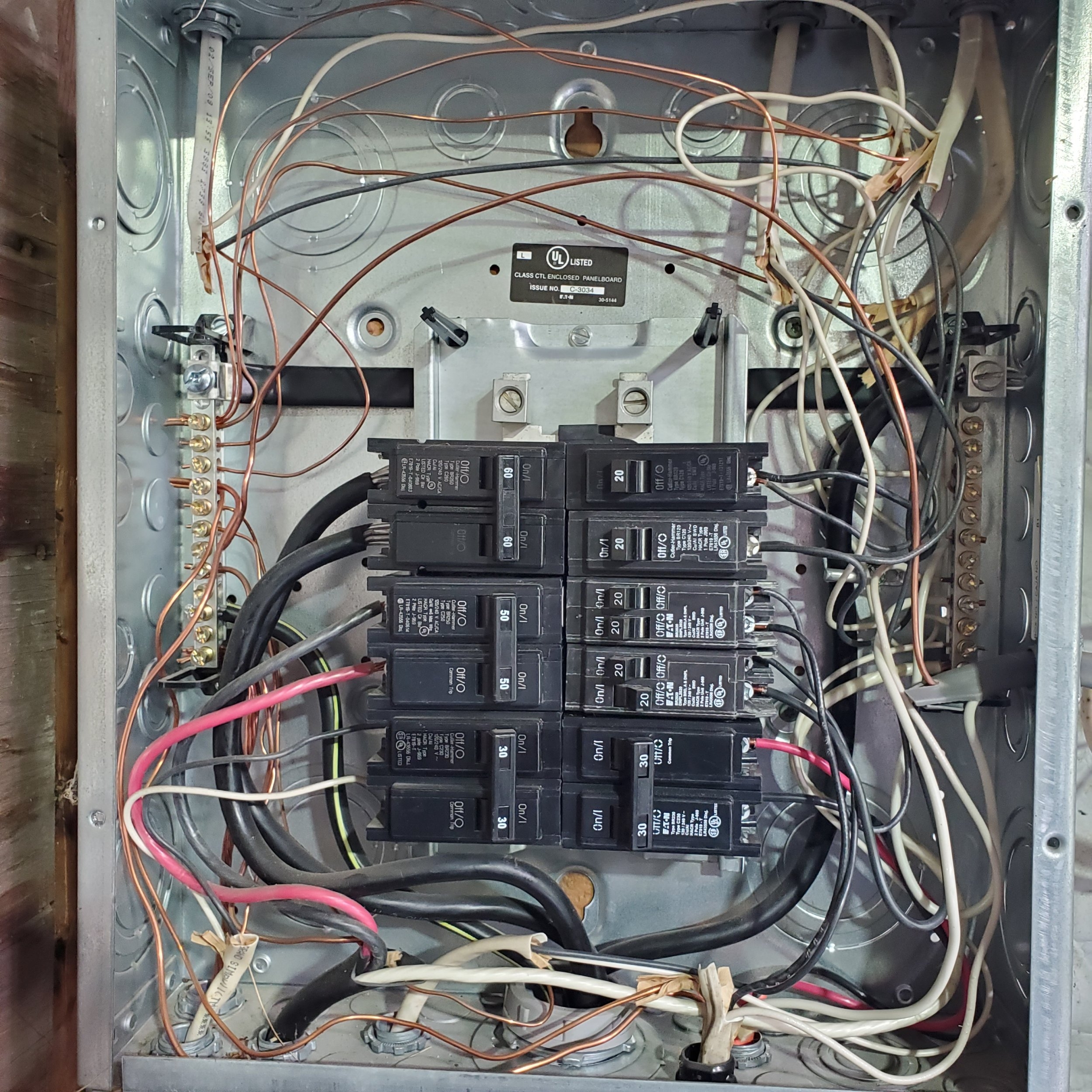

I cannot even tell how that panel is fastened to the building
/ Electrical question. #22
But being sloppy wouldnt cause his issues. See what happens after jumper is removed. I doubt that will solve issue though. It can be a variety of issues, usually concerning loose neutral connections somewheres. Ive also notices some brands of led lights will flicker no matter how clean of power you have.
/ Electrical question. #23
Not so….in older homes, they only ran 3 wires between buildings and drove new ground rods at the secondary buildings. In these cases you leave the bonding jumper inplace. In more modern houses, they run 4 wires between buildings, and this is the case you dont want to bond ground and neutrals.
Good advice here, but looking at the sub panel in his picture, it appears (but maybe you see something different) that there are 4 inbound wires coming from the house. I also think I see a copper ground wire connecting the 2 busses.

Agree, you have a modern 4 wire fed subpanel. Lose the jumper bar. And that panel is a mess. if my employee did something like that, hed be unemployed that same day.
Yup, i refered to this after my post, before his picture appeared.
I looked and there is not a wire connecting the two busses.
/ Electrical question. #31
Is there a “bond” going to the box from the two busses?
That would serve as the same as a wire between

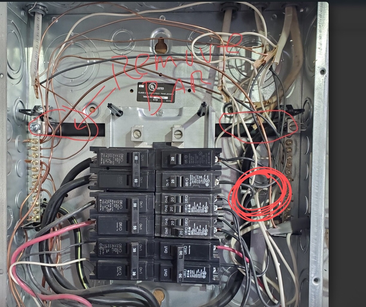

I removed the jumper bar and tightend all the connections. There were a few that were loose.
/ Electrical question. #33

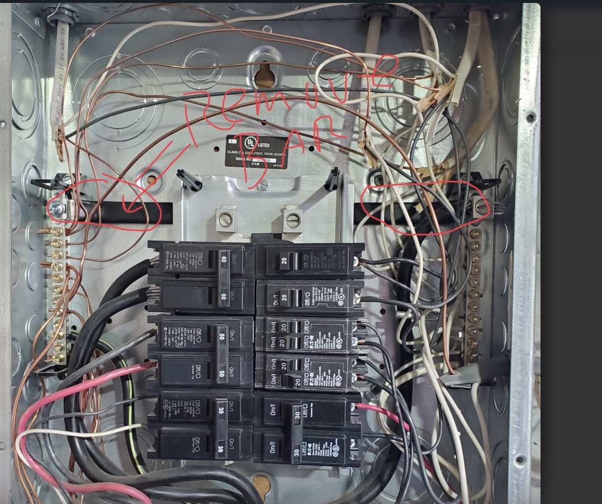

After removing the jumper from neutral bar to ground bar you need to bond the ground bar to the panel. Using the bond jumper from the right side of the panel. Looks like it is just holding the neutral wire to back of panel.
Is there a special connector I need to get? Why is it located on the opposite side of the ground bar?
/ Electrical question. #35
No. Use the item I have circled. It can be used on either side of the panel. But the ground wires are in the bar on the left and neutrals on the right. The panel box needs to be grounded. Use the jumper (circled) to do this.
So your saying I have to ground the ground bar to the panel.
/ Electrical question. #38
Yes, the ground bar needs to be bonded to the panel.
That is a very good catch there sir!
I don't notice a #6 solid bare conductor going to two ground rods from the ground bus, ground rods need to be 6' apart. If this is done, I Just didn't see it in the picture.
/ Electrical question. #40
It is obvious that it's not a professional install but, this should have been done even if it was neutral to ground connected.
