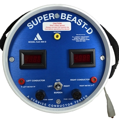

Okay guys here's the update.
My buddy came over yesterday to have a look. He's an electrician for a local municipality in a different town. He pulled the meter from the house and snapped in it's place a device called a "Super Beast". He turned it on and within seconds said it's not your house.
He went to the pole behind the barn that holds the transformer. He could not tell from the ground, so he put on his climbing gear and went up. He did not get far before he said these neutral connections are fried. Told me to call NYSEG and report and emergency.
NYSEG had a truck out within the hour. They cut the old connection and crimped in a new one, but still had problems. They went up to the transformer, and the connection there was also loose. The pine tree next to the pole had a charred branch.
The demons in my house are no longer there.
Thank you all for the feedback.
