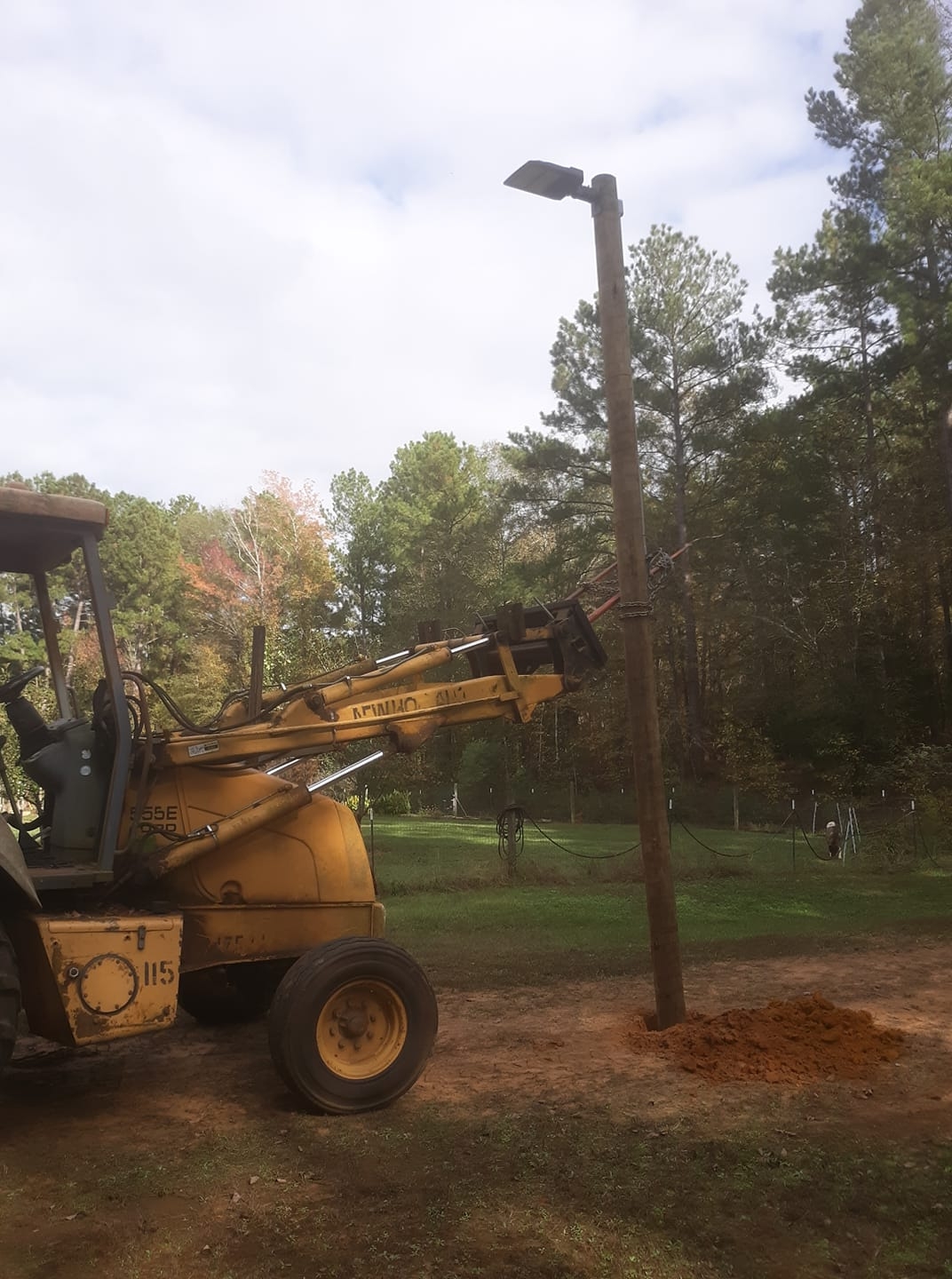

A few years ago I put a 20 foot post in the ground with a LED yard light. It's at the far end of our fenced in area for our dogs, and my wife really liked having it. After about two years, it sort of died, but not all the way. Some days it would barely glow, other days it would sort of flicker, or slowly start to come on, but then turn off. But most days, it was dead.

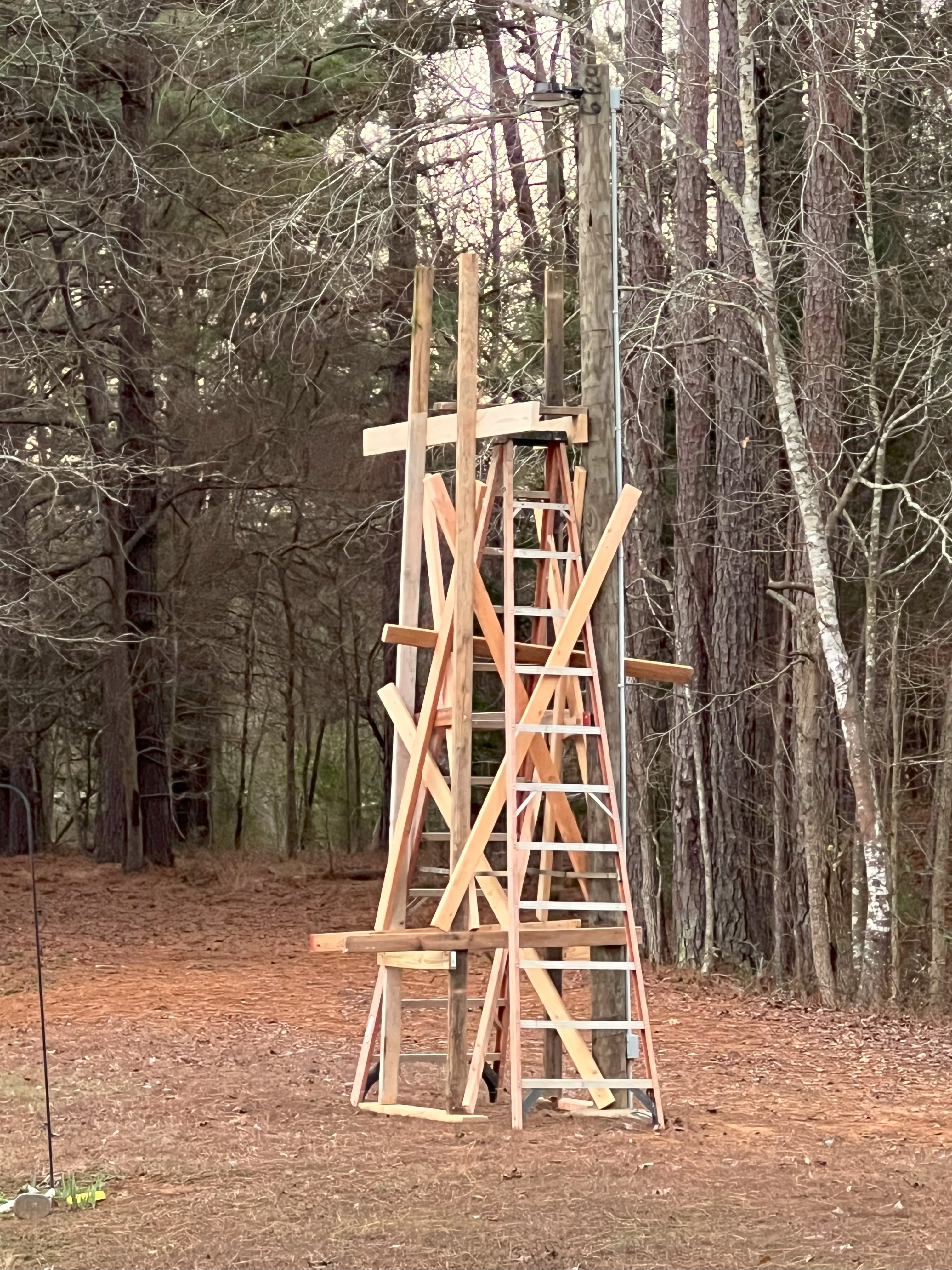

For Christmas, I bought my wife a new light and promised to make it a priority to change it. The light is 17 feet off of the ground, and it terrifies me to get up that high and swap lights. I built a tower from lumber lying around to make my 12 foot step ladder as solid as possible. I don't like heights, but if I'm on something solid, I can deal with it.
Old light off, new light installed, and nothing happens. I checked the voltage and my meter says 118 volts. I returned the light and installed the new one. Still nothing.
I've probably installed a thousand lights in my lifetime. I don't know of anything electrical that is easier than installing a light. Black to black, white to with, and bare copper to green. But this has me questioning my sanity. And to make it worse, I've already installed three of them at my place, plus a dozen or more of them for clients. I really like these lights.
The light has a small dusk to dawn built into it. You can turn the ring around the glass to make it brighter, or dimmer. You can also move a small plastic cover over the glass to make it come on sooner or later. That's the only controls, or options on the light. The other three worked perfect the first time I installed them. I've never had a client complain about these lights. They are probably the only light that everyone likes!!!!
Is it possible to have voltage, but not amps?
I'm about to do something really stupid and run a new line to the post, but before that happens, I'm hoping for a suggestion that I'm missing.
As I'm typing this, I think I'm going to remove the LED light, and install a simple light bulb to see if I really have lost my mind.

yes its possible to have a surface voltage. where any real load will drop it, but leds use very little.
wire a normal incandescent bulb, and see if it works , if it doesn't unscrew the bulb. check voltage. if it shows normal, screw it back in and check voltage. if the voltage disappears, you likely have a loose connection or a cut wire.
and just wire the old light up at the house and test it as well, its prolly still good.

Pretty strange, but thinking that you do have two duds. Install the incandescent and see what happens as your meter indicates voltage. 120 watts/1 amp is less than a floodlight would be.

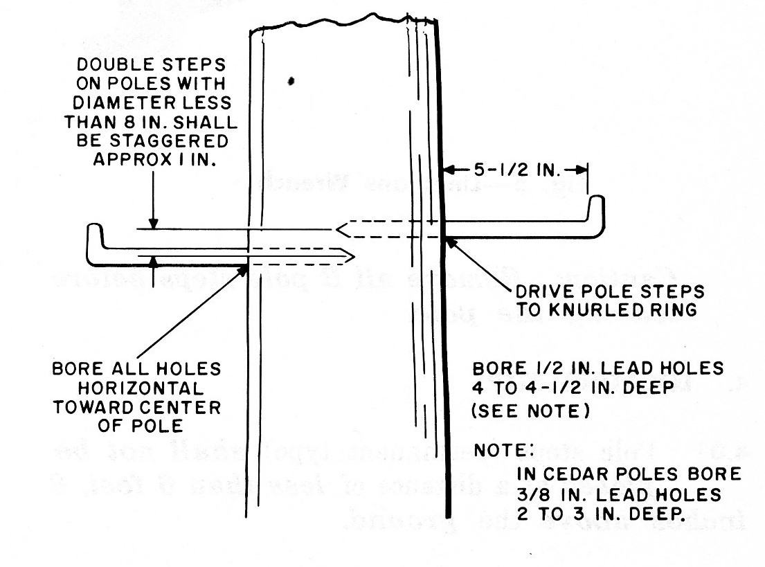

I would get some pole steps. put a pair opposite each other to lean an extension ladder against, then alternate them at 18 inch intervals until you are at working height at the light. Wear a safety harness. Forget the ladder contraption.
Your power or telephone line company may have buckets full of used ones.

As others have suggested, test it inside to verify it is not the wiring to the pole.
Make sure you have covered the photocell so no light can get in.

I noticed a box at the bottom of the pole. Is there a junction there or just a pass-through? Is your light fed directly from a breaker from the house or from somewhere else? Where is the osha stamp on your ladder brace structure? :D

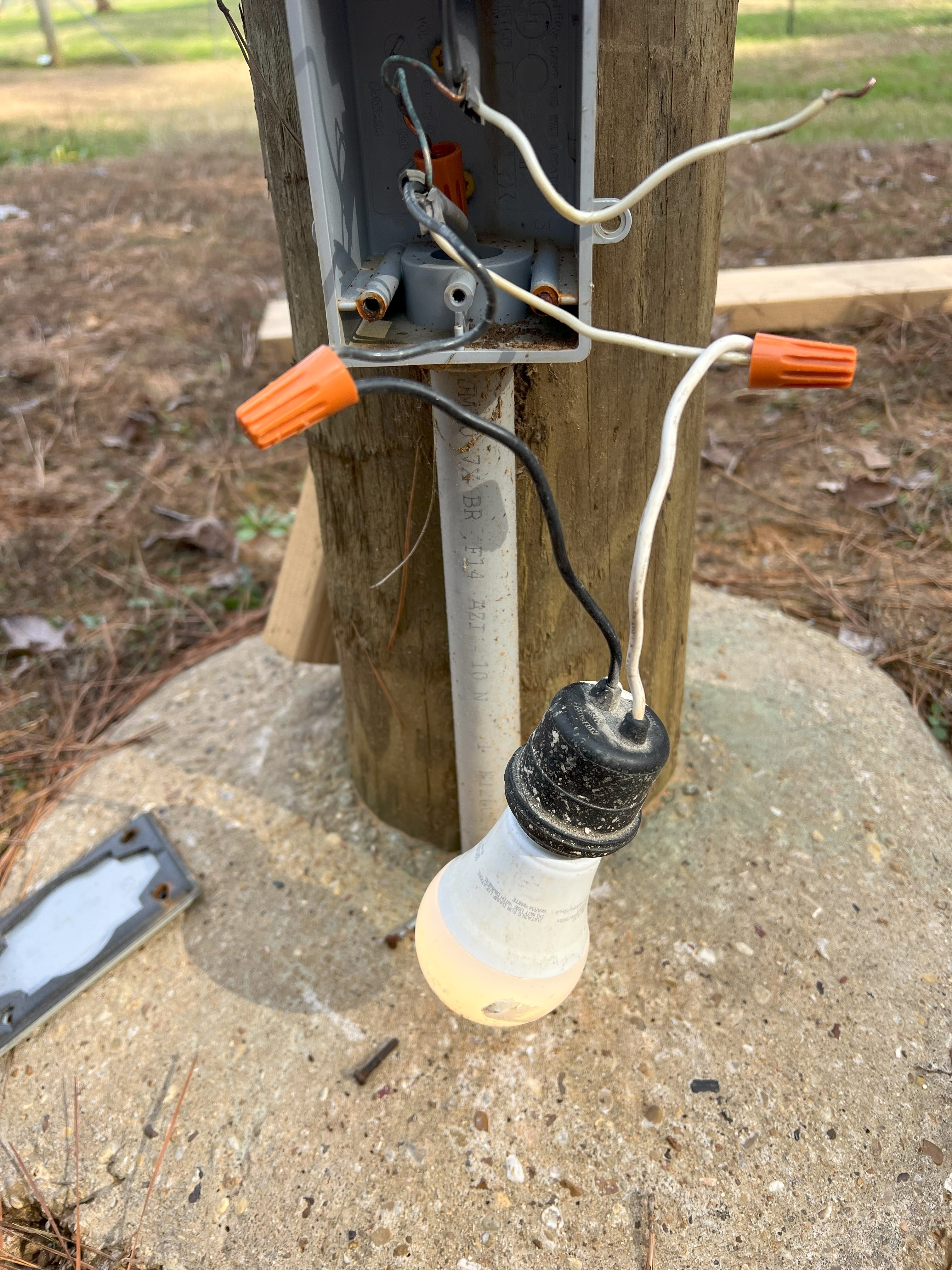

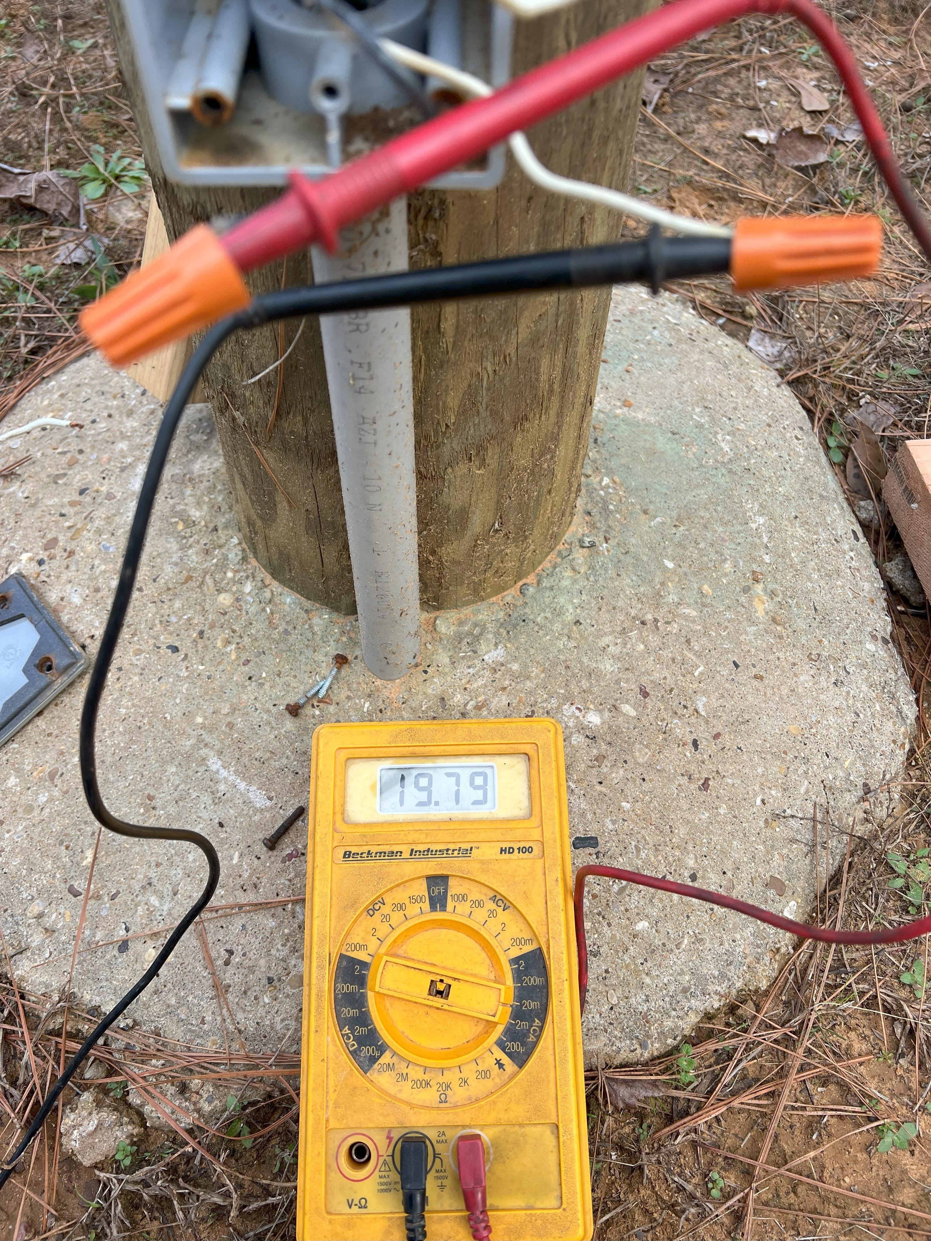

The power comes from a breaker in my house and goes to a box on a fence post about halfway through my yard. There, I have another line that goes to another light, but I haven't installed the light yet, so the wire is coiled up on the fence post, with a wire nut on the black wire.
From the box on the post, the 12/2 direct bury wire goes to the post. There is a box at the bottom of the post that connects that line with another 12/2 line that goes up the post to the light.

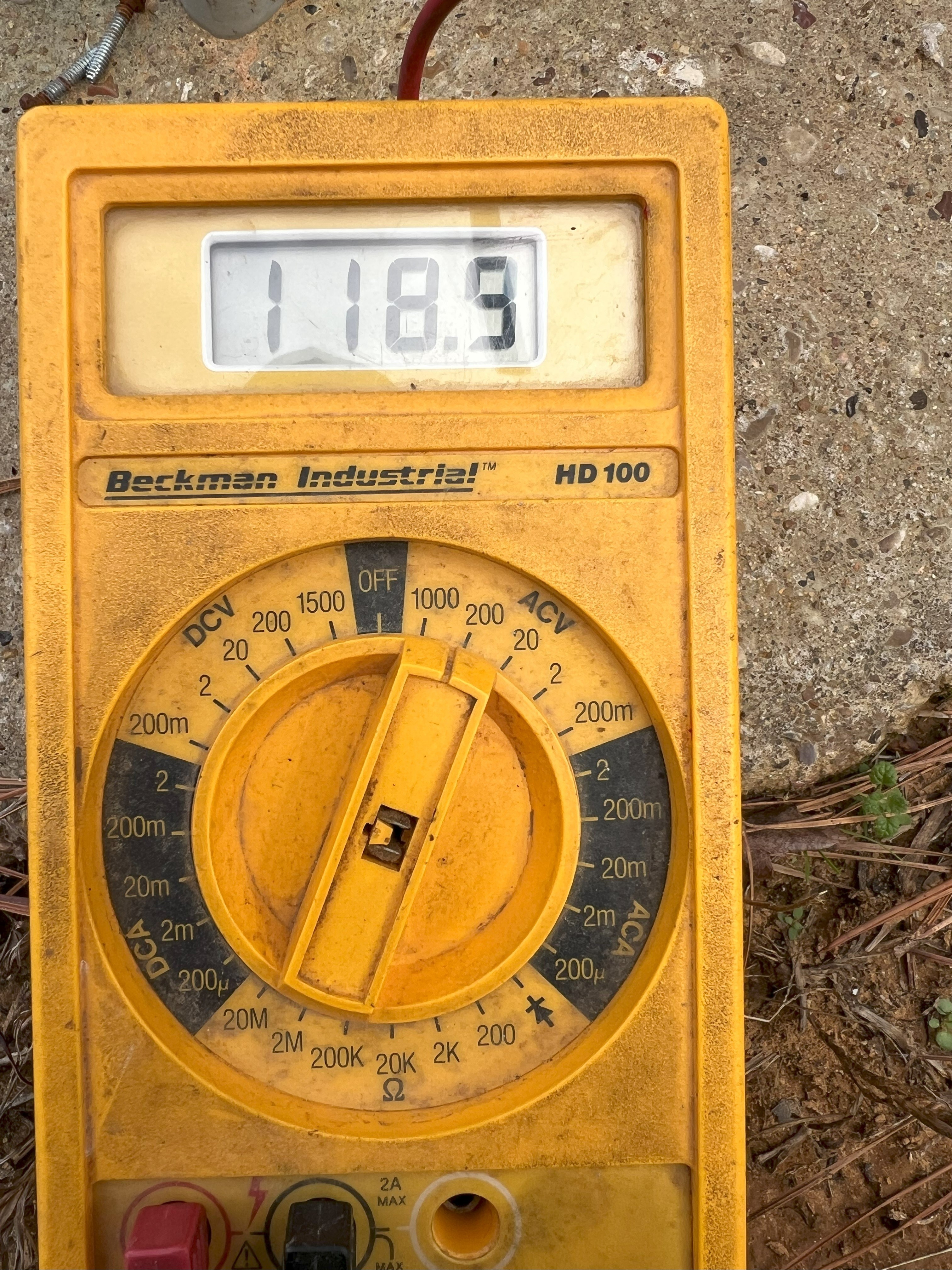

I'm testing at the base of the pole right now. My voltage test at the top of the pole reads the same as the bottom of the pole. Between 117 to 119. It's constantly fluctuating.
I connected an LED light bulb to the line. I tested it in my house first and it was super bright. Here it's very dull.

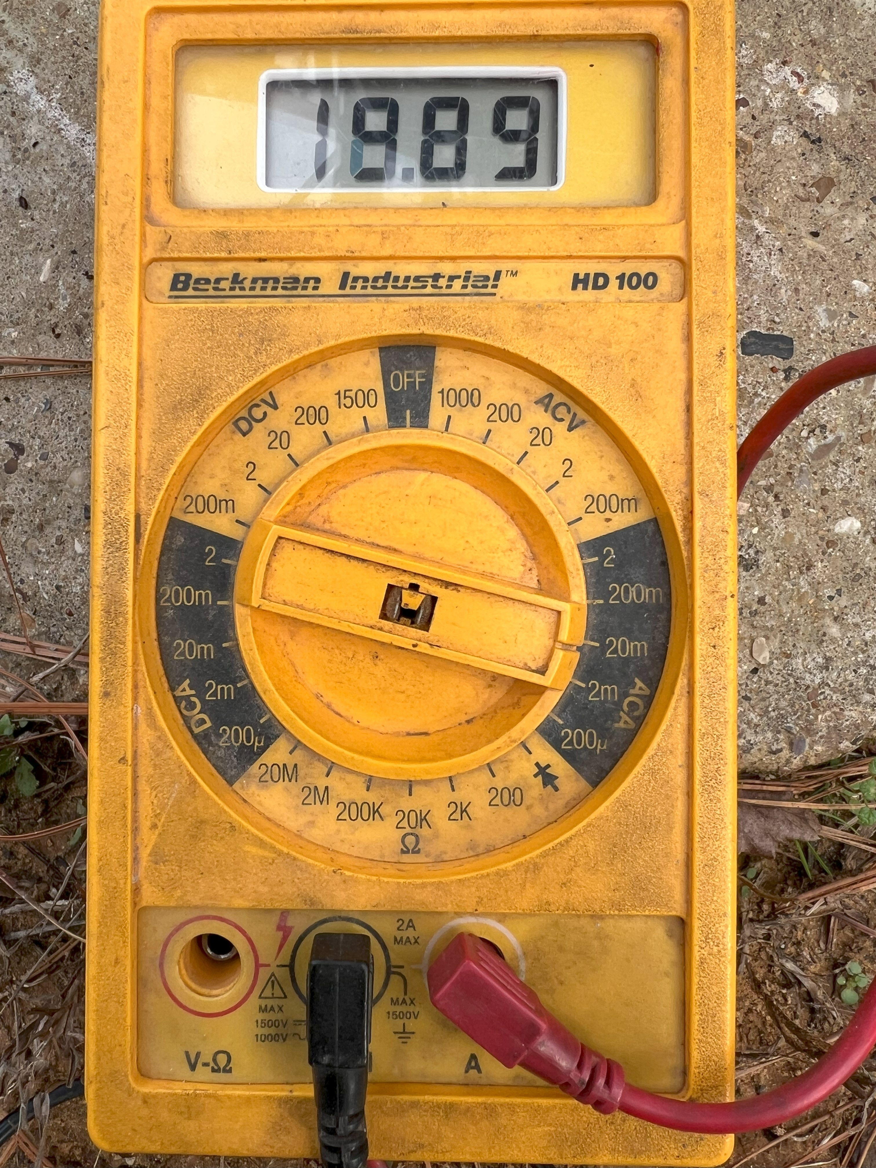

I did a search on testing for amps. From what I read, I have to move my postitive lead to the A connection and then set the switch to ACA
When I did this, at the 20m setting, I got 18.89 in the picture, but it was going up and down from 17 to 19. But it was also going back and forth to DL
Is this the correct way to test for Amps? What does DL mean? I'm thinking that DL is my problem.

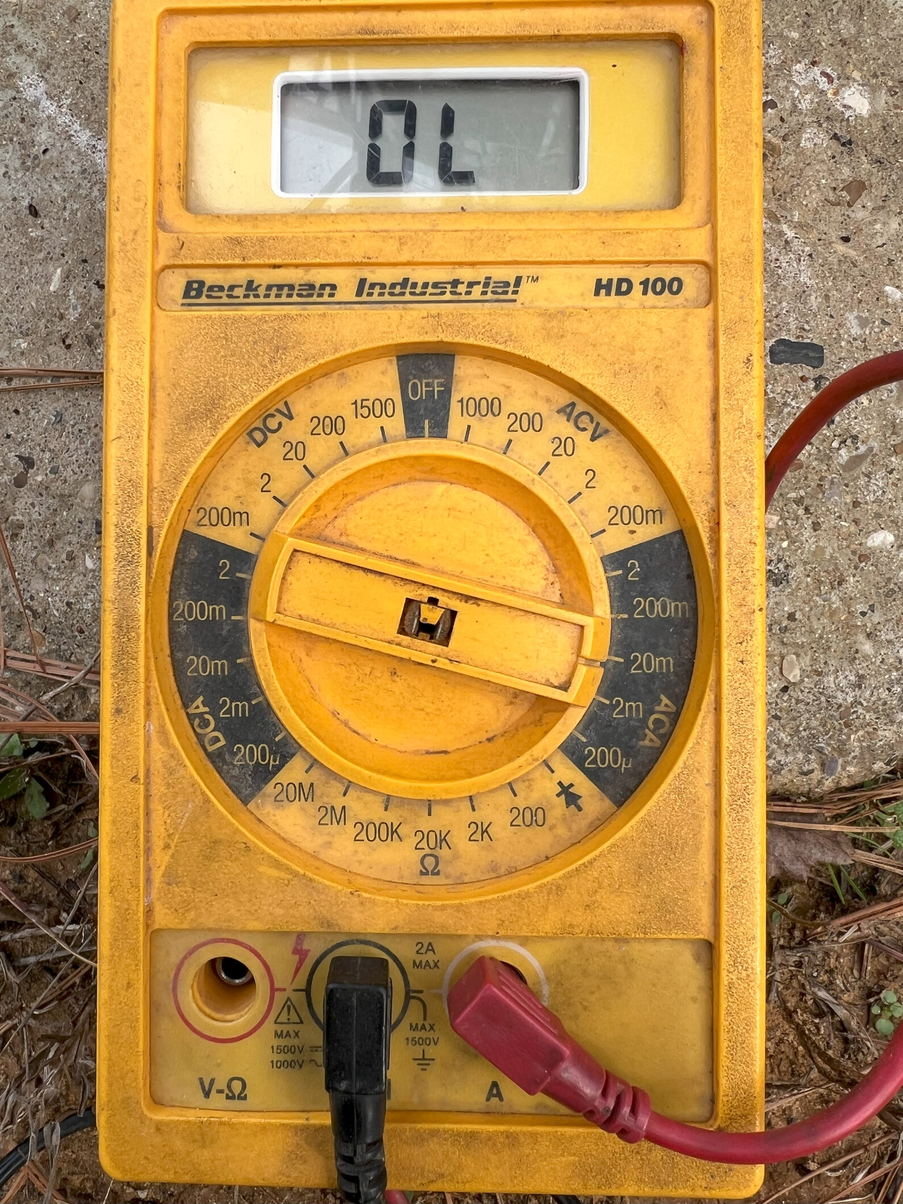

View attachment 2123805 View attachment 2123806
OL means overload, you have it in the wrong setting, should be on the 2. be aware you should only keep this showing amps around 10 seconds, these things have limits.
what is the voltage with the bulb lit? I see a bit of corrosion and water in that box.

Make sure you test thru your meter when doing amps

Thanks. OL Makes more sense. I'll test it again at the 2 setting and be right back.

The voltage is more important, what is the voltage with the bulb lit.

To test for amps you have to be in series with the line.
From your description I suspect a poor connection between the breaker and the the junction box.
Or a possibly a short (restive connection not enough to trip a breaker) in the wire at or going to the post where you have not yet installed a light. You might try turning the breaker all the way off and back on.
