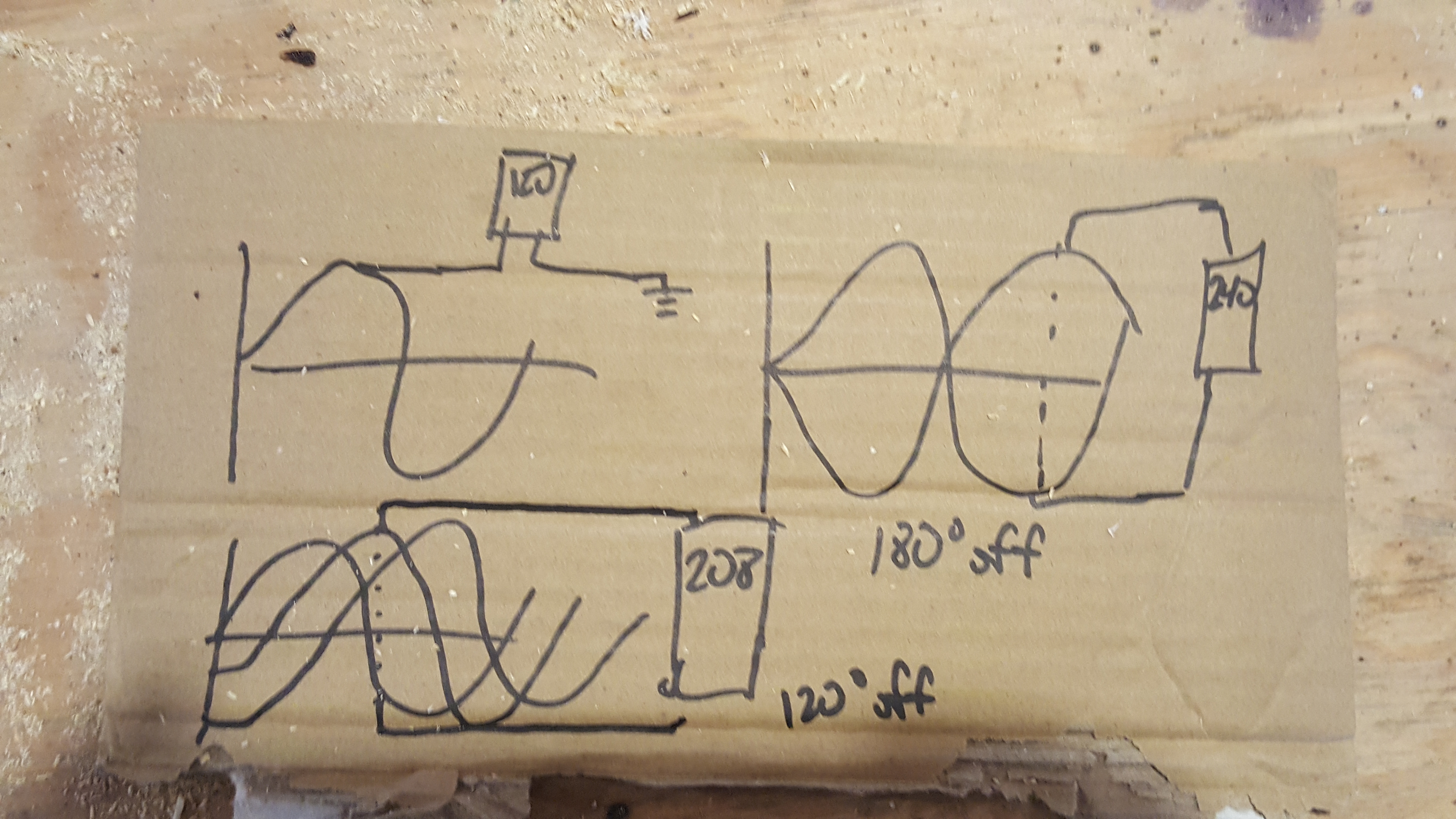

I was confused thinking about how a load draws half the amps when its converted from 120 to 240.
/ Electrical question #34
Loads as most think of them are typically measured in watts.
And doubling the voltage does indeed cut the amps in half.
A 100w 120v light bulb will draw twice the amps as a 100w 240v bulb.
A 2 hp 120v motor will draw twice the amps as a 2hp 240v motor.
Watts is a unit of measurement that in it's simplest form equals Volts x Amps... 2000 watts / 240 volts = 8.33 amps used. 2000 watts/120 volts = 16.67amps.
Less amps = lower electric bill..
