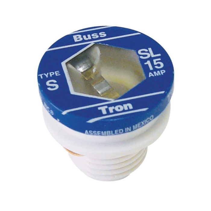

Mine is single 30 amp Edison main with knife switch.
The sub-panel is inside and has 2 Edison Fuses…
A 15 amp light circuit and a 20 amp outlet circuit.
3 bedroom, 1 bath at 1100 square feet single family…
Gas gravity central heat, gas hot water, gas stove and gas dryer…
Over 100 years in service… it least I don’t have those pesky Federal Pacific Breakers that ever home inspector writes up.
I did put in Safety Fuses so my renters wouldn’t be confused should a fuse need to be replaced.
I have never seen 20 amp outlets on a house that old and most have one or two outlets per room. How many times I went to replace a service that has 3 or more taps on a 60 amp box,

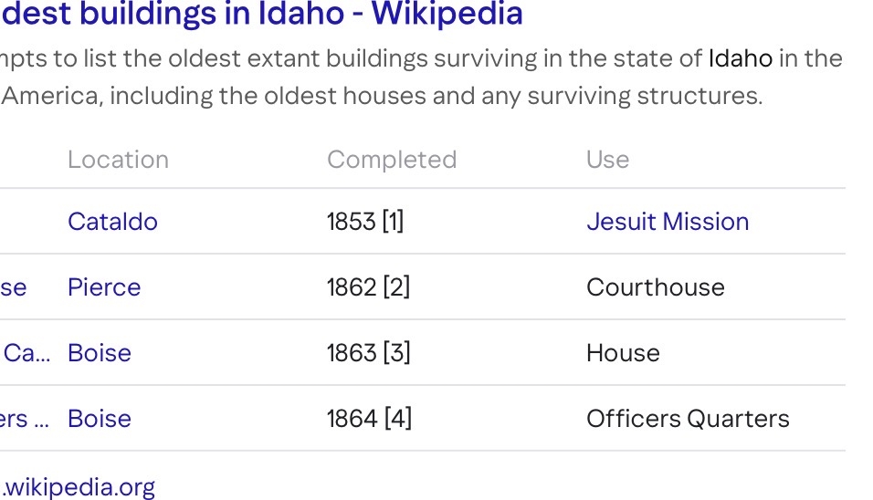

Yeiks….i doubt there’s any structure even close to 200 years in my entire state.
I had to look it up

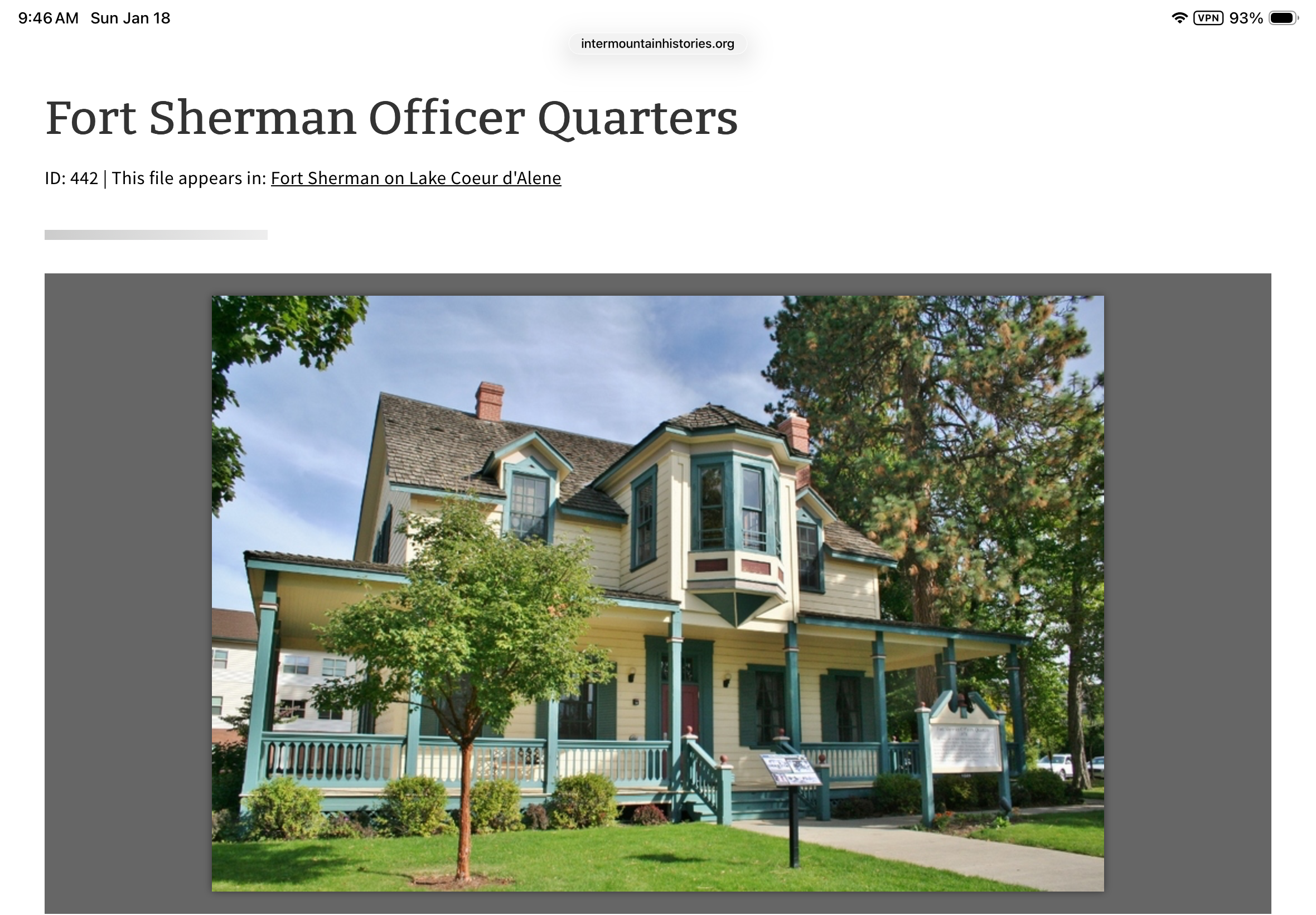

I actually helped rewire the old fort Sherman officers quarters in coeur d Alene years ago. The school where the buildings resided quietly tried to demo all 4 remaining buildings to build new office buildings but was caught. As a punishment they were forced to restore a few of the remaining ones. The old officers quarters was lifted off the ground and a proper foundation installed. Then we replumbed and rewired it (even though that never existed before). Than they were forced to add an elevator to meet handicapped requirements….like they had elevators in 1880. Then had to have custom gas/electric lights manufactured.
Came out beautiful, and is the most expensive office space per square foot in entire state of Idaho.
I don’t see how restoring to original means to replace everything with new stuff.
