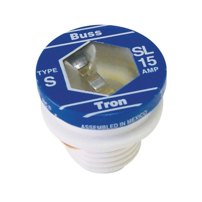

Houses in the neighborhood where I grew up were all built on panels of Edison fuses. Not a damn one of them was properly-sized when we moved into that house. I remember seeing 30A fuses on AWG-14 circuits, because some prior owner got tired of having their 15A fuses blow. Of course the panels are almost never labeled with what size fuse should be in each slot. Those things are truly dangerous, in the hands of most homeowners, and may be responsible for more electrical fires in homes than nearly any other invention, ever.
Mine is single 30 amp Edison main with knife switch.
The sub-panel is inside and has 2 Edison Fuses…
A 15 amp light circuit and a 20 amp outlet circuit.
3 bedroom, 1 bath at 1100 square feet single family…
Gas gravity central heat, gas hot water, gas stove and gas dryer…
Over 100 years in service… it least I don’t have those pesky Federal Pacific Breakers that ever home inspector writes up.
I did put in Safety Fuses so my renters wouldn’t be confused should a fuse need to be replaced.
