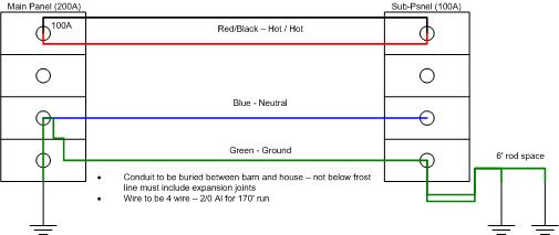

You MUST run a separate ground wire in the conduit out to the barn. In addition you must float the neutral buss in the barn panel. This means you do not put in the screw that ties the neutral buss to the pan. You will probably have to buy a separate ground buss bar (not expensive) to tie the ground distribution wires to. In a main panel the ground and neutral are on the same buss.
The reason for this is that the ground system wants be a tree with no loops in, to avoid stray currents. Also the ground system in the barn has to be at the same potential as the ground in the house and going through rods in the earth does not do it, but you still need the rods . 2 six feet apart is also correct.

6sunset6 - OK - so let me spit back what I think you are saying... From the main panel in the house - I run 4 wire out to the barn... 2 hot, one neutral, one ground... but in the house since neutral and ground are "the same" - they are basically connecting to the big blocks you use to hook big wires onto the small bars...
Then - out in the barn - the ground will go to the "ground" bar - where there will also be a copper line running in from the 2 ground rods... and all grounding lines for barn circuits run there... then the neutral runs to a "floating" and insulated from the panel neutral bar... where the neutrals run...
Attached to the post is a diagram - is that right?

You got it . :)
